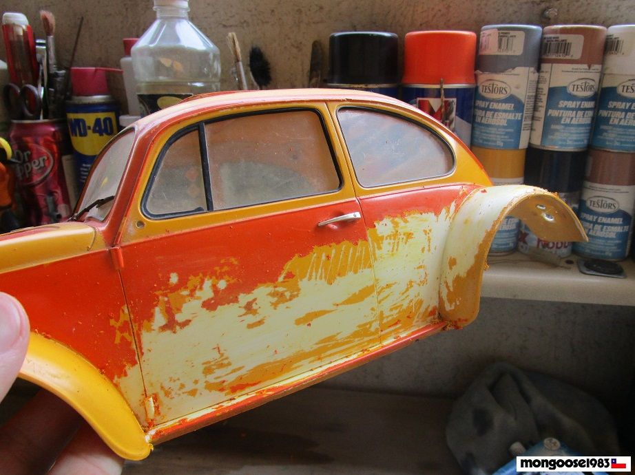

BUT... the yellow paint on the 1st one gave up real quick! :P Here's how the wet t-shirt method worked:
I decided to try some drops of brake fluid on a little area of the VW body with pieces of some old cotton t-shirt. Worked great, paint came out EASY. Wish I knew what type of enamel the original owner used in this one.

Still, today I got half the VW body stripped with the wet t-shirt method:
Sand Scorcher 1979 bodyshell stripping photo Sand Scorcher paint removal process_zpsjfevbefv.jpg

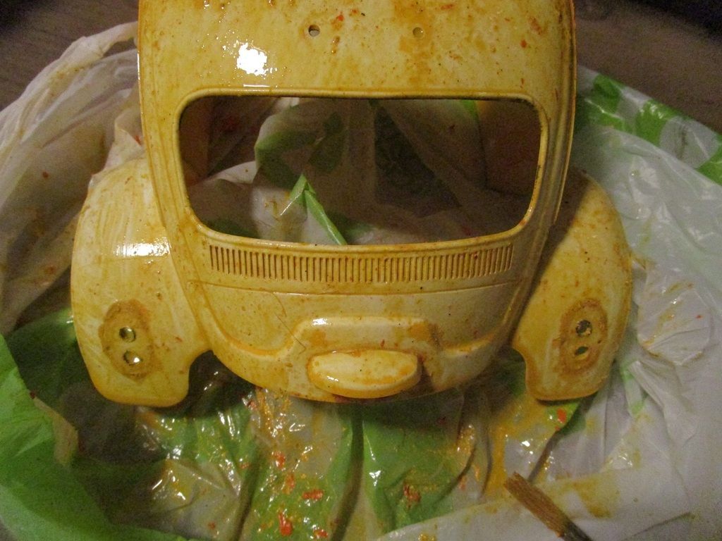

Well last Thursday a local buddy and I we got together to try and test the caustic soda paint removal method. Fortunately it worked removing most of the many layers the body of the Sand Scorcher #2 was painted with. Thick as you can imagine, the brake fluid wet t-shirt method did not do much with the... red, silver, blue, green, gold, white and dark red that was all over it. Incredible. The caustic soda did pretty good, although there's some remnants I hope to remove sometime later. The previous owner thought this was ready for the trash can-I'm in hopes I can prove the guy wrong. Actually, I think I'm going to make the car look not just decent but good.
The caustic soda doing its job. I'm very well impressed. Too bad rubber gloves are so darn expensive. I combined costs with my buddy here, he had to strip a Bruiser cab, and I had to strip this VW body, so I purchased the caustic soda, and he got the gloves, so we could keep costs down to minimum. Pleased about it.
Sand Scorcher orig. bodyshell Caustic Soda (1979) photo Sand Scorcher Caustic Soda_zpsytngritf.jpg
The results. Still some remnants to remove but I am very very happy with it. After that there will be lots of sanding and repair work to do to this one. I'm excited, and very much looking forward to get it painted.
Sand Scorcher #2 body restoration (1979) photo Sand Scorcher IMG_0388_zpscq0uxmvh.jpg

1) This is how the bodyshell looked like when given to me. Seven enamel layers all over it. Silver, blue, green, red, yellow, baby blue, and white. Brake fluid --my favorite paint removal method- didn't worked. It was very hard, I almost gave up. So happy I have not!
2) This is how far I got when I first got it through caustic soda...s6XtJN8.jpg
