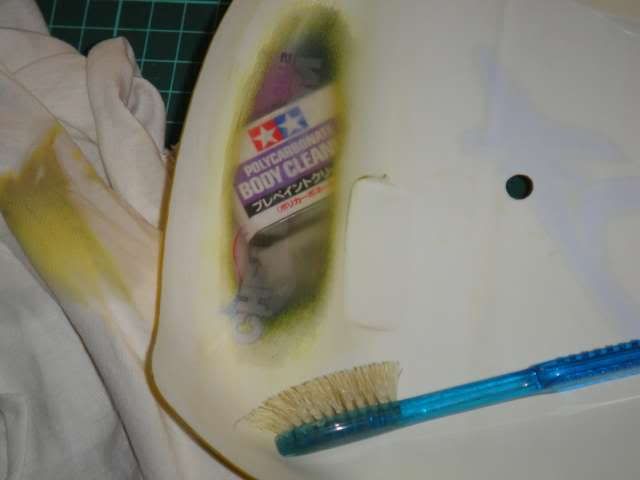

Purple bottle leaves the lexan pretty clear, clear enough for "windows". Here, see for yourself - this canopy came painted black:-
Start scrubbing...
much later...
Dont be expecting you wipe it on & the paint just falls off, noooooo.... it's many many long hours of scrubbing like polishing it off. (Sanding would've been quicker, if it weren't need to keep lexan crystal clear)
Use a soft cloth moistened with the fluid, that's best way. Have tried soaking painted surface in fluid, scrubbing with toothbrush etc... nup, doesn't clean faster.
Once you know what you're doing 1 bottle & 2 tshirts should do that whole shell (buggy/openwheeler). Touring car probably need 2.
I'd run out of patience long before that though :unsure:
