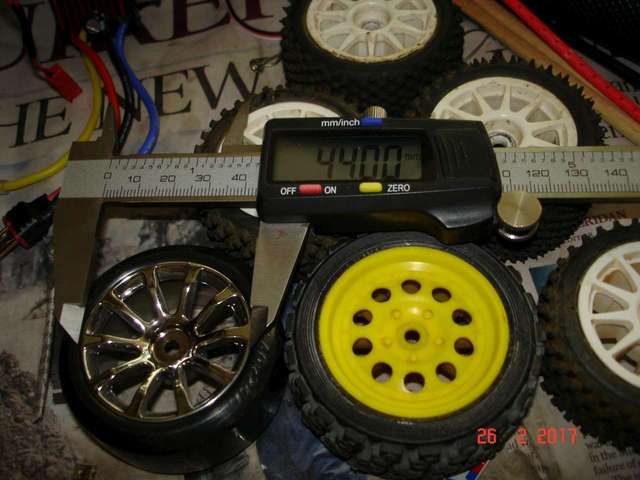

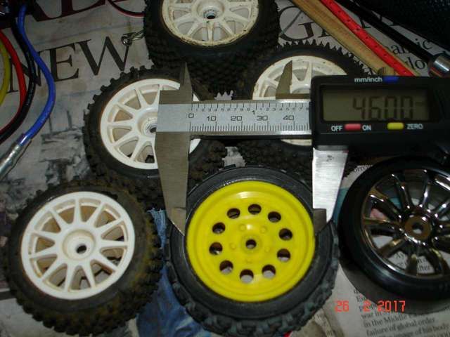

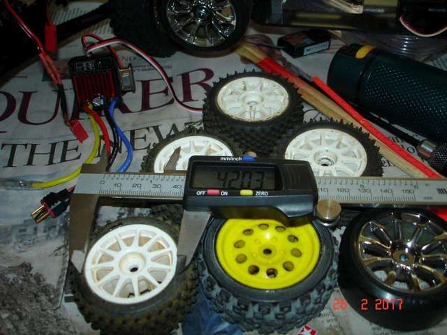

was walking past the Dakar shelf when read your post, so i stole a wheel off the Porker. (Amazing how there's a T hexwrench lying everywhere i could possibly need one... don't we all? :lol:)
Mini wheels are 42mm:-
HPI has MX60 wheel size which comes up to 44mm:-
959 is 46mm:-
No idea what tyres are on the Swift m-chassis wheels but 2 are cut-n-shuts. The other 2 are supposedly for Half-Eight or Losi Mini-Eight, the rubber is a tad wider than the wheel.
Both T wheels are 24mm wide, the HPI is 25mm.
