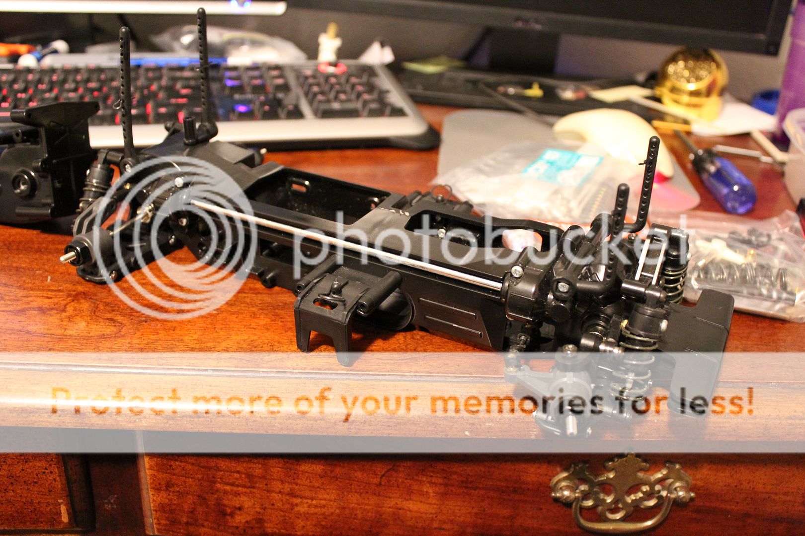

The donor car for the suspension

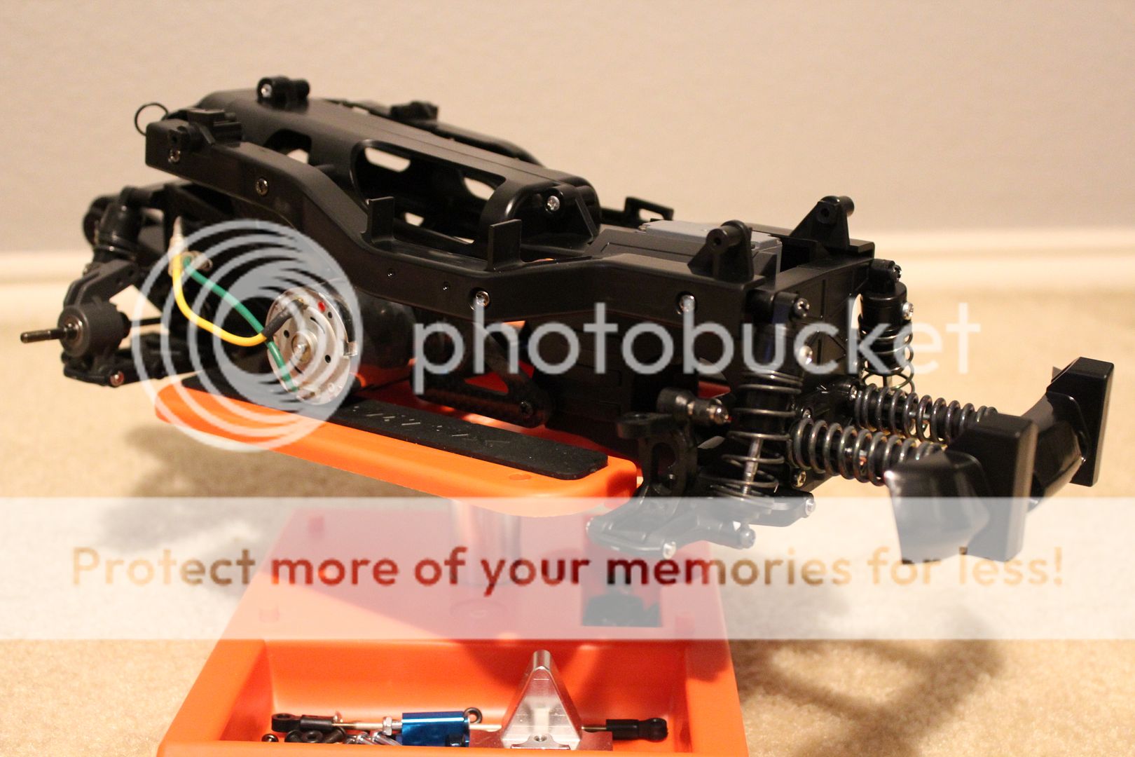

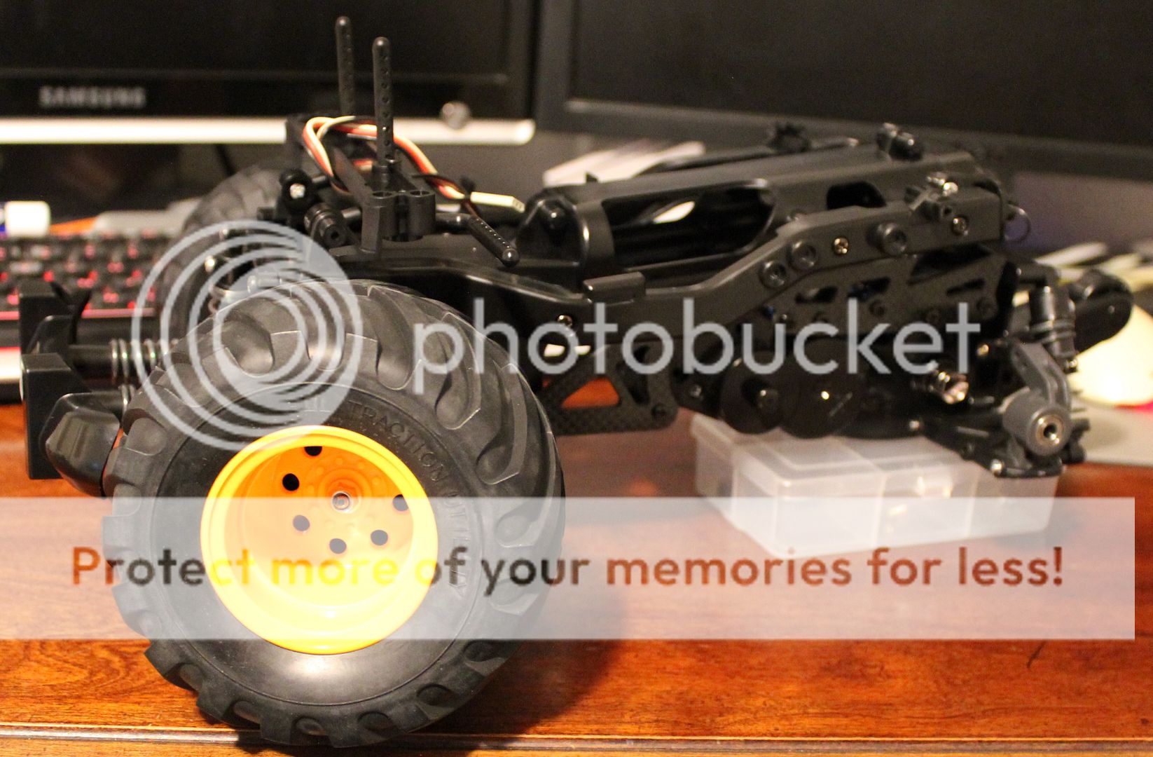

and with that, i got all the suspension parts moved over onto the WR02, and the new WR02 parts onto the TL01 which will be going up on ebay. The rear CF chassis extension pieces arrive yesterday or the day before and I went ahead and got them installed as well.
Here's how it looks now.
will need some rear axles to pud into the front of the TL01LA setup to be able to add the wheels, will then figure out steering, and mounting up the body too.... i think.

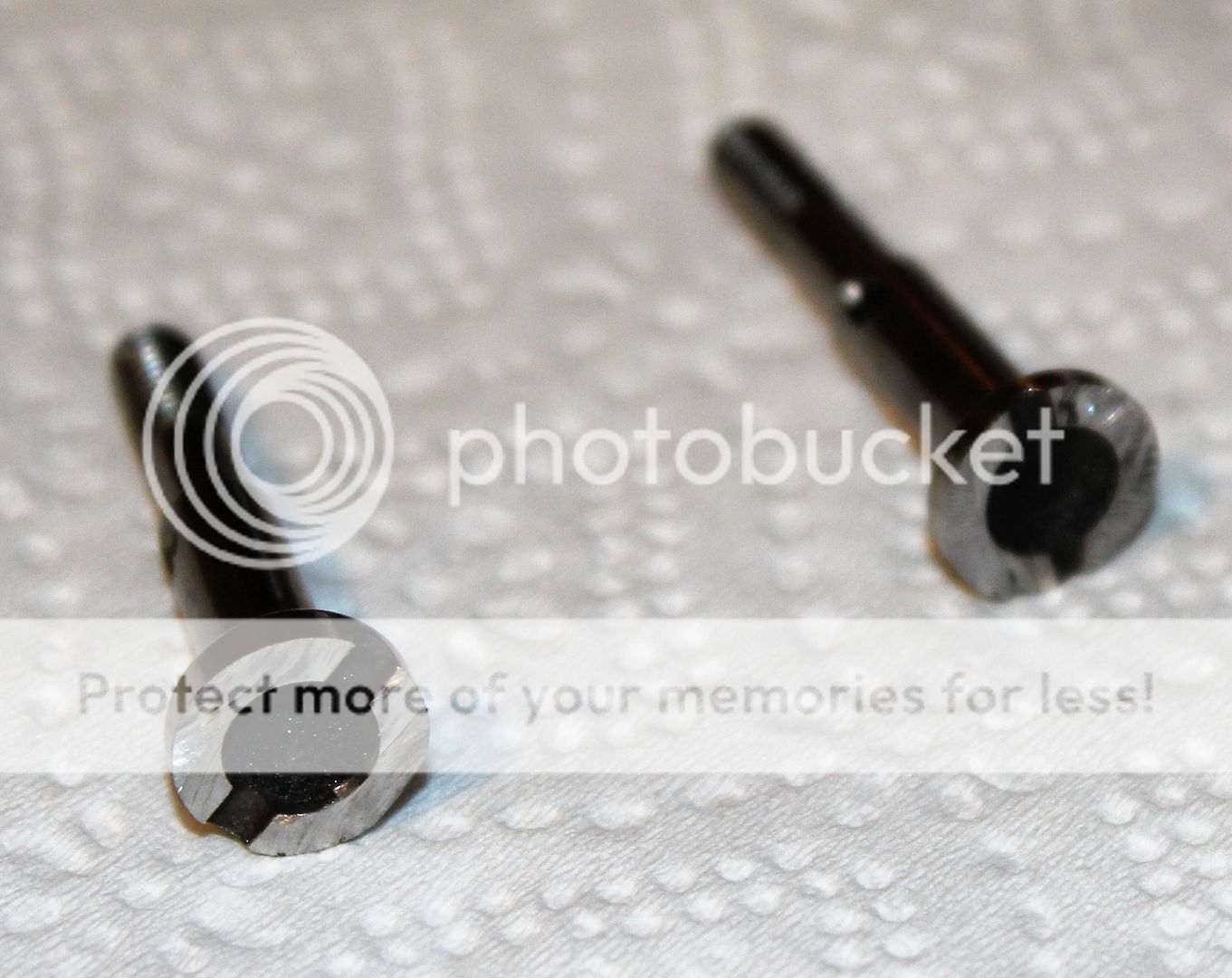

Well this is where progress starts to slow as I have yet to score a Lunchbox body kit, nor some of the other parts needed to complete the build. BUT since I was going to need a set of long out drives for the front I figured what the heck and ordered a set of universals for the rear instead and did some actual modding to the new front out drives to kinda go with how they look on other vehicles.... (only cause I'm anal....... and Tamiya could make these if they dont already).
So the front is set up so to speak....

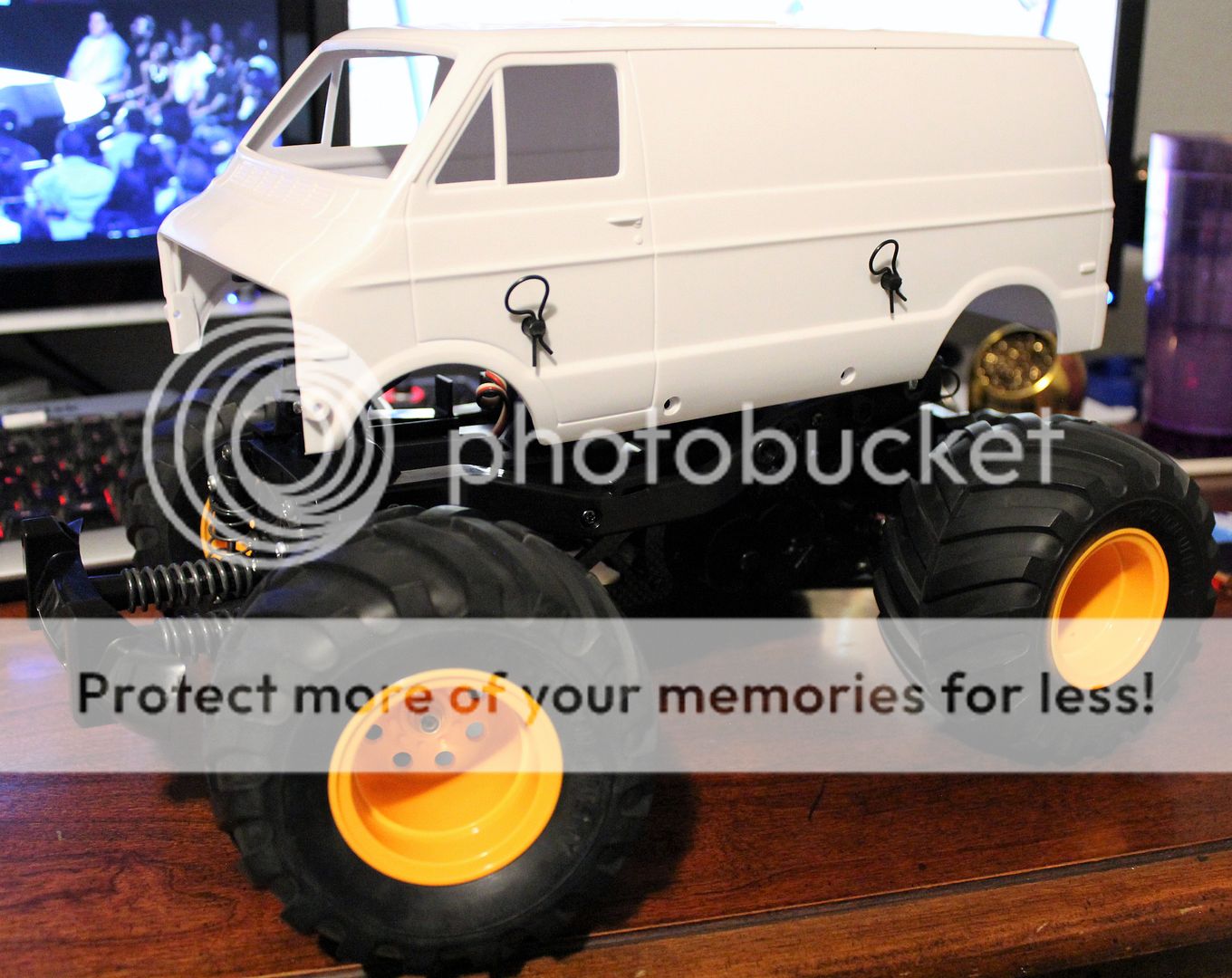

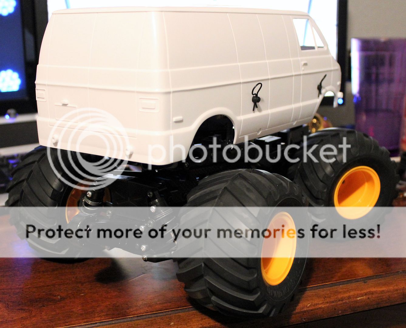

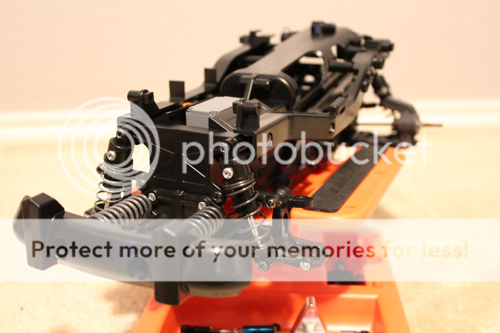

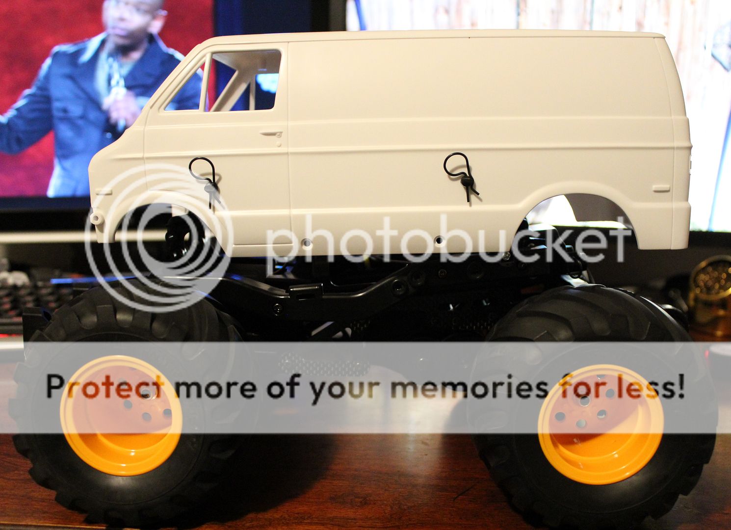

I was able to get a good setup for the body mount and have the front setup how I think it should go (eye balled it using my shelf queen vintage LB body) but once I got the tires on I realized that the mount will be too low which isnt a big deal and will be addressed once I get an actual body for it.
But here is my grocery list
SHOCKS!!!!!! these stock things are horrible Id almost rather have it sitting on the chassis than even have these mounted.
LB body kit....
^I actually think that is all I will need to complete this.......... well the main part of it.... I think.

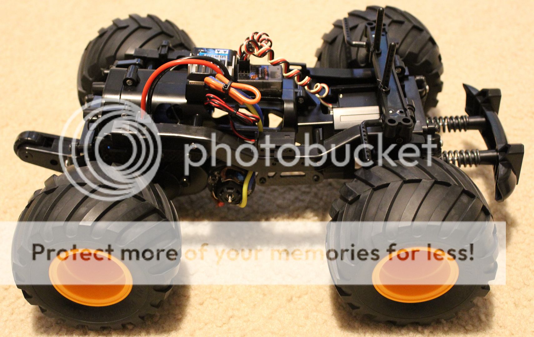

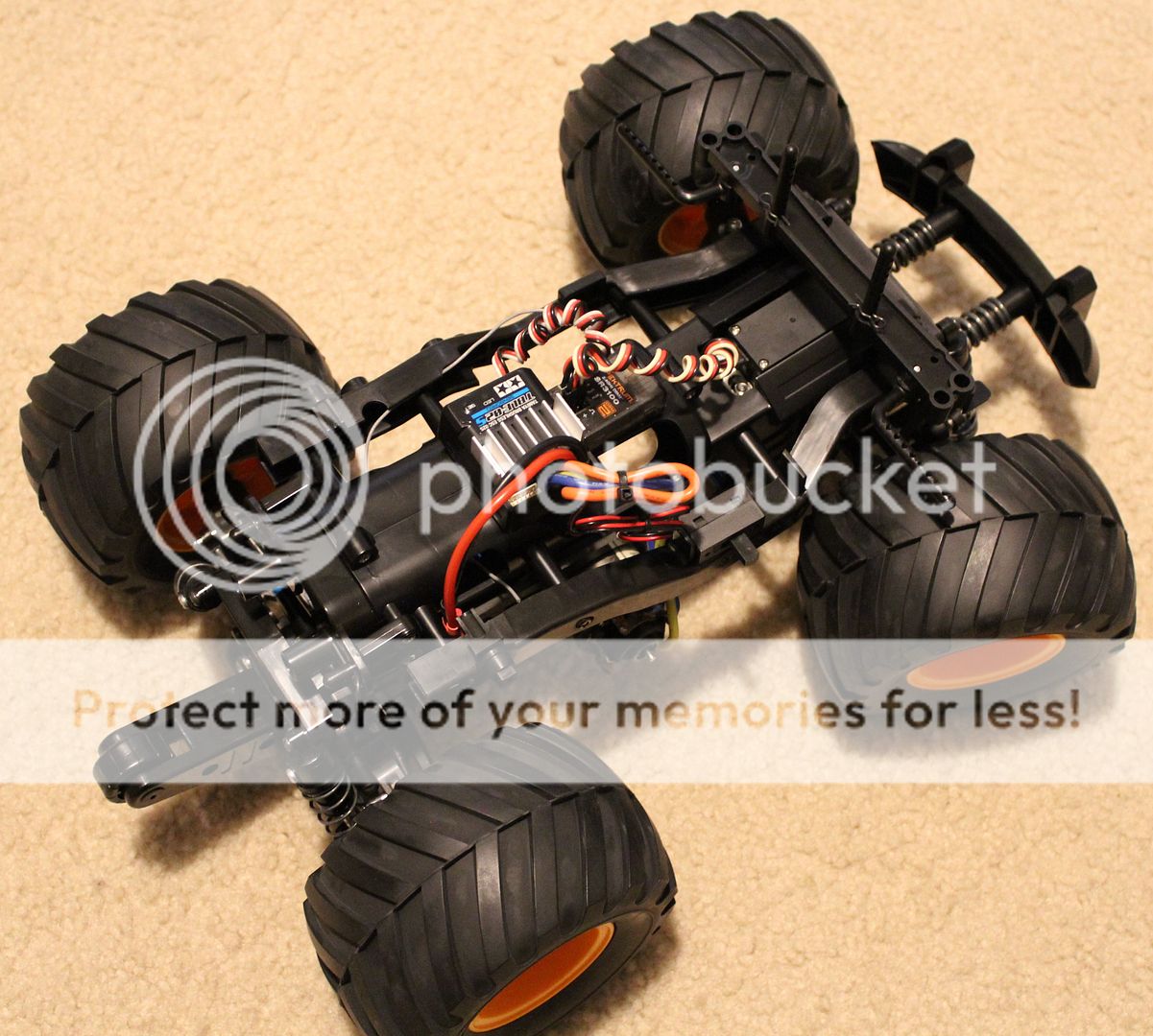

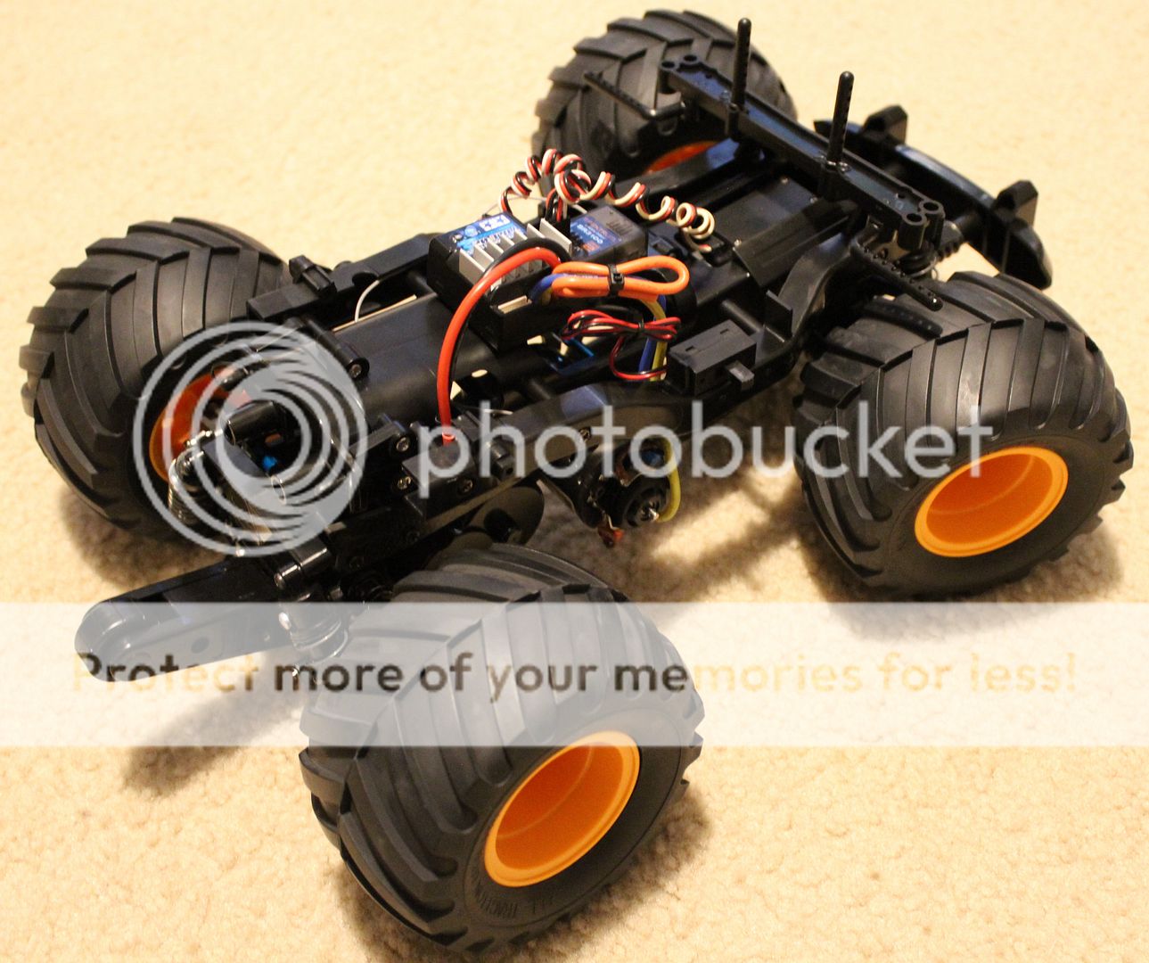

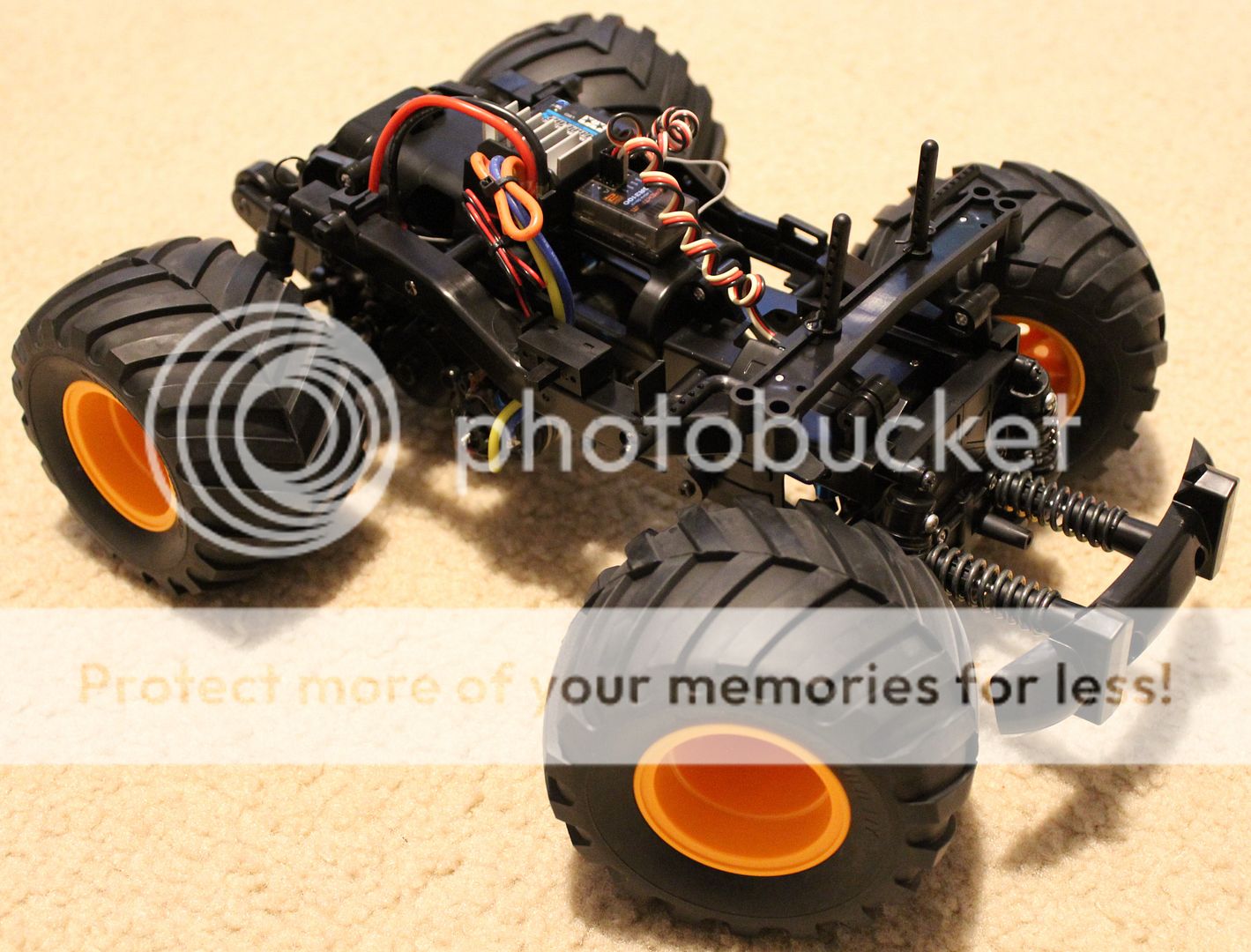

So nothing much as of now, pricing out Lunchbox shells but I did go ahead and add in the electronics, a MG low profile kopropo servo with aluminum HD servo saver, and the standard fare TBLE02S with a Team Checkpoint $ 19T spec motor (is was soldered onto the esc from a previous build so figured Id try to run it.... I think the ESC will hold up.... I hope.

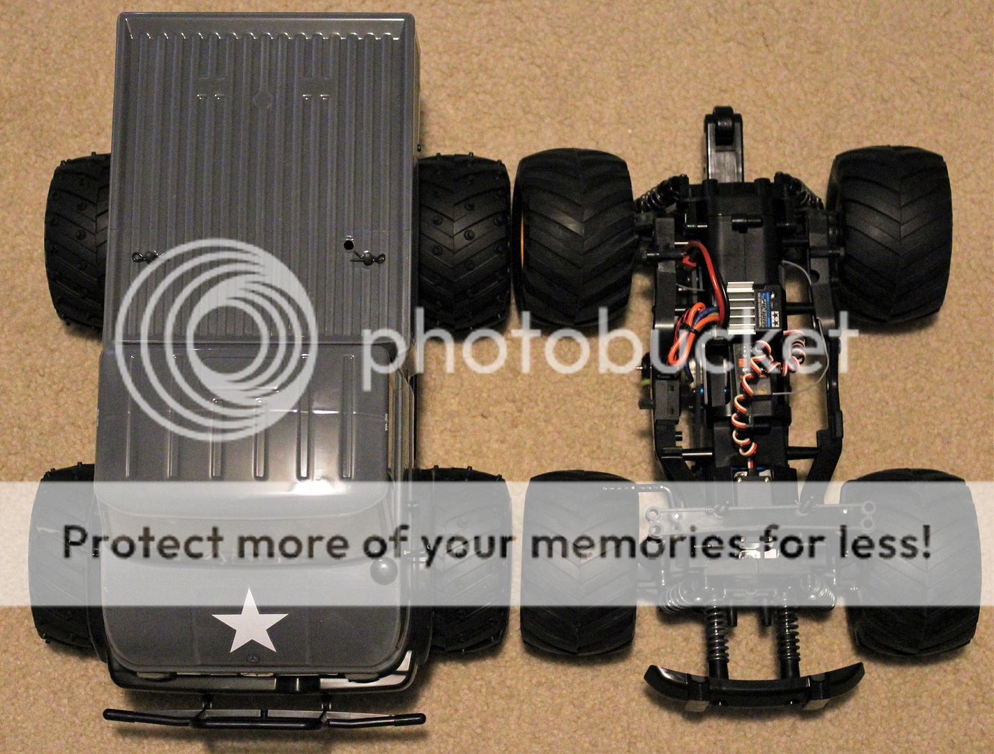

Rear universals came in today, and now Lunchie is standing on his own and now I can see that the wheelbase is spot on to the CW01 chassis so it wont look wonky! I must say it looks a little meaner with the longer wheelbase, more fitting IMO.
This is great! I've been kicking around a similar idea for years. Where did you find the extension plates for the chassis? The width looks great too. Are the TL01 arms between the stock WR02 length (a little too short) and the TL01B/WT01 arms (a little too long)?
Thanks, the chassis is a piece made my Square http://www.ebay.com/itm/Tamiya-WR-02-Carbon-Sub-Chassis-Set-Blue-Post-40mm-LWB-Square-/252437816190?hash=item3ac677637e:g:hPgAAOSwv0tVHLWu they have different color combos.
As for the arms, the WR02 uses stock TL01 arms, what I am using is the TL01 Long arm kit, the arms  themselves are wider, but the c hubs and rear hubs mount inward to where there is no track width change, only a change in handling. Kinda like the Yeah Racing long arm kit for the MF01X.

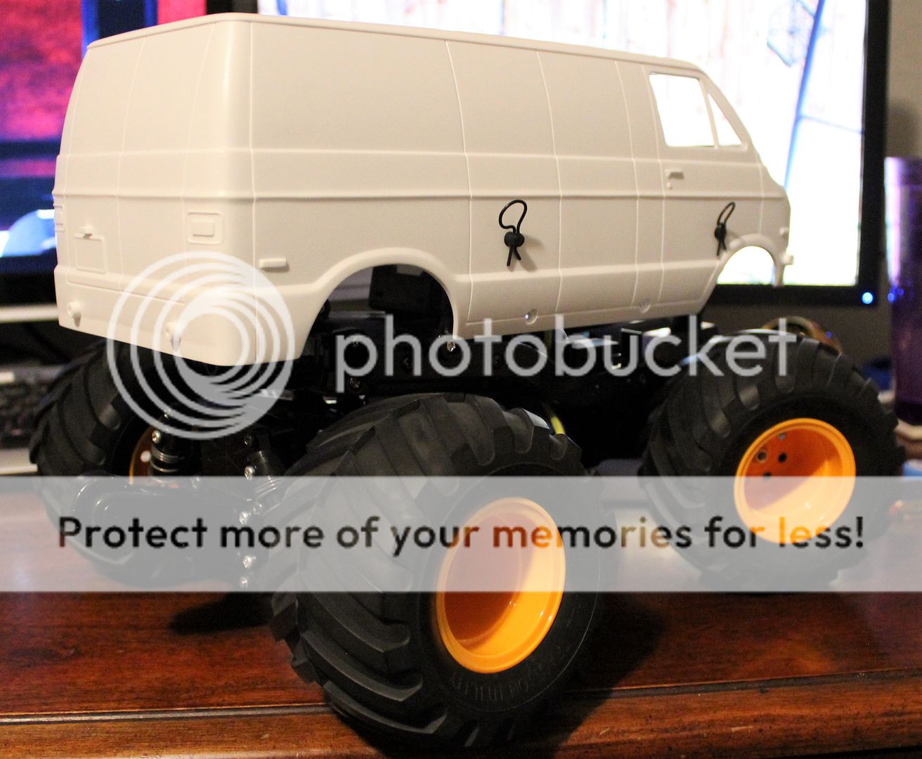

went ahead and ordered the LB body set minus the decals as I have a couple of sheets of them.
So it was really awesome that I didnt really need to mod anything to get the body to line up with some stock body mounts so it looks like im good, now just to paint it and get some shocks.... i NEED shocks.... lol.

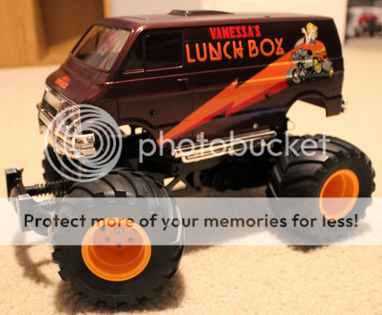

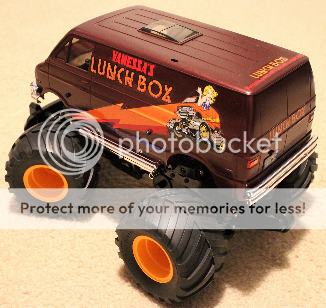

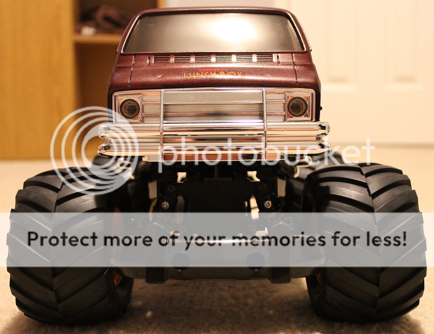

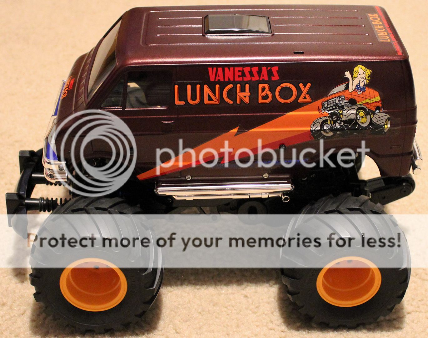

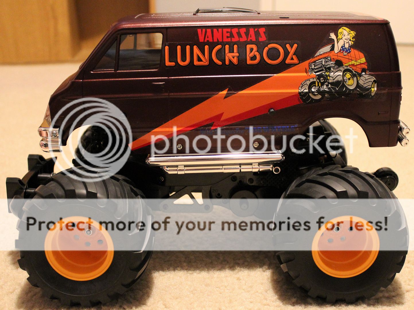

Although not completely finished (everything else needed is simple WR02 hop ups) I went ahead and painted the body. I chose to paint it closely to the color I painted my original Lunchbox as a kid (saw it painted this way in an old RC Car action magazine).
Its so pretty Im scared to drive it, that and these friction shocks are horrid!!!

The Lunchie looks awesome, what colour is that?
It's actual car paint - GM Dark Toreador Metalic
