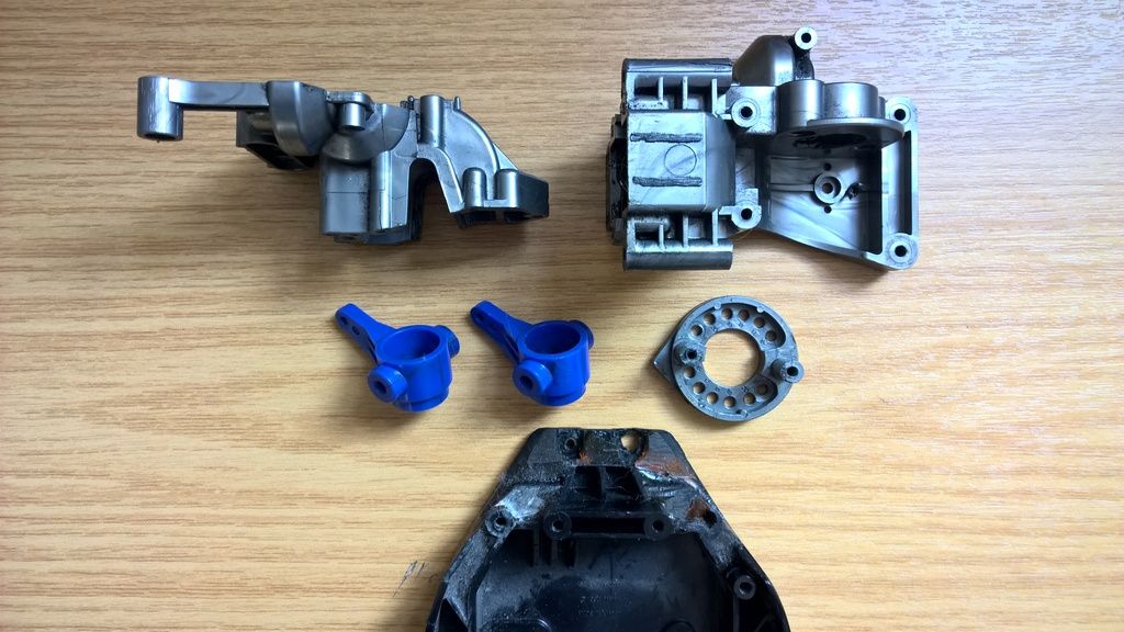

First picture shows damaged parts, cracked cases, threaded motor mount and damaged front chassis which had been repaired with resin.
Second picture, bearing failure?

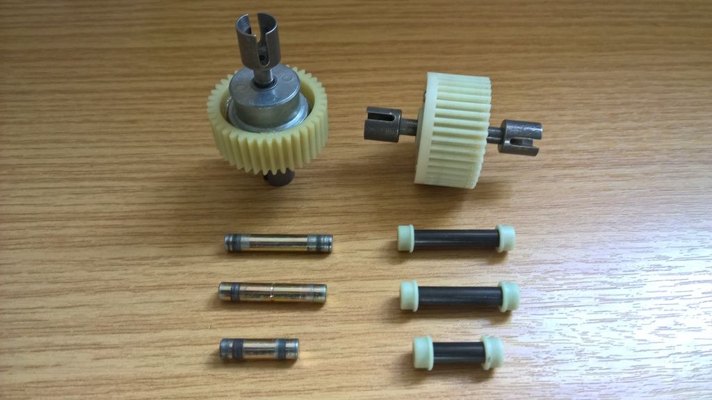

Third picture, I made some CF shafts to replace the metal items and rebuilt the differentials.

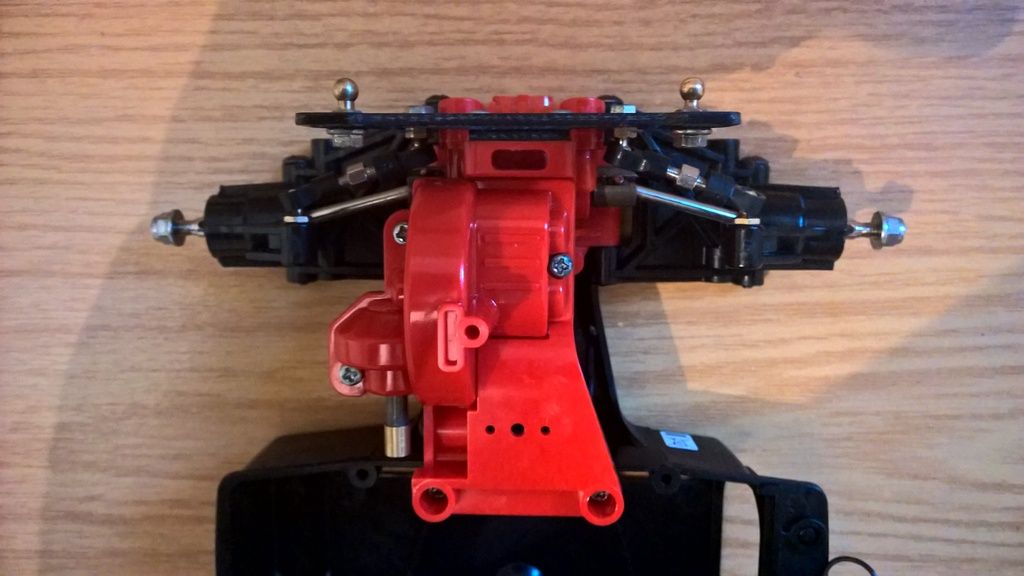

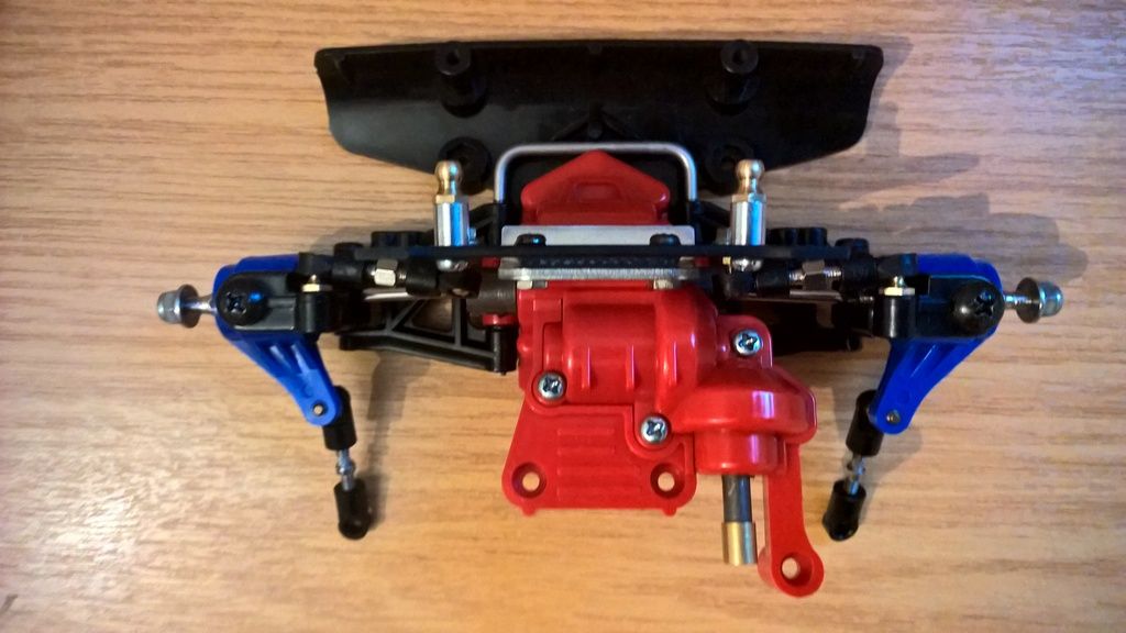

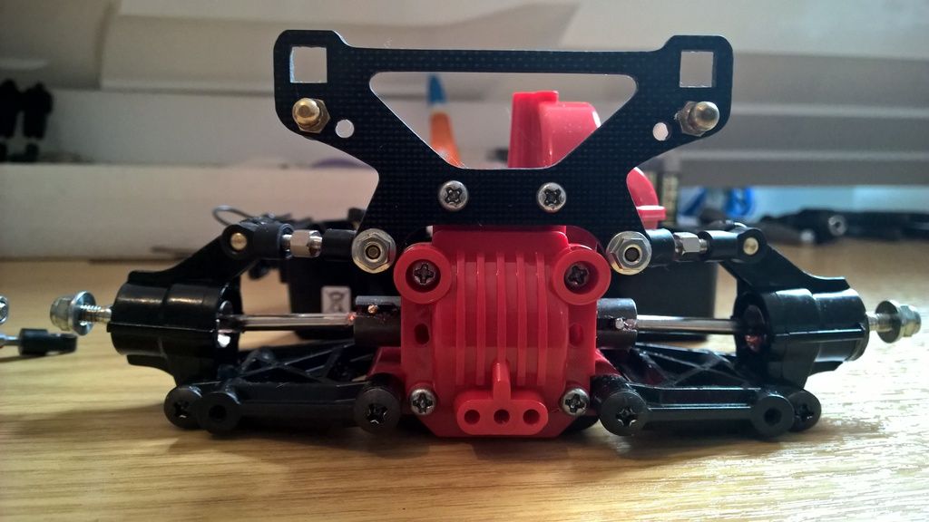

Some parts arrived, which allowed me to continue the build.  Firstly the car got treated to a new bearing kit, to replace the tired items.  I came across a hard prop shaft for a bargain, so I purchased.  I wasn't planning on spending unnecessarily but I couldn't resist.  GPM motor mount, to finally do away with the plastic item.  The screws which go through the case were a little long, so used x2 washers per screw - sorted.  FRP damper mounts, F and R, were also purchased.  These were the important parts as I believe that they would allow me to manipulate the body as required.  Whilst rooting around through spares, I managed to put together a x7 piece tie rod set for the car.
So I suppose stage 1 for GT2 to GT1 is to reverse the rear lower arms.  The only other thing I did do was to use x1 O ring at each end of the dog bone, as there was too much movement.

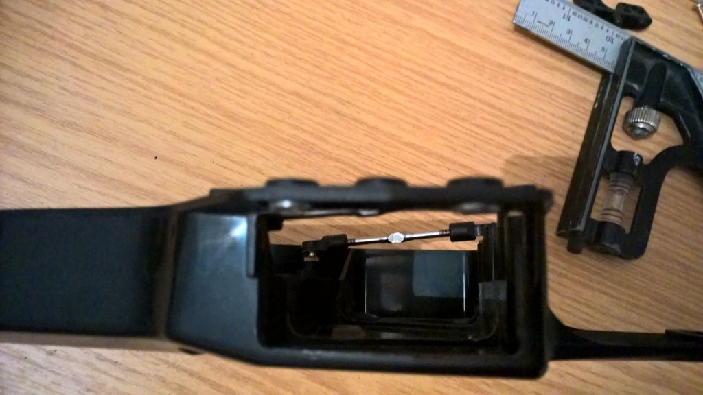

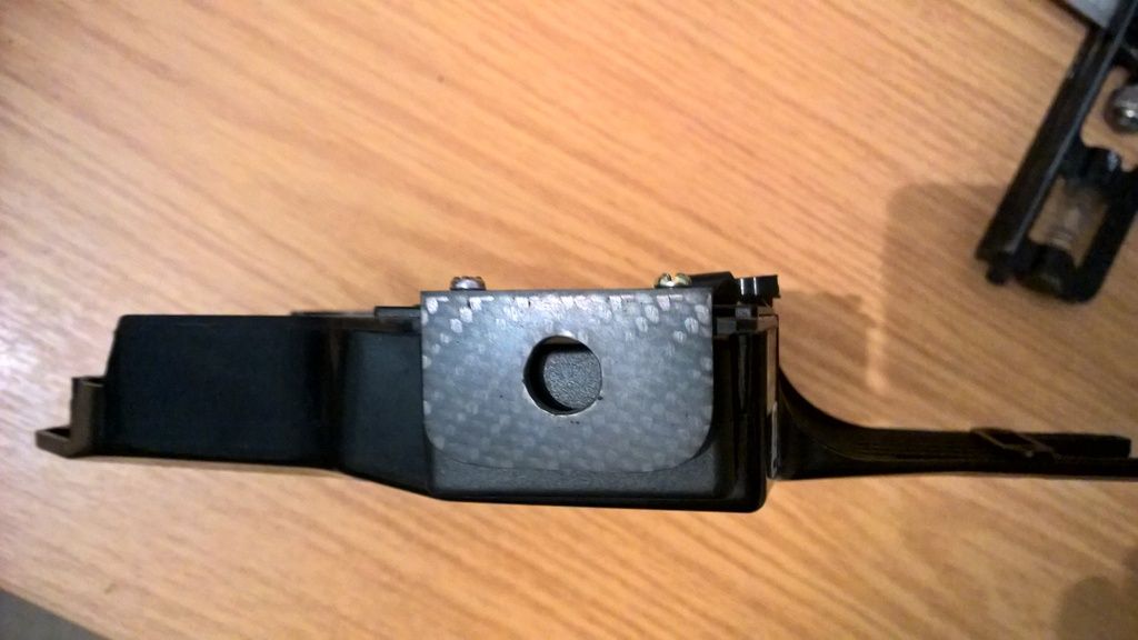

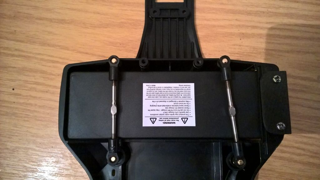

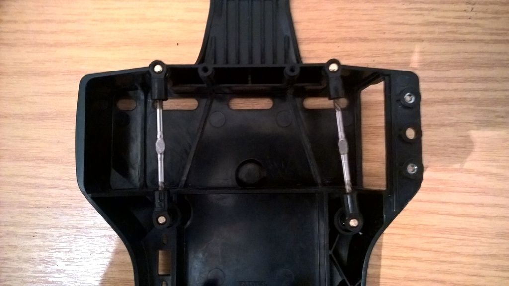

One of the areas I wanted to look into was the possibility of fitting hard case lipos.  My solution to this was to remove the top plate and scratch my head.  Reason why was because removing the top plate would create another two issues.  Bracing of the chassis and a platform for the esc.  So being a typical bloke I threw caution to the wind and continued.

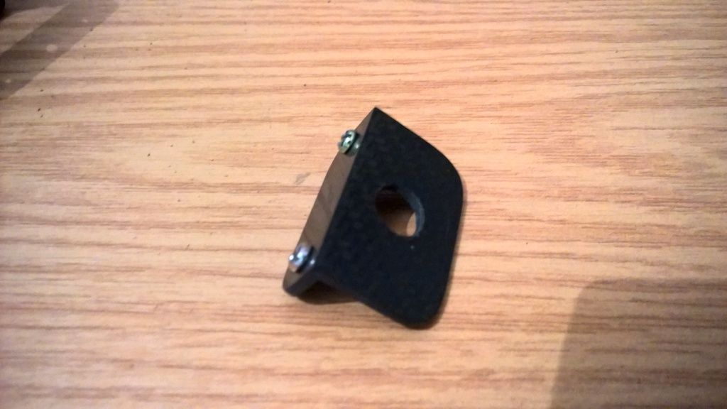

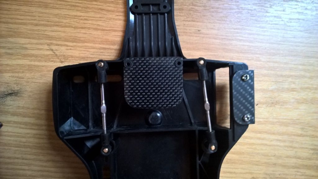

Firstly the opening for sliding in the battery was enlarged.  Then I had to reduce the webbing in the tub.  Once that was done I had to think of a way of retaining the battery.  A simple, 2mm CF angle, battery plate was fabricated, with x2 flanged nuts pressed into the chassis.  I could not get too carried away here, trying to make a quick release or what ever because the body pinches in there.
Anyway, time to think about esc mounting.  Got a few ideas already.

Well at least parts are cheap so go ahead and modify away. A shorty lipo looks like it would fit in the existing space without the extensive modification you have undertook.
Yeah, chassis not too expensive, but everything I've done can be reversed engineered to oem.  A shorty pack would fit length ways but will still have issues getting it to seat in the compartment and getting it into the chassis.  I also don't want to be limited to shortys.

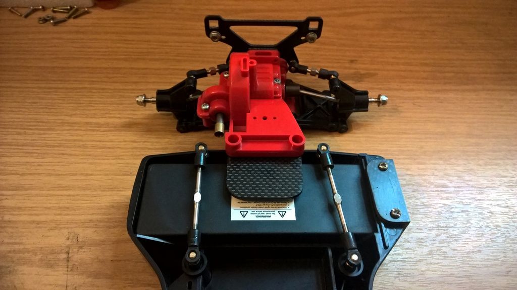

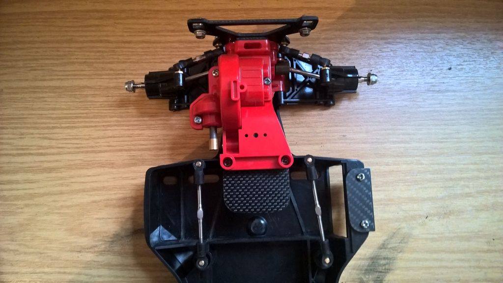

Made the esc plate out of 3mm CF plate.  Cut pretty much with zero tolerances and persuaded onto the chassis.  Now rock solid without further fixings.

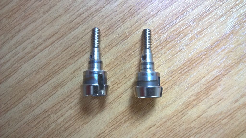

My attention has now turned to the x2 screws mountings at the front of chassis, left/right, for the steering - as I have had these fail on me a few times.  Was tempted to cut them out and replace them with metal stand-offs or even sleeving, but I'll probably just resin it again.
