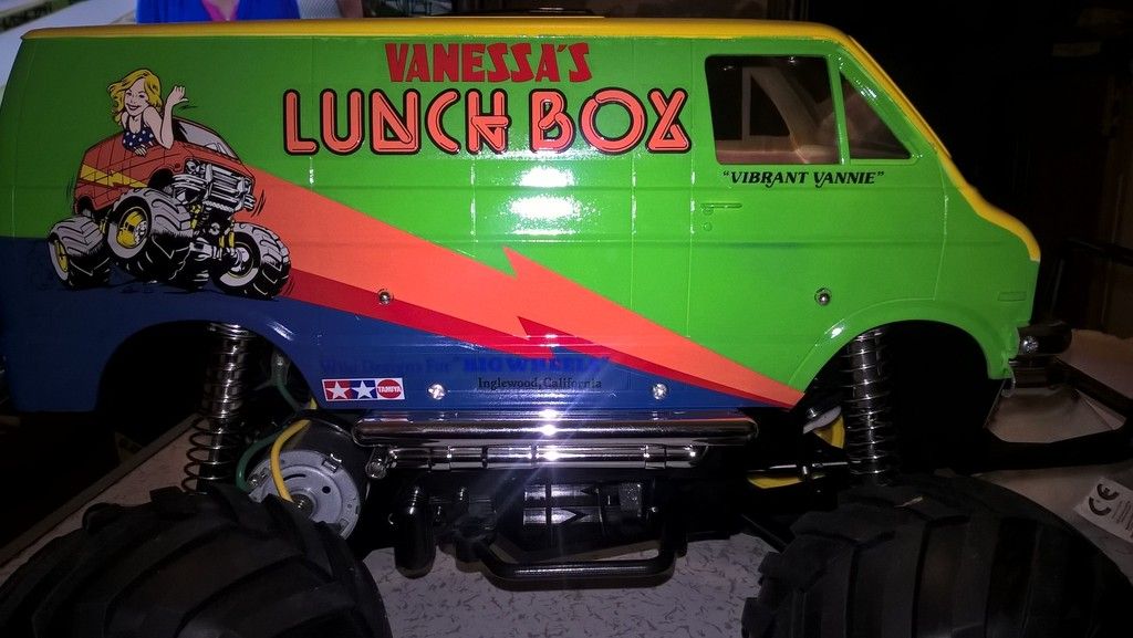

Man was I happy to see this on the side of the box!!! (see pic)
This is the way my father painted it for me as a kid... please tell me that these color codes are preserved somewhere?
Would love to paint my new one the same.. :D

Now I just need to figure out the paint codes for the blue/green so I can place my order!
