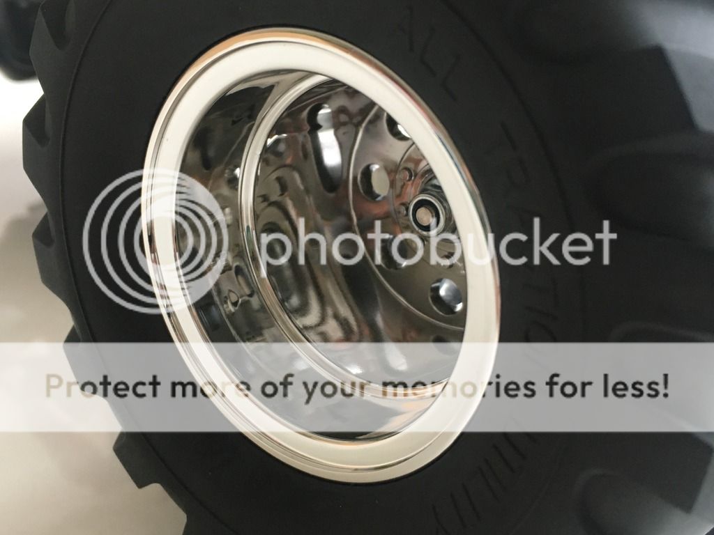

Wild Willy 2 wheels and tyres:
6CD094D8-73CD-4FE4-9262-894DE2B0B8A4_zps

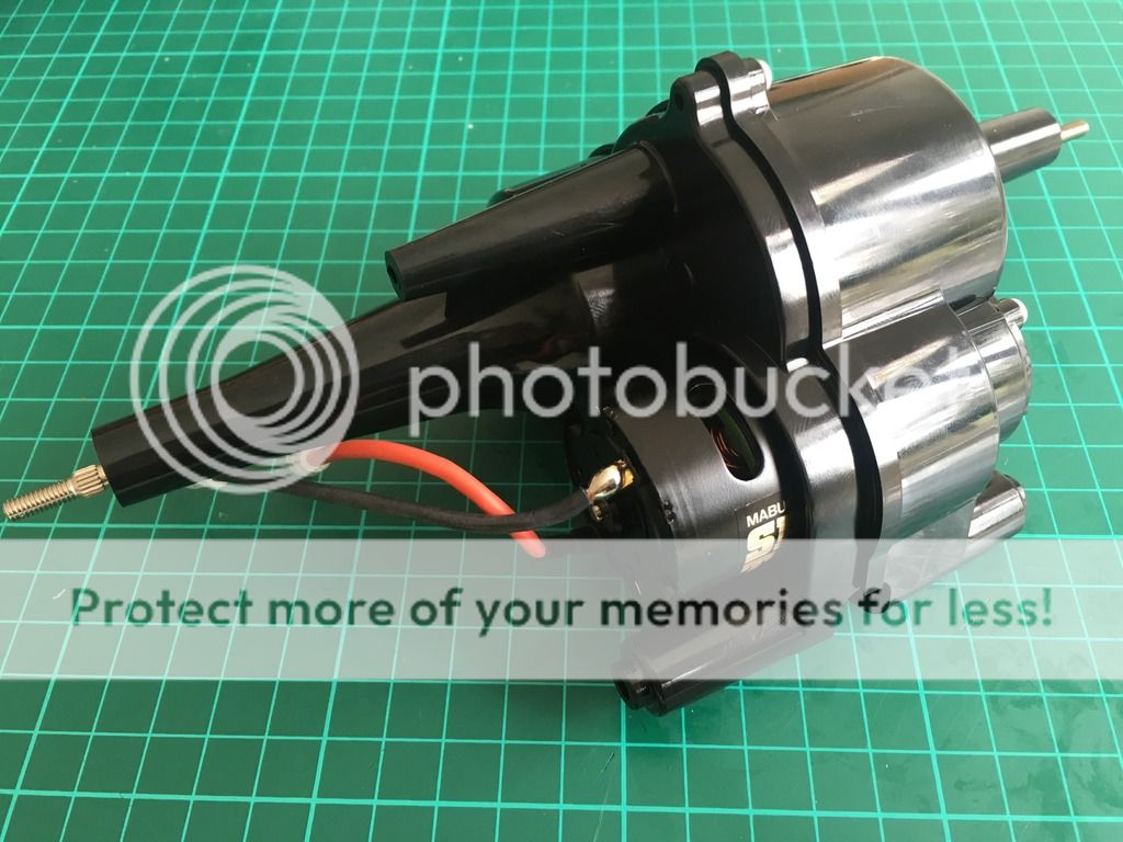

Rear gearbox with Sport Tuned motor fitted:
3A10C997-BFD7-46A0-ABF1-4B98D6F1641A_zps

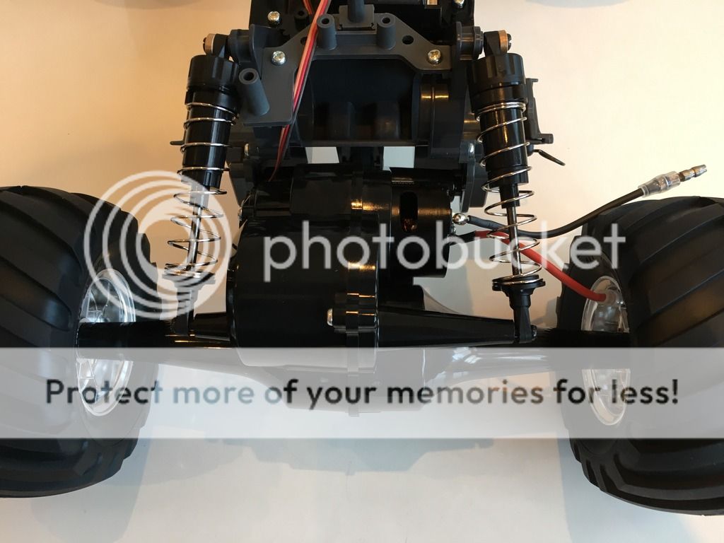

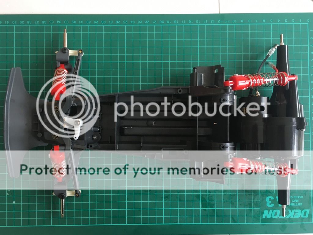

Front and rear suspension fitted:
D00145BB-CE7D-44FC-8FE8-E85E84A83C05_zps
56361286-0B59-44BA-9F4D-91FAA6C01019_zps

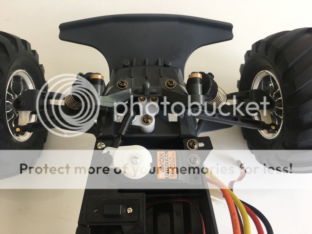

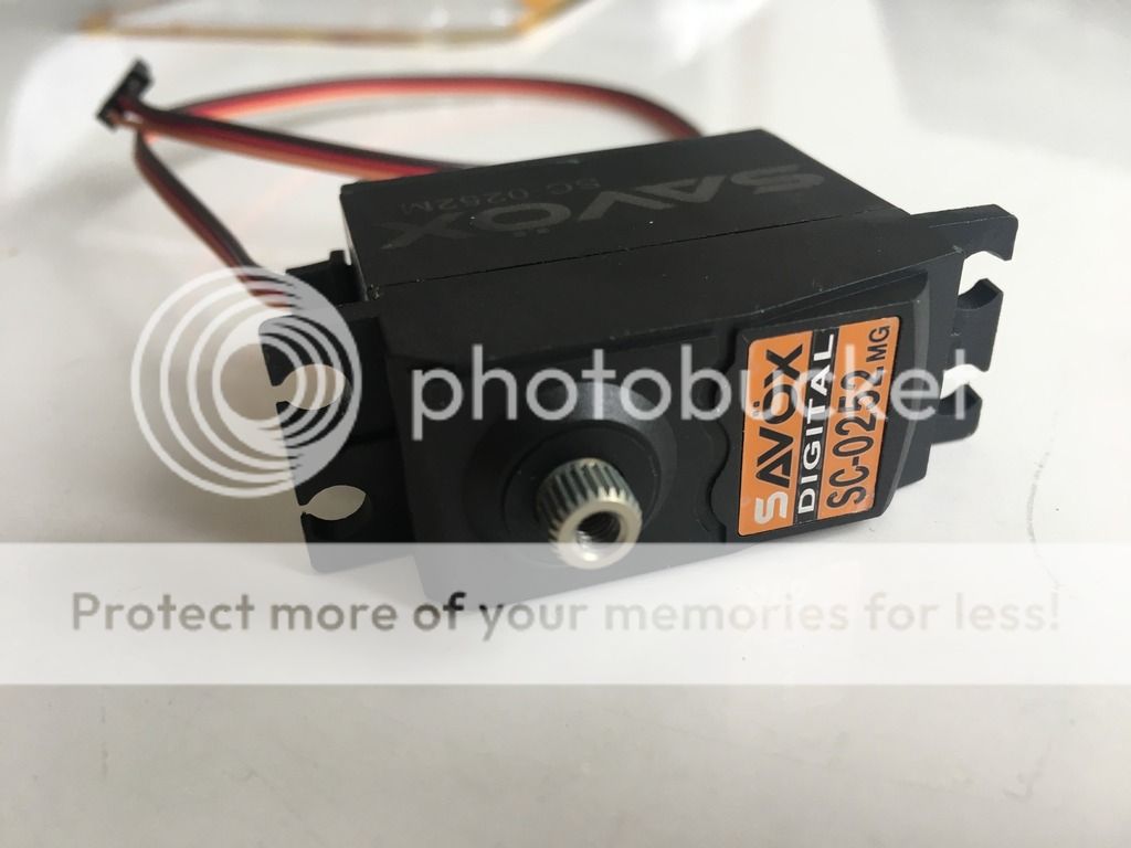

Savox Servo:
C117CC0B-62C9-4942-80F0-D86F8DE1C6C3_zps

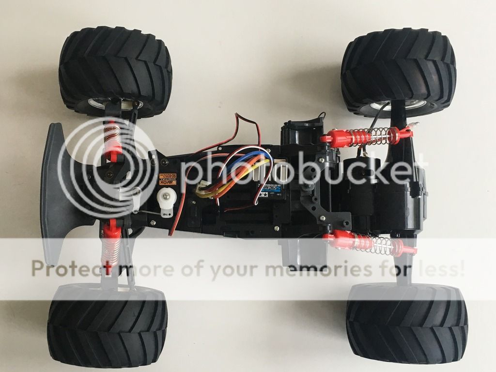

Wheels fitted:
9FAB1E0C-CDE5-476C-9257-B91D210FF93E_zps
D32BF8C6-E328-46DC-AB9B-536DEEE02F5A_zps
7F1542F6-5A36-4D56-94D2-4B87A4183429_zps
C6A30BBE-91D8-4B9E-921F-969DF5268F0B_zps
B93001F6-BC86-451A-BA94-22907CE9509C_zps
C85D9405-BDF1-411D-9A65-A6858742B007_zps
4580059D-C0E8-472C-A6BB-D6770E7C9264_zps
CA65F2D2-E5AC-4F99-81DB-D58B01498AF8_zps

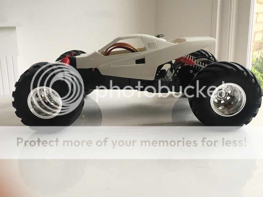

With body fitted:

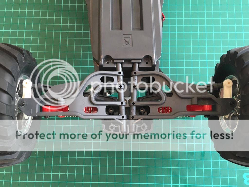

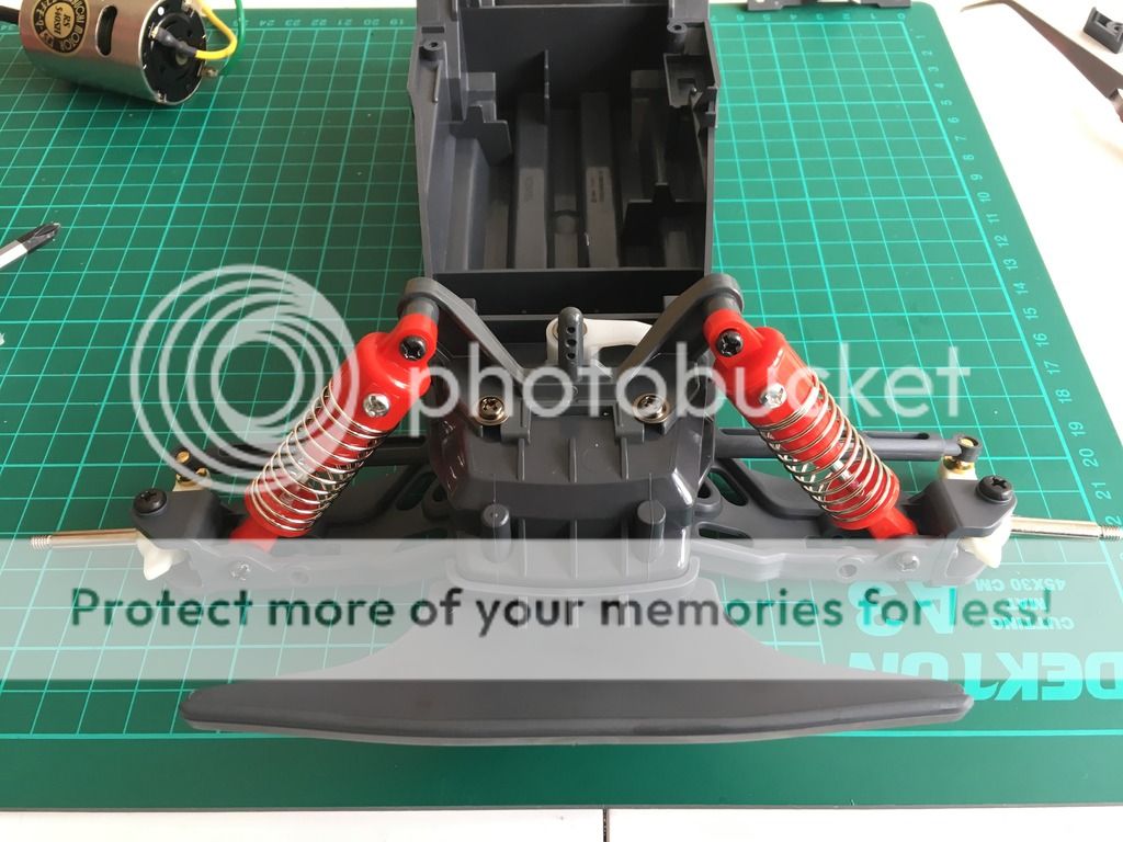

So I am going to attempt to fix up the suspension on this car using the sloppy steering improvement mods described elsewhere in this forum.
Will heat shrink the tips on the ends of the suspension arms. Steering mod will come later with ball cups and ball studs, just need to get the parts
For the shocks, I can put on DT-03 CVA damper set 54567, the CVA short and mini shock II set 50529/50520, or use the kit shocks from the re-re Monster Beetle.

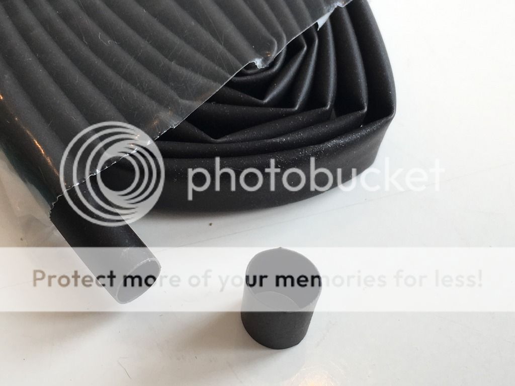

So I had a go at the heat shrink mod to the pivot tips at the ends of the suspension arms where it mounts to the tub.
Not sure if i've done it right or as per others but this definitely removes some of the play or slip that the arms exhibited. They are now firmly planted in their pivot holes.
This is the heat shrink I used:

Arm on the right done with heat shrink, arm on left not done. Definite difference between them, no play at all on the right:
BD95F0A4-64EB-44FC-B48C-4FD6AB591F40_zps
55A66B55-6B69-41BB-BE58-849C099B8119_zps
Both completed:
B4BC3E8D-4E32-46AF-8B25-1E879880EA79_zps
Haven't driven it, and haven't driven it without the mod either, so I won't be providing a comparison commentary, but this definitely helps reduce some of the sloppiness in the front suspension when manually moving the arms around
Next up will be the springs/dampers and then the steering link mod.

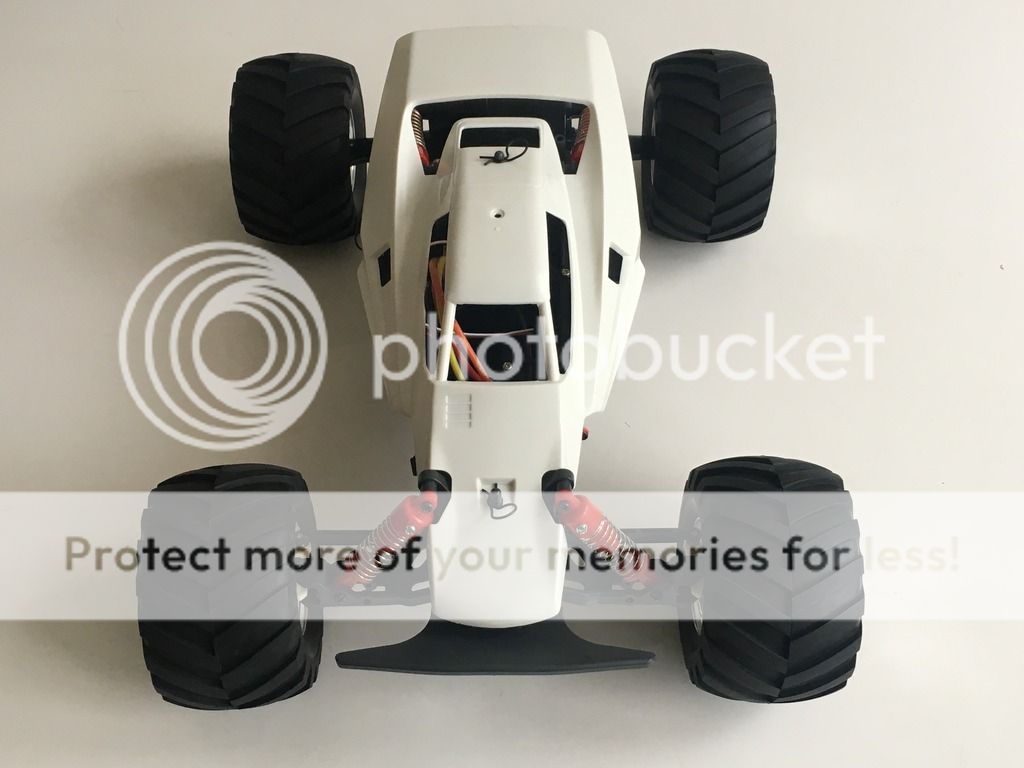

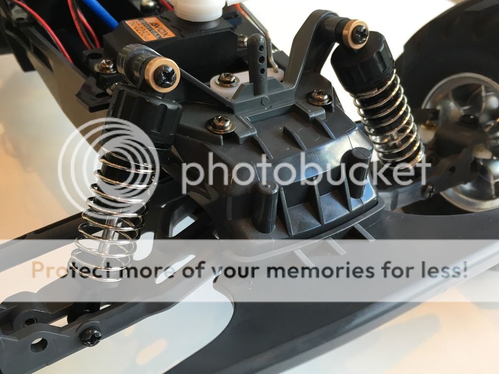

So I've now mounted some shocks, put on the DT-03 with Tamiya hard oil on the fronts and regular oil in the rears. Feels more planted, yet to run it but will drive it before switching out to test a couple of other possibilities.
FC6ACCF0-1B97-4298-8887-860BE2476F7D_zps
C0886EDF-D861-4F63-B28C-B2CB26B60EE7_zps
305C7210-1DD2-493B-B3BF-FC783780477A_zps
BA2EF97B-761C-478B-B04B-F3B45C1940A7_zps

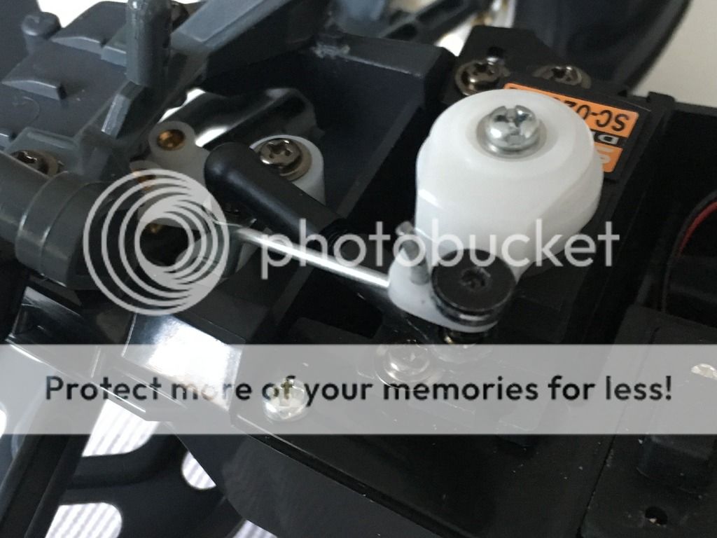

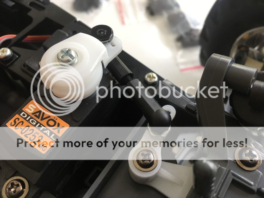

Also had a go at the steering link mod. I used some of the DT-02 turnbuckle kit, and the thread of a 3mm screw (I cut the head off using pliers to leave just the threaded rod). This has reduced slop by 50% but there is still some play in it. Compared to stock with this and the above modifications, the Mad a Bull feels alot more 'tight'.
Turnbuckle kit from DT-02, kit part number 53828. I used two ballstuds and two ball cups from this set. ( A bit of a pricy mod component when you consider cost ratio of items used out of this pack...!)

Servo horn with screw and ball stud.

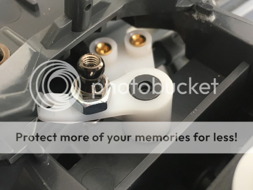

Ball stud and nut spacer on the steering arm:

All connected up with ball cups and threaded rod connector:

Just wondering a little bit more about the fact that there is still a little slop or play (although much reduced from before the mod), I tried to stiffen the connection between the servo horn and  the steering arm by adding the stock steering rod back in. This effectively triangulates the connection, or braces it. I made a minor tweak to the rod to avoid it clashing with the new screw head on the servo horn, bending the end of the steering rod up.
The steering action now has zero play in it, feels really tight. I plugged it into the servo tester and it's got a great action. The steering rod and the new turnbuckle rod do not clash with each other

Nice! Is there still clearance between the rods and the servo housing for full steering lock to both sides?
Nice idea with doubling up the steering rods.
You can buy ball nuts and those rod ends separately if you search for the part numbers so you don't need the turnbuckle kit next time. I got some m3 threaded rod off ebay for £1.20 for 30cm.
Are you going to be able to use the steering turnbuckles from the e dt02 set on the mad bull?
Actually at total lock on the servo tester the ballcup very slightly touches the corner of the servo. I will play with the setup to mitigate this.

All in all the steering and suspension mod seems to be turning out quite nicely.
