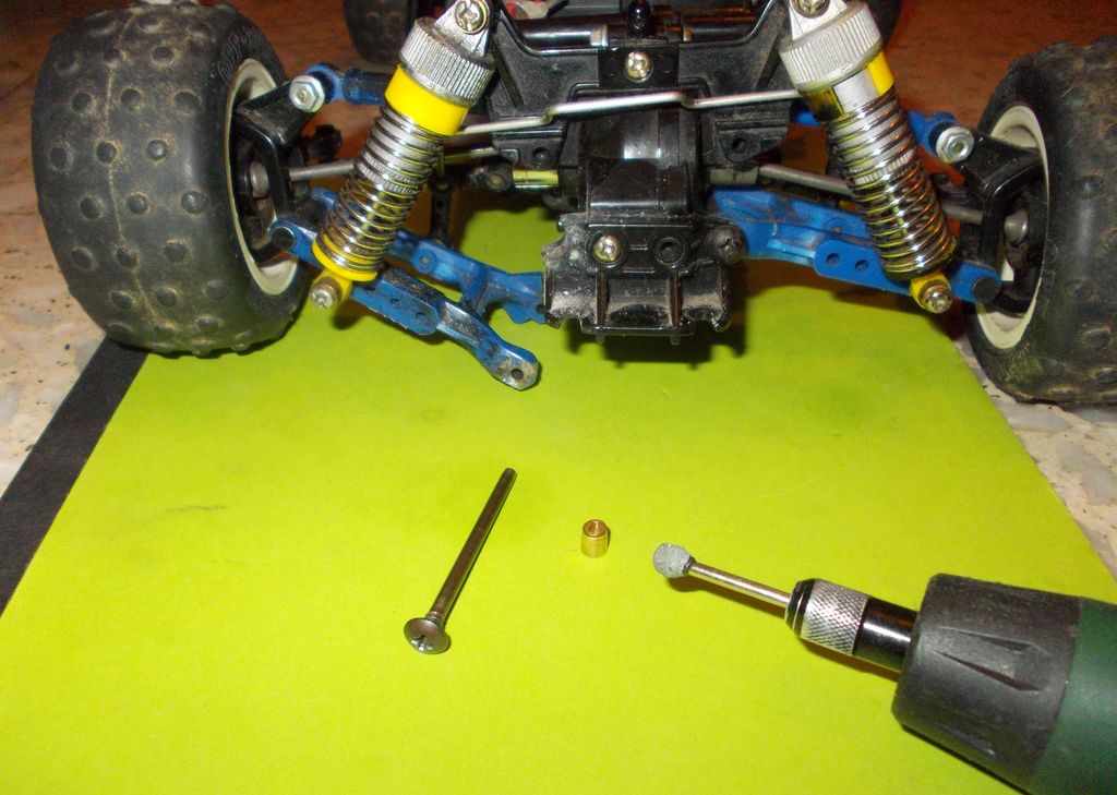

I also broke part A5 in my Terra Scorcher; in this way, solve it:
rebuild restoration Terra Scorcher
I put a bushing through which the screw enters (shaft). To do this, we clean and shape the size of the bushing with the Dremel drill machine and the sanding tip:
broken part terra scorcher
I put and paste the bush with cyanoacrylate to hold momentarily:
Then, fill with ABS plastic dissolved in acetone and let it harden.

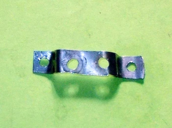

I made this piece with a metal sheet
metal part rebuilt terra scorcher
The piece provides a reinforcement and this works!

52 minutes ago, Baddon said:
I use these on my cars £10
My only problem with these is they are steel and I found the ruined the threads on the screw pins (2 outer long pins). I paid more and got the fully alloy A5 part but worth it not to ruin anymore screw pins.
Share this post
Link to post
Share on other sites
modelbuild's re-inforcement (as pictured) has always been fine with my screw pins, enough clearance (ive had dozens!) there is a seller that sells a silver coloured one where the screw pin holes are to small and need enlarging.......
Share this post
Link to post
Ah that's the problem!! Yeah I have the silver one. I'll have a look at drilling it out a bit
