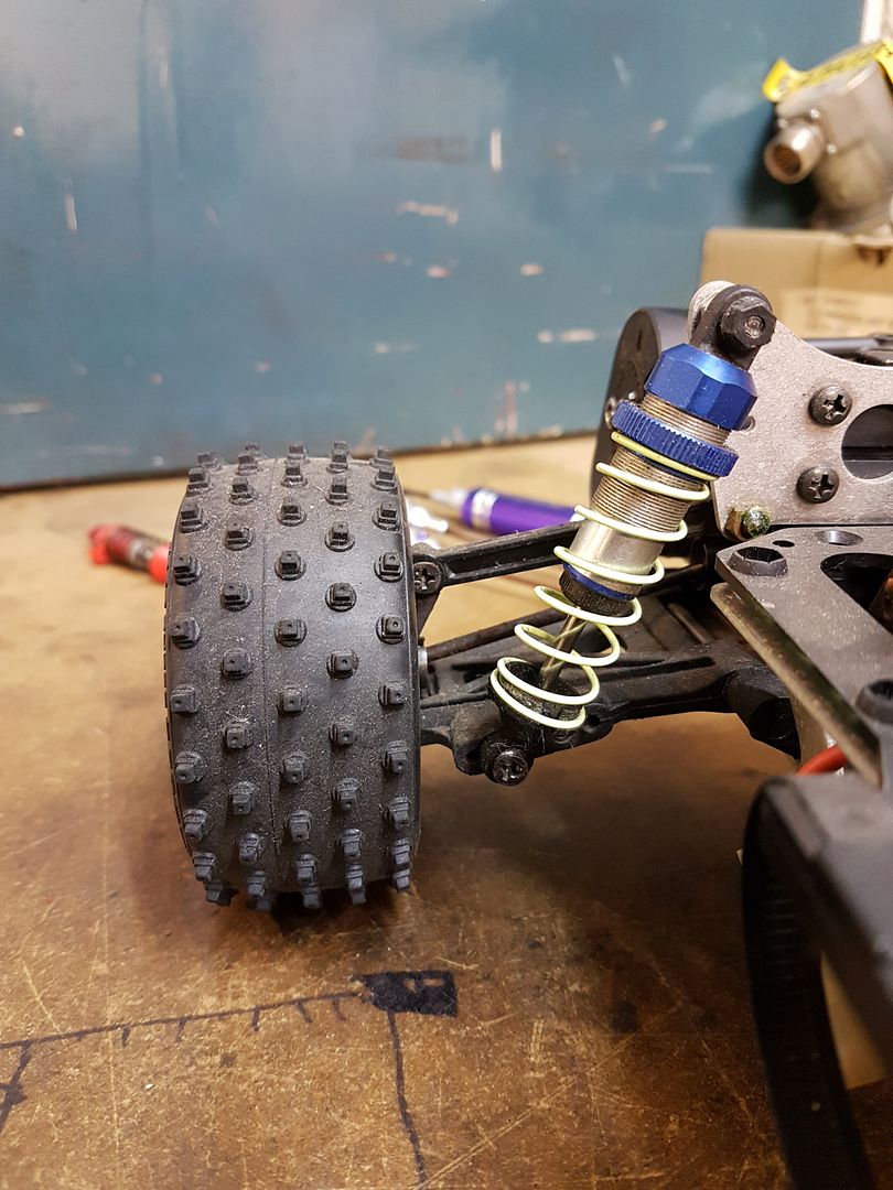

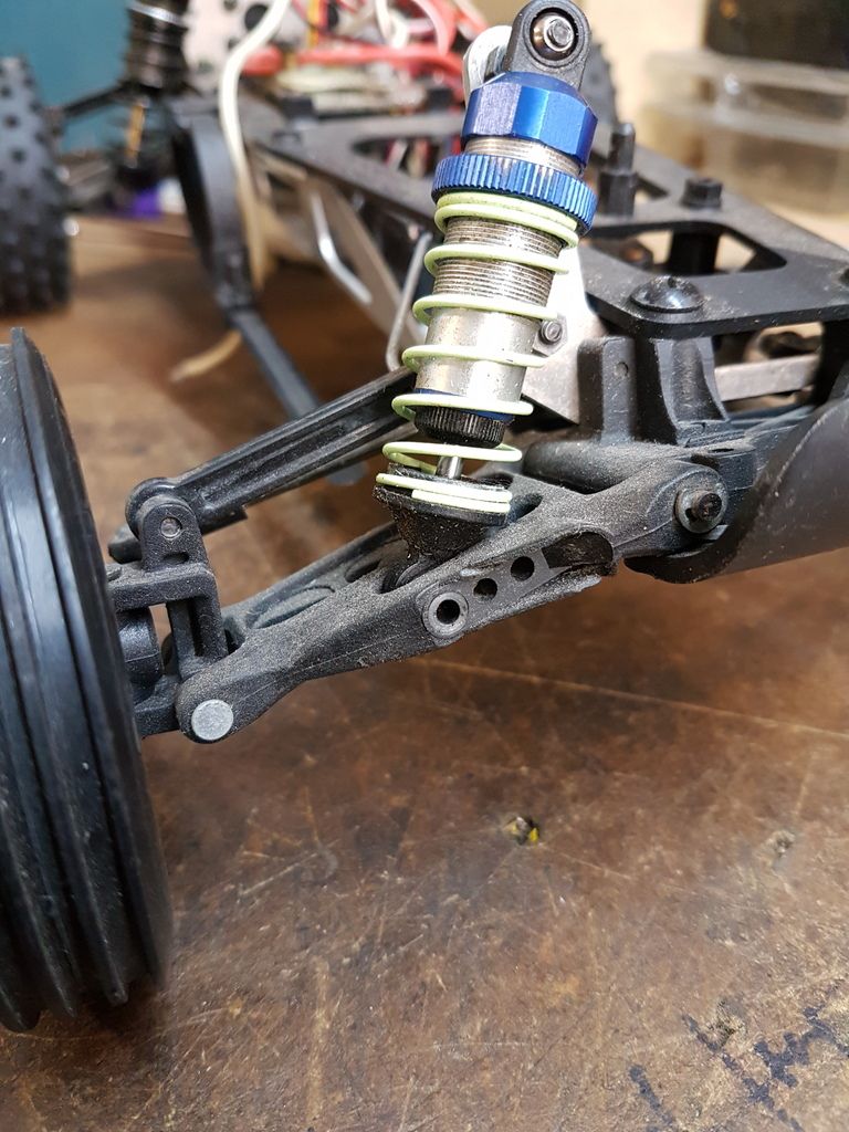

Wooders28 4703 Posted September 13, 2017 Managed to get a bit of time in work and happened to have bits and bobs in the boot so.... First tried the front Schumacher big bore shocks on the rear, Not bad tbh, On the front, not so good, very little actual suspension travel (but looking at the 'Ultima special' above, that's not alot either) Pulled a front shock from the RB5, tried on the rear, Looks like we have a winner, anodized red and black springs and that would look the business 👍 On the front, same story as the Schumacher's Just to show how times have changed, a more modern (RB5 is actually an old chassis now!) buggy front shock, is bigger than an old rear shock! Think I will dig out the spare shocks I've got for a Schumacher fusion and see how they fair. Next, RB5 gearbox, surely that'll fit? Maybe? May need to modify the shock tower to slot the front of the gearbox support in, but the gearbox won't move all the way forward as the motor hits the rear axle stopper plate. Meaning the driveshafts aren't the best angle. Not sure what to do re gearbox, still the slipper pinion and stock gearbox option or raise the RB5 gearbox 🤔 Share this post Link to post Share on other sites

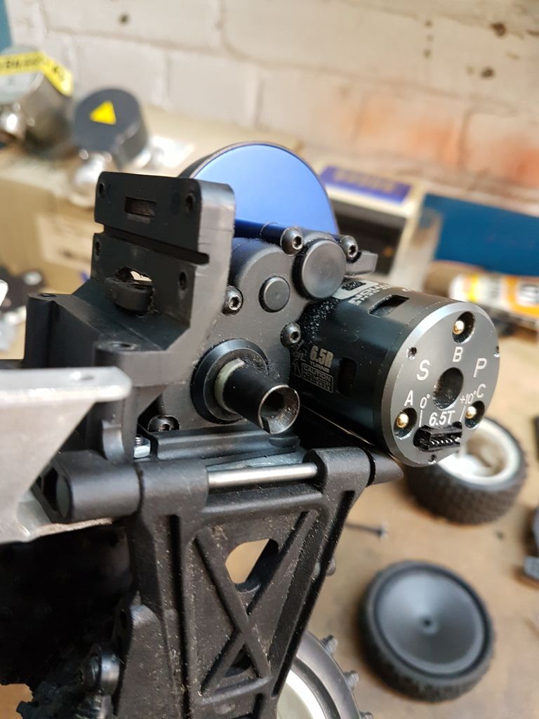

Wooders28 4703 Posted September 15, 2017 37 minutes ago, Champ85 said: But at some point, you're just making an RB5 out of parts. I plan on using as little as possible off the RB5, but not sure how much the stock gearbox will take, and would really like a slipper to stop the back flips with a 6.5t brushless motor, so there's the slipper pinion, but with only a small contact patch, my prove to be problematic! 1 Share this post Link to post Share on other sites

Wooders28 4703 Posted September 22, 2017 I want to race it, how comparative it'll be, I don't know, I'm not one just to have it look pretty on the shelf! Saying that, if it was full blown I want to win, I'd put longer arms on and 2.2" to get the benefit of fresh rubber, but that'll ruin it. 1 hour ago, Jonathon Gillham said: is there a wheelstand class in Scotland or something?! Its what ive got in my toy box! 🙄 I'm hoping I can get the RB5 box nailed on somehow, which will give me the slipper and ball diff, plus if i can get the weight further forward, I've a fighting chance of not shooting to the moon 🚀 1 Share this post Link to post Share on other sites
Percymon 2184 Posted September 22, 2017 Can you get a spacer plate under the gearbox to raise the unit and motor up enough for clearance ? Not exactly ideal moving centre of gravity upwards but if it means going forward 15mm then it might be a price worth paying. 1 Share this post Link to post Share on other sites
Wooders28 4703 Posted September 22, 2017 That's an option,and as the RB5 box isn't flat at the bottom, maybe a good one. I may trim a bit off the wishbone to enable that to move back a bit too, reduce the strength a bit though, but I'm sure I've seen aluminium arms somewhere, which painted/anodized black may work. Share this post Link to post Share on other sites

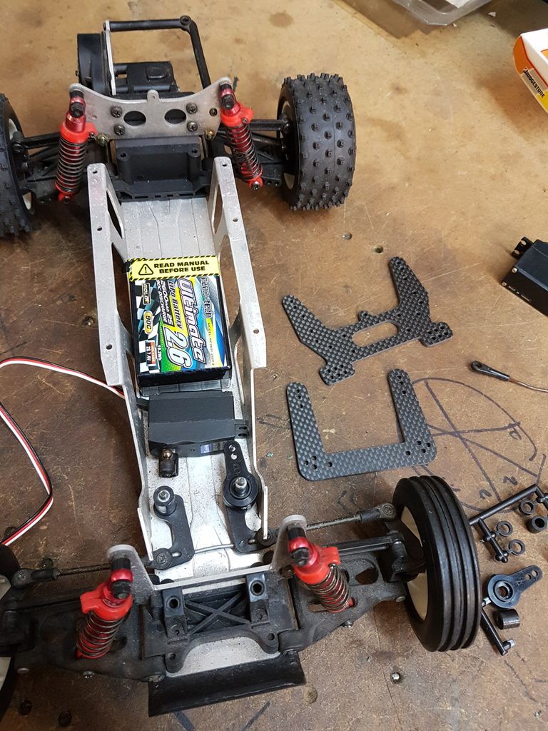

Wooders28 4703 Posted September 30, 2017 Bit of progress! Found a servo horn with the lug in the correct orientation, to enable a low pro servo to sit width way, need to cut the lugs off and use servo/ reg plate tape to hold it in position, going to use the RB5 linkage. Got the new carbon shock towers fitted, and tried the Schumacher big bore shocks, and I don't know what you guys think, but i dont like them,(look wise, fantastic shocks though) I think the RB5 shocks look more at home? (Need anodized cherry red though) One downside of the (ultima pro) carbon towers, is too much neg camber, so I'm going to have to either drill a hole on the shock tower further in, or fit adjustable turnbuckle. Decided to go for the spacer option, to lift the RB5 gearbox slightly, to get it to not obstruct anything and looking for something suitable 🤔 So I quick chop, and the original (actually a new spare), gearbox plate from the RB5 is getting utilised, it'll sit flat and gives a template for bolt holes too! 👍 Wth a little modification to the shock mount, Plus a few new holes in the chassis It fits!!! 👍😀😎 With the driveshafts lining up much better, The only issue, is that , with the RB5 gearbox being thinner, the driveshafts are too short, and fall out, 😔 So, out of interest, tried the RB5 ones, they fit!??! 😎 (Need to get a spacer to move the UJ in board to stop it catching, but thatll be enough to take the slack out too) Sitting low at the rear, I'm hoping that's because of no radio gear or lipo fitted, something that can be sorted out later. So that's were I am upto. A modernised Ultima, or a retro-fied RB5????? 🤔 2 Share this post Link to post Share on other sites

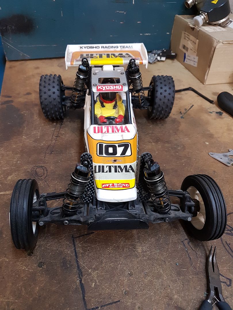

Wooders28 4703 Posted October 1, 2017 Managed to get a bit of a chance to get a servo and elecs nailed in , slipper set and take it for a spin! 😁 Need to fettle the servo position and re think the linkage, but I'm happy,she's alive!! 2 Share this post Link to post Share on other sites
Jonathon Gillham 4595 Posted October 1, 2017 Hard to say whether thats a modernise early one or retro rb5...looks quick tho! I like the old style too, so definitely an improved rb5 if it counts as rb5 1 Share this post Link to post Share on other sites
