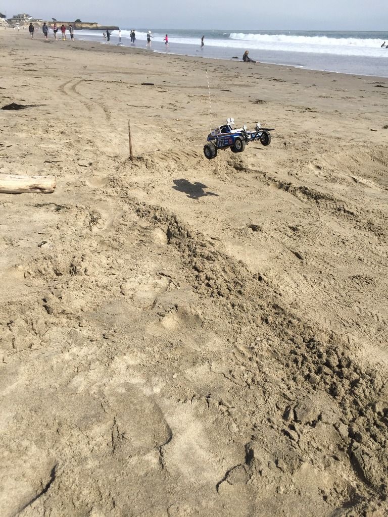

Rubber shielded bearings would be the best choice but I’ve not had any problems with the metal shielded bearings on my Rough Rider
FF7A26AD-E04C-4FB7-AC3B-6B2B49FFCA55_zps
