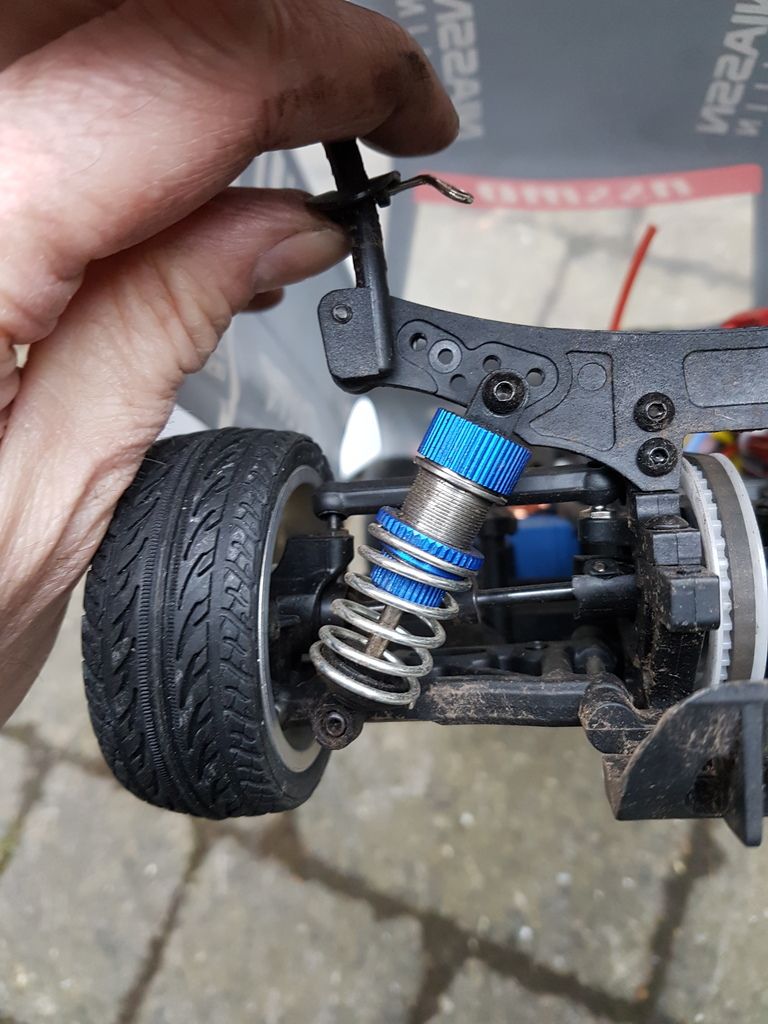

10mm is just about ok I guess, is there any room to increase it by playing with the shock mounts maybe, One photo shows the shock collar wound down to give more ride height already... I know for drifting low is good as you only use a flat surface anyway but for a road car used outdoors in a car park I'd want more ride height to stop it bouncing off stones and debris.
I'll have a play about and see what it'll raise upto, there's some options on the shock towers, and at £2.50, could drill new holes.
https://hobbyking.com/en_us/shock-tower-set-f-r-1-10-hobbyking-mission-d-4wd-gtr-drift-car.html
There's also alloy upgrades, maybe more options with those?
https://hobbyking.com/en_us/alu-front-shock-stay-1-10-hobbyking-mission-d-4wd.html
Not really, maybe claw a mil moving to a different position, putting on longer shocks would lift it, but would pull the driveshafts out a bit, and I'm guessing they'll then fall out every couple of revolutions!!
