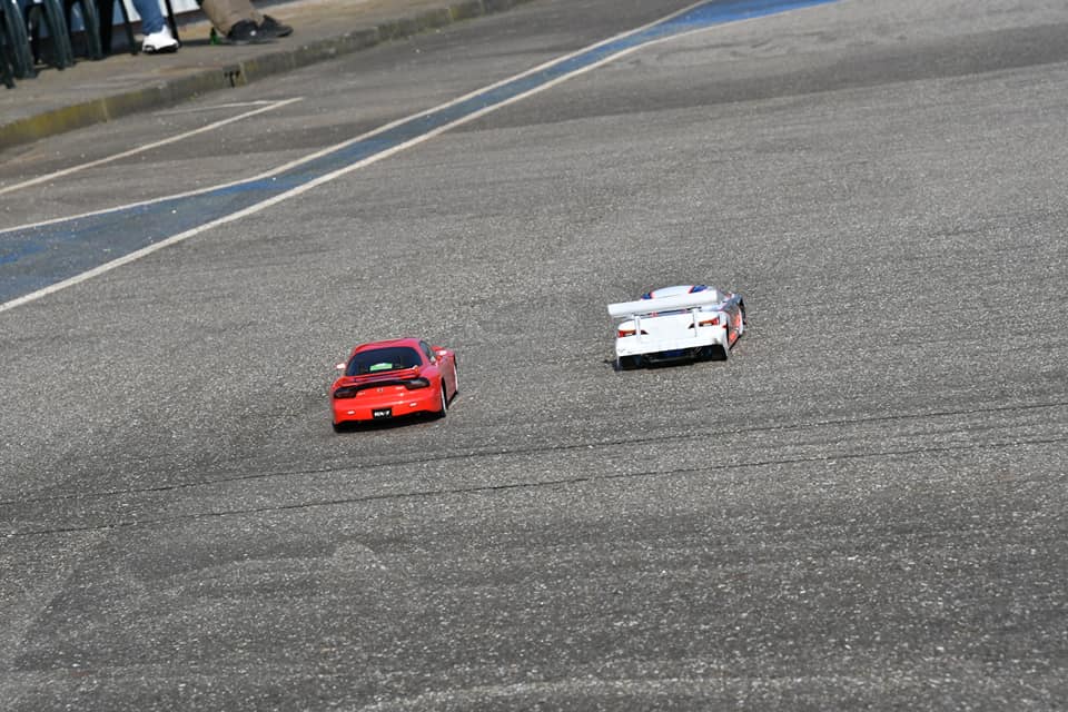

So, my indoor track folded (Boo!) and I had to go and find another club to race at. There's an outdoor track about 20 km from my house, but I never gave it much thought as I simply don't really like running outdoors. However, with the weather improving and..well.. you get the key to the gate so you can run whenever you please, I figured I'd sign up there and give their club comp a try.

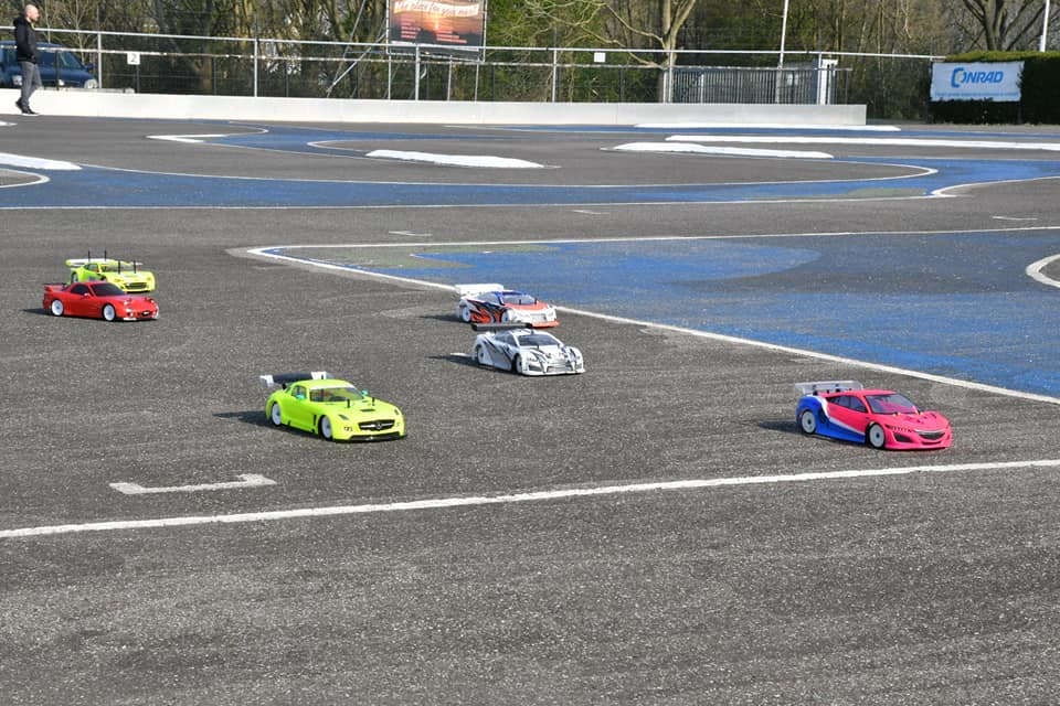

56466308-2615619465146353-58464358111882
Note the red RX7 in the background. I was the only 01E there, the rest being either 02R or 02RRs, so I figured I didn't really stand a chance. What I didn't take into account is how well set-up my car is, and years of indoor racing have made me a rather precise driver. I'm not fast, I just don't crash. Slow and steady wins the race....
...literally.
I showed up, and during Q1 I just sorta followed other people around, trying to work out the racing line. Once I got a bit of track knowledge going I upped the speed and started getting into it. This lead to me being second in Q2 and first in Q3. Having set the  overall fastest 3 consecutive laps (again, I am really consistent) I got TQ for the first final.
The first final was shaping up to be a close battle between me and another member from my old indoor track, but a backmarker took him out in the latter part of the race and..well, I had another backmarker on my 6 so I couldn't hang back and wait for him.
The second (of 2) finals went a lot smoother, and after helping another member set-up his (brand spanking new) TT02RR I got a bit of a fair fight going with all 3 of us changing 1-2-3 out for the most part of the race. Eventually I ended up in first after a tangle with a backmarker that involved all 3 of us, and took the win.

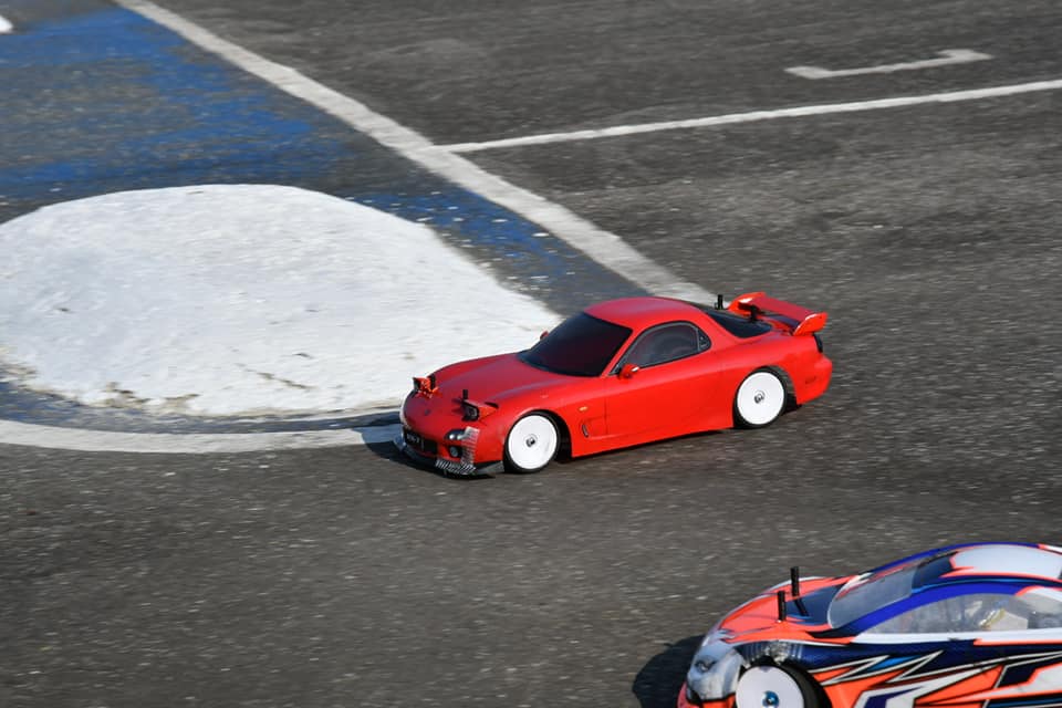

56400500-2615619585146341-90889833476815
The tape on the nose is the result of 6 months of racing, a few indoor scrapes and bruises, and one head-on collision with a Traxxas. Don't ask. Things got weird during an open track day. Other than that the RX7 held up nicely. I completely expected the headlights to fall off all the time, but they've been surprisingly durable. The light set, however, did take a bit of a beating with one of the front wheels rubbing through a wire, and another wire getting snagged and broken when I removed the body shell. As a precaution I've removed it. The first time in years (?) that I've had the TT running without low beams. :P
