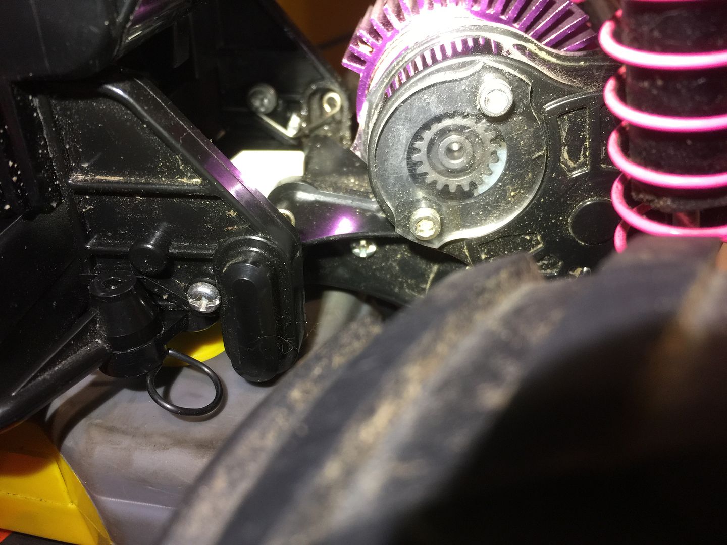

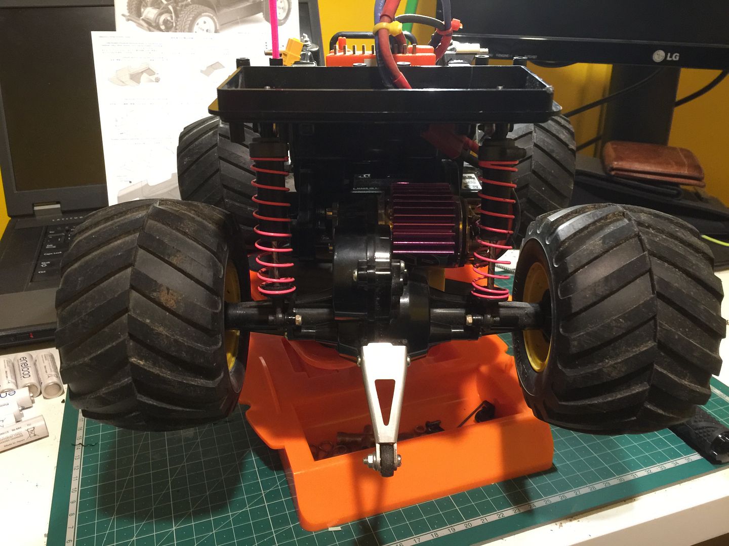

Not overly impressed with my Lunchbox at the mo and find the enjoyment of driving it less than it probably should be.
It’s got a wheelie bar, oil shocks and an AMPRO trans brace on it.
It wheelies way too much and becomes hugely unstable in a straight line. I’m looking for suggestions to make it put its power down better.
I fitted the trans brace earlier this evening and it has massively improved the axle control. But it still can’t put the power down. On wet mud/grass less than half throttle still results in it almost flipping over backwards.
And I haven’t been able to go above about half throttle even over a longer distance. As accelerating from a steady half throttle still results in trying to flip over backwards.
I’ll try and get a vid of it this weekend.

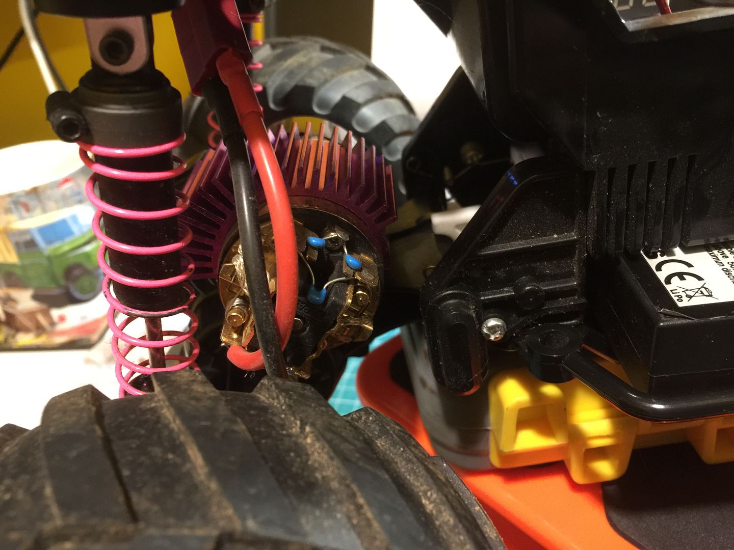

Setup wise. I’m running 2S LiPo’s with a Novak Tempest ESC. This is an old race ESC and can pull a lot of amps according to the spec sheet (420A). I have it paired with a brushed 13x3 race motor.
I fitted an adjustable motor mount and changed the pinion to suit the motor, although I forget what too.
The ESC has an adjustable initial amp dial which I’ve set to the minimum amount too.

Sorry if this has been previously shared as I didn't read every post. But when I want less wheelies on the CW01 chassis I simply flip over the stock wheelie bar. The normal way it wheelies just fine, upside down it keeps the front wheels planted a lot better. Its an old-school trick but it works beautifully.
Thanks for the tip. Haven’t run it again yet. Been to wet here and I don’t like getting them caked in mud.
Need to check what pinion is on there. It’s bigger than the stock one but can’t remember what I bought.
I did check the motor. It isn’t a 13 Triple in there. It’s a 12 Hex! Maybe I should revert back to the silvercan. But it always felt a little ‘toylike’ with that motor in it.
Mum also going to have a play with the expo settings on the Tx and see if I can profile the throttle curve a bit.
I’ve turned the wheelie bar upside down. And I’ve altered the throttle curve on the Tx. Sadly it got too dark to try it out today. But testing it on the bench it certainly seems a little less vicious.
Managed to check and it’s an 18 Tooth pinion on there at the mo.
Working the curve on your TX is also great option (I don't have that on my TX for the Pumpkin)! But I do like the idea of flipping the bar! I'm going to do that on mine now! So simple and never thought about that! Great Ideas guys!
Well I can report back that the changes have made a significant impact. Much more driveable.
