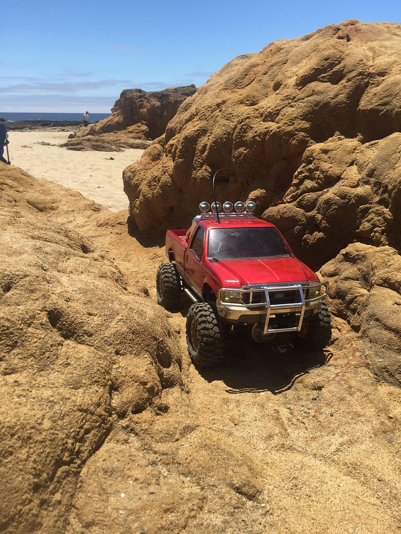

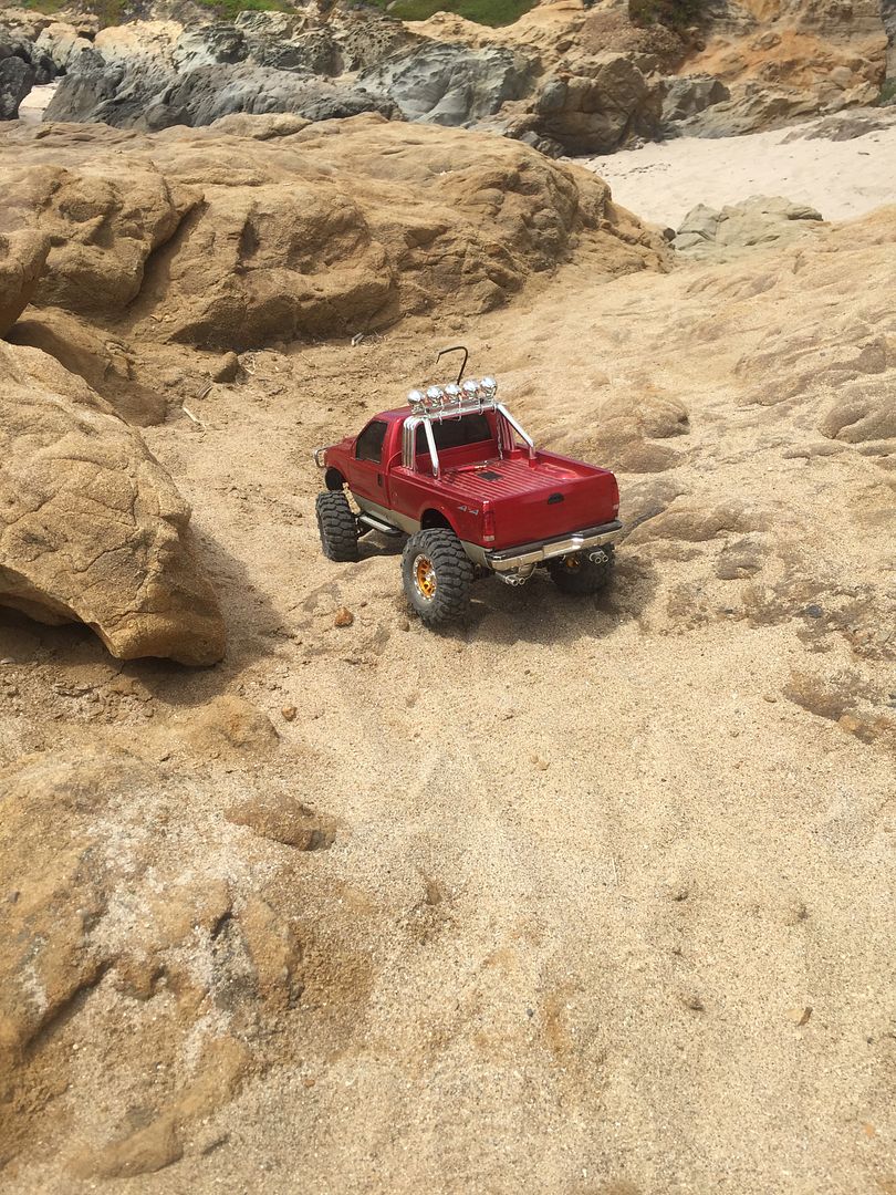

Shodog 1835 Posted April 17, 2018 I’d skip the 4ws. It will help it roll like crazy. I have a spare hilift with 4ws and body is toasted from rolling over so much. The drive is comparible to what a real truck could drive in. There are other far more capable chassis but this truck certainly checks the box as a good all around runner. I’ve taken mine to several places to run. The MFC definitely gets attention 1 Share this post Link to post Share on other sites
gizard 133 Posted April 17, 2018 Hi thanks for the response - is the one in the picture running the 4-link then I can't tell + what wheels and tyres? thanks Share this post Link to post Share on other sites

Shodog 1835 Posted April 17, 2018 3 hours ago, gizard said: Hi thanks for the response - is the one in the picture running the 4-link then I can't tell + what wheels and tyres? thanks This is running the stock leaf suspension. Wheels are Rc4wd beadlocks and the tires are Rc4wd rock crusher. The stock tires are hard and small in diameter. Slightly larger tires will give you more ground clearance. You don’t really need a shift gate as this tranny is smooth enough to shift under power Share this post Link to post Share on other sites
