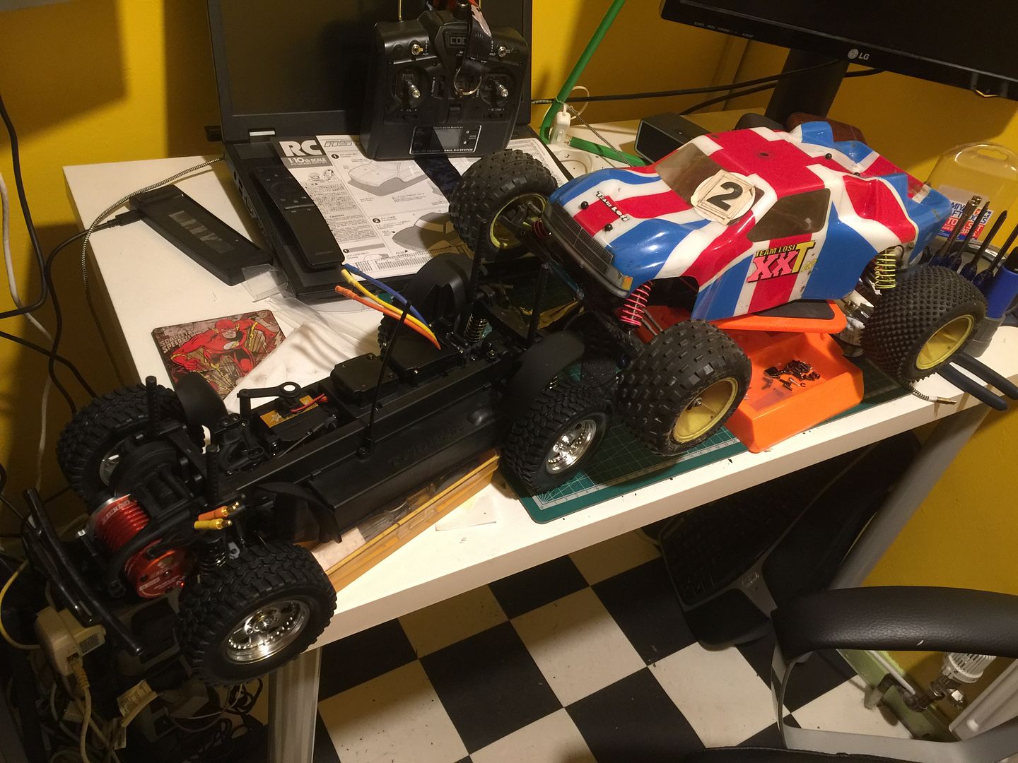

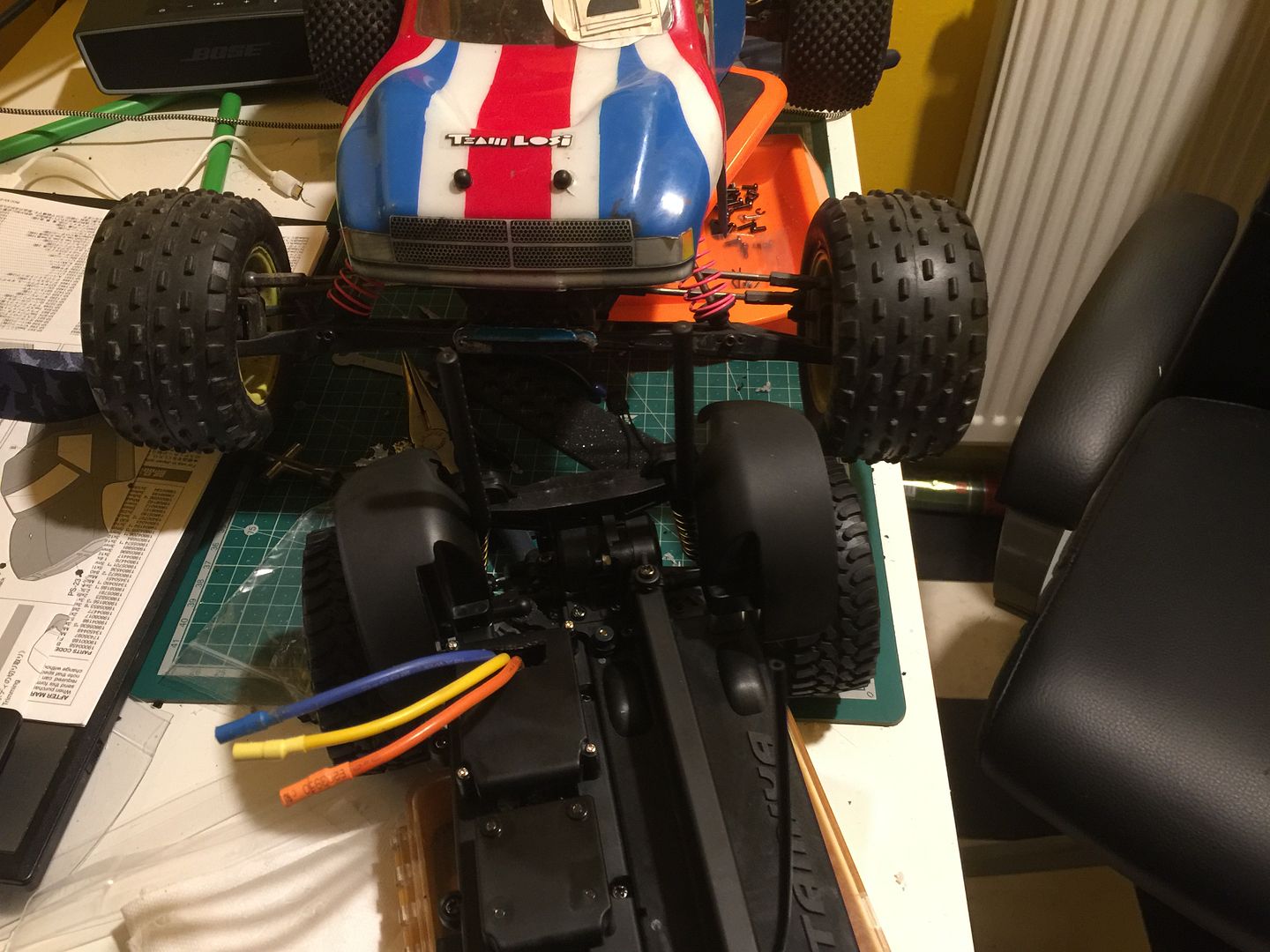

I have a 1/8th scale Porsche 959 (Carisma M48S). Which has much bigger wheels over a 1/10th. And while it can run on grass, it’s no where near as good as a 1/10th buggy on shortish grass.
As for Tamiya models. I bought the XV-01T which is the truck version of this chassis. Not run it yet. The tyres are the same size as the 1/8th Porsche and with similar ground clearance.
I’m looking forward to running it. But harder dustier surfaces are likely to be its home terrain as opposed to proper off roading.
Look how small it is compared to a 1/10th stadium:

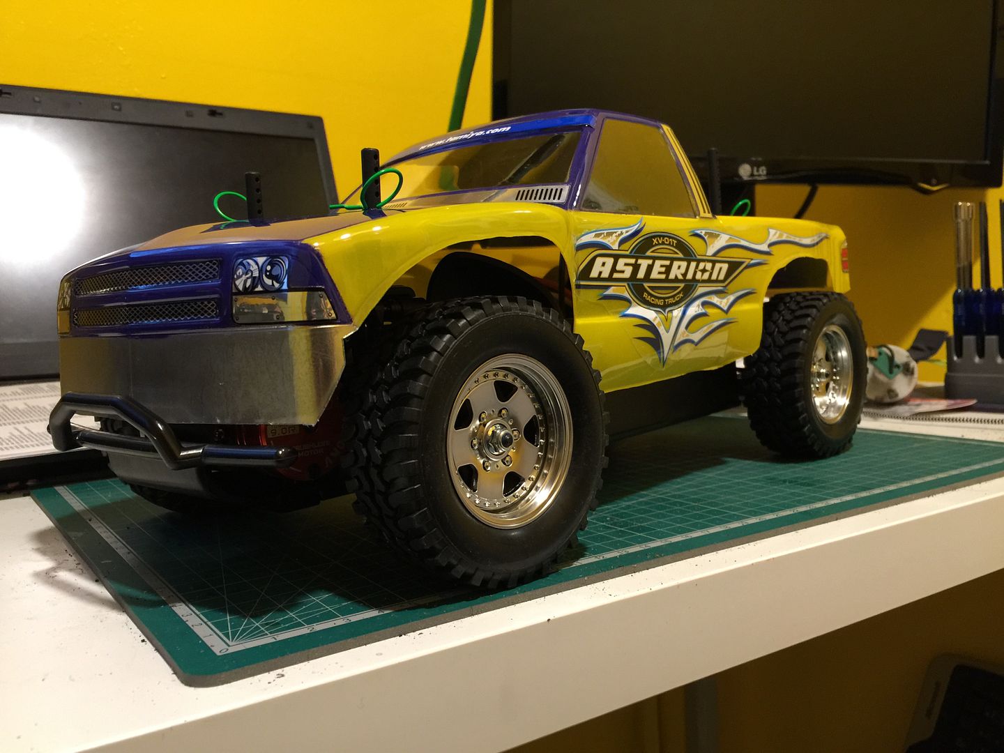

I bought the Asterion as my garden (where it will be mainly used) has some rougher terrain and bigger wheels give a little more clearance).
