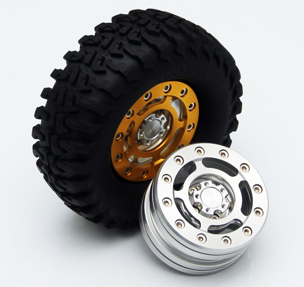

Those beadlock wheels don't work.
You could get some axle extenders:-
but then you'll cause even more body clearance issues. Your call.

I already buy this wheel.... I read in description that are compatible with cc01 but it isn't true. I have just ask a refound.
For extender, yes I buy it! They will arrive...
Why? You are telling to me that the tyre will ho out from the wheel anyway?

The beadlock wheels you received... with the beadlock ring on the inside fouling the suspension/knuckle its not made for CC01 definitely. It way work on other trucks/crawlers maybe.
Some crawlers can use smaller wheels of 1.5" rim diameter, but these won't work on CC01. Many "steel" style wheels come in this smaller 1.5" size with thick tyre sidewalls.
With CC01 we need "touring car" wheelsize of 1.9" diameter (24-26mm wide).
Many of these are glue-on type of wheel; but there are some beadlocks that clamp with the ring on the outside too.
Hi, my beadlock have ring inside and outside. I hope they will work right when will arrive the offset for wheel!
I have glued only my big tyre. The tyre with beadlock I have NO glued.. in your opinion I must glue it too? I suppose the tyre didn't go out from wheel but maybe the tyre can slip around wheel without glue...

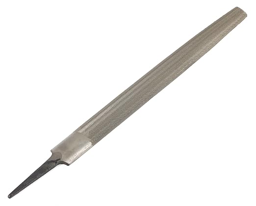

My wheels were like that, I just removed the metal tabs with the sanding drum attachment on the dermel, it took a couple of of sanding attachements but it all came off fine & has be working fine for the last couple of years.
Hi thanks for your answer.
Sorry but I don't understand what is it "sanding drum attachements" can you explain? Sorry

ahhhhh!
Ok!!! It is one kind of attachment to the dremel!!! now I understand! ahah
