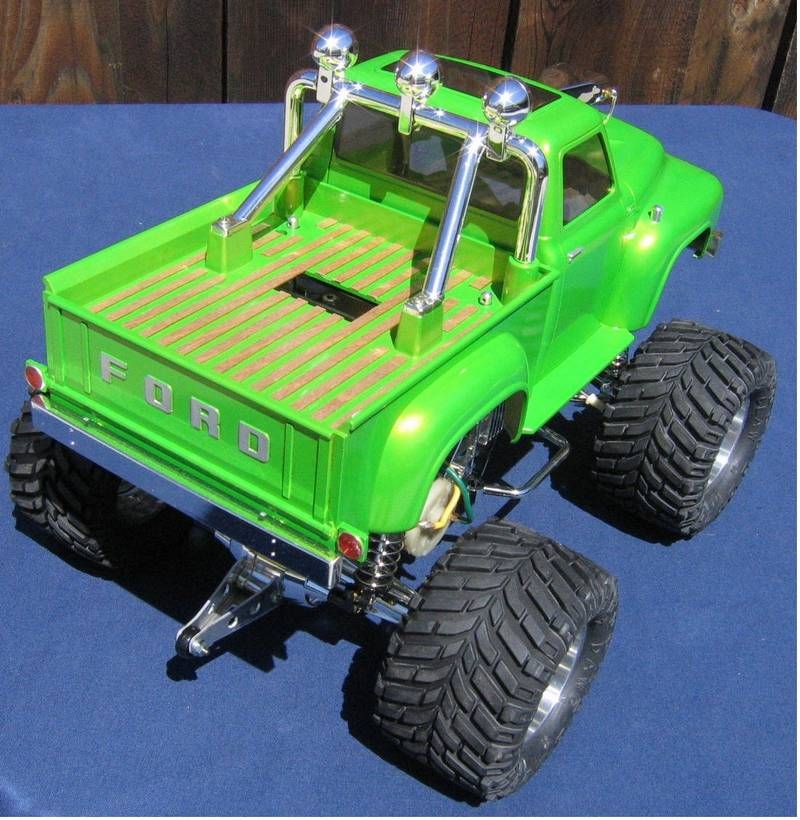

Looking for suggestions on putting a wood bed in the BRAT - I was thinking of just using balsa, but wondered if anyone has done this, with anything else?   Pics, suggestions etc appreciated.
If you want to cover the whole bed (rather than just the raised ribs like topforcein did, where strips of balsa wood are ideal), then perhaps consider 1:12 scale 'dolls house' flooring - an example here on eBay: https://www.ebay.co.uk/itm/1-12-Dolls-house-Miniature-Real-Wood-strip-floor-boards-Flooring-Sheet-DIY-LGW/391990078486?hash=item5b446dec16:g:rMcAAOSwKIpWDkQP

Really nice!  I will probably go this route.  Thanks!
I put a sheet of 1mm ply in my Pumpkin, lightly oiled it to bring the grain out.  The plan was to add thin metal strips (or tape) to make it look like proper slatted bed, but, erm, I never got round to it... :(

That looks lovely Stroker'!
A suggestion here would be to simply score a series of parallel lines in the ply with a bradawl point along a metal ruler edge to form the 'planks' then put a light wash in the creases to highlight the gaps.
note. If you were lazy you could probably just use a black ball-point pen instead of a bradawl and you'd do both jobs in one ;o)

Good idea(s).  Funny how all my builds always still have a job or two remaining on the 'to-do' list...
On my pumpkin I cut and glued thin strips of mahogany veneer.  Once clear coat gave it a deep rich look

Just a quick update to this thread - inspired by the suggestions above, I finally incorporated my own wooden load-bay bed in the YJ Wrangler recently:
More details and photos in my Daydream B'leafer build thread starting here:
Hope that helps!
Jenny x
Try Mc Donald's stirrers but draw down the edges with black felt tip before glueing down. Old boat builders trick + the wood is free. May need a little bit of stain  run rub down well and semi gloss( satin)  varnish.
