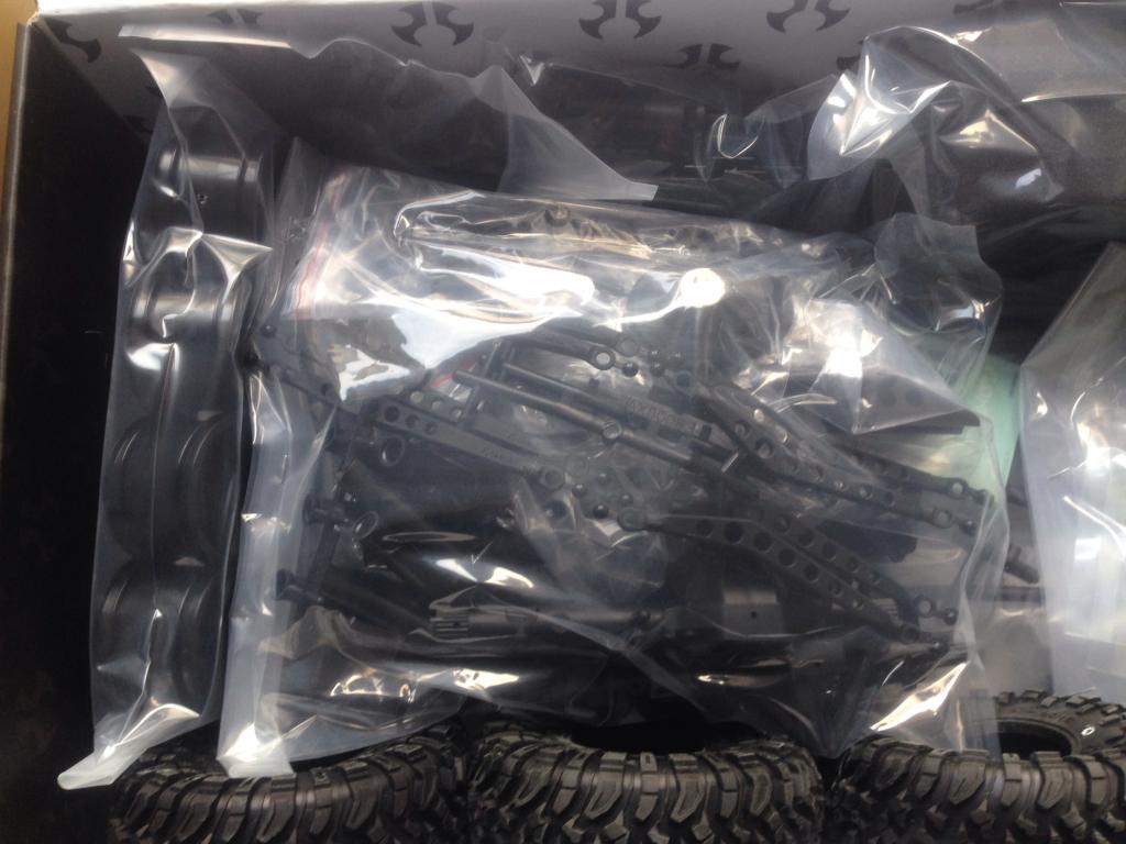

I've only built one, a Wraith that i added Vanquish hop-up parts to during the build and that was ca 5-6 years ago.  All parts were well packaged and clearly labelled, the plastic felt more robust than the run of the mill Tamiya kits (more like the carbon reinforced Tamiya parts).  No issues with the build manual or the build itself.  Opening the kit box was a little underwhelming..

but its pretty much the same with recent Tamiya kits and Gmade.
