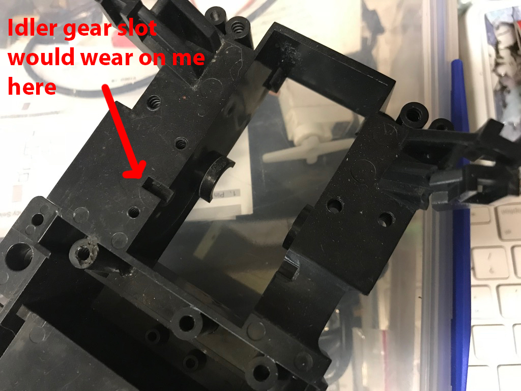

Yalson 514 Posted May 19, 2018 17 hours ago, yogi-bear said: I had a Marui Galaxy as a kid and loved it. My own biased opinion is that the Marui setup is better. I only really had two issues when running my car as a teenager, the mounts at the rear for the shock was prone to breaking and the where the idler gear sits in the chassis would wear out. Parts for at least the Grass Hopper should be readily available. Pictures would be great 😀 Thanks yogi. Just to clarify, when you talk about the 'Marui setup', do you mean the Hunter or the Galaxy, as they are both Marui cars? I presume you mean the mounts for the shock on a Hunter. Would putting the Galaxy shocks on the Hunter cure this? I can do pictures. Do you want them now or after the rebuilds? Share this post Link to post Share on other sites
yogi-bear 2321 Posted May 20, 2018 3 hours ago, Yalson said: Thanks yogi. Just to clarify, when you talk about the 'Marui setup', do you mean the Hunter or the Galaxy, as they are both Marui cars? oops, I meant the Galaxy. I think there is the same issue on the Fox with the mono shock at the front and hotshot with the mono shock at the back. You get a better suspension setup when its dual and independent. 3 hours ago, Yalson said: I presume you mean the mounts for the shock on a Hunter. Would putting the Galaxy shocks on the Hunter cure this? Both the Hunter and Galaxy use the same shock mount to the chassis, so they both have the same problem. When I get a chance I'll take some pics, but that might be a day or so. 3 hours ago, Yalson said: I can do pictures. Do you want them now or after the rebuilds? either, I just like to see pics 😀 Share this post Link to post Share on other sites

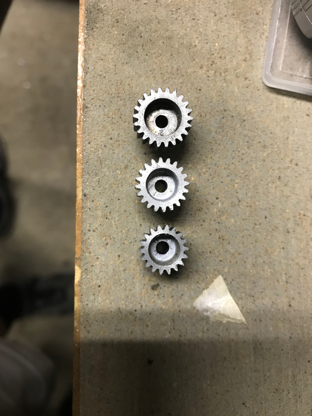

yogi-bear 2321 Posted May 24, 2018 apologies for the delay, these are the 3 pinion gears. I don't know the pitch and was going to measure and work it out, but I haven't had anytime this week. If you need some I am happy to send you a set. This is where there shock tower can break. I don't recall it ever happening to me, but a number of restoration projects I've bought had this issue. The Hunter and Galaxy share the same chassis, only the colour is different. This issue happened to me at least twice, the idler gear shaft would wear out the socket it sits in, causing the gear to skip. I'd often repair with epoxy resin, but it eventually I'd just get another chassis. Apart from that, the Galaxy was a fun car to drive, very stable and not bouncy. My only regret is not taking any pics of it. Share this post Link to post Share on other sites

Yalson 514 Posted June 6, 2018 7 hours ago, Static Age said: You can buy a spur gear on shapeways that has bearing recesses. I've been using one for a while & its holding up well. Regarding the pinion, I'm sure they are 0.6 mod. Hey Static, is this the gear you are referring to? https://www.shapeways.com/product/XQXJRV5N4/hunter-galaxy-idler-gear-20t-48t-for-ball-bearing I would be glad if they were .6 Module as that was what the Optima Mid originally used and I have loads of them. Share this post Link to post Share on other sites
Static Age 65 Posted June 7, 2018 That's the spur gear. As I said its held up to a fair few runs so far which is more than I can say for the stock spur. I'm pretty sure that they are 0.6 mod, same as the tamiya sand scorcher. I'm using the 19 tooth pinion, seems spot on for decent acceleration & a good turn of speed. These old hunters are a little fragile & spares are not easy to come buy so you only want to go so fast with it. Handling isn't the best although it is slightly better than some entry level buggies from the era. Not to bad off road but they understeer very badly on tarmac as the front end is very light. Share this post Link to post Share on other sites
