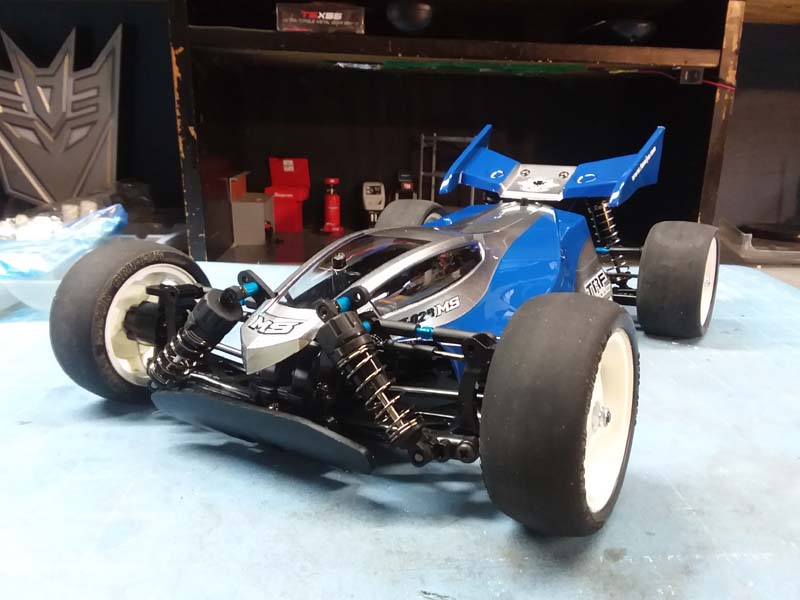

Finally got the chance to run this build. Whilst all of the doom and gloom and Planet Lockdown is very much present in our minds, one minor silver lining is that there is a totally empty, smooth and level car park 5mins walk from my house. Unbelievable!
An actually empty car park..... Never seen one before with my own eyes, outside of those mythical empty car parks you see in the US on YouTube videos. Wow.
Formula NeoScorcher
Anyway I can report it ran really well. Super precise, the stiffened suspension worked really well. I was concerned about the low ride height but there is very little chassis contact with the road at all - there are some scratches but I think this is from when it ran over a small rain grating depression in the asphalt.
The 10.5 motor really flies,  the grip off the line is very immediate. I suspect it understeers on power at full speed, at mid speeds it’s pretty arrow sharp, quite pointy feeling. I am itching to spend more time with it to learn its characteristics. Feels like I’d like the rear to slide slightly to counteract the front understeer at higher speeds
The Proline tyres held up very well, whilst the asphalt is pretty level and smooth topographically, the aggregate is slightly course.  I was worried the wheels would slip inside the tyre but these held firm.
I had to play a bit with the steering trim just to set it up on the day. It was tracking a little to one side.

edit: @Munkeyfeet yes I think it was orange then silver with a black backer. The orange  was a metallic Orange from the standard tamiya PS paint range.  Not sure how you might replicate the look in pink although there probably is a metallic pink somewhere for polycarbonate.

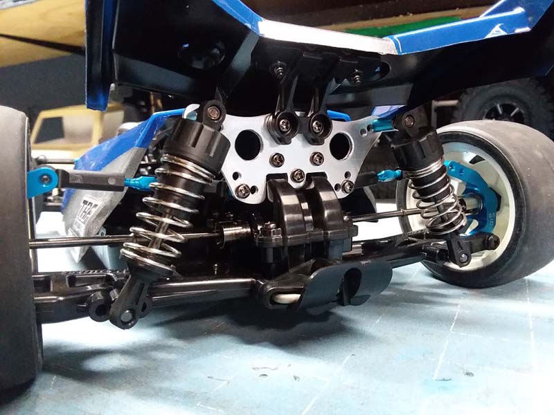

Hope you are well, firstly what a build your formula scorcher is, its that good im just starting my on version of it :).... i bet you get asked this a million times but would it be possible for you to send me the shock tower designs over, i have spoke to fibrelyte who they said with your permission i can have some made which would be awesome.

@ALEXKYRIAK I tried messaging you but I think your inbox is full. It says you can’t receive messages. If you still have the shock tower files and with your permission would I be able to get them so I can order a set from fiberlyte. I failed in spectacular fashion attempting to make my own from a carbon sheet and have modified a set from an old touring car to work for the time being but would really like a set like the ones you designed. Thanks.

@Apexape I have PMed you on the shock tower pieces. Let me know if you got it? Cleared my inbox a bit so messages can come through.
