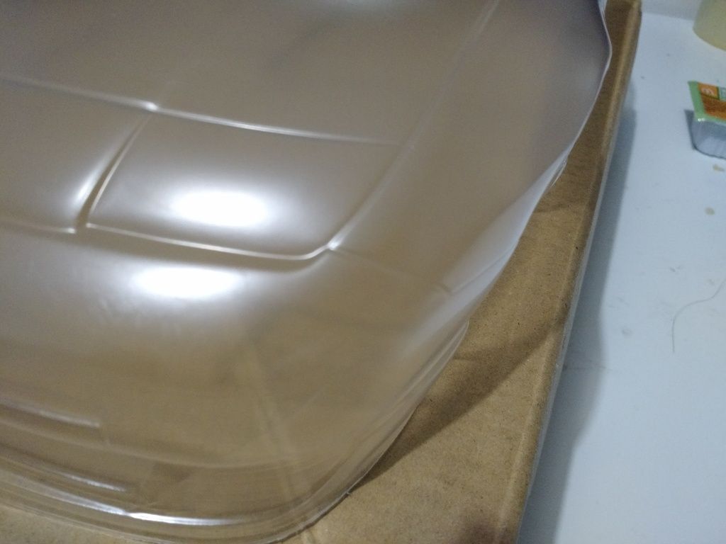

She wasn't paying attention and sat on a brand new lexan body. The front left guard has a nice crease from the side marker light, over the edge of the wheel arch and all the way down to the edge of the front lip.
Is this body now ruined? Is there anyway to remove the crease mark? Whats worse is the crease line goes straight through 2 very smooth areas which has a very gentle radius. I'm worried this will catch the light and just look disgustingly obvious...
I really hope there is a simple old trick out there that I dont know about. Just add hot water and it will spring back to its original shape from some special memory? Its a long shot lol.
Maybe a positive, but the lexan is only 0.25mm thick which is about half the thickness of all my other bodies. I'm hoping it will be easier to rework...
I've had a few hard hits with some of my Lexan bodied bashers and once its creased there's no going back, its not like having a crack and using a spare piece of lexan and backing it with shoegoo
I just spent the last 30 minutes under running scolding hot water trying to work it out with my fingers. Managed to bend it back slightly but cant get that darn crease out :(
Looks like this will become my practice body :( I'll have to order a new one... $100... :(
Now wife is peeved because I yelled at her... She's lucky it wasn't my full scale 300zx... instant divorce lol
In a last ditch effort to try and at least make it less noticeable, I thought I'd try my hot air smd soldering rework station. Now I tried to be careful and go slow... So I first tried 150 deg C but it didn't do anything. I then bumped it up to 190C. Good news is it healed the crease like magic, bad news is the once nice smooth radius now feels a bit like mild cellulitis. Might look worse when painted. Who knows.
So just a note to anyone thinking of trying this: Don't go as high as 190C and use the finest tip you can. Evenly heating it is not ideal. Controlled focus of heat is what you want. Having said that, for thicker lexan (0.5mm), you might need more heat, but I'm not sure. All I can say is it softens at lower temperatures than you'd think, so next time I'll be bumping up the temp by 10 deg C increments.
So I've accepted I need to get a new body anyway. Just wanted to try it as I have another body with a similar problem that I need to fix.
I tried it with a hairdryer once and it seemed to be going back into shape at first but it soon became clear the whole shell was turning into a lumpy mess and it was impossible to make smooth again.

Lexan is like really thin sheet metal in some ways -- once you've distorted it, there really isn't much chance you're going back to the original dimensions. You seem to have discovered that a little heat will make the plastic very malleable, but without a form or buck to guide it, you're just going to be creating lumpy blobs.
If the Lexan is not creased you can normally fix damage to good standard by delicately applying heat from a lighter.  When heated this way it actually wants to return to its moulded form not go into lumpy blobs :lol:
