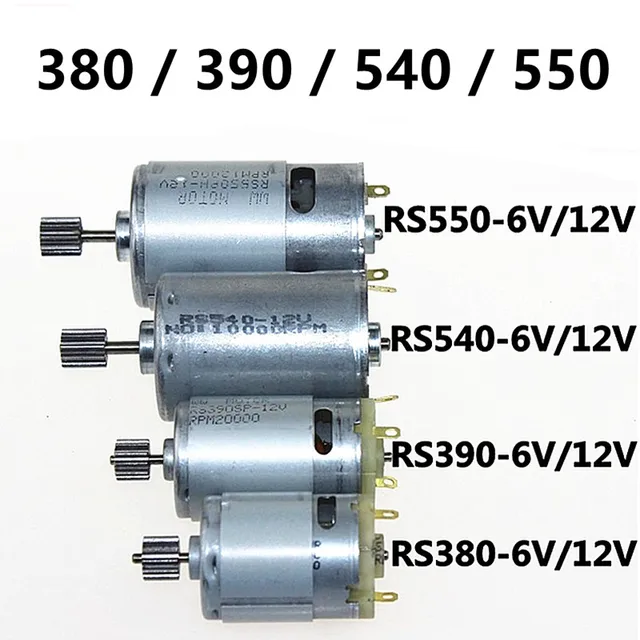

It could be an upgrade for Dancing Rider.  Or for 1/18th cars.  Or small electric airplanes.
The torque of a motor comes from the magnetic force between the magnets and the rotor.  Bigger cans have bigger rotors.  For one, bigger rotors give you longer leverage.  Even with the same exact force applied, an 8 inch wrench will just give you more torque than a 6 inch wrench.
Secondly, magnets are much bigger in 540 motors.  You can't do much about smaller magnets in a smaller can.  A smaller motor must take a lot more electricity to do the same work.  (I don't know, maybe a 13 turn 380 might do a little better than a silver can, but will drink more juice and will run much hotter)  A 380 motor just can't replace a 540 motor (unless it's brushless).  Even amongst brushless motors, a 540 sized brushless is stronger than a 380 sized brushless.
[Below diagrams are just re-sized.  You can see how big the magnets (in gray) get, and how much more leverage bigger rotor can have.]
Image result for 540 electric motor vs 380
Thanks Juggular-that basically confirmed what I was guessing all along. If a Sport Tuned 380 was a viable alternative to a 540, then a lot of folks would have been using them already. I saw this product and quickly became curious.
