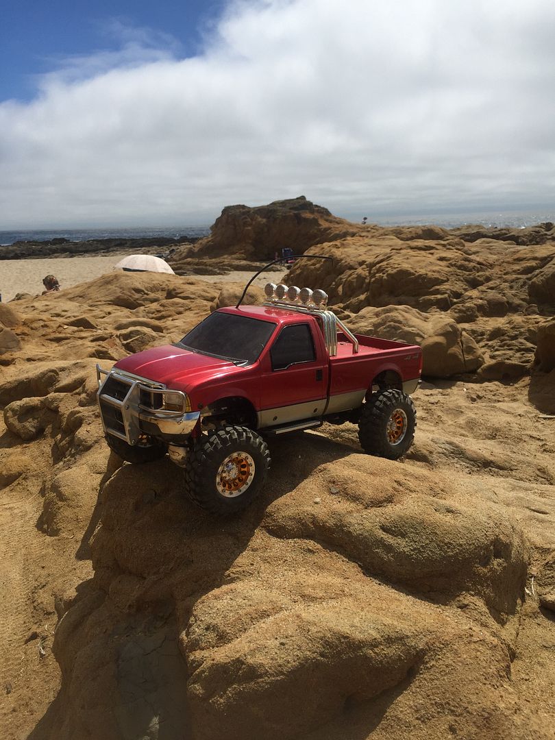

I’ve been getting more into the crawler scene lately.  My son has a couple of crawler rigs and after running my F350 Hilift along side of the SCX10II I bought him last Christmas, I realized I needed something more nimble.

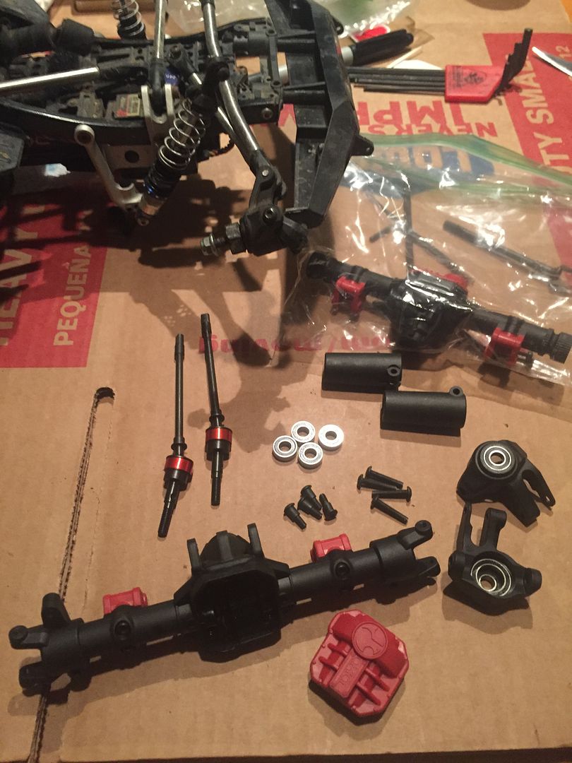

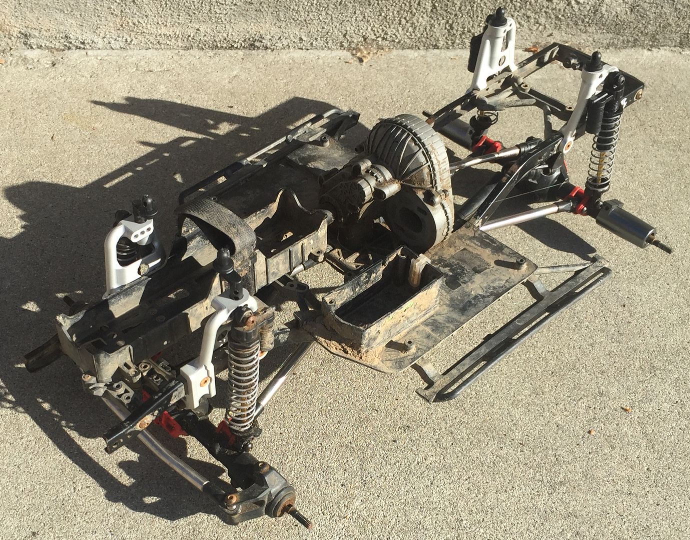

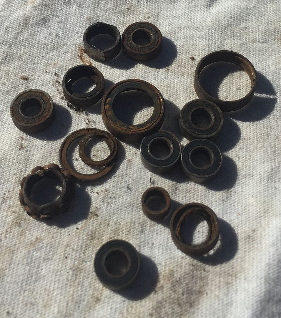

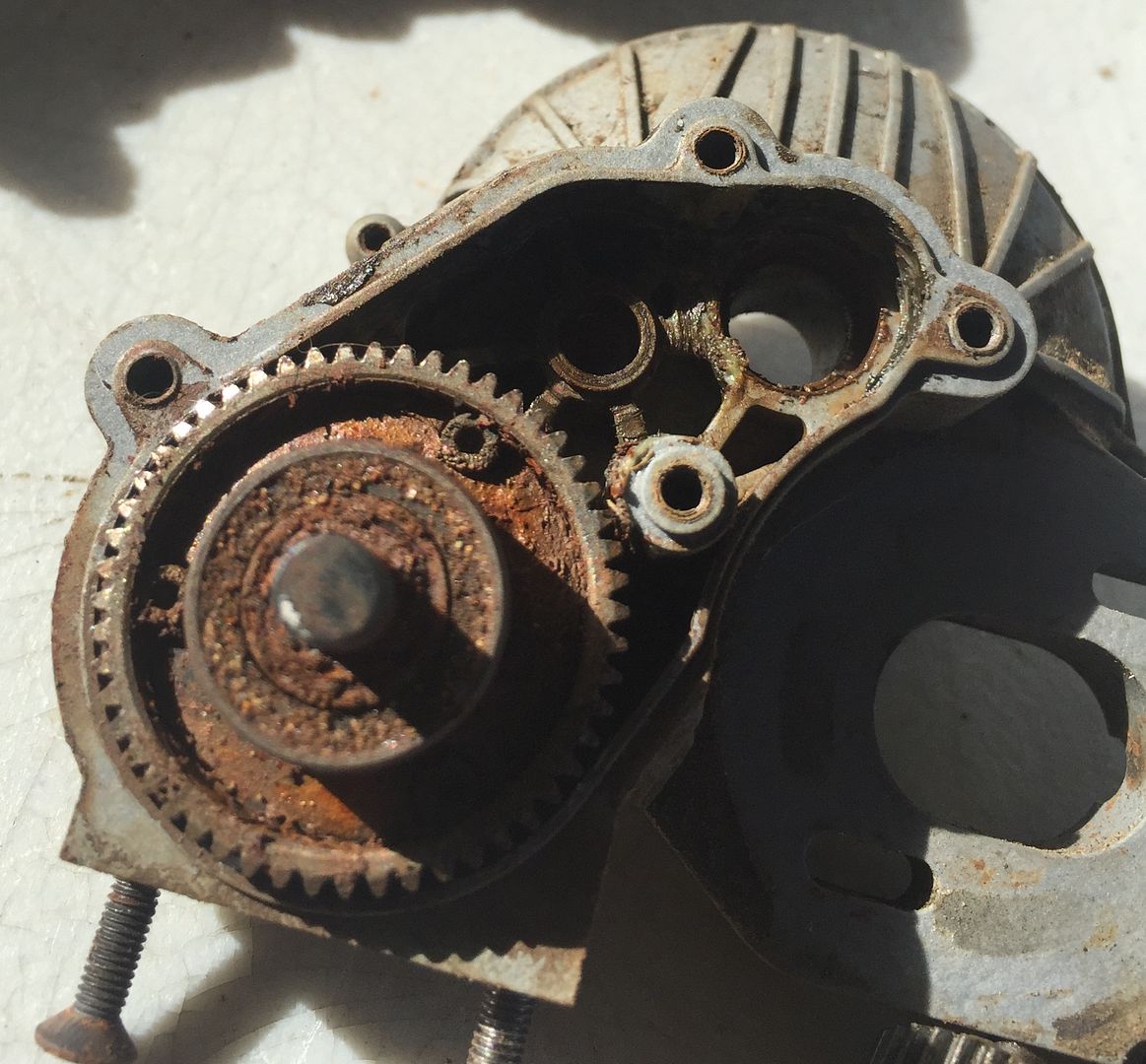

I bought a dirt cheap used SCX10II chassis from a friend that was fairly beat.  He ran it through mud and water then left it to sit. I had to replace all the bearings and clear off most of the rust.  I’ve restored 35 year old cars that were in better condition than this year old truck.

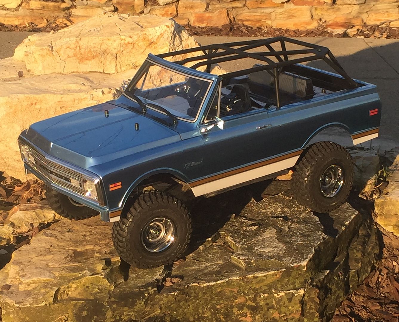

All clean and back together.  I used a Futaba 2.4ghz receiver, Hitec 7950 servo and a castle mamba X motor system. Chassis has vanquish shock mounts and links.  Rc4wd Dick Cepek aluminum wheels with Proline Hyrax tires
67C63FF9-EB1B-42D2-90F3-12F3E236D586_zps

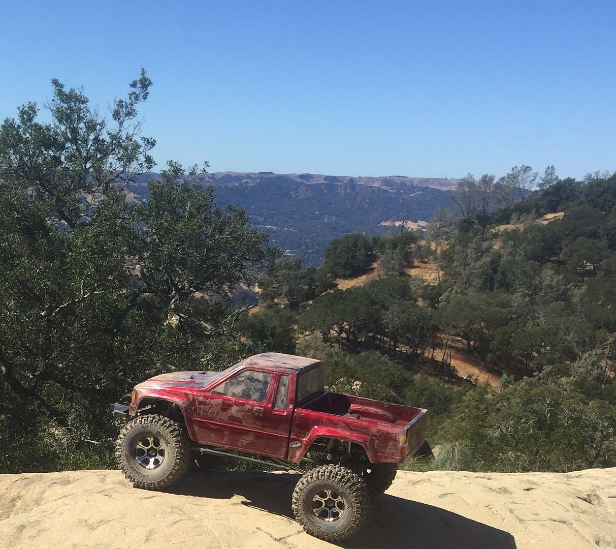

It climbs like a little Billie goat.

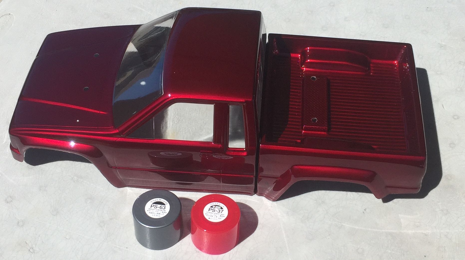

The body that came with the truck looks good from far and far from good so I bought a replacement Proline Hilux.  I’ve been wanting to try out a color combo using Tamiya’s PS-63 light Gun Metal.  I laid down the PS-37 clear red first then backed it with the light gun

the color is beautiful and I’ll use it on some touring car bodies
I know that feeling. I thought my CC01 was great on trails and enjoyed running it everywhere offroad until I got my girlfriend a Wraith Spawn and realized that I couldn't go anywhere that she could.
That gearbox wasn't sealed? The previous owner must have really just given up on it to let it become that way.
The paint came out great. Really nice color.

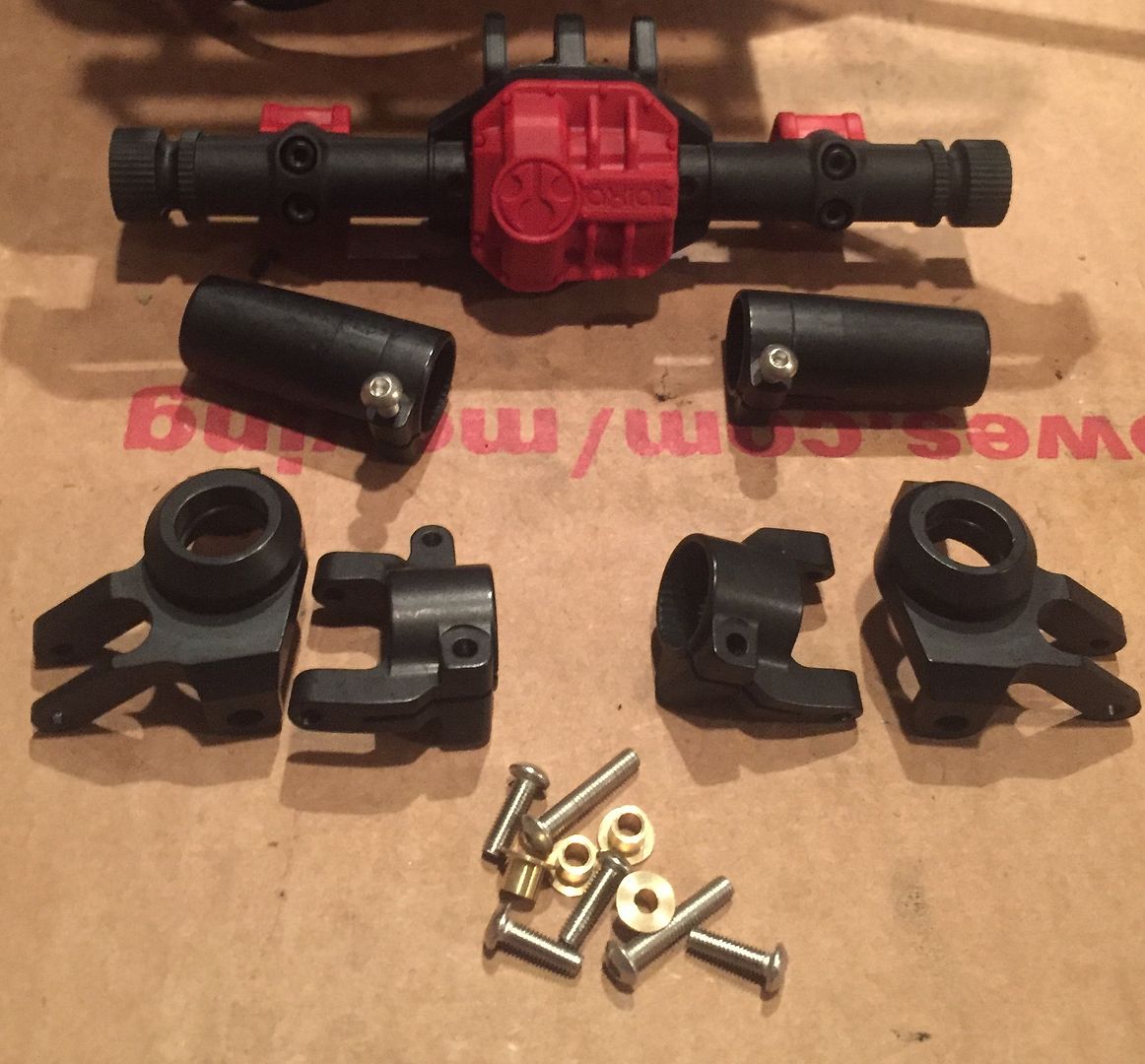

After lots of bashing I ended up breaking the plastic C-hubs in the front axle. Resisting the urge to bling out this truck I went back with the stock plastic axles.  I have a set of the aluminum C-hubs, knuckles and rear collars for the axles on order.  So I’ll switch out the rear axle casing when that stuff comes.

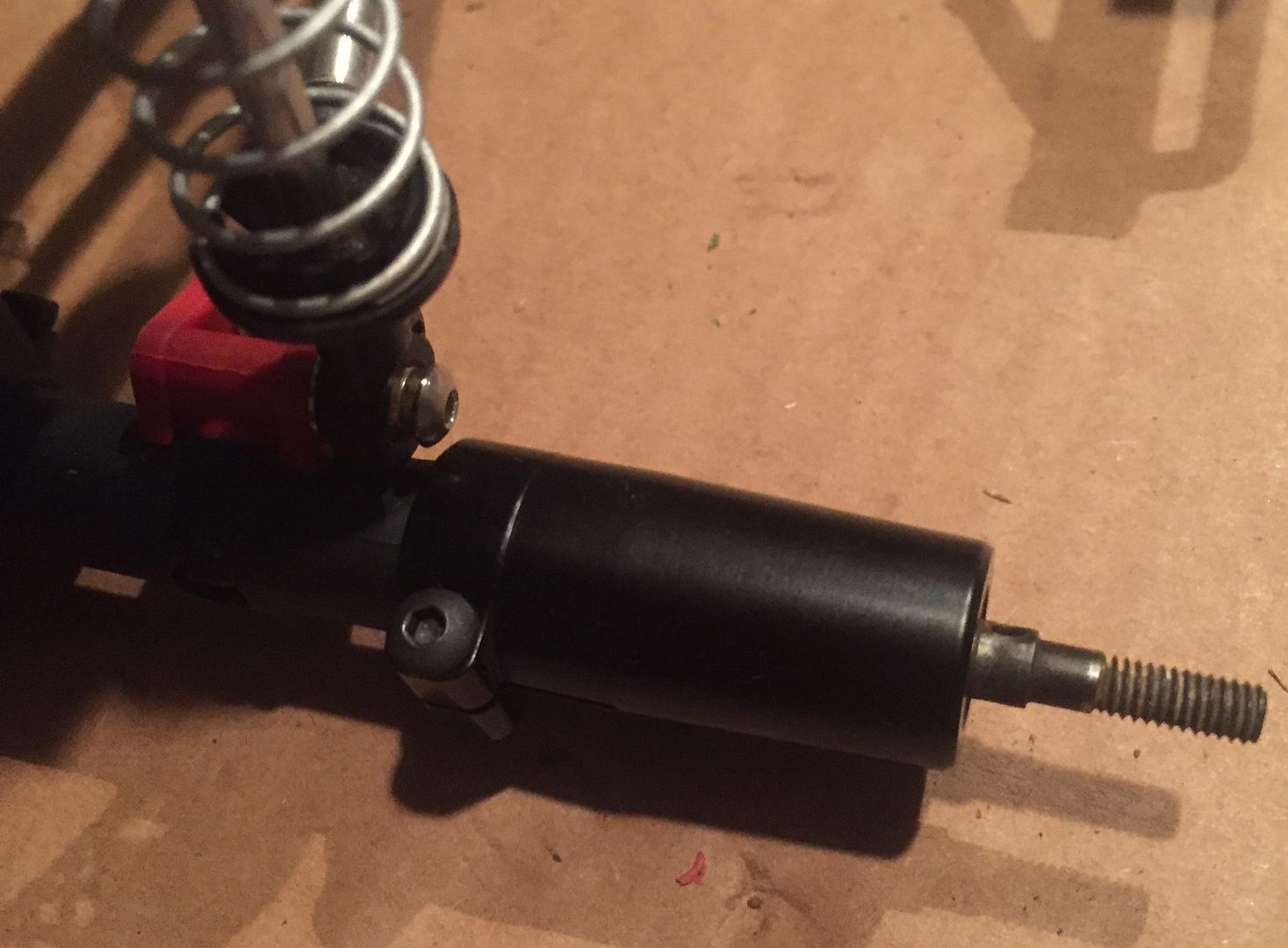

I replaced the rear axle housing with a stock plastic one and installed the aluminum parts to the front and rear axles.

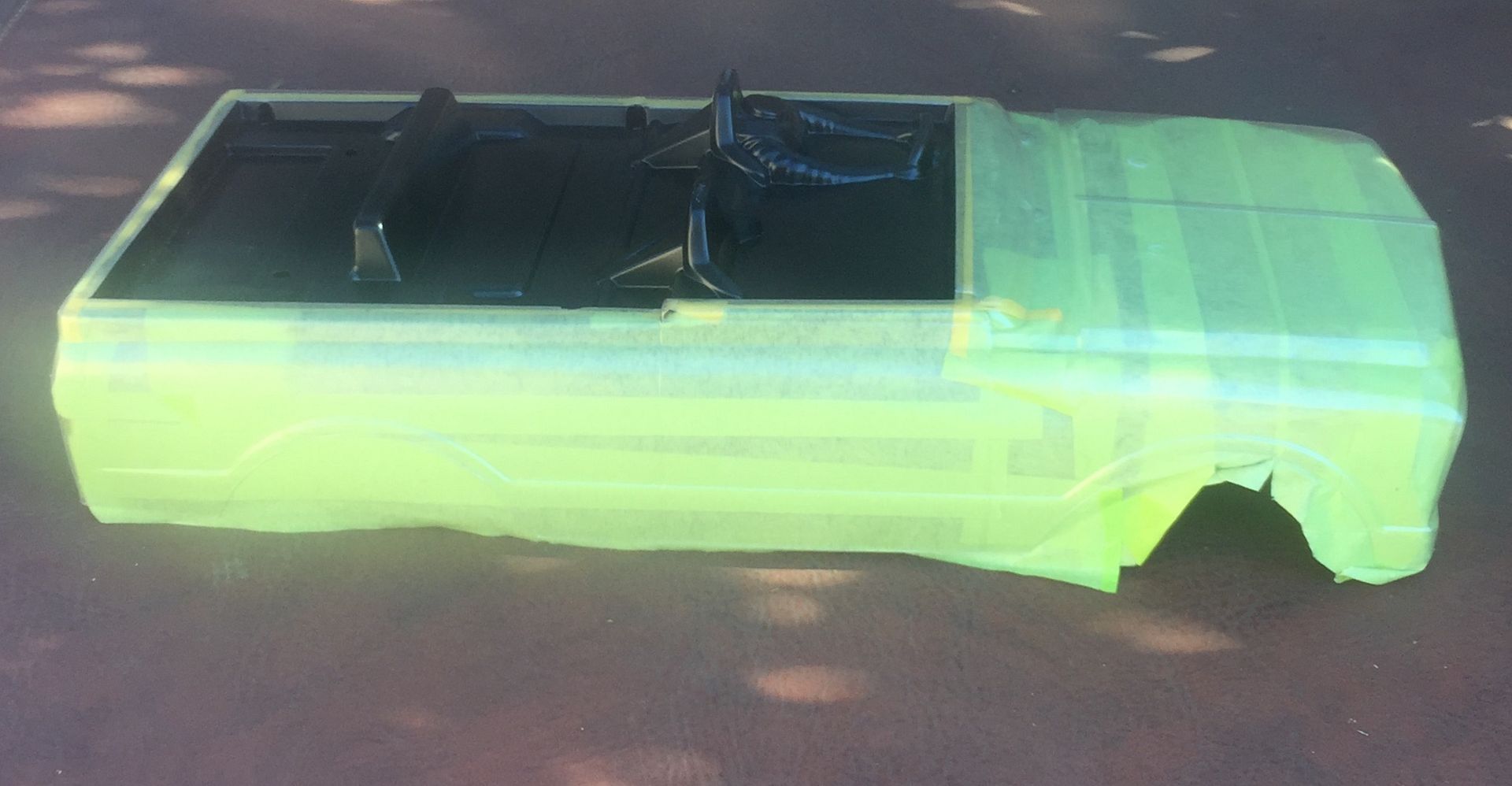

Finally there has been a break in the weather this weekend so I can start spraying the paint on the body.  Taped off nearly the entire body to spray the black.
9F1CFC17-3124-45A9-B14D-D6FD0C4163FB_zps

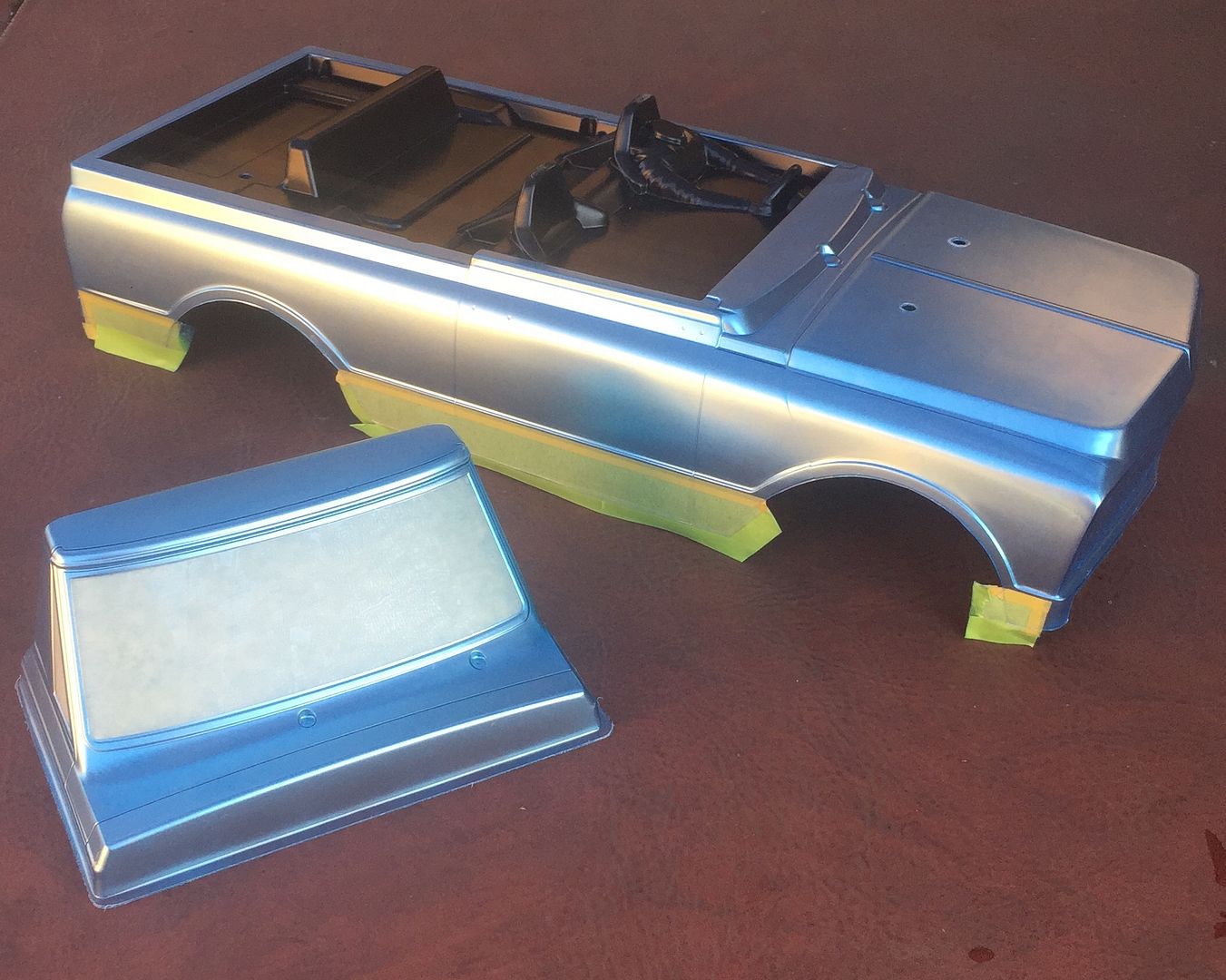

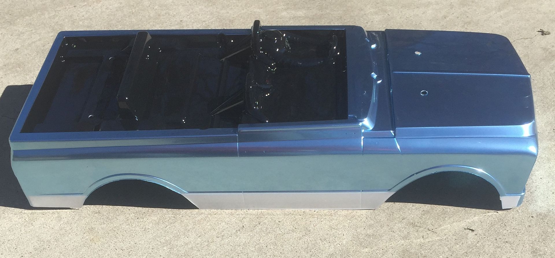

Then sprayed the Sky Blue Anodized Aluminium (PS-49) leaving a strip on the botttom for the rocker color
1E2A717F-6B6C-4F73-AB62-1C9167C07630_zps

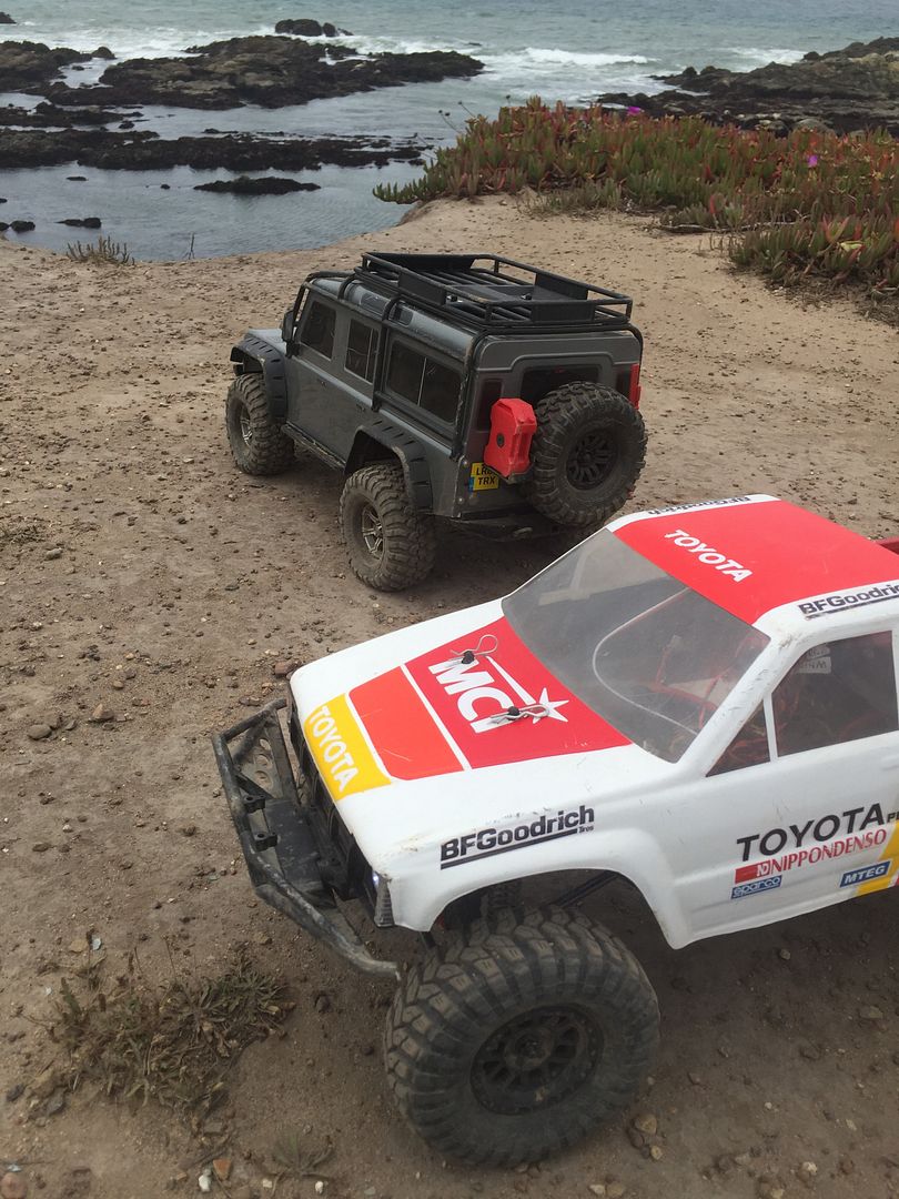

Was torn between silver or white. Went with white as it felt more old school
