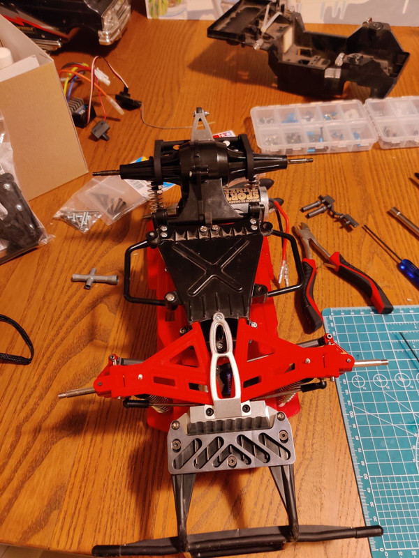

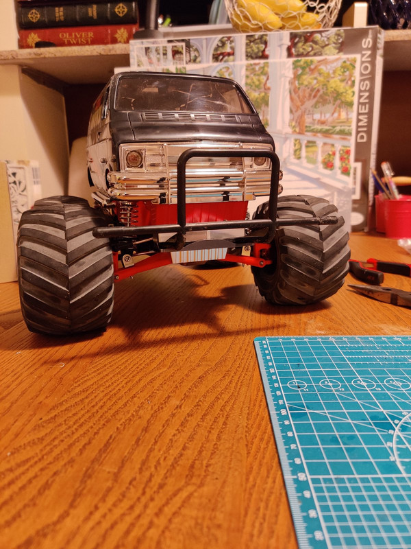

Apologies for exhuming an old thread, but it may be worthwhile to mention that the Ampro "Wide" HD arms for the IFS on the lunchbox are very solid indeed; I don't see how they're going break with normal use, unless normal use involves running the LB headfirst into a wall at over 50 km/h.
I bought a set from Shapeways, and couldn't be happier with the result. You'd have to make your own upper arms out of turnbuckles, but that is very easy. Here's a pic or 2:
Does that really make that much difference in realtion to the normal Arms?
I think the normal arms are quite ok. The only thing i don't like is that the tires rub against the Body while breaking & cornering at the same Time....
