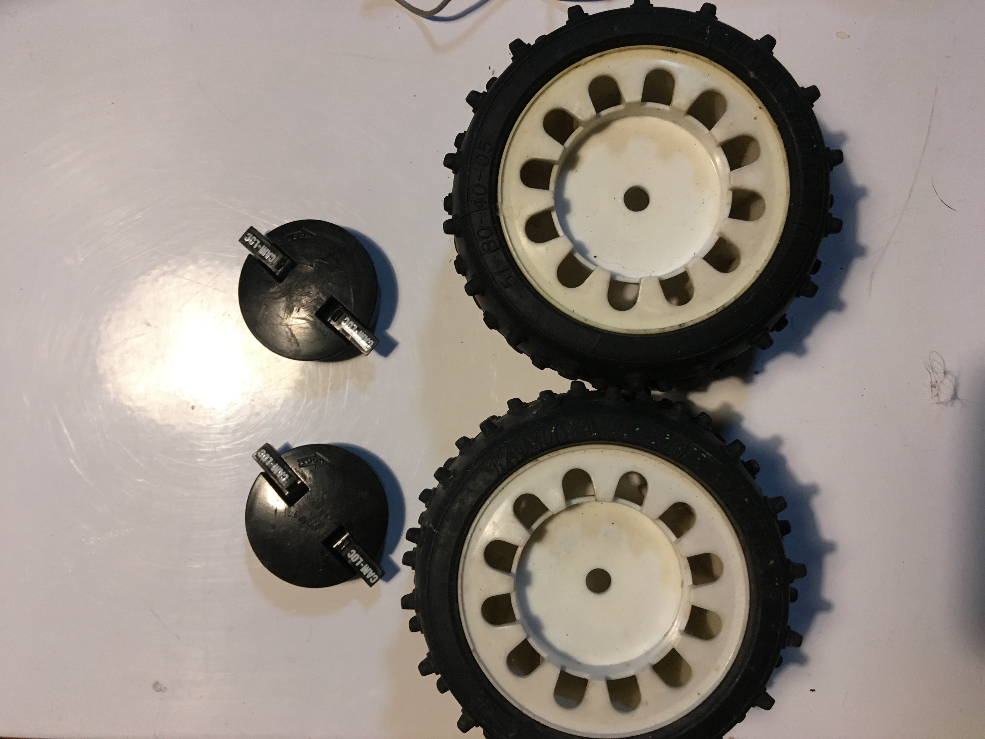

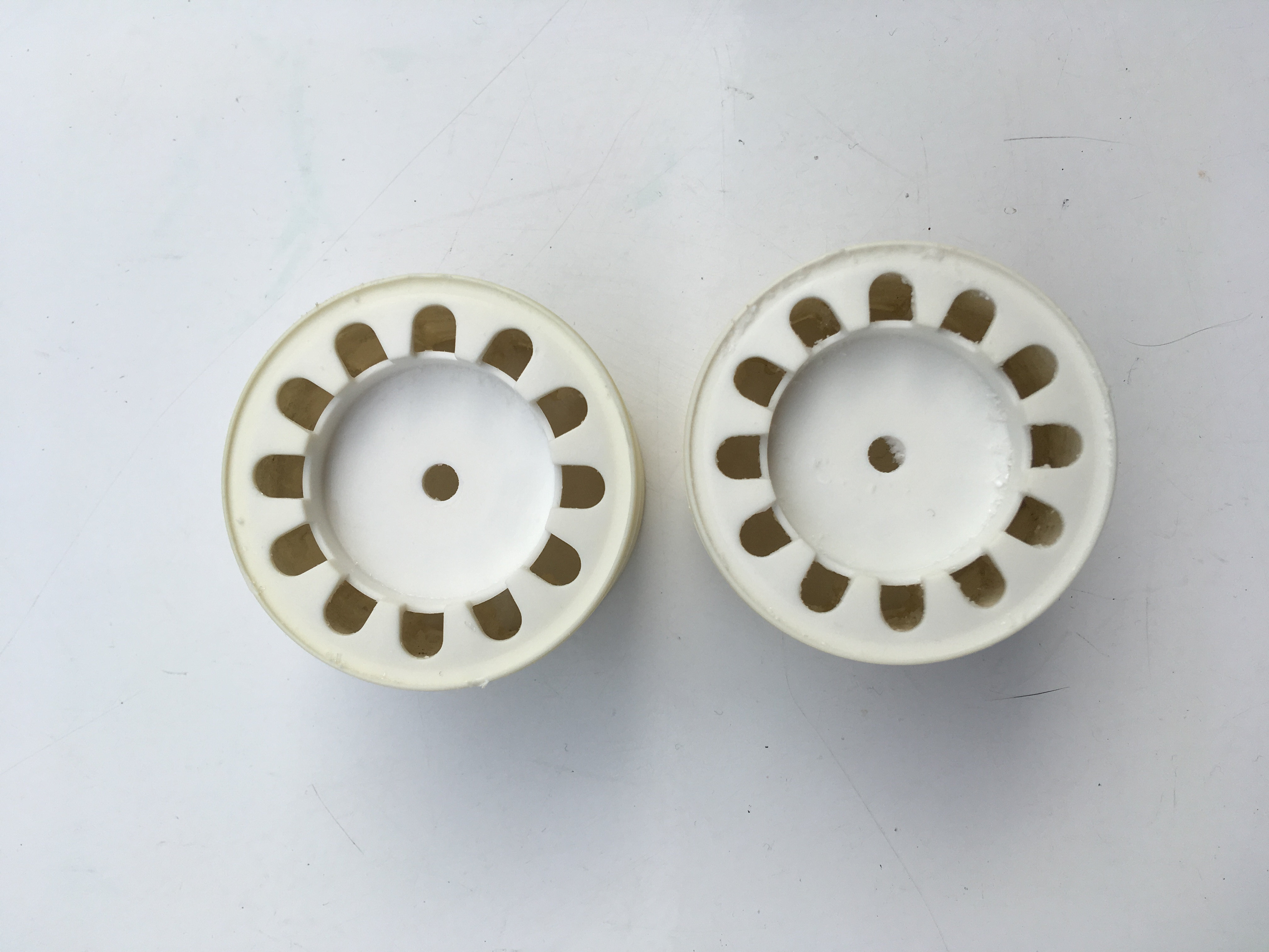

Hello all,
I have heard about adding Hydrogen Peroxide to "bleach" the rims. MOST I can find is a few days in sunlight.......
Its N.Ireland and winter so sun is in short supply. I have a bottle of 9% Hydrogen Peroxide but what strength solution for how long.
Can anyone help? They are vintage wheels and I don't want them to collapse - it is for a vantage Vanquish for display only.
Thanks in advance.

How off-white are they?
I believe the vintage Vanquish wheels were more cream than white anyway.
The rest of the rim when you remove the rim is pretty clean, while the part that is visible once the rubber is on is not so.
Was thinking about running through dishwasher first.
