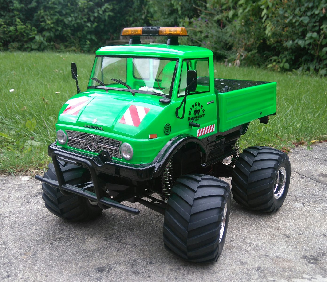

I wouldn’t be so bold as to call this a ‘build’ as I’ve pretty much just screwed it together out of the box over the past few days, along with a few basic upgrades as I went along. But I think it looks nice just finished so thought I would bung a few pictures up before my 6 year old gets his hands on it!
Like a lot of people ive always loved the original Unimog shape, and my wife’s Dad ran one on their farm years ago so there’s a tenuous link there too.. Choice seemed fairly limited when I bought the kit last year but I’m happy with the green that it came already painted in.
It all went together without any issues. I added bearings throughout, the Ampro transmission brace in fetching orange, Absima oil shocks (heard mixed reports about these, but they seem fine at the moment - we’ll see) and made a front strut brace from 3mm rod and some of the left over rear suspension mounting points.
The hardest part was probably the decals! They mostly went on ok; very fiddly of course - especially around the windows- and I wish I could have another go at the headlights which are quite wrinkled.
I’m still running the silver can motor and 3300 Ni-mh batteries which is plenty for using it with my kids.

Nicely done.  I like how the orange AMPro part stands out.  It's almost a shame to run it and dirty it up.
If you want, you can give each wrinkle a cut with an Exacto knife. Have one part overlap the other to take care of the leftover circumference.
Thanks Juggular. We took it out for a shakedown run yesterday and it went well, definitely fast enough for the time being with perhaps a sport-tuned motor down the line.
On cleaning up and checking it over afterwards I saw that the little ball joints had unwound and very nearly detached their nuts (and themselves) from the servo saver - I was probably a minute or two away from losing the steering completely! I’ve nipped them back up with threadlock on now, but will look out to see if it happens again.
Good fun though; very different to my original/upgraded Monster Beetle and re-re Hornet. I am planning on putting some foam in the tyres and then glueing them and that should really show what the suspension is up to with the other upgrades.
