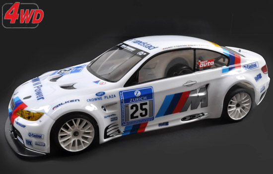

My rc club friend, has built one of these, we are using 1/5 bodies and using very thin plexiglass. Dont know much about that, but I can ask for example what material was used to make the form etc, but you will need at least one new shell to make the form.

What 1/5th bodies has he done?
