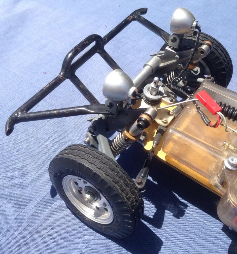

Some good steering set up ideas. My thoughts are that you have to keep the steering rods as low and close to the chassis to minimize bump steer. On my runner rough rider I use the Super Champ servo saver with Tecnacraft titanium rods with Dubro ball links.
6EB0B81F-0A8B-46E1-9592-8FDB898F3DC5_zps
any chance of a better pic of the rims you are using?
And also some Background about the coil over springs and retainers on the original shocks?;)
Those are made by CRP.  Rims are vintage RCH wheel covers
