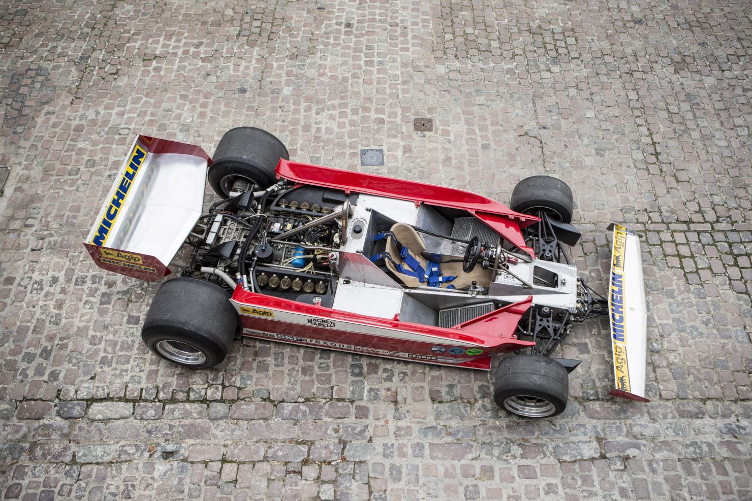

The reference photos I have curated over the years were of great benefit. Using 1 mm styrene sheet and some hardware, I scratchbuilt a gauge cluster:
Unfortunately, as I had only the one size of styrene rod, I could not fill in the flanking gauges, which were brass servo post spacers. Drilling through the panel allowed for a more realistic appearance by giving the gauges depth, but I could not manage to fill in said spacers. I eventually replaced them with cut sections of styrene rod, sanded flat on the gauge face side, though I kept the 850 bearing as a rev counter surround.
Tamiya plastic model cement works spectacularly for plastic-plastic bonding, but for multi-media joins, I used Gorilla Glue-brand CA. The latter was how I was able to attach the metal pieces to the plastic panel.
Reference photos of Gilles Villeneuve suggested a red racing suit with white stripes along the arms, so I modified my paint plan accordingly:
I was also able to add some more detail to the cockpit base by adding a bent styrene rod and another altered section to depict the front roll pylon and steering column, respectively. The steering wheel issue was solved by cutting a sprue off a set of Grasshopper II front arms, and creating the centre section out of 1 mm styrene stock and two plastic bushings: one for the front hub of the steering wheel, and the other to fit said wheel onto the steering column. The centre section (bonded to the black plastic ring/wheel rim) is visible in the lower part of the picture. By now, I have already replaced the brass spacers with styrene rod for the gauge pod.
To simulate the recessed panels on the nose of the monocoque, as visible in this photo:
Ferrari-312-T3-Formula-One-Car-10-1480x9
I cut out some shapes from the stock and glued them to the front panel. The opening for the steering column and pedal box access was then painted in XF-56 Metallic Grey, to distinguish it from the closed panel and surrounding material in X-11 Chrome Silver:
The build kept changing as my information was updated through reference photos. The white stripes for the driver suit were found to be much narrower than I had initially painted, so I would eventually paint over the borders of white with more XF-7 Flat Red. White sleeves and gloves were added in deference to Villeneuve's suit at the Canadian Grand Prix in 1978:
0Asu4_ckh-NmWpNzSlvouOP-guOiQPRAHr59_1Du
Although it is worth mentioning that I otherwise do not intend to depict the car or driver as they appeared in any particular event. The objective to depict both car and driver as they likely would have been during the 1978 season (the only year Villeneuve raced the 312T3) is sufficient.
This took me about two nights, including painting the gauge cluster and steering wheel in XF-1 Flat Black. The helmet was given X-3 Royal Blue - leading to a curious twist, as we may see later...
Another point of contention was the seat harness. I chose to acquire one for this build, which is in common with the Ferrari 312T3 in that it has an anti-sub strap and is blue. Otherwise, its authenticity has more to do with scale than faith to the originals.
However, I could not decide how to anchor it to the chassis or cockpit. Did I want it to unbuckle? Should it be fixed to the cockpit for aesthetics, or to the chassis for realism? Should I use screws, glue, or some other means?
Some more clues:
Of course, the harness for this particular 312T3 is not a period-correct one, but the anchor points are consistent.
The most obvious location was for the shoulder straps, which bolt to the back of the cockpit. I cut slots to pass the fixing points through the cockpit, since I figured I would be unable to access them after everything was assembled:
And out back:
