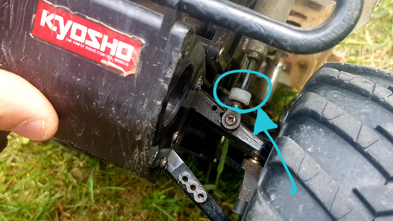

About my Kyosho Big Boss. Even if this monster truck is from 1988 (maybe mine's 1990, but still...) it is my main runner. In order for it to be up to the task, I've tweaked it up a little. Nothing too hard on the eye like what's on the Hornet, but still quite ghetto. Let's start.

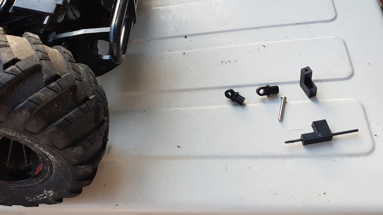

-The 5.8mm ball ends are a weak point on this car. Fortunately spares are available, but I didn't like the idea of wasting them so easily, especially the ones that connect the shocks to the suspension arms, which kept popping or breaking every time I landed higher jumps (which you are probably not supposed to do with a vintage car, but that's another story).

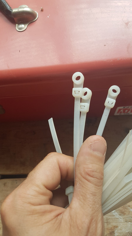

I had these nylon zip ties in a toolbox:
 So the solution came automatically:
Works great. Did that just over 2 years ago, and never had to open the bag of spare ball ends ordered in the meantime.

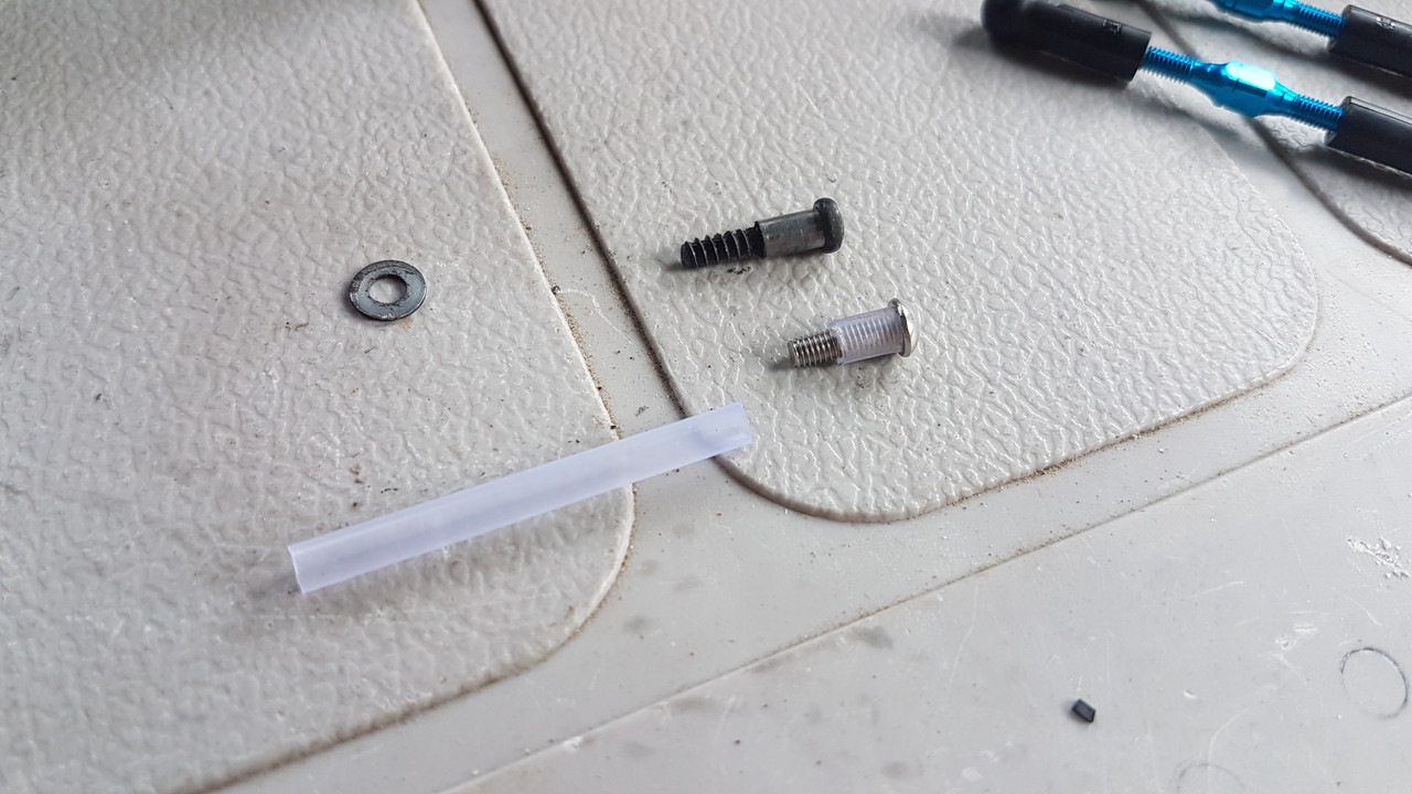

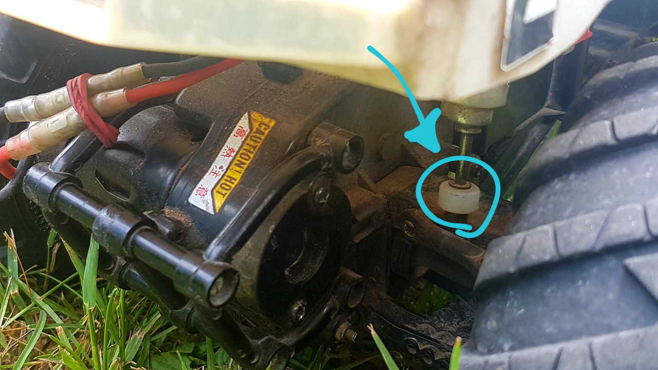

-On these trucks the body shell sits on four pins, and is then secured by other four on top of it, so basically the body gets sandwiched in between the pins. There was way too much play on mine and while driving the lexan bounced and screeched on the body posts like a ghost galleon in the perfect storm.
I cut four little pads out of some gummy material of the right thickness and punched a hole in them with a three hole punch. Slipped them in the body posts just on top of the under pins, and now the body shell is cushioned like a princess on her pillows. No more ghostly sounds to make me flinch during night driving.
Oh, and my niece provided the material for the pads: it came from one of her Disney bracelets!

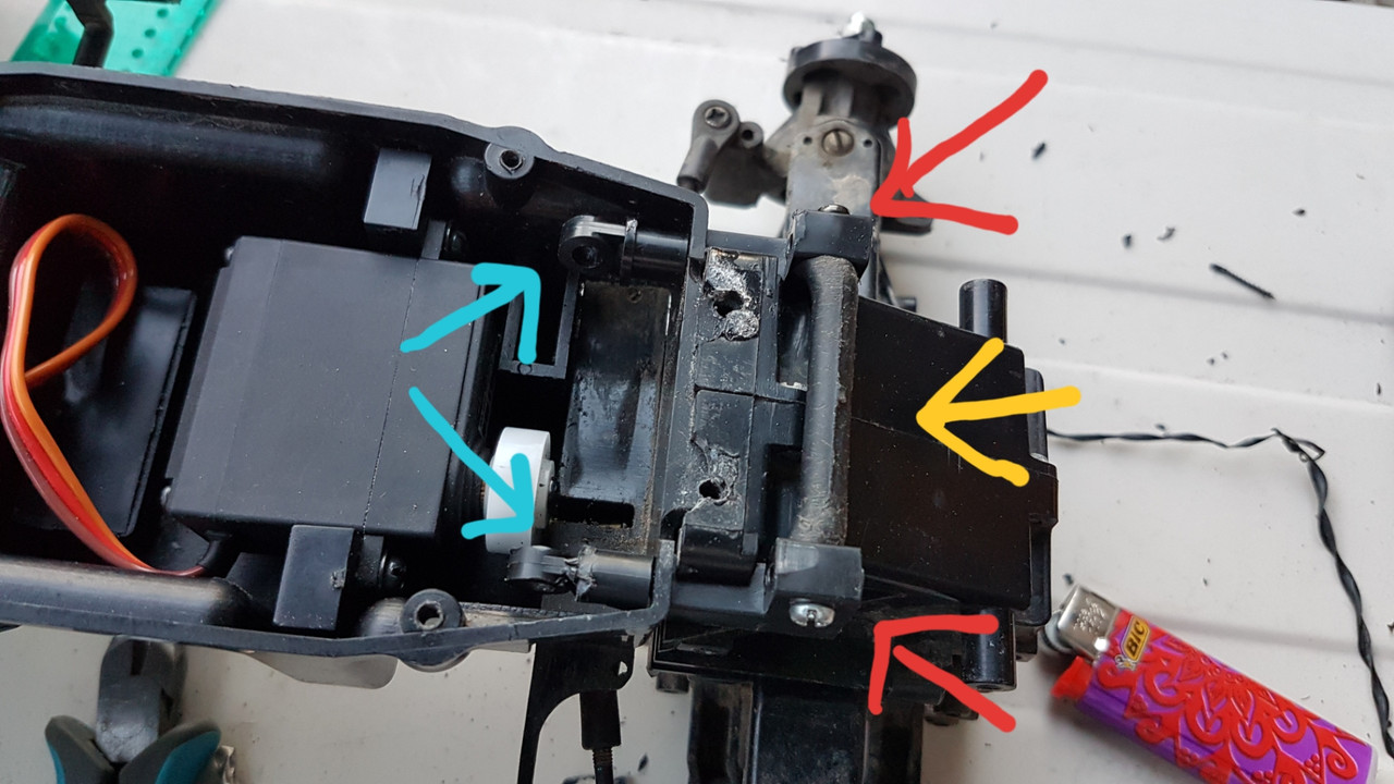

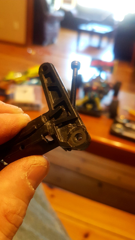

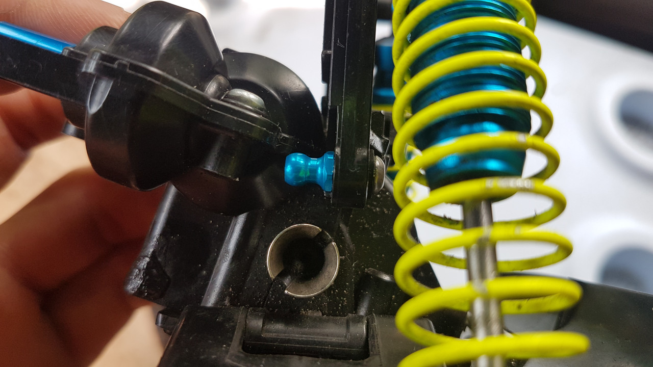

 As anybody who own one may have noticed, a major weak point of this truck is how the front bulk is attached to the chassis. Only for screws in total do the job very poorly, two at the top and two at the bottom and both sets in the center, where the plastic is particularly thin and flimsy. I'm surprised, actually, that it held on that long.

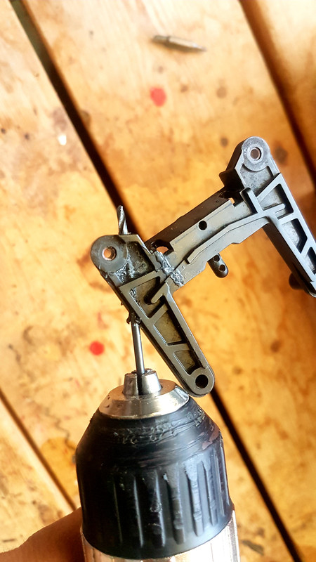

In order to improve it, I decided to try and design a brace, after noticing that there was room for it exactly where I wished it to be: between the side suspension mounts and the side grooves in the upper part of the bulkhead.
I cut the brace to fit out of an old Hornet front bumper, and used two servo mounts and two random shock mounts as brackets. These are the parts:
After measuring and fetching the right drill bit, the operation started.
Two screws hold the bracket to the servo savers, which themselves are screwed to the suspension mounts through the chassis in the inner side.
It's not as invasive as it seems, besides the inevitable drill holes in that part of the chassis which is hidden anyway. I am usually not for invasive mods, but this one was just screaming for it.
In the picture below, the yellow indicates the brace, the red the servo mounts and the blue shows the shock mounts.
The shock mounts on the inner side have eyelets so can be easily held and turned to tighten the brace, if it's ever needed. I hope it's clear enough to understand. Anyway, since I did this my front bulkhead felt like one thing with the chassis, and still does to this day. Once everything is back into place, you hardly even notice the brace.

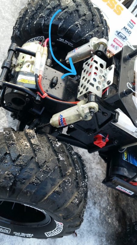

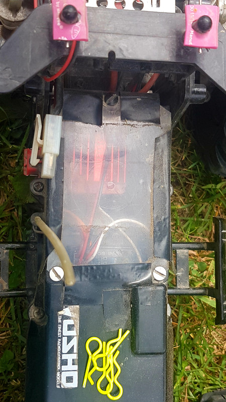

 My Manta Ray has just a few ghetto mods, all od them in the winterizing/waterproofing department so I take them off in the good season.

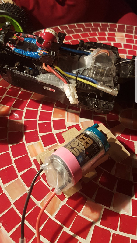

-to protect the ESC from splashes, I cut open a leftover bag from a kit to cover it, and attach the bag to the chassis with heat glue in strategic points. It doesn't get more rudimental than that but it's very effective, all I have to do is blow off the snow, or droplets, which otherwise would soak into the esc. The bag does sit on the heat sink, but at the criminal temperatures I have to deal with it's far from being a possible issue. Once the snow's gone, the bag is removed. No pics as it's summer now! And no need for pics of that anyway...
- for the same purpose (protection and shield) I trim a smaller bag to fit the motor. Broccoli elastics are perfect to keep it into place, and they come in different colors so you can choose the one that works best with your car. They only lack the Tamiya logo, really.
This too gets removed after the winter of course
-This is the only ghetto touch on my Manta Ray that's installed all year round.
A little transparent plastic box shield that was trimmed from some packaging or blister (I have a box full of plastic packagin leftovers exactly for this purpose) fits perfectly around the receiver. It doesn't make it waterproof but it saves it from snow and splashes, which is prettyvmuch what I need.
This too proved to be very effective and I suggest it: if you keep an eye out for the leftover packaging you'll find the dimension you need for pretty much whatever electronics in whatever car (a box of pens, chocolates, socks, cellphone, many things will do, they are around us all the time).

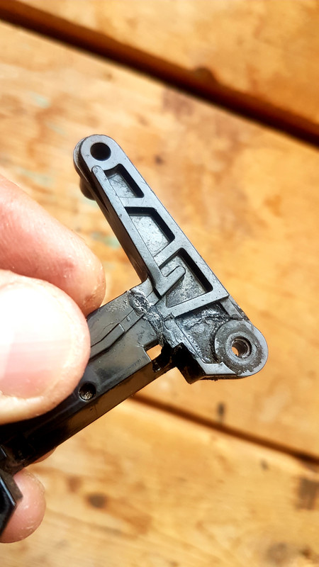

Since I started gathering parts for a massive restoration/facelift of my Manta Ray two years ago, at the same time I got an urge to try and squeeze as much life as possible out of the car before embarking on said restoration. Because of that, every time there is an issue or maintenace to be done on this buggy I'm invariably drawn towards trying to make do with what I have, and use ingenuity rather than going for a new part even though I already have them. This has lead to some exhilarating results lately.
The first is about the front shock tower: following a bad tumble over rocks at high speed, it cracked badly on the right side. A quick search online for an aluminum counterpart did not help the cause (none available, exept for one in a horrendous off green colour for a premium price, nah thanks). I do have an extra parts tree with a new one, but because of what I said above I wanted to try and fix the old one first.

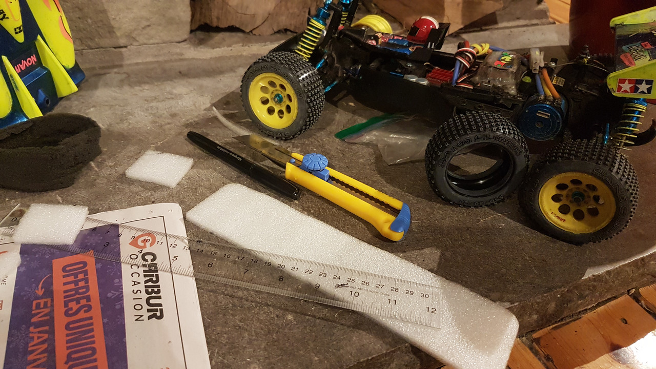

The second ghetto mod is pretty straightforward. Upon mounting a new set of Kyosho Sand Super tires on the Manta's rims, I noticed it was time for some new inner sponges as well. Old omes were just too munched up to be usable alone. After realizing the ridiculous cost of ordering some online, I just got creative. This small sheet of foamy-ish packaging material did the trick. With some trial and error I was able to cut stripes of the right lenght, one that would allow slight compression when inside the tire once it's glued to the rim, so that the padding material feels consistent all around.
The feeling, once done, is the same as having new foams. Sorry I didn't take more photos of the material itself, but I'm sure you'll still be able to identify it (it's the very padding that comes in many of our RC parts deliveries).
Feels good sometimes to save the coin and do with what you got in house.
