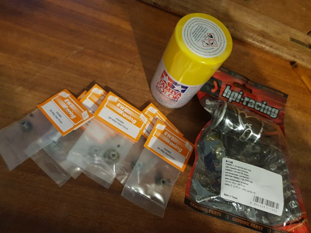

It's going to be "Sand Viper" yellow - that was my second choice car and is still like one. I've not painted a car for 30 years ago might be interesting. Also decided to buy an £8 15t HPI motor - rude not to try at that price.20190102_114519.jpg

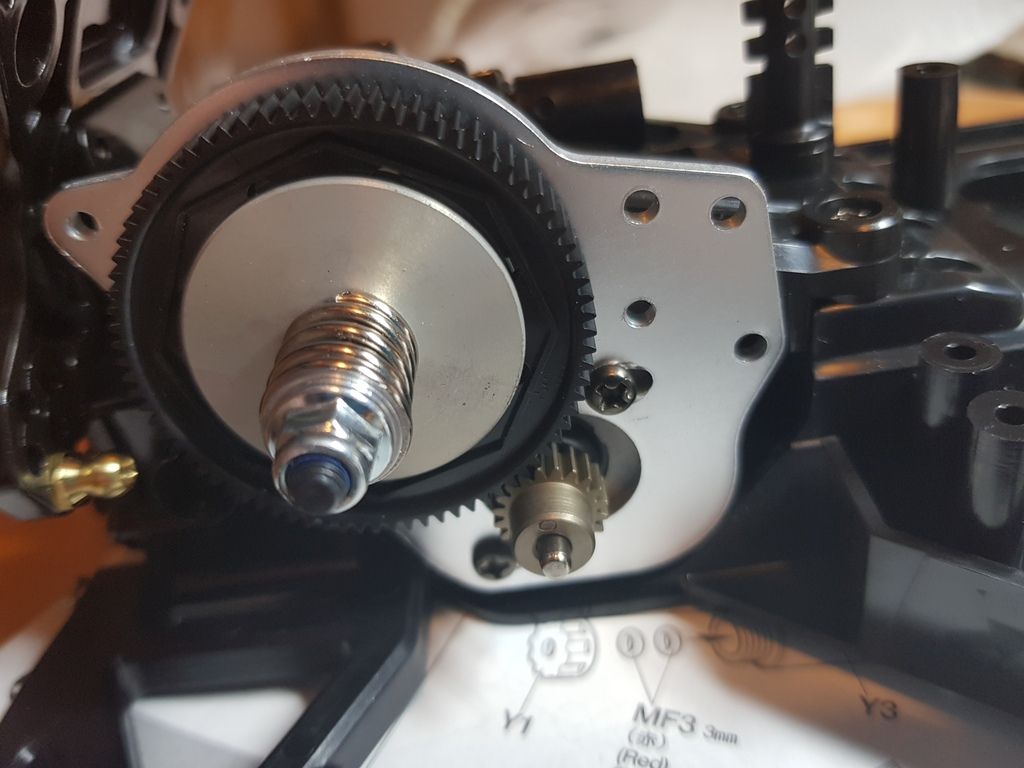

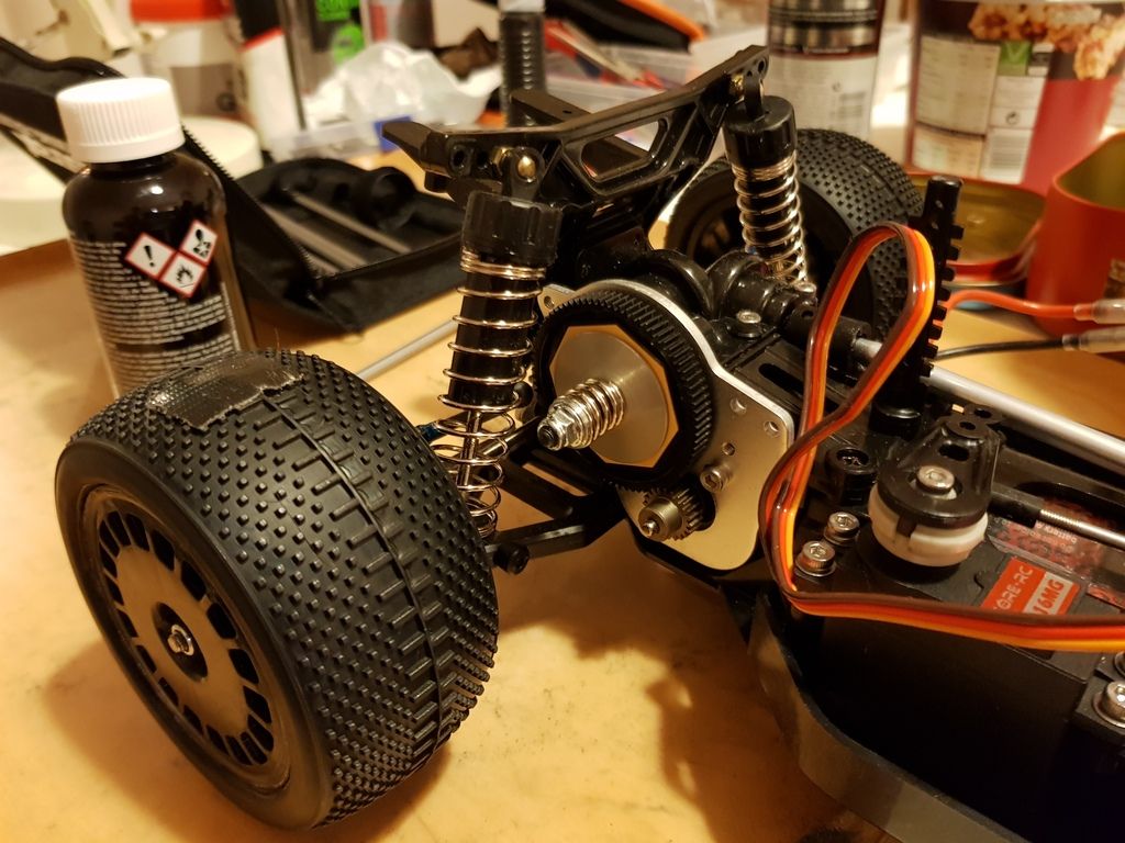

Freshly reamed Associated B4 48dp slipper spur with 20t RW steel 48dp pinion. Fits perfectly and now I have a bunch of pinion choices. Could cut tamiya pads to fit but have B4 pads arriving tomorrow. 20190104_213233.jpg
Can't get the 84t spur under the cover but the 81t does and will take an 18t pinion. Reaming needs to be gentle as very little material needs to be removed.

This is a simple mod to allow the use of 48dp pinions provided you're using a slipper - B4 spurs won't key into the stock shaft. The plastic reams easily and evenly. Really pleased!!

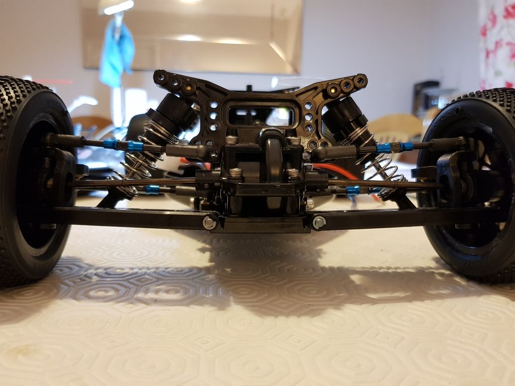

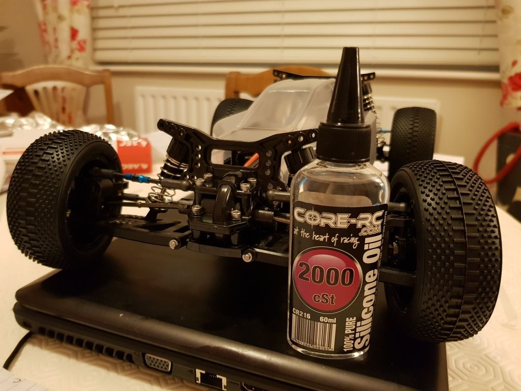

Added rear turnbuckles - used dry PTFE and graphite powder rather grease on ball joints and in an drive cups. Had spare foam so added a half piece to the outboard drive cups - positive pressure on dogbone at full droop. Used inner shock mounting point on tower and outer on bottom arm to (slightly) limit droop based on what I've read about dogbones popping out. The dampers sound very slightly bubbly so may have some air in there. Already thinking about hop up but also have some 1000cst oil to try in these - I read somewhere they are under damped with stock 900 oil. I used 1 hole pistons front and rear.

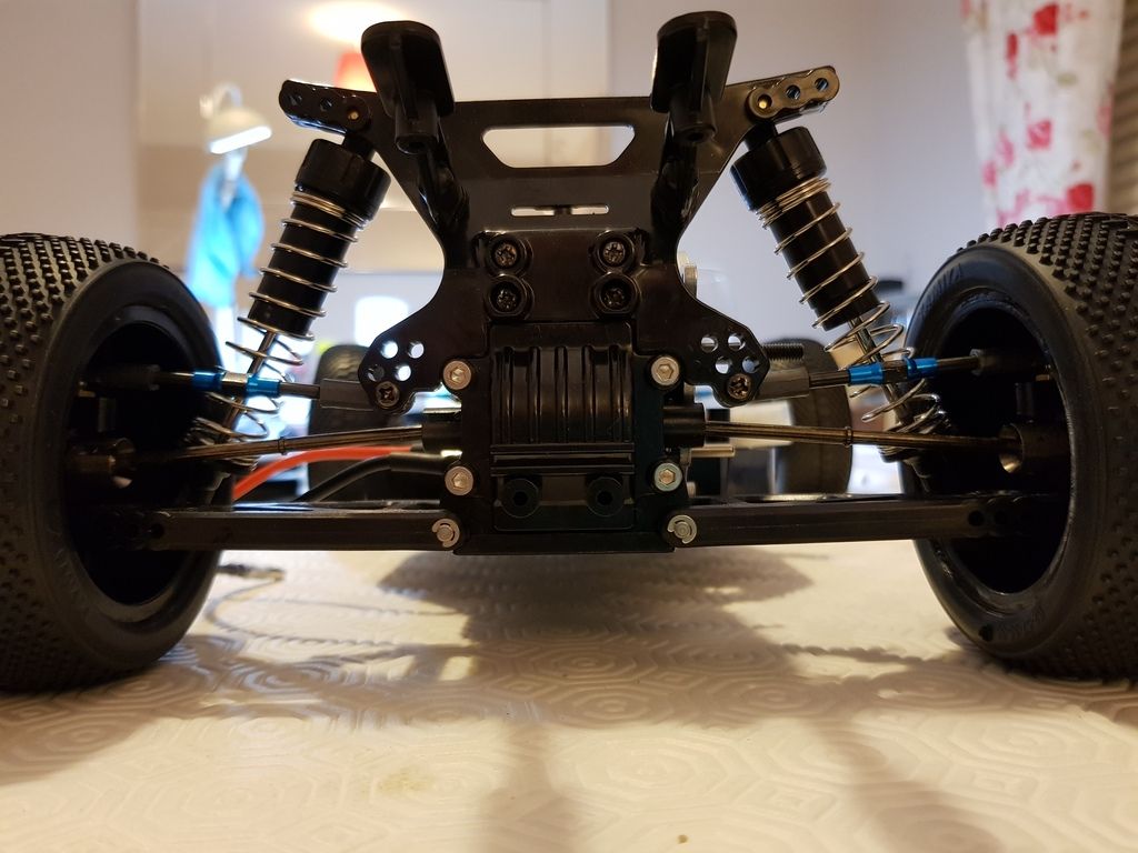

20190108_232537.jpg20190108_232441.jpgPhotos of ride height. It is quite low - bottom arms horizontal at full droop. Damping seems reasonable with a drop test - doesn't bounce. Rear is relatively slow to rebound. Front end bottoms out and front end is sitting lower than rear. I've kept it low to try and limit loss of dog bones at full droop. Any comments? Bring front up to match rear height?
I ordered  more urethane bushes from Tony and added an extra half to each front outdrive and a half to each front drive cup. You'd think that would make it really tight at full compression but it's comfortable - very loose at full droop without and I may need to limit droop if they pop out.
Front damping with stock 900 cst oil and single hole piston seemed non existent so I refilled with 2000 cst and now it feels controlled when I drop it. Might be a bag of spanners to drive of course.

Radio arrived today so electronics "in". Ran diffs in by locking one outdrive and running low throttle for 5 minutes each direction then tightening until rotating one wheel will turn the motor over (tight). Spinning a rear wheel I get half a turn of diff action and spinning a front I get 3/4. Sound ok?
Adjusted slipper (B4 81t spur and 21t pinion) by tightening until the  rear diff just started to bark (horrible sound) when the rear wheels were held still. Backed off a bit and then set up the slip by pushing it backwards on carpet and then full forward throttle. Happy with it so far. Diffs still feel smooth thank God. I wouldn't recommend my first method - tightening until required slip on a high grip surface probably more sensible.

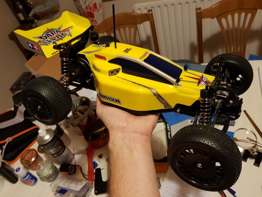

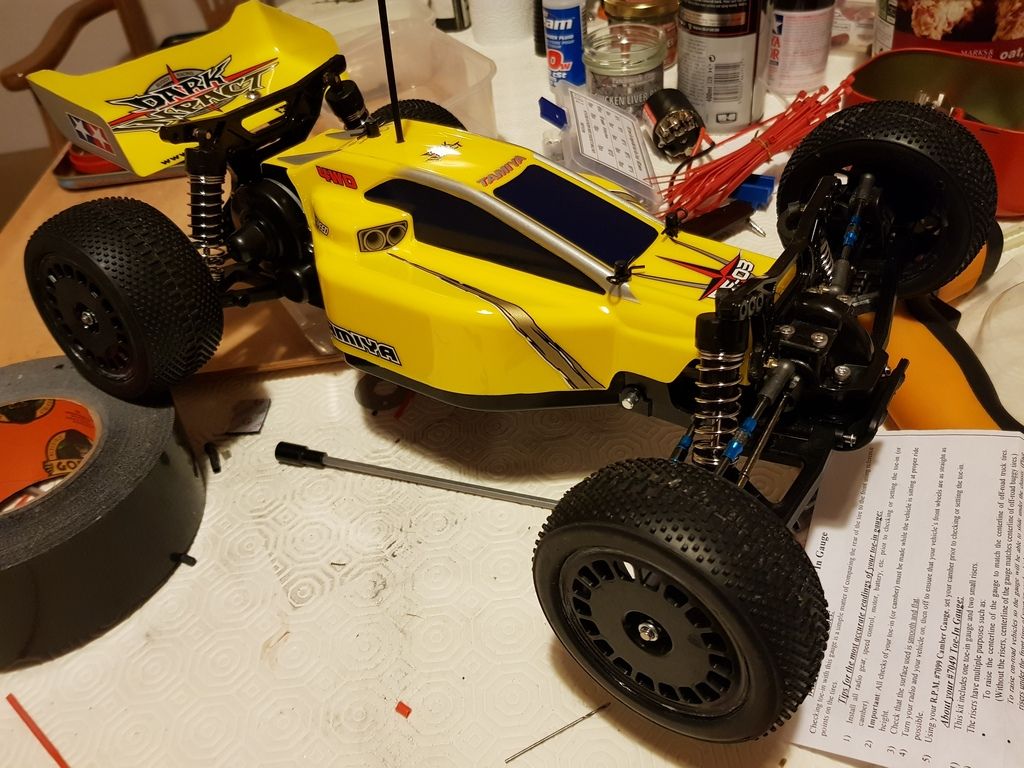

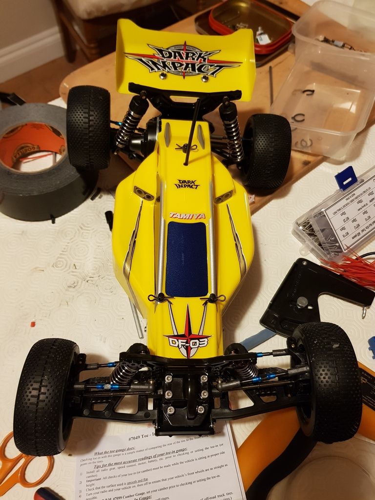

Mostly done. Damaged a few of the decals when trying to fit them so a bit minimalist. My attempt at a 4WD Sand Viper. Took 2 cans of yellow to get coverage and I wish I hadn't taken the film off the wing before painting (manual said to remove it?). Driven it a bit today and noticed the rear wheels aren't exactly round so may look out for replacements. The slipper needed tightening after a while and currently running a cheap 17 turn motor with 81/20 spur/pinion. Didn't get hot but time will tell. Tends to understeer so I've increased negative camber to 4 degrees up front and reduced rear to 1 degree. Looking forward to giving a proper shakedown soon.
If you want more ride height, the Tamiya alloy df03 damper set will increase it quite a bit. The front and rear are nearly cm longer.
9 hours ago, DI driver said:
Tends to understeer
Softening up the front shocks and /or stiffen the rear will help get rid of understeer , there comes a point where more camber will be less grip.

Thanks. Yes, I may have over damped the front (and my driving is poor!!).
