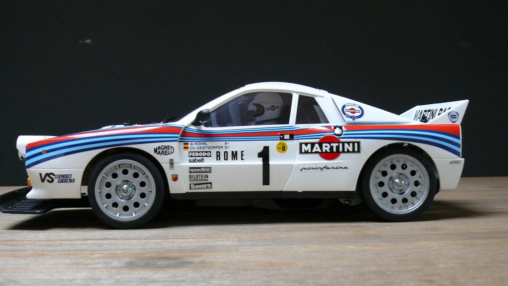

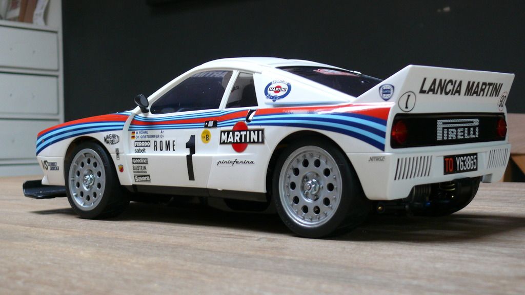

I was messing around with my 037 this morning, still trying to get the body and wheelbase to my liking, when I saw your video.
Nice coincidence. I love to see how others build a model that I've built myself. Good luck with the rest of the buid.
Here's a few pics of mine so far, after much gnashing of teeth, indecision, and just general faffing about.
Looks awesome! Can't wait to finish it so I can run it. I will def not be using that big bumper on mine. ;)
Thanks. Yeah, I'm not a huge fan of the big bumper either. But the body took me such an insane amount of time to complete, that the thought of damaging it makes me wince and want a still bigger bumper. I've stopped
short of strapping a duvet to the front, but the temptation is certainly there.

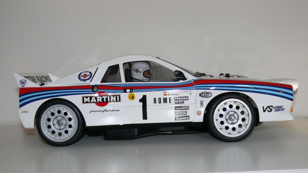

I swapped out the bumper for the smaller one, part E7, and removed the rear bumper too, so that you can see what it looks like.
I do think it looks much better. Now if only something could be done about the chassis being so visible, that would be great. I suspect I wont have much luck
there though. Ideas so far = 0.

I know the build thread I did a while ago has some tips - it must have been a combination of manipulating the internal damper spacers and body post settings; I never used the 5 mm cuts of tubing for the rear posts. It certainly is possible to reduce the amount of chassis exposed under the bodywork while retaining a useful suspension configuration.

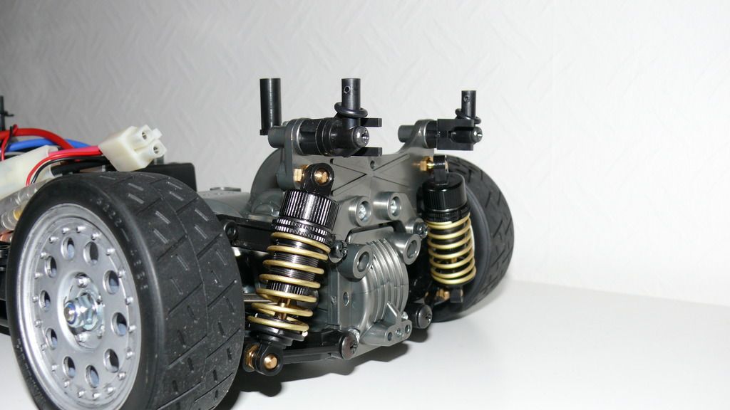

The problem is that I can't get the body any lower at the rear. It's practically resting on the shock mount. I rotated the spacer for the body post by 90 degrees so that the little fork thingie was not in the way, and
as far as I can see that's as low as it will go. Lowering the suspension arms will just make it look like it's jacked up.
I went back through my own build thread, and it looked like what I did was remove the larger of the internal damper spacers, and add two pre-load spacers to each damper. I kept the shorter bottom damper eyelets on, for a stance that looks like this:
This setup still allows the wheels to clear the arches under full compression:
It also looks like I left off the 5 mm rubber spacers underneath the rear end of the shell, leaving it sitting as low as it can go. I was fine with the clearance between the wheels and the arches, since I intended to run the car off-road, but some more creativity will be required (as well as a harder suspension setup) to achieve less negative space between the two. Of course, the front body post settings were also lowered.
I owe @ThunderDragonCy for that tip during my 037 build. Hope this helps!

I managed to get even more ground clearance using the longer damper eyelets as speedy_w_beans had alluded to - almost to the point of tucking the chassis completely under the shell - but learned that it was better for the chassis to be closer to bottoming out at full compression. It was quite far from doing that with the longer parts.

It will go a bit lower. As I explained (badly) above, rotating parts H8 through 90 or 180 degrees gives a couple more mm. The body posts wont rotate as the parts are keyed together anyway, and at
that body height the extra support is not required. I didn't want to mount the body without an o-ring though, but they squash down a little. The triangular fillet supporting the body post doesn't interfere
either because the holes in the body are oval rather than round.
Yeah, I'm after the stance of the real car/box art/ silhouette on the back of the manual, so I'm not looking to increase ground clearance more than standard.
You've lost me on how changing anything on the shocks will tuck the chassis further under the body. Surely that's only possible by lowering the body.
It is a combination of removing one internal damper spacer and lowering the shell that allows the chassis to tuck more under the shell while retaining similar ground clearance. Recall that the damper spacers prevent them from extending completely.
Removing one (and stiffening the springs) allows the dampers to extend further down, giving more ground clearance. To compensate for the increased height, then the body is lowered, giving the appearance of a stock ride height but with less chassis under the shell.
As for your comment about the wheels clearing the arches: examining my picture, it is clear we have different interpretations for "clearance." You are correct, though.
As you are after more of an on-road stance, though, I see this might not be useful. Hope you can find a solution!
