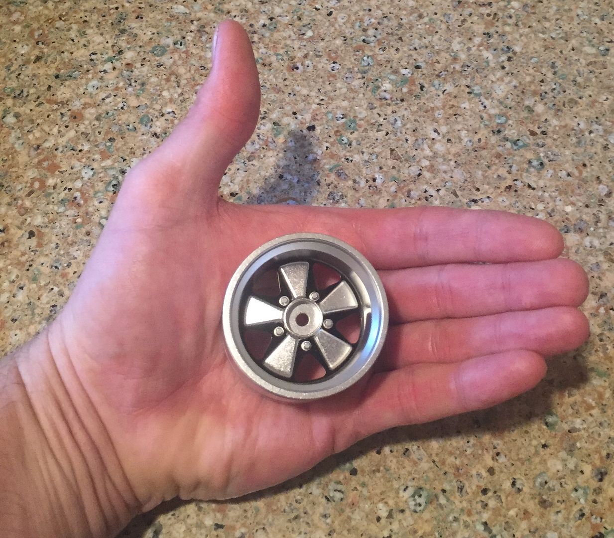

Shodog 1834 Posted January 8, 2019 Don’t know if anybody peeped these out yet. A German seller on eBay has been cutting chassis plates and shock towers from carbon. Very professionally done Cchand has been producing a set of Porsche Fuchs from aluminum. They are a staggered fitment so you can use the wide rear tires 3 1 Share this post Link to post Share on other sites
OCD 514 Posted January 8, 2019 36 minutes ago, Shodog said: Cchand has been producing a set of Porsche Fuchs from aluminum. They are a staggered fitment so you can use the wide rear tires First time seeing these, and almost wish I hadn't Now I'm gonna have to fit them into the budget somehow Does anyone carry this besides RC4WD? And are those wheels using an internal beadlock design or something? There looks like there's a lot of extra meat in the center of the barrel-section. Share this post Link to post Share on other sites
Shodog 1834 Posted January 8, 2019 The wheels are bolted together hence the extra material. They are not beadlocks. Ive only seen these at RC4wd and they are pricey. I saw them before Christmas and they sold out. I figured I better grab a set before I can’t 1 Share this post Link to post Share on other sites

Juls1 1653 Posted January 9, 2019 On 1/8/2019 at 12:40 PM, Shodog said: The wheels are bolted together hence the extra material. They are not beadlocks. Ive only seen these at RC4wd and they are pricey. I saw them before Christmas and they sold out. I figured I better grab a set before I can’t Do you have these in hand? The picture shows a center lock ring as if they are bead lock? Share this post Link to post Share on other sites
Shodog 1834 Posted January 9, 2019 8 hours ago, Juls1 said: Do you have these in hand? The picture shows a center lock ring as if they are bead lock? They are not beadlocks. The wheel is one piece and the face is bolted to the wheel from the back. Share this post Link to post Share on other sites
Juls1 1653 Posted January 10, 2019 Yep ok, picture makes it look like a lock ring all good Share this post Link to post Share on other sites
