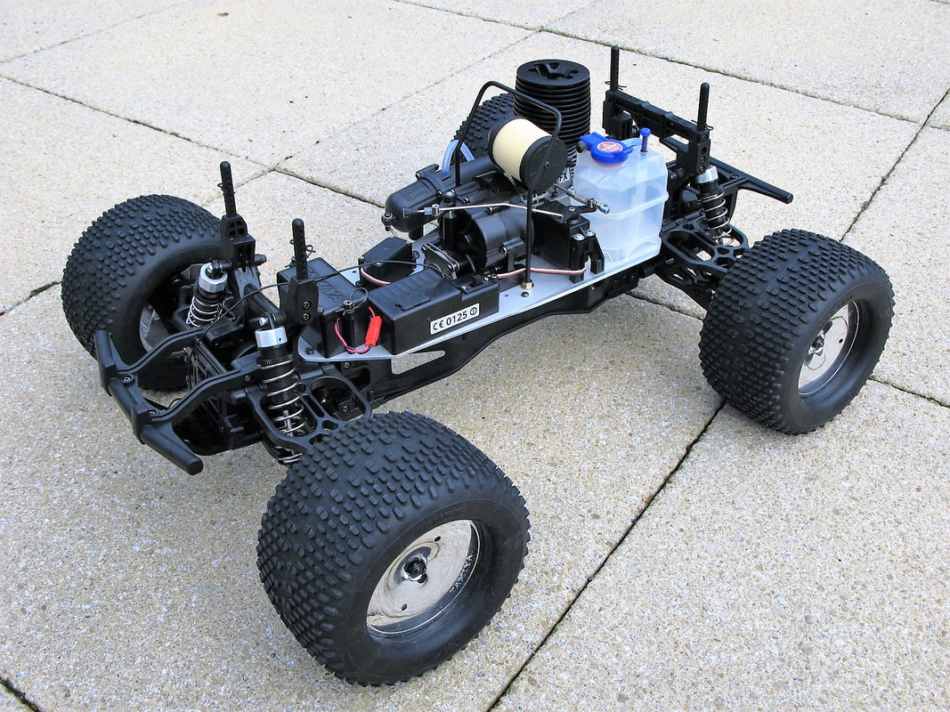

As the sun was out I thought I would have a go at starting the chassis plate. As mentioned before the Gold Edition uses a silver chassis plate. Tamiya have never released it in silver, you can only get TNX 5.2r chassis plates anodized blue.

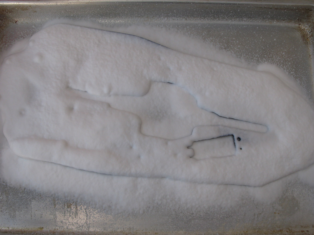

Took the old used plate

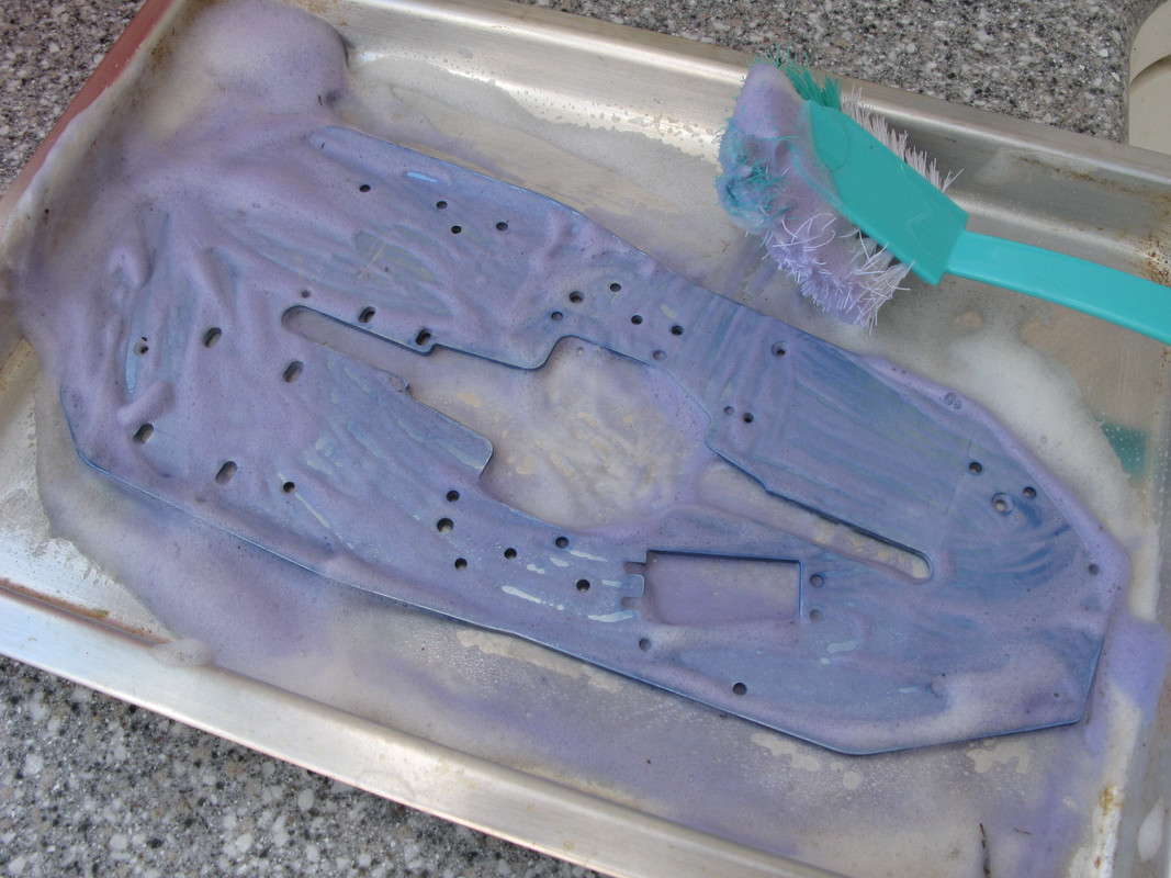

Covered it in spray oven cleaner

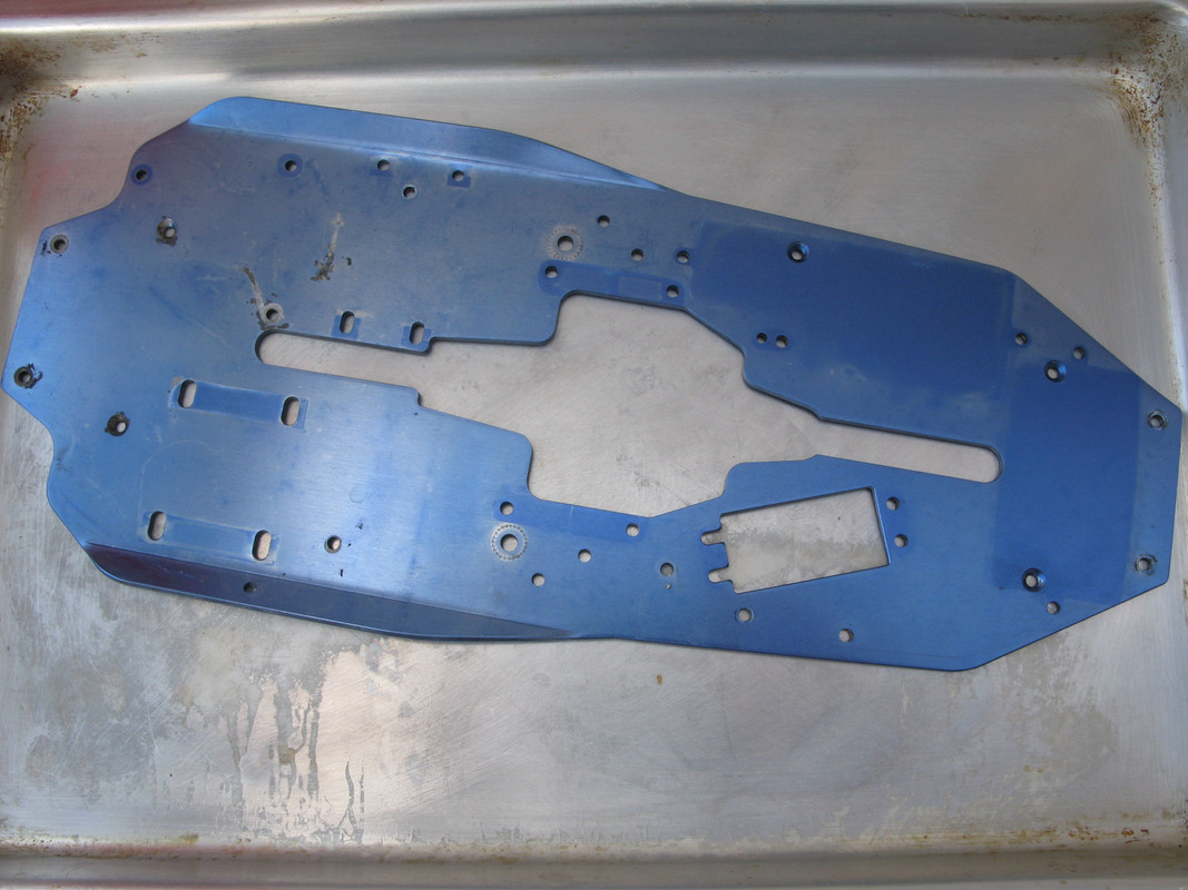

Left it for 20 mins and then scrubbed it. Blue foam!

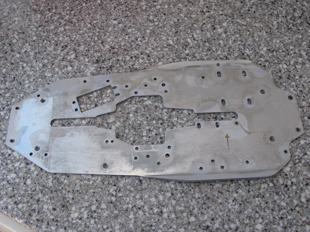

Both sides scrubbed and then rinsed off left me with this
and 30 mins with 400 grit wet and dry left me at this point
Just needs fine sanding and polishing now.
Tyres arrived from Japan so fitted one wheel in

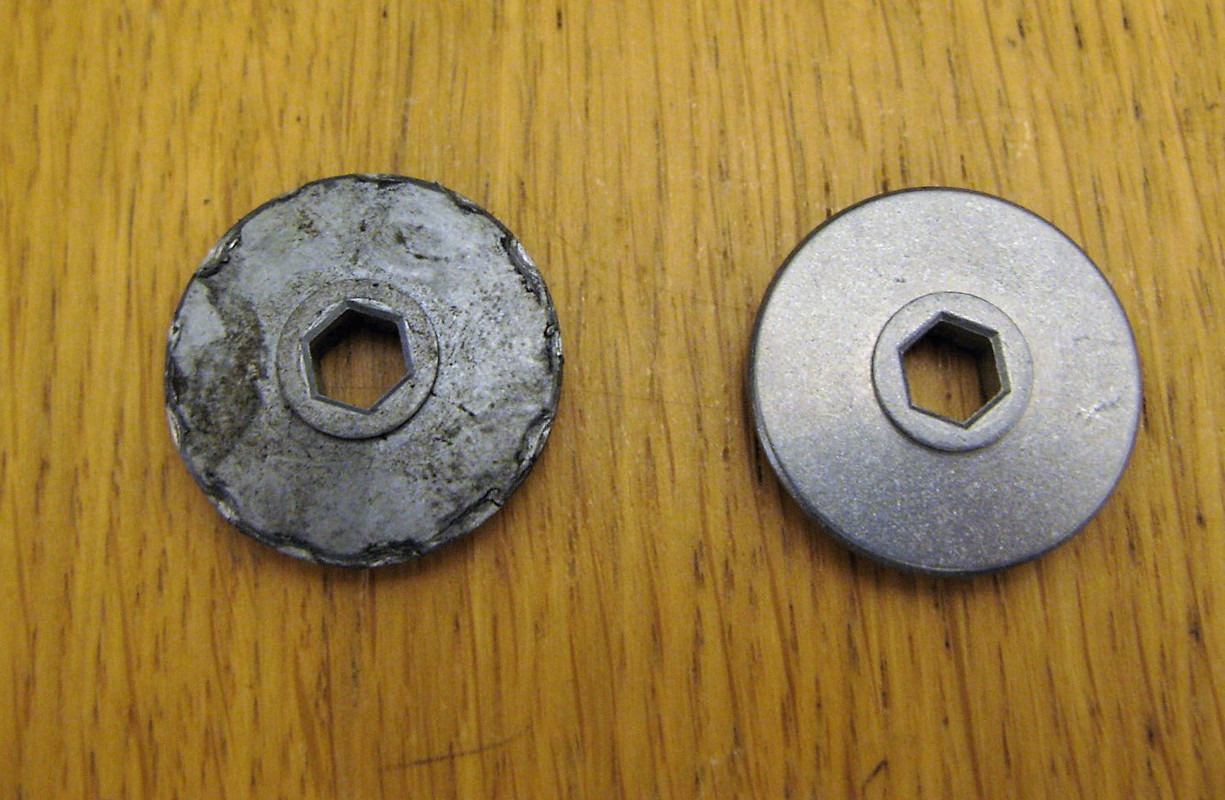

Got the pressure plate on the gearbox swapped over, new v old

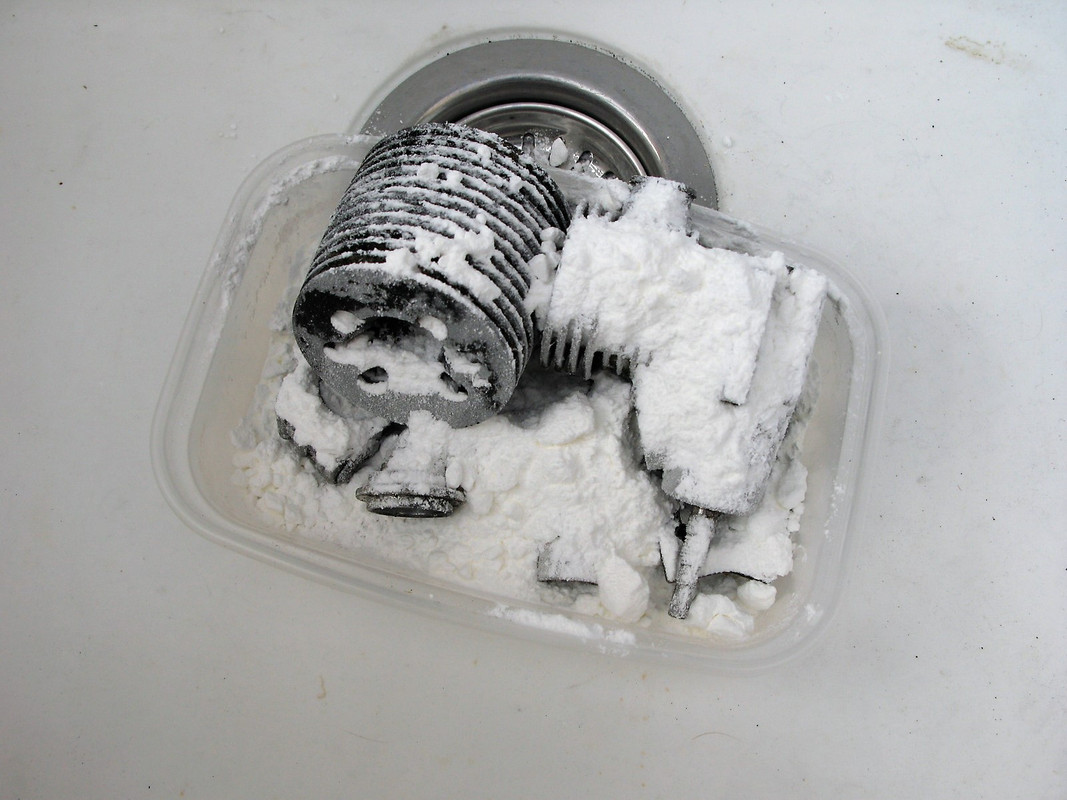

and started to clean the engine. Following the same procedure in my TGS thread.

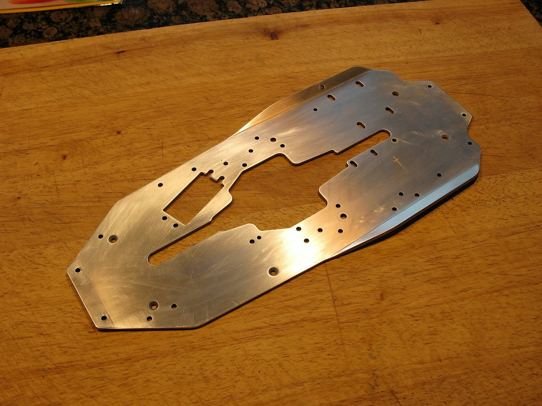

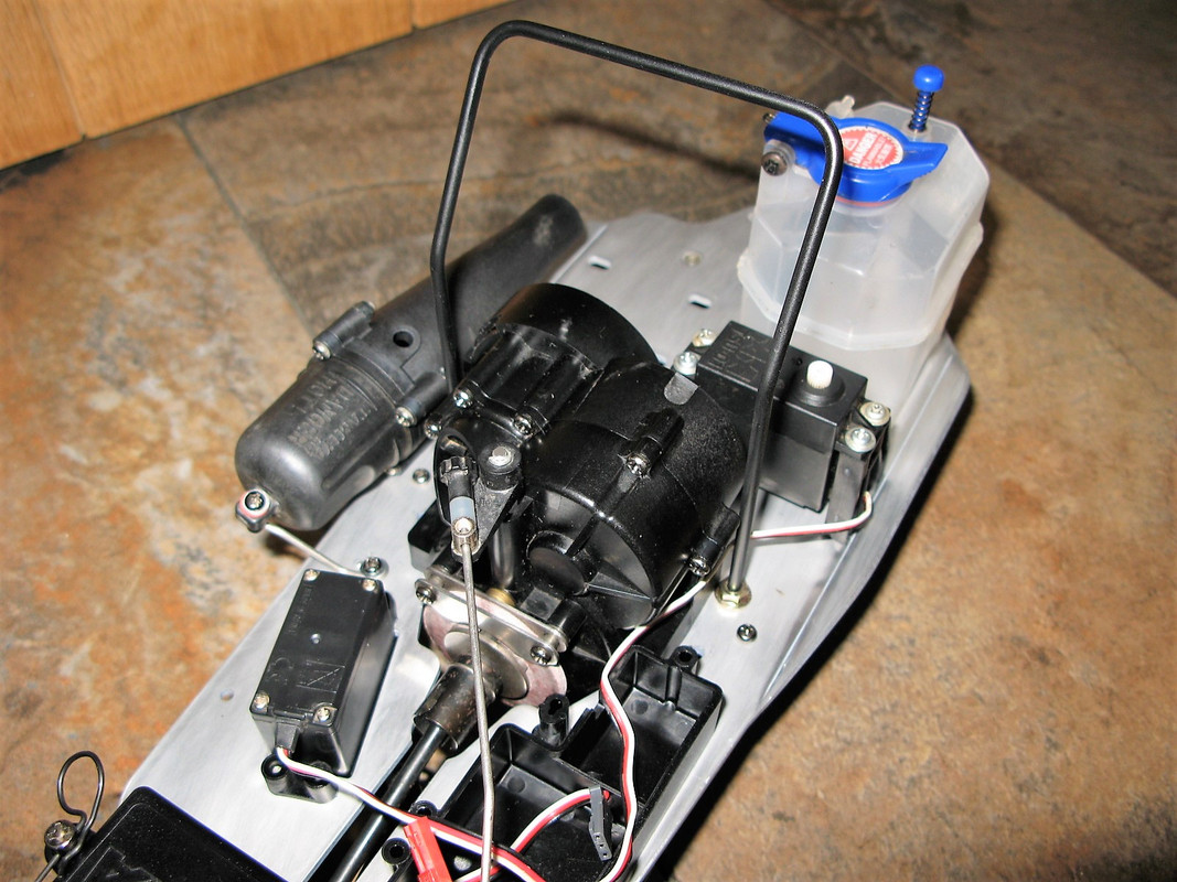

So after working the chassis plate through various grits I finished at 2500. I didnt want it polished but more matt looking like the original. Bear in mind this part has never been released by Tamiya and I have never seen one I am happy how it came out.

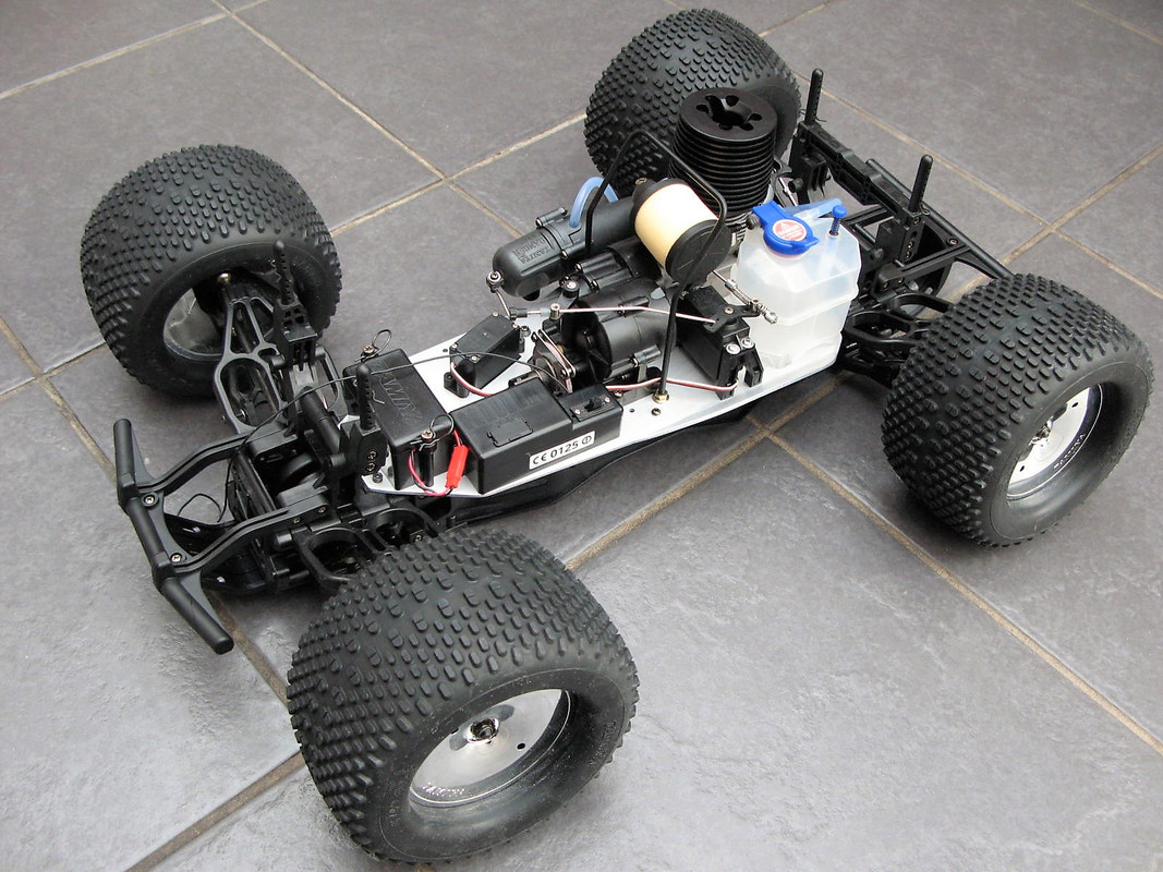

With the chassis done I started to build her back up. More work today but coming along nicely.
That’s a lovely finish, it looks factory.

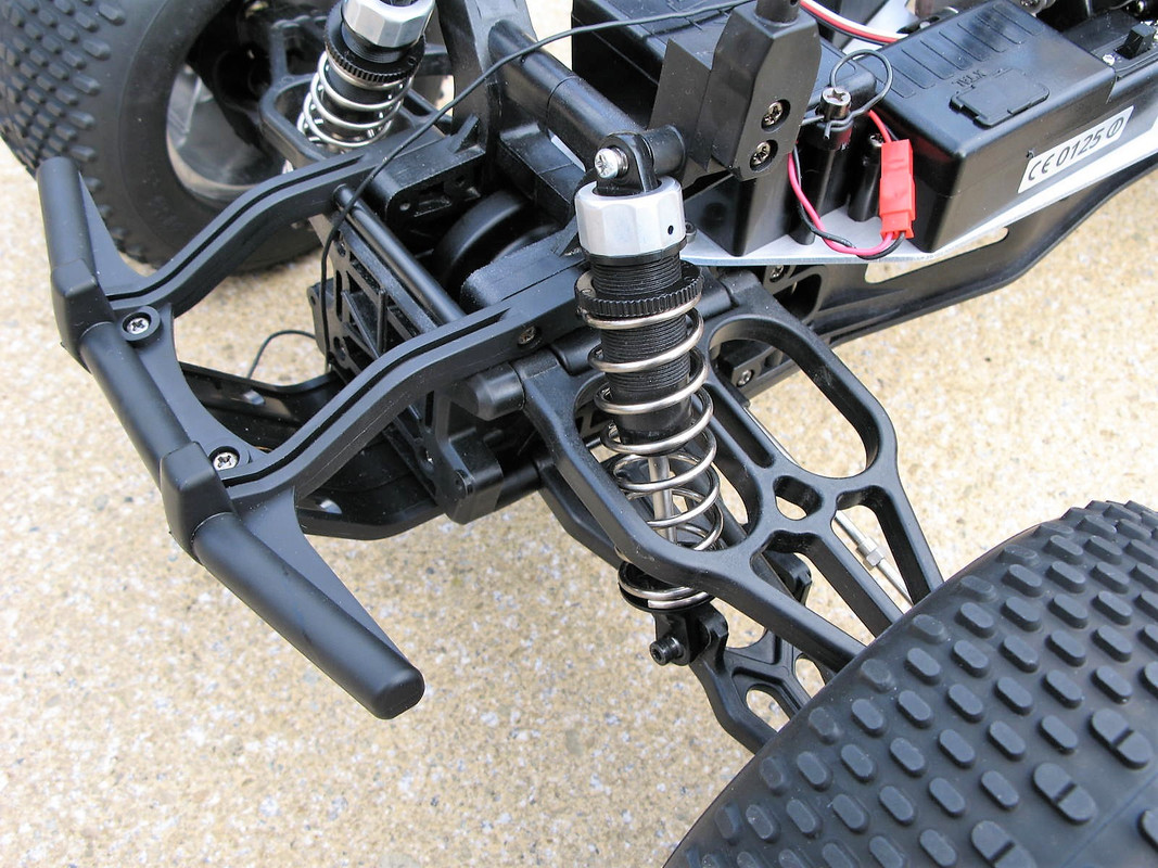

The basic chassis is almost done now. I have just prepped and sprayed the engine heatsink and then the engine can be fitted back onto the chassis. After that it is just the dampers. The caps need to be turned silver like the chassis and silver springs sourced and fitted.
Getting there!

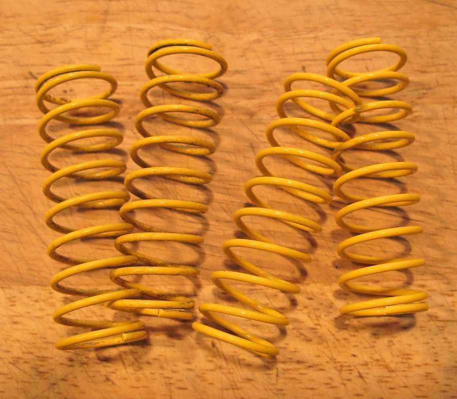

So haven't updated this one for a while. I have been away with work and also had some difficulties with parts, mainly the shock springs. As mentioned previously Tamiya never made these in Silver as a replacement part (like the deck and shock caps) and I have had to get some made specially for the car. They are coming from China, so whilst I wait I sorted out the other shock parts.

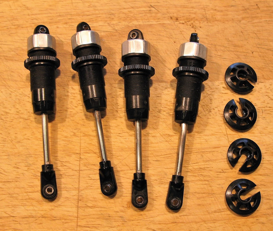

As they are today
Stripped down
The yellow springs will go in my TGM parts spares box, ideal for a runner.

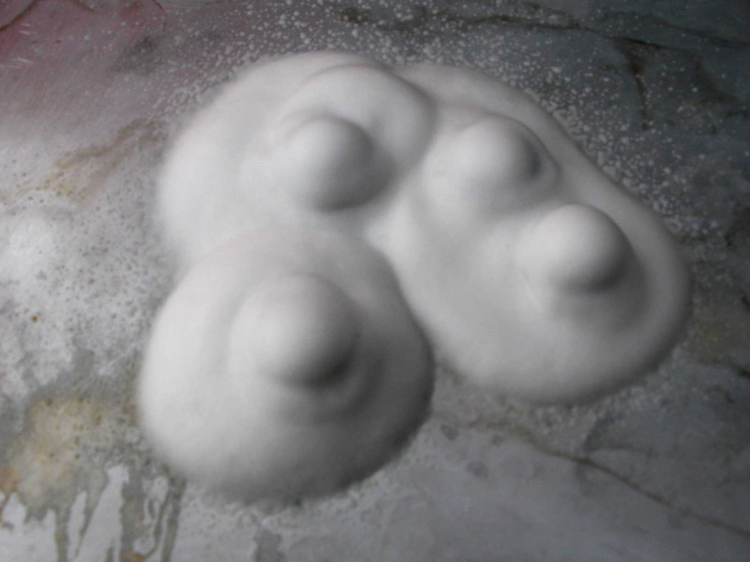

On the Gold Edition these caps need to be silver and Tamiya have never released them in Silver to buy.
So just like the chassis into the Oven Cleaner they go.
and then after 30 mins they are washed, cleaned and then rubbed down with 600, 1500 and 2500 grit wet and dry. Once back on the shocks they look ok, maybe some polish needed.

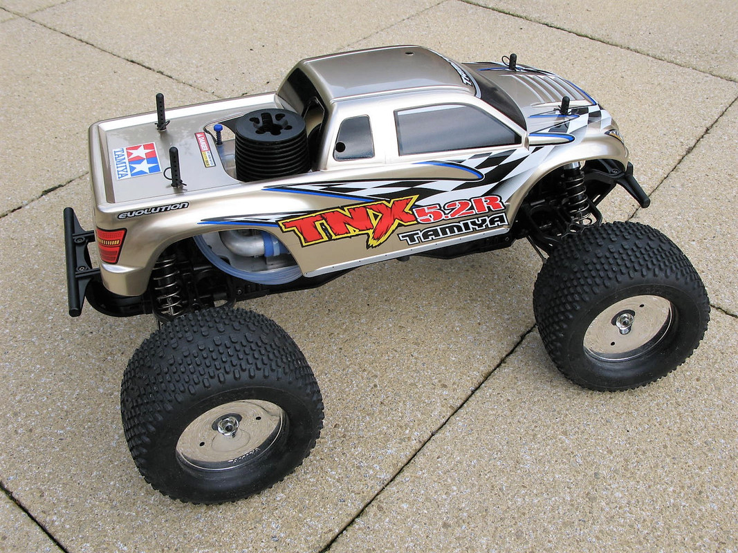

and without body
Just awaiting the new springs to finish and fit the shocks now and she is more or less done. Finished pictures soon.

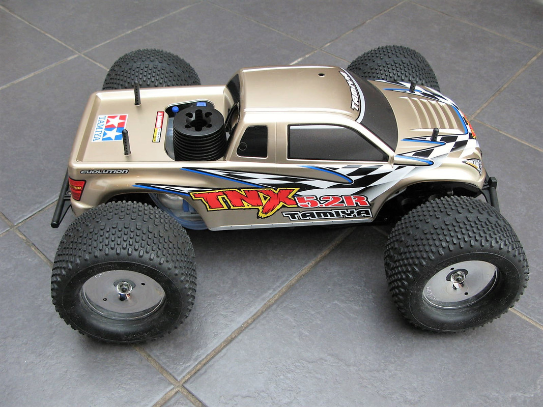

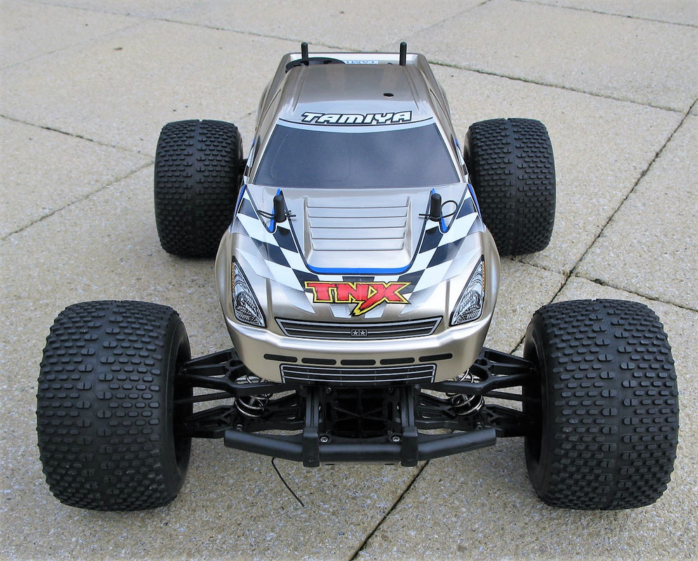

So,
The springs I had made finally came from China and it was an easy job to get them fitted and then attached to the truck

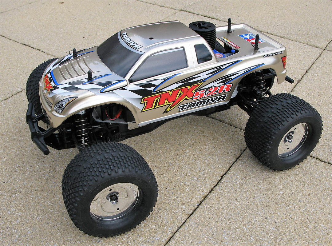

And that was then her finished, very happy with the way it has turned out. On to the next one.
