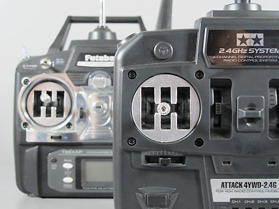

I had ordered a Futaba 4YWD Attack radio and receiver, as well as a 4 x 4 Slipper Clutch kit. I finally had the time to work with them, and quickly prepared everything:
“Quickly” does not describe the ensuing process of rigging up the radio and installing the slipper clutch, as we will see. A lot of it had to do with my expectations for the radio, and one lost bearing…
I set up the Futaba 4YWD’s supplied 4-channel receiver with few problems:
The radio itself left a good initial impression. With its array of switches and sliders, the large radio really felt like an old 1980s device, but the capacious battery bay only needed four AA batteries; the rest was blanked. It may be a testament to the efficiency of current electronics, since the radio uses 2.4 GHz technology in a case that clearly accommodated frequency-crystal-type internals. Curiously, the bay separated the batteries into two pairs – one on each side – instead of clustering them together.
This resemblance between the 2.4 GHz version of the Futaba Attack and its crystal-type relatives should have tipped me off that the radio would not have end-point adjustment for the servos.
One thing I was excited about was the inclusion of an on/off switch with the radio – maybe I could hook up the ESC and have something to stick onto the mechanism box lid! Alas, it failed to work, with the Axial ESC not recognizing the switch. I am unsure how some in the crawler community break multiple on/off switches in their models, but I will get used to a lack of one for the sake of the Axial ESC’s drag brake and LED output; ultimately, those are more important to me.

My initial impressions of the radio gear’s performance was still poor: coming from the efficient 3-channel setup that I was using for tuning, this dedicated 4-channel equipment only served to slow down and add ambiguity to each shift. Without end-point adjustment, I could not look to prevent excessive wear on the shifting and steering servos, either.
However, the 4YWD Attack is claimed to be designed for the 3-speed trucks – Tamiya even has their own rebranded version for this purpose – and as such, end-point adjustment proved largely unnecessary. The shifting servo only buzzed if the shifter was moved without any wheel rotation, and after some practice they were silent at their limits of travel as gears were selected. The steering servo showed some signs of excessive travel, but did not strain too hard at full lock in either direction.
The purpose-built nature of the 4YWD is accentuated by the inclusion of an adhesive round sheet, cut into the shape of a shift gate, for use with the throttle stick. This part appears compulsory for safe operation of the shifting servo on these stick radios.
In short: all my misgivings and flaws that I perceived were for nothing once the radio was in. I still think the old 3-channel setup performed better, and using its 3-position auxiliary switch minimized the time spent off-throttle. The trade-off, though, is a control system that captures more of the feeling of the full-size thing, and for a scale truck like the Bruiser, this is worthwhile.

That first run was fantastic - I really enjoyed shifting it through the gears using the Futaba Attack radio I had set aside specifically for this truck. As before, I did manage to make it work with a 3-channel pistol radio, with the 3rd channel switch handling shifting. That actually resulted in smoother shifting and less fatigue, but why do that when you can literally row through the gears as with these radios:
I did have to change the drag brake setting on the ESC to improve shifting, as the truck wanted to brake whenever the stick was in neutral. With some practice, eventually I got adept at shifting gears without too much crunching!
