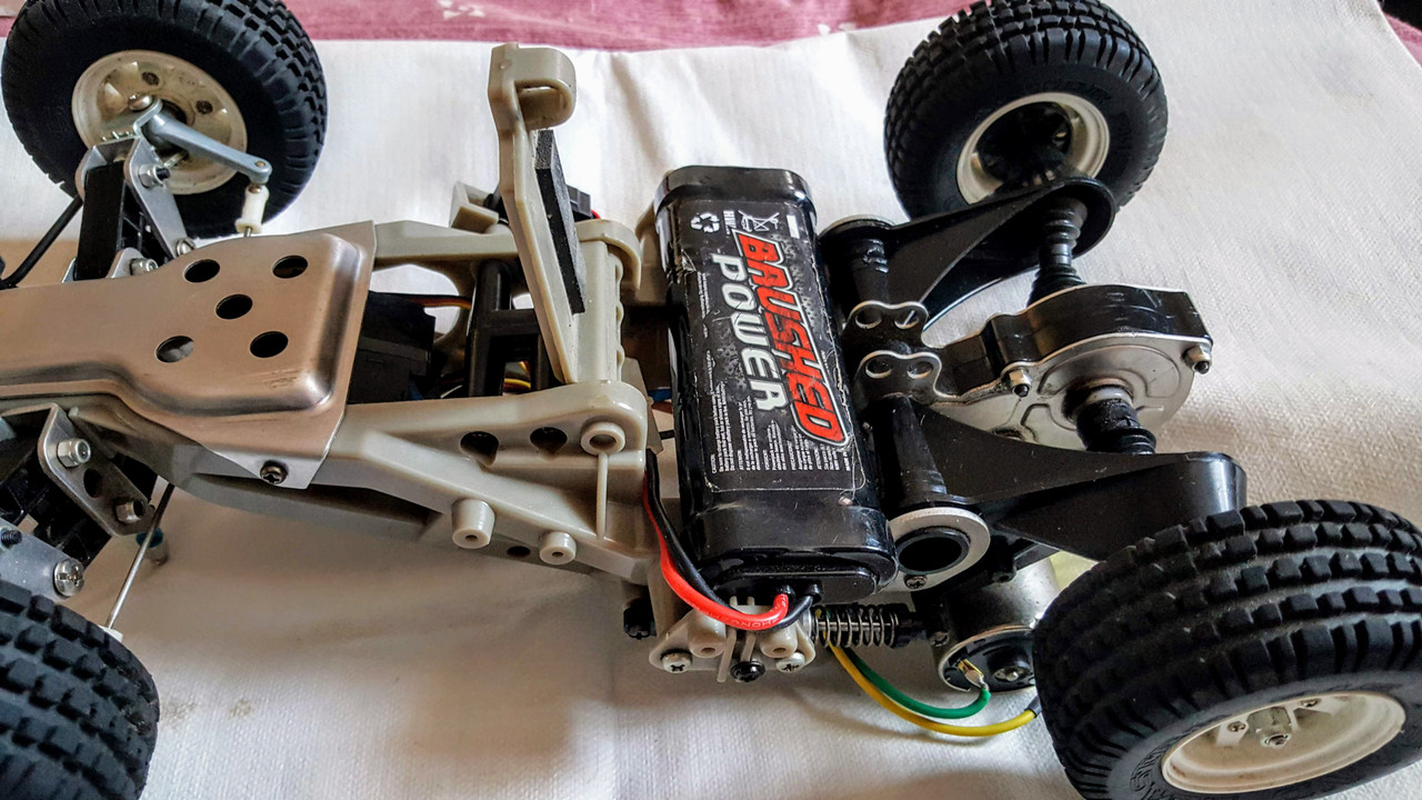

Anyway, a quick passing question for all you veterans in the know; I noticed as I installed the battery that the cable and connector sort of hangs out the right side of the car (see photo) with seemingly no obvious place for it to be tucked away. For such an otherwise aesthetically pleasing car, its oddly disturbing me. Should I tape it to the side? Has anyone a workaround, or am I just being precious and will I not even notice it after a bit? Shouldn't the connector be a bit more protected? By contrast, the Grasshopper battery cable and connector, due to the orientation, is completely hidden inside the car.

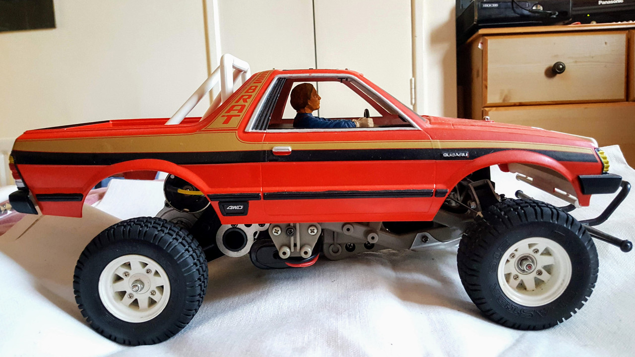

@HopperLeo  Hi. There is enough space where the battery goes to tuck the cable and plug alongside it and up into the chassis. I put my battery cable like this in my Subaru Brat, which uses the same chassis as your Frog. It's all safety out the way from the outside :D

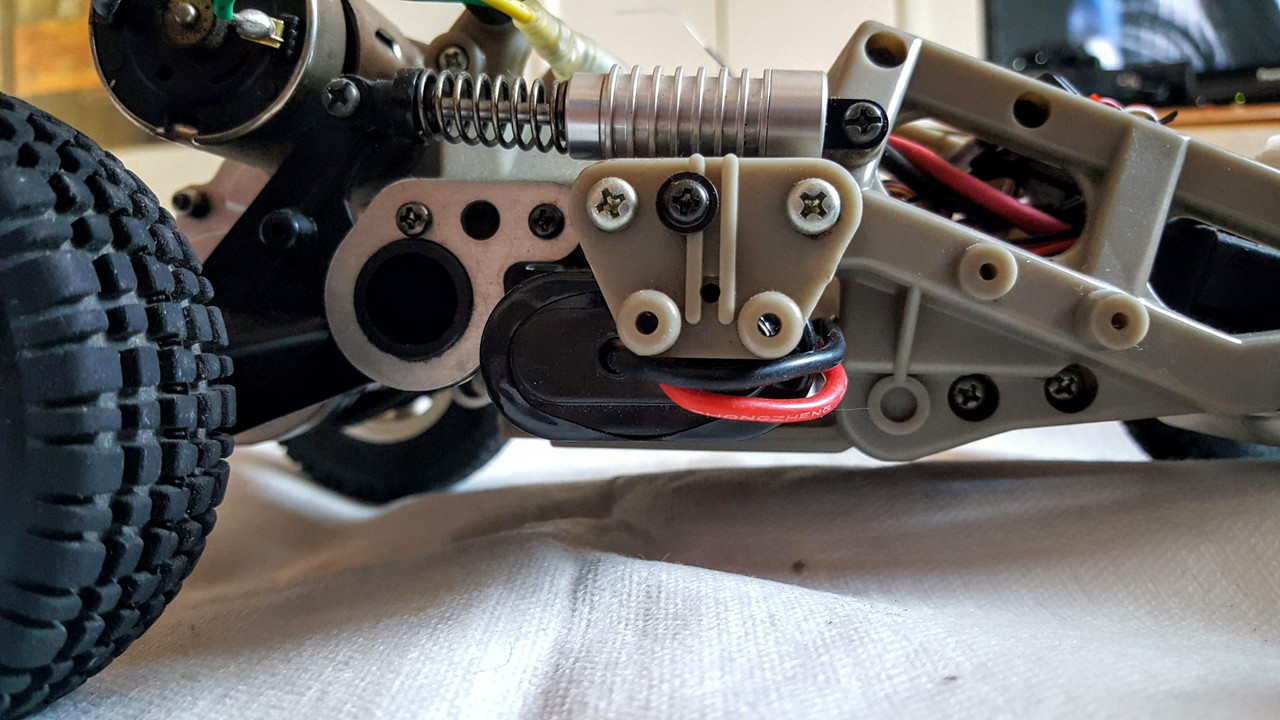

Ok, I just tried running the cable along the other side of the battery and tucking it down into the chassis...and it fits! Sorry for bothering you with what was clearly a very newbie stumbling block :wacko:
A bit more of a fiddle than the Grasshopper, but now that I know how it goes, all is good!
Cheers :)

@HopperLeo You're very welcome my friend. I'm pleased you got it sorted. You may want to put some tape around the cable, or something in between where it goes under
the metal bracket though. If the battery took a knock from underneath it could possibly push the cable up and cause it to be damaged or cut by the bracket.
