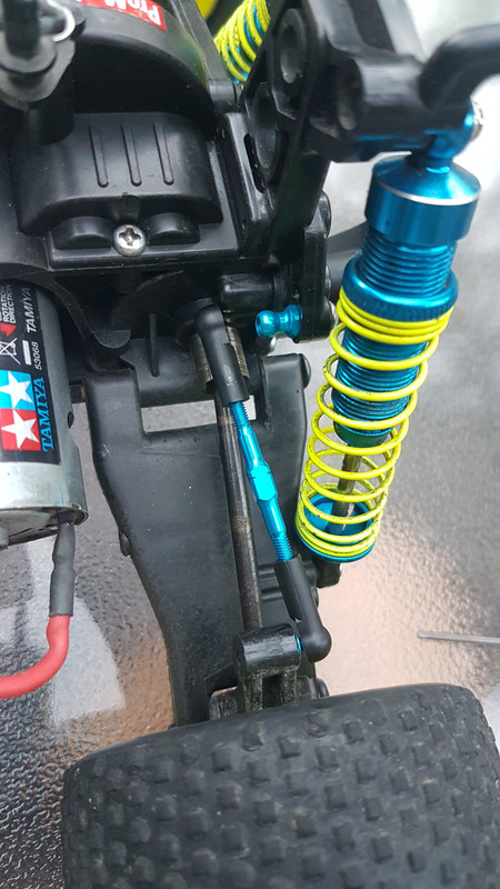

Found what I need!
These turnbuckles are available in the lenght I need.
I now have to figure out how to link them to the stock shock towers, which have a bigger bore.
Any thoughts on what part can do the trick?

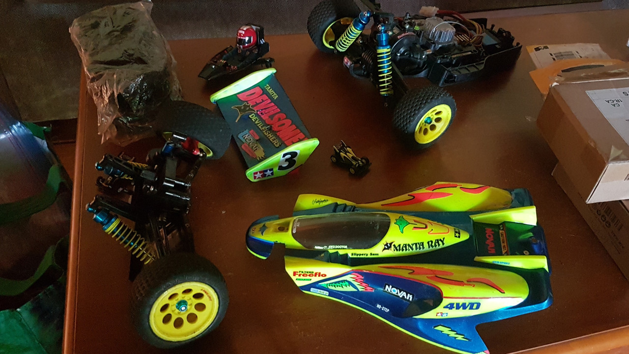

A few hop-ups I've ordered a while ago finally showed up.
Front, rear and steering turnbuckles, aluminum hexes, hardened aluminum pinion, touring plastic gears, hard steel prop shaft, aluminum steering links and some vintage Eagle spiked tires.
I also got a bluebottle brushless motor that arrived today, unfortunately it's sensorless so I can't use it with the TBLE02s esc, which I forgot about when I bought it. The brushless experience will have to wait for another esc or a sensored motor.
Thanks @MICHAELs TopForce17 and @matisse for the help with the turnbuckles' measurements and links, I started the rear ones and everything fits perfectly so far.
It's probably gonna get a little face lift too, at this point

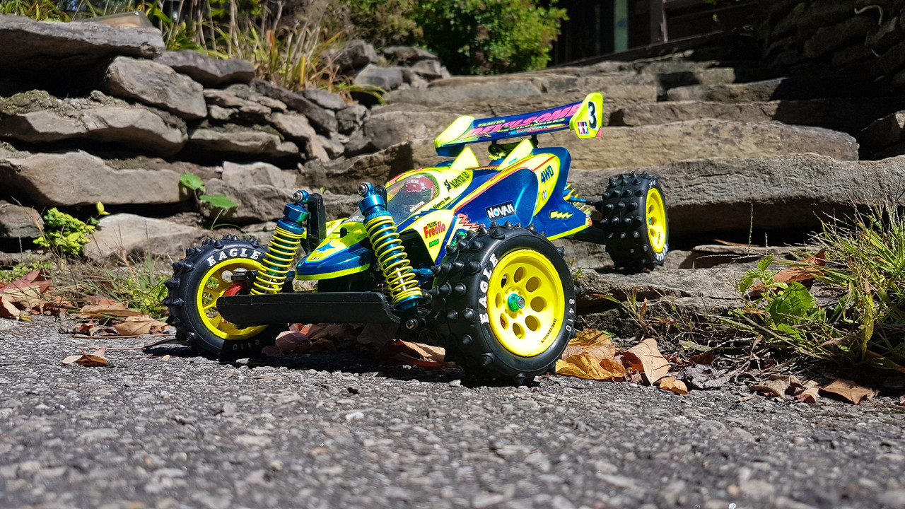

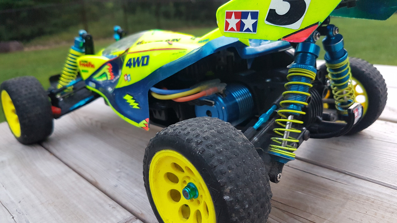

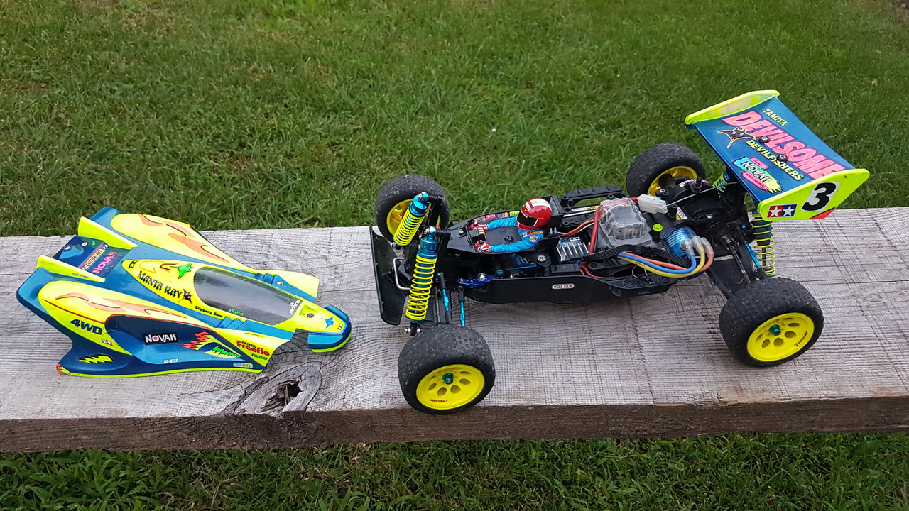

Done with the upgrades and the fecelift, plus a 13.5t Bluebottle brushless motor is now installed!
I took the car for a few speed runs on tarmac today, and wow! It's pretty fast, even on NiMh. Can't help wondering how it would be with Lipo...

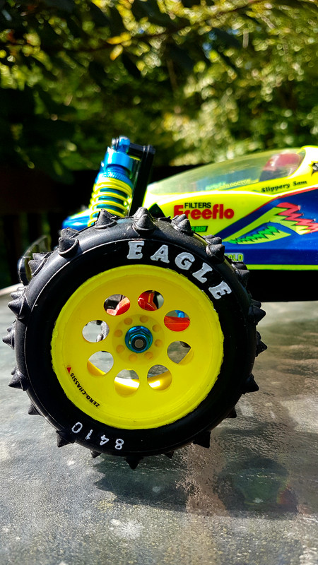

Now that I tried it on asphalt I will mount the Eagle spiked tires for offroad and this round of upgrades will be complete.
When I placed it back I guess the driver was happy with all the new bling :D

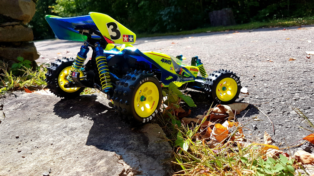

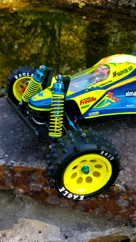

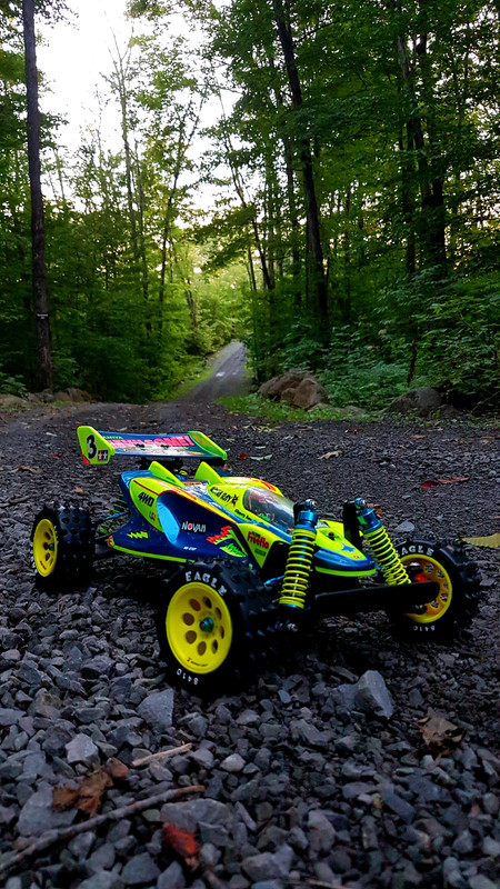

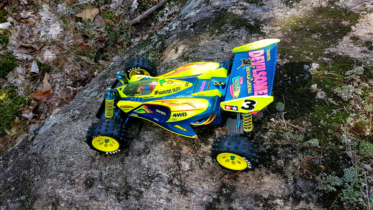

I eventually got around to mounting the Eagle spiked tires on the Manta Ray, now it's finally complete!! I love how it looks so got plenty of pics while it's still spick and span, as within a few hours it will probably be all dirty again, with definitely no trace left of the lettering on the tires :lol:
