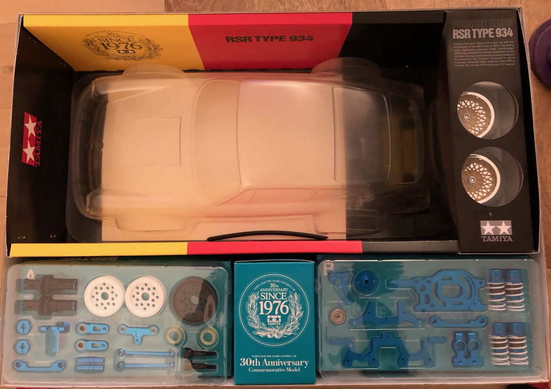

For those that don't know much about this kit it was released in 2006 as a commemorative model to celebrate the original 934 from 1976. It's a lovely model and it's worth taking a good look at the packaging, as it's without any doubt for me the nicest that Tamiya has ever produced.

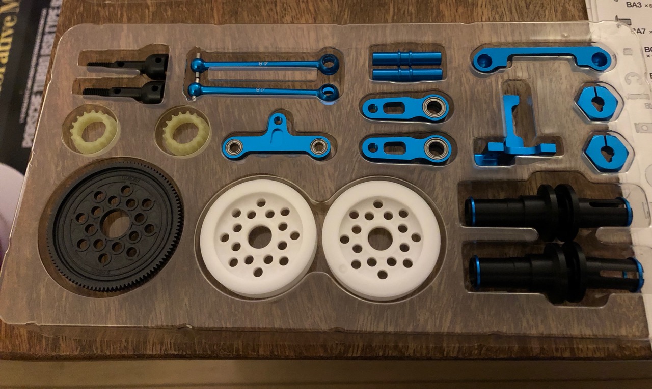

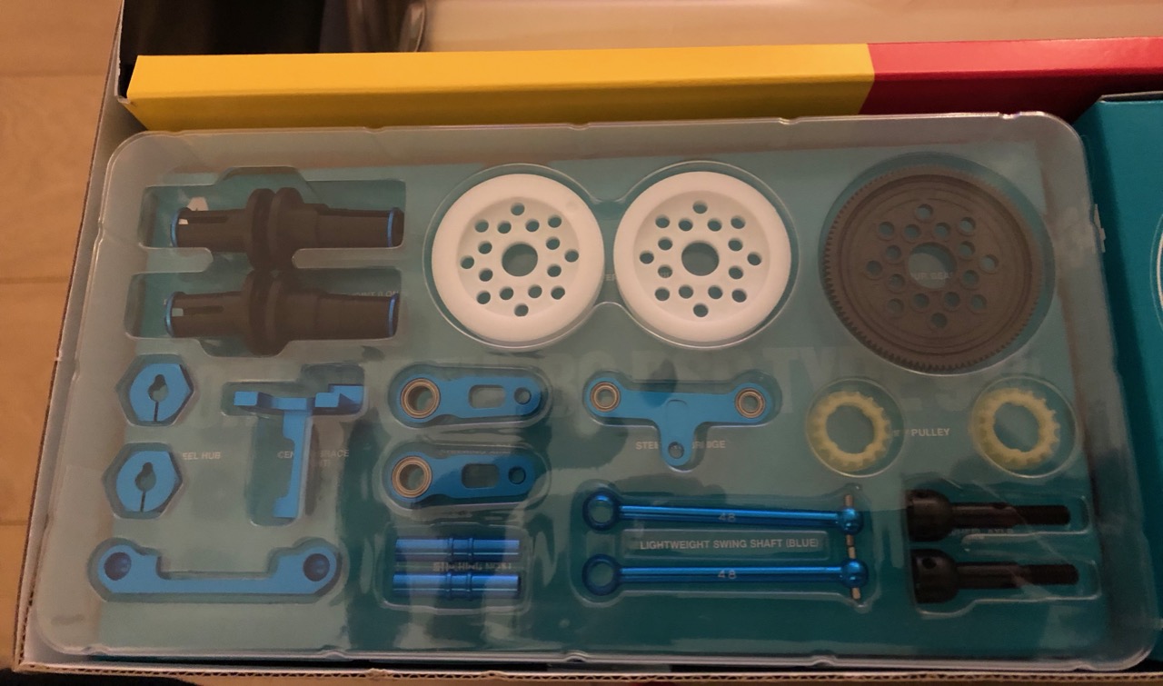

This is high end blister packaging :). It's actually two part, and the outer skin lifts off to reveal the parts in the inner skin.
Lots of blue in here. And lots of carbon. And lots of that reinforced plastic (the dark grey stuff). The kit itself feels very TRF, just in display packaging. TRF dampers I think, too.
It comes with this nice fold out which explains about the model release. You can see Tamiya went to a lot of care and attention here. Great details. Someone loved designing and making this kit and really thought about the experience of the person owning and opening it up. Lovely job Tamiya. I'll try and do my bit by putting lots of care and attention into the build.

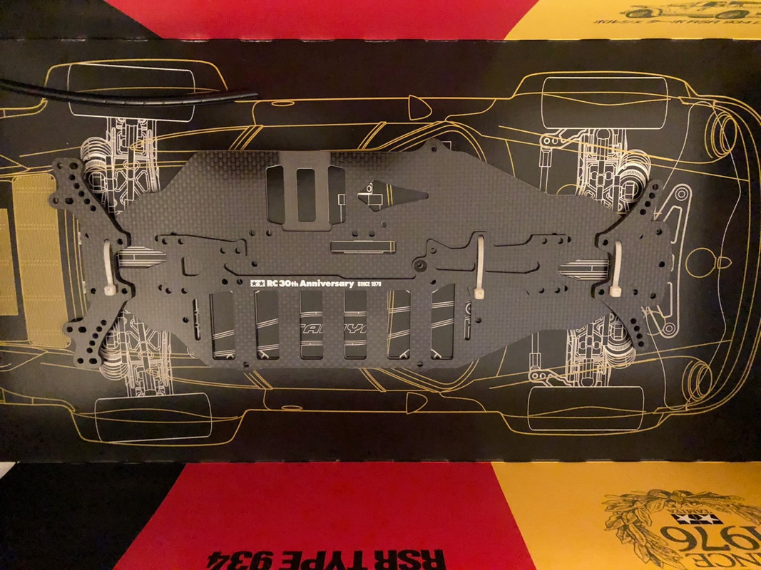

The carbon is marked up "30th Anniversary". Again feels very TRF to me, nothing cheap about this kit (well, maybe a couple of small things - more on that later). Note the German flag colours here (from memory they did the same on the Black Porsche special edition?).

So first step is to CA the carbon. And I skipped that. Two reasons - first, whenever I've tried to do it I've made a mess, and mine always look sloppy and I don't like that look. Secondly, I'm only ever going to run this lightly and carefully, for obvious reasons. So I'm not really interested in the re-enforcement, which I'm also a little dubious about as I've read mixed opinions on it here.

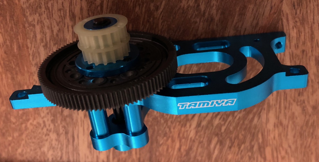

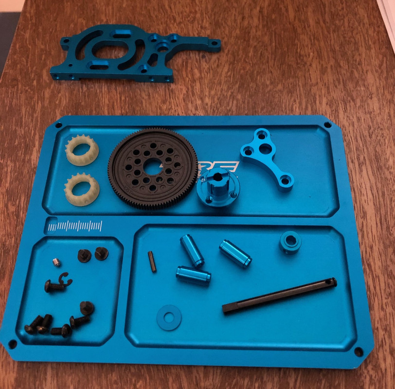

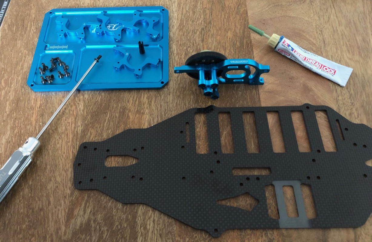

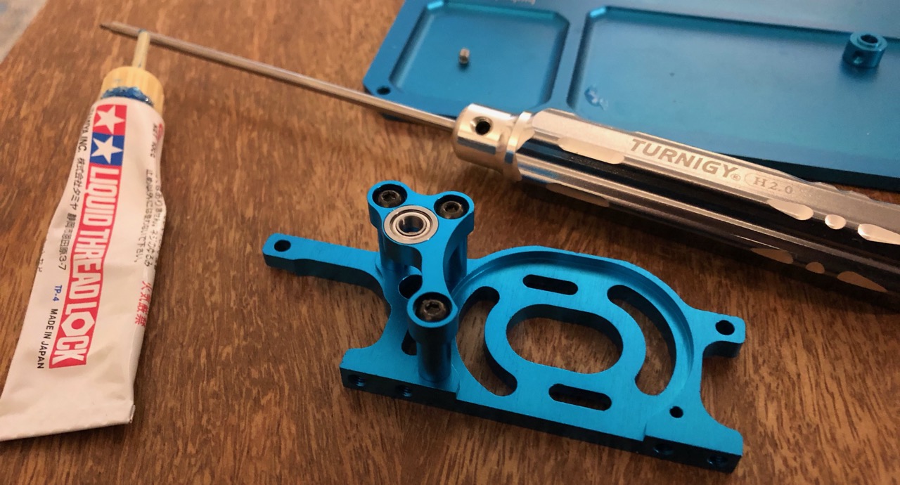

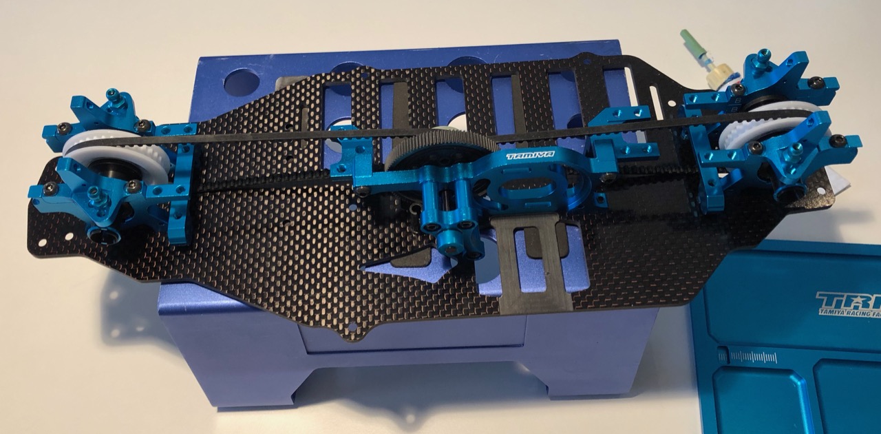

So I went to what is technically step #2 which is middle section motor mount and spur arrangement.
The manual does actually mention that threadlock isn't required. I'm not sure why - due to all the alloy, there's lots of metal on metal and I've never had an issue with using threadlock, so I used it anyway, on all screws going into alloy.

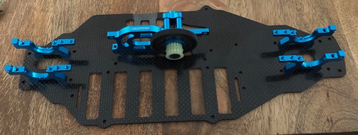

Next up we'll attach that to the chassis and put together the main bulkhead supports.

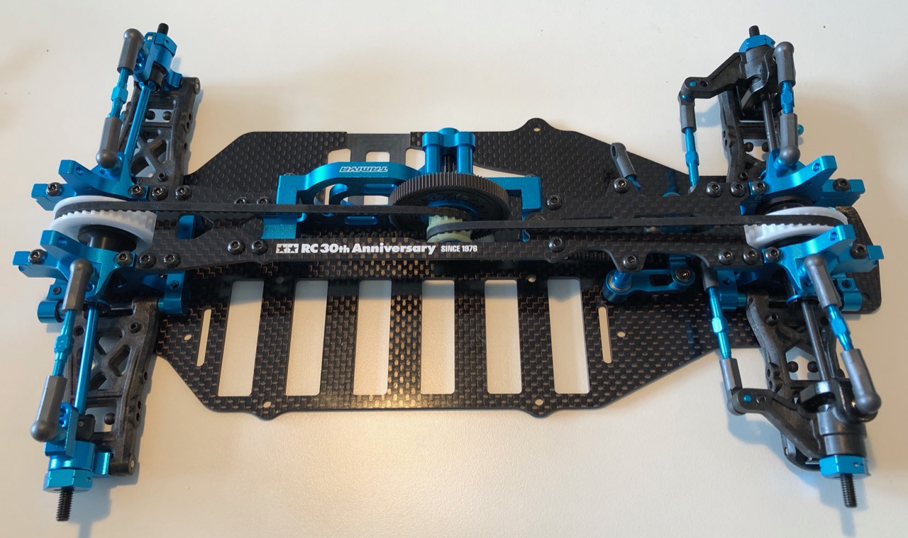

Black and blue :)

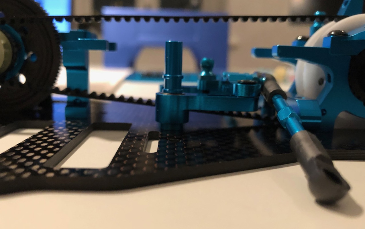

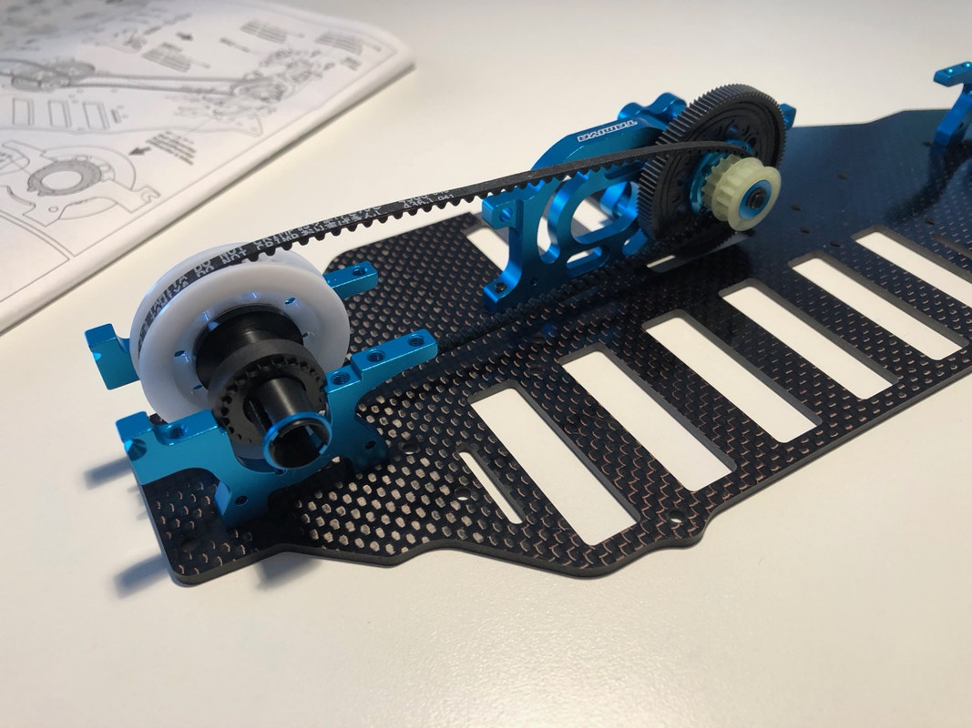

Going to be a pretty chassis this one I think. It's based on the TA05MS, but slightly shorter to take the Porsche body.

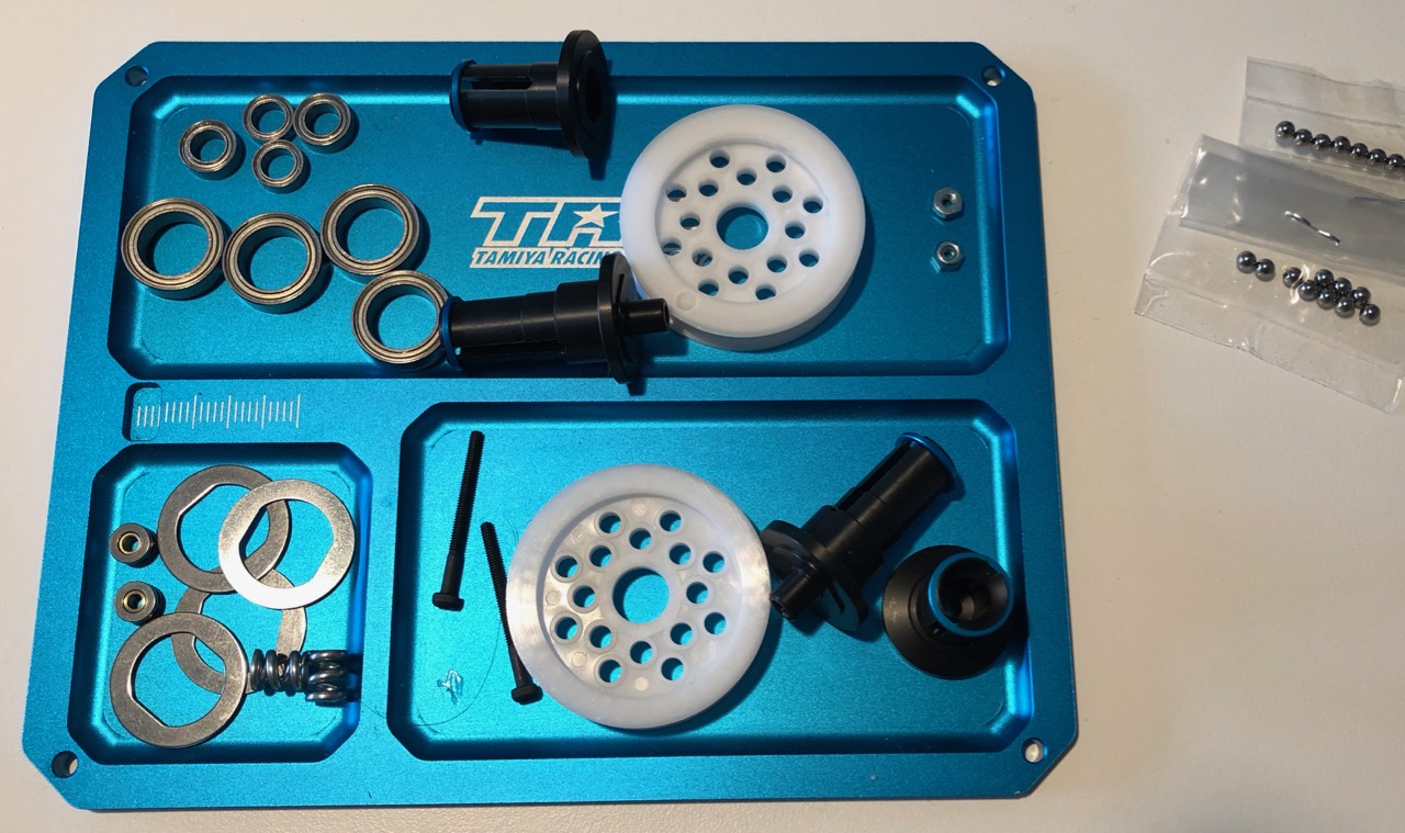

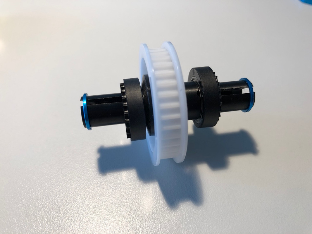

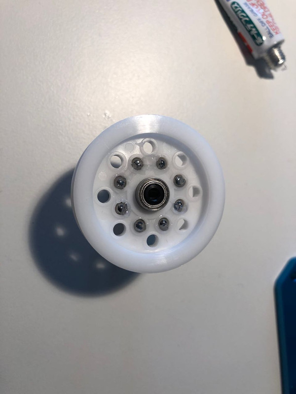

Diffs are up next.

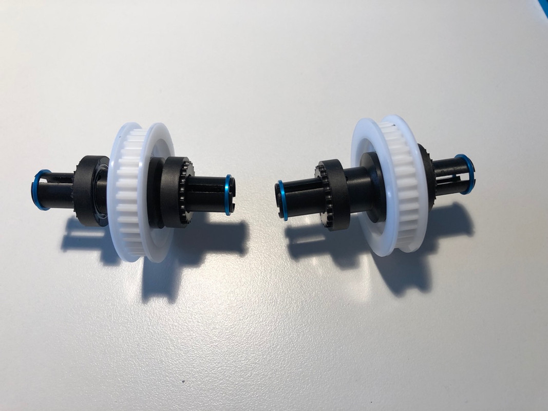

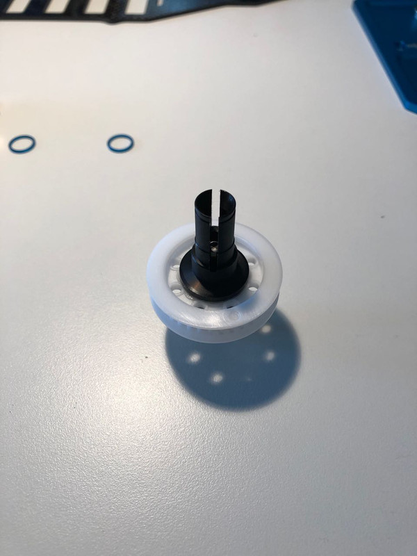

Pretty standard affairs, not quite TRF quality and here's where you start to notice a few things you'd probably change if you were racing this thing. Like the bearings, which are absolutely fine, just the typical packed with grease variety and probably good for long life but not speed. Again, speed isn't what this is about for me so I'm not upgrading them. Will be building the whole kit stock as intended.
Not much to say here other than easy to build and actually nice and smooth. Again if you were racing, you'd probably do some polishing and use a higher end ball and grease. But not for me, it would break my heart to have a high speed crash in this one, so keeping it all stock.

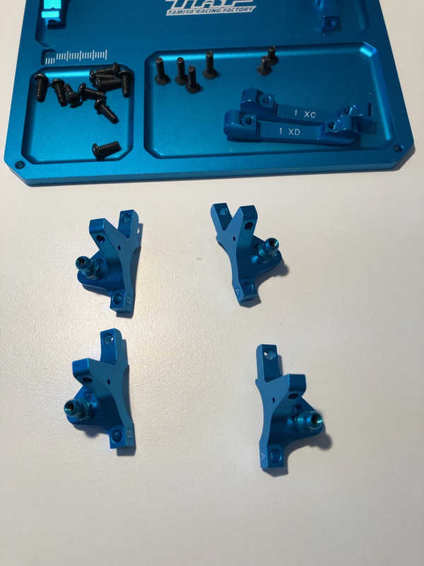

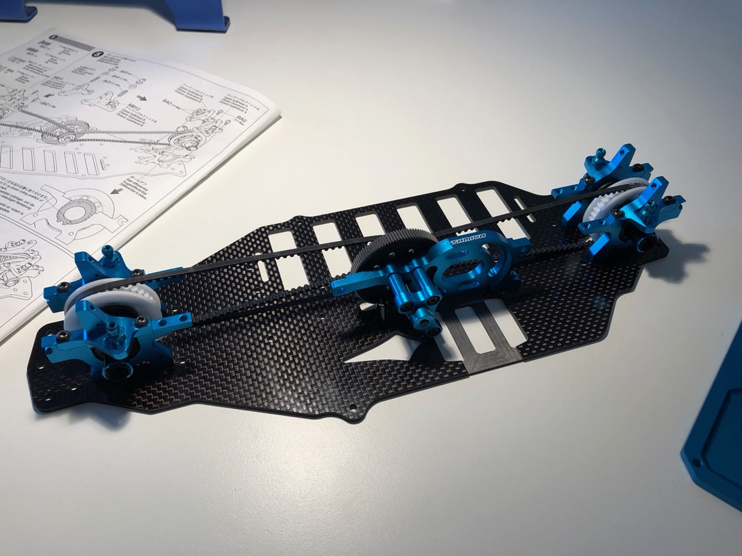

Time to finish off the bulkheads.
Almost all blue, simple construction. Won't bore you with the detail, suffice to say it all goes together easily.

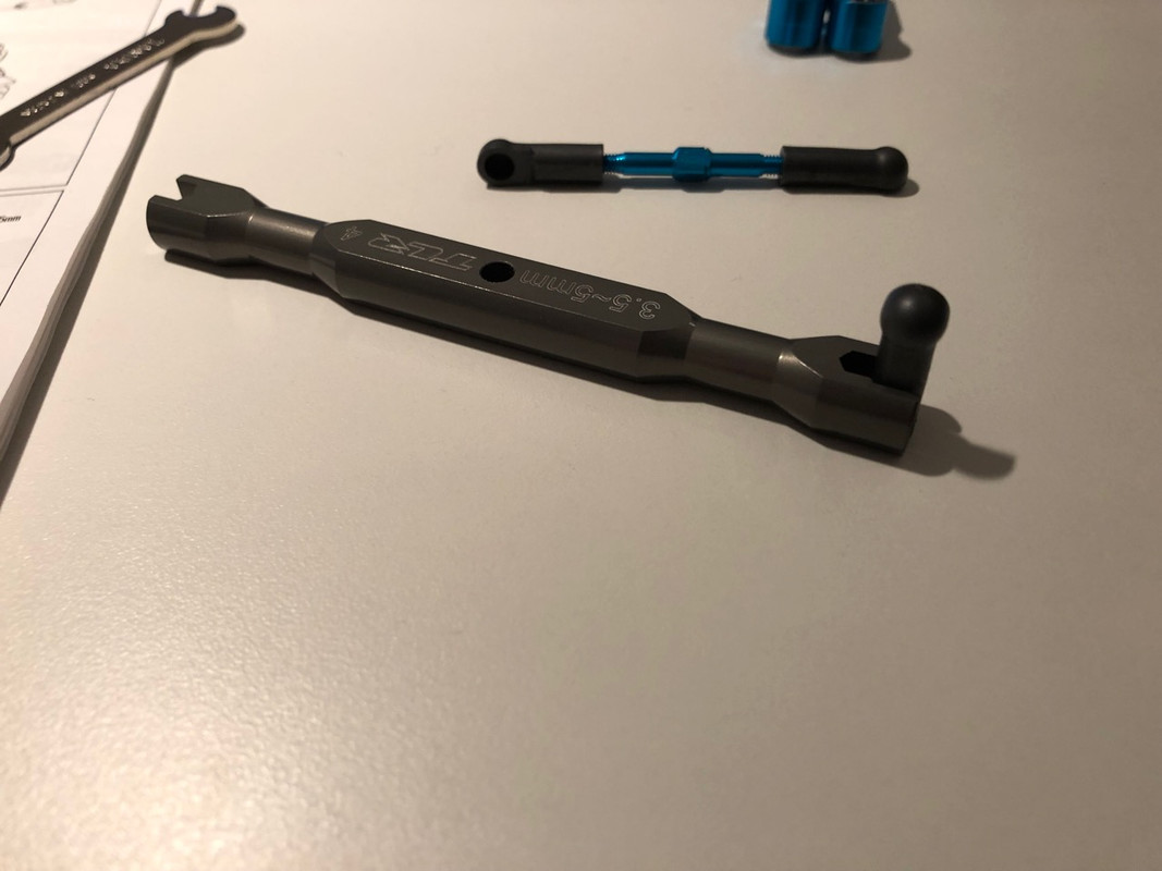

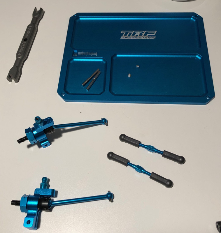

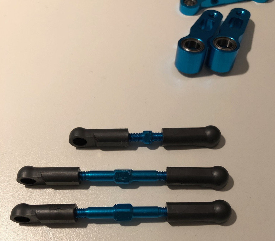

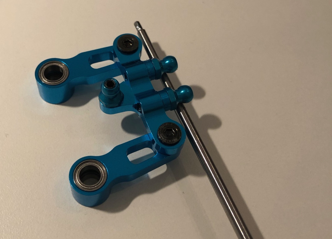

I don't like making tie rods/turn buckles. But this tool does at least make it a tiny bit easier.

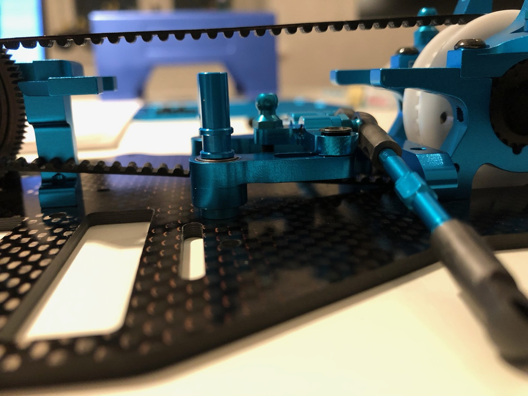

A couple of screws and the steering rack is pretty much there. It's all double-ballraced and  feels very smooth indeed. Best steering rig I've seen in a Tamiya.
Couple of bolts and it's on the chassis.
It really is smooth, and there is zero slop which is something I've never had in any RC car. Am very impressed.

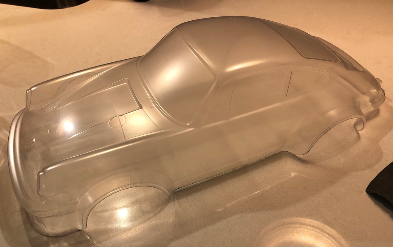

Took a break from that to tackle the bit I really don't like, which is cutting out polycarb.
Edged all the edges in rough with a Sharpie as a guide.
... and took my time with the cutting. No mistakes, thankfully.
I've cleaned the edges with 600 grit silicone paper.

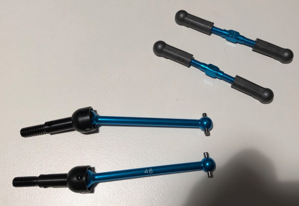

Dogbone time....

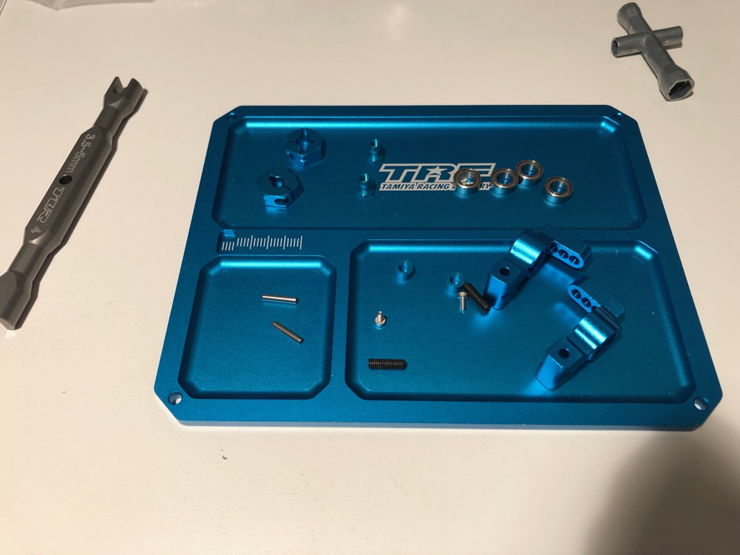

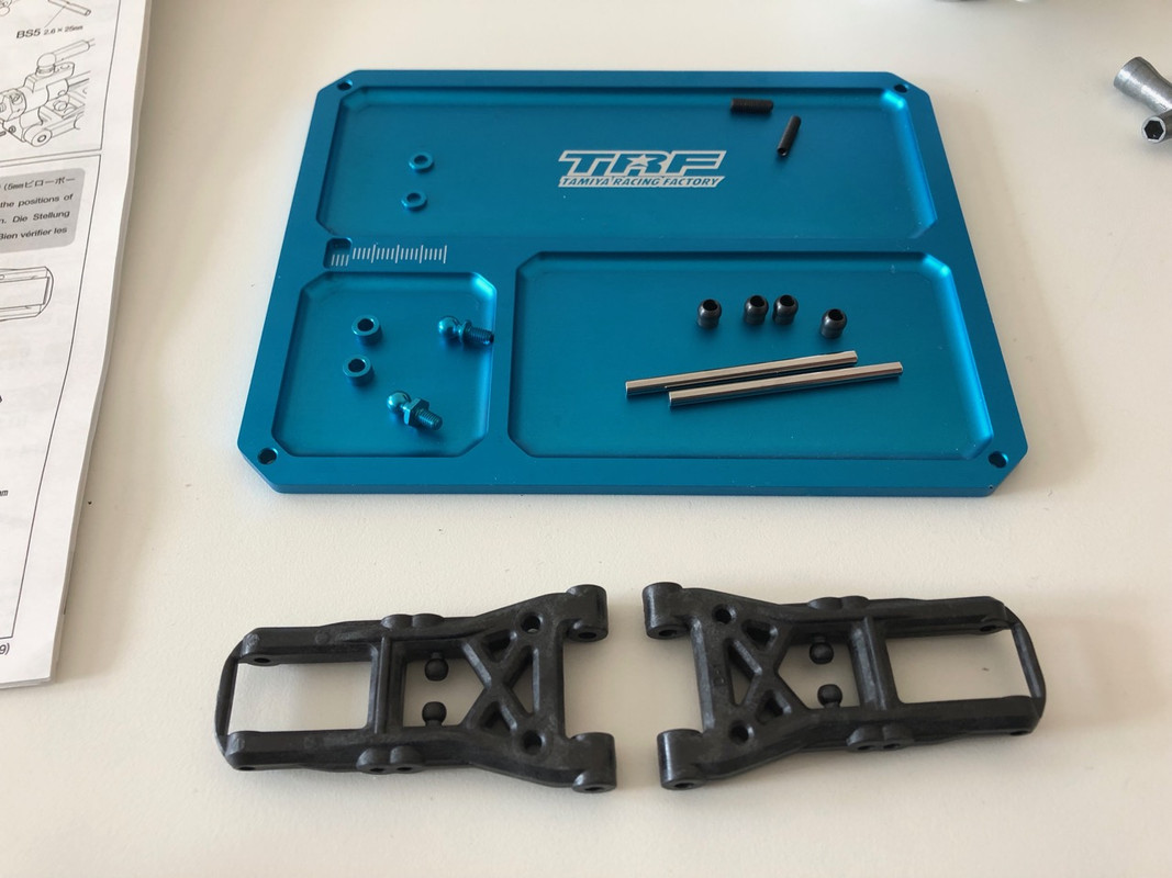

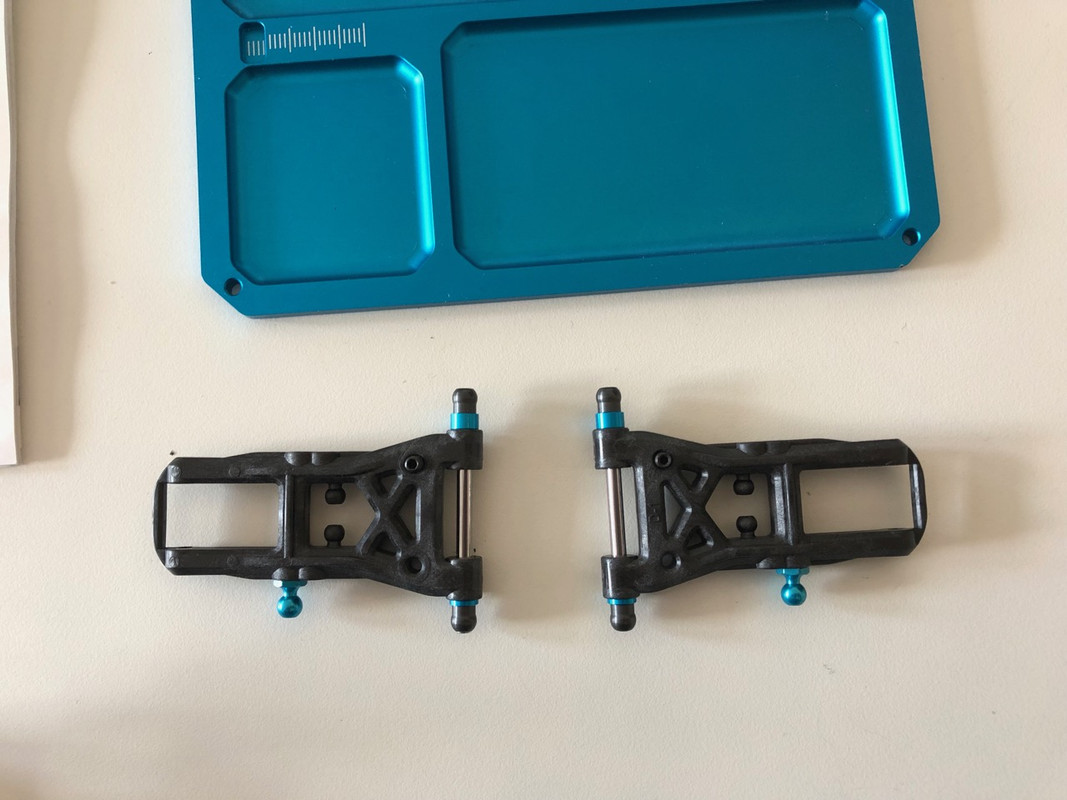

And then some uprights.
Sort of ends up looking a bit like:

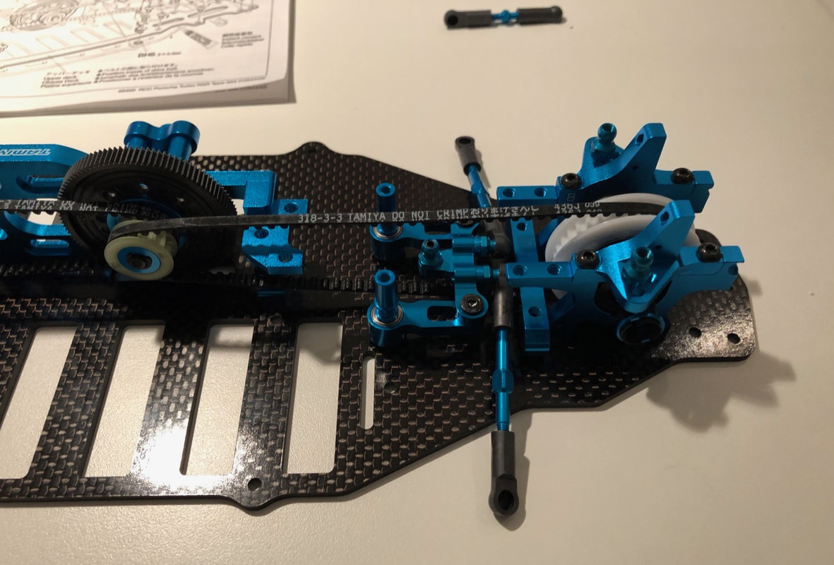

Then it all drops in with a pin and couple of screws. Nice and easy. Starting to look like a roller....

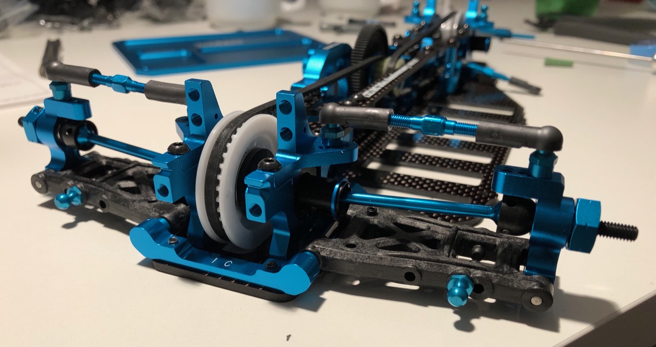

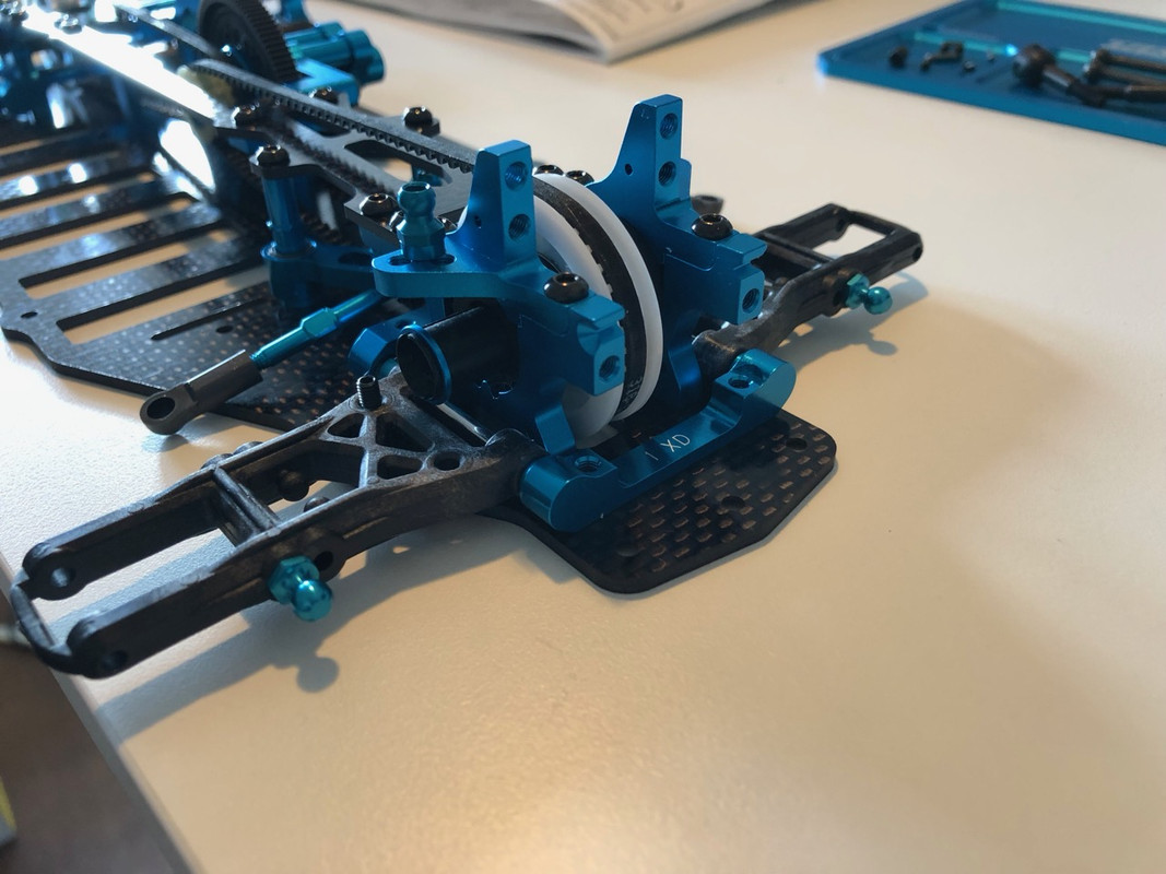

Front next, pretty much the same thing.
The mounts are just sitting in place - makes it a little tricky to get it all together without it falling apart. The manual says to great the inserts on the ends of this pin, but I chose instead to grease the female side as it was a little easier and less messy.
Then they drop into place and this blue alloy stay is screwed into the chassis to hold it all together. I love simple design like this.

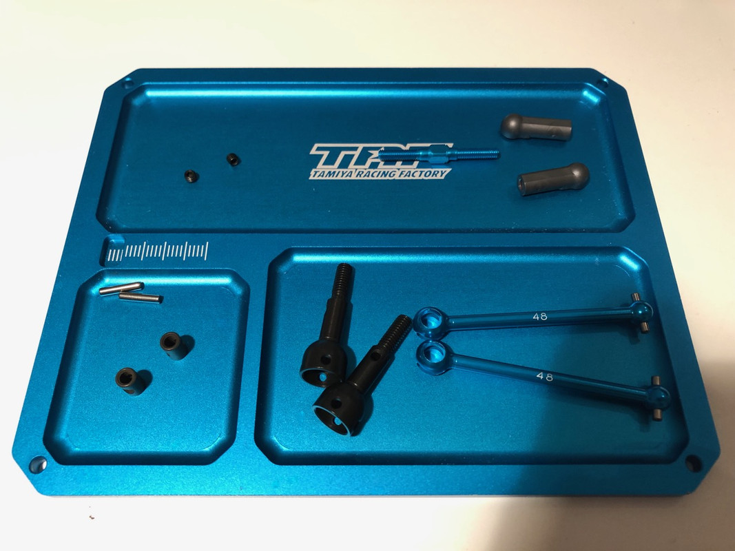

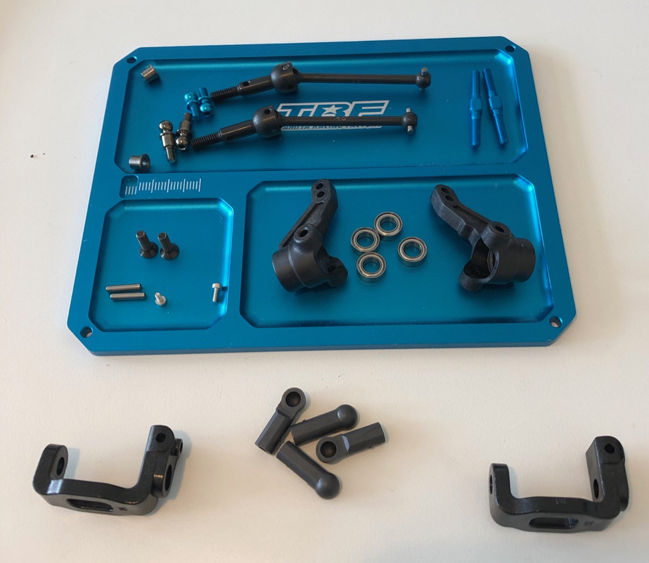

Front uprights. Different colour dogbones, not sure why (different metal?).
Again pretty straightforward.
Then they drop into the place the same as the rear - couple of pins and stays.
"Bit too much blue alloy and carbon on that Tamiya", said no-one. Ever.
Yes, front dogbones are made from some sort of hardened steel, they need to be harder than rears to withstand large angles and vibration caused by steering. Blue are made out of aluminium to save weight.
