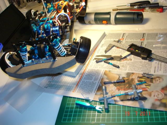

Easiest way to do turnbuckles is to obtain 2 crosswrenches (not Tamiya) that fit the ballcups and the teeny tiny turnbuckle spanner :)
the hopup grey low friction ballcups are a lot stiffer to screw in than stock black plastic
The old hpi cross wrench used to have a ball cap fitting, but it only fits Tamiyas small touring units.
I sometimes use the Tamiya thread forming tool about 20% in to make the turnbuckles easier to start.
No more turnbuckle pain :)
20190427_120615
I had one of those HPI cross wrenches in a box for years and hadn't given it a second look, ordered a second one today :lol:. I've been tapping the ballcups with a M3 screw, lightly greasing the turnbuckles and using the cross wrench to hold the ballcup and spinning with the turnbuckle wrench. Not as efficient as two cross wrenches but a world away from the pliers method.
