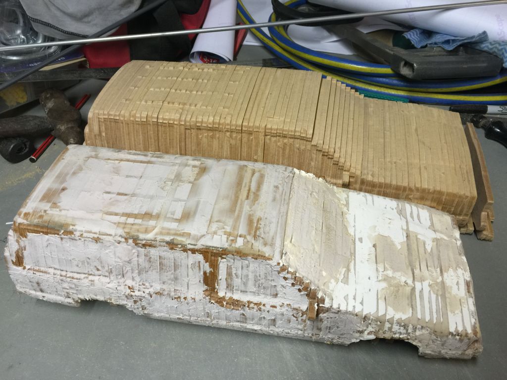

yogi-bear 2746 Posted April 17, 2019 some thoughts as I have tried this too. you should have no trouble finding a 3D model on thingiverse or a stl file from somewhere else. Years ago you where able to use Autodesk 123D (but I think its under a different name now) and you can slice up the model which you can print templates and use that to cut wooden sheets to build up a basic car shape. Can be much quicker than carving from scratch. This is how I initially tried to do a Volvo Station wagon, file was from 3dwarehouse.com. You don't need to do as much as I did, you could make them say for example 30 mm apart and then cover it like you would a balsa plane. But as mentioned above, it would have to withstand high temp. Lexan melts at 155C. On lexan, I think you'll have a lot more trouble vac forming lexan without a very good setup with good temp control and suction. Much easier, even if it its just to test, is to use PETG, it forms a lot easier (using a vacuum cleaner won't be an issue) as it has a much wider temperature range for vac former than lexan. Its almost as strong too, but much more likely to shatter if hit hard where lexan tends to deform a little first. Its cheaper though and polycarbonate paints aren't the best to use on it. 1 1 Share this post Link to post Share on other sites
80skidtoo 4 Posted April 17, 2019 Wow that’s awesome 5 hours ago, yogi-bear said: some thoughts as I have tried this too. you should have no trouble finding a 3D model on thingiverse or a stl file from somewhere else. Years ago you where able to use Autodesk 123D (but I think its under a different name now) and you can slice up the model which you can print templates and use that to cut wooden sheets to build up a basic car shape. Can be much quicker than carving from scratch. This is how I initially tried to do a Volvo Station wagon, file was from 3dwarehouse.com. You don't need to do as much as I did, you could make them say for example 30 mm apart and then cover it like you would a balsa plane. But as mentioned above, it would have to withstand high temp. Lexan melts at 155C. On lexan, I think you'll have a lot more trouble vac forming lexan without a very good setup with good temp control and suction. Much easier, even if it its just to test, is to use PETG, it forms a lot easier (using a vacuum cleaner won't be an issue) as it has a much wider temperature range for vac former than lexan. Its almost as strong too, but much more likely to shatter if hit hard where lexan tends to deform a little first. Its cheaper though and polycarbonate paints aren't the best to use on it. Wow that’s awesome! I’ll have to check that idea out. Also good mention on the PETG, I’ll try that rather than Lexan, besides the project of making it these are going to be used as runners for 3 boys (10-13yrs old and their big kid dad, haha) lunchbox, pumpkin, Blackfoot and Blitzer Beetle - this Mold or one like it could easily fit all of those Chassis’ with a bit of modding. a fun project that will get them away from the gaming etc Share this post Link to post Share on other sites
