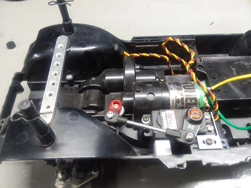

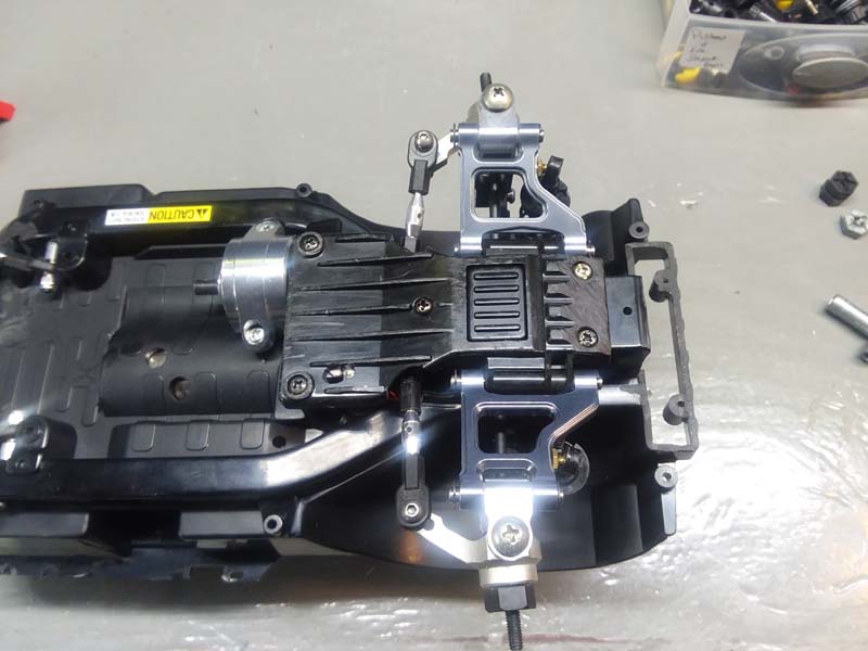

This chassis was pretty well built already. This was my Pajero at one point, and was a very capable trail truck. I drove it off the side of my test ramp and the body was pretty much toast. It was unfortunately the last of many falls. It's been sitting ever since, and I've been picking at it for parts. As is stands, it has a Tamiya mini motor on a 3:1 reduction, chassis stiffner on the shock mounts, and made a chunck of styrene to brace the steering servo to keep it from flexing. Very solidly built.
Underneath the suspension is all metal - mostly GPM I think. Tamiya CVD's and adjustable camber links just because the stock uppers were flat worn out and wobbly. All shimmed up and rock solid. Integy steering parts which are surprisingly so far better than the GPM setup. Found the aluminum gear cover in my parts bin...the plastic one was almost worn through. I'm sure it'll hang up quite a bit more than the plastic, but I'd rather have that than a possible hole in it.

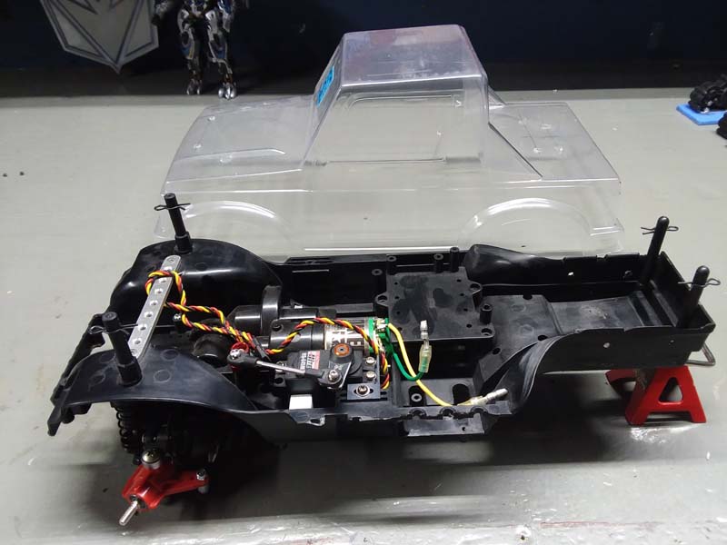

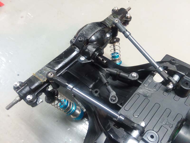

Dug around until I found the missing axle. Nothing fancy here, just relocated the links as per usual mods, made a new upper Y link and set to the Sumo WB.

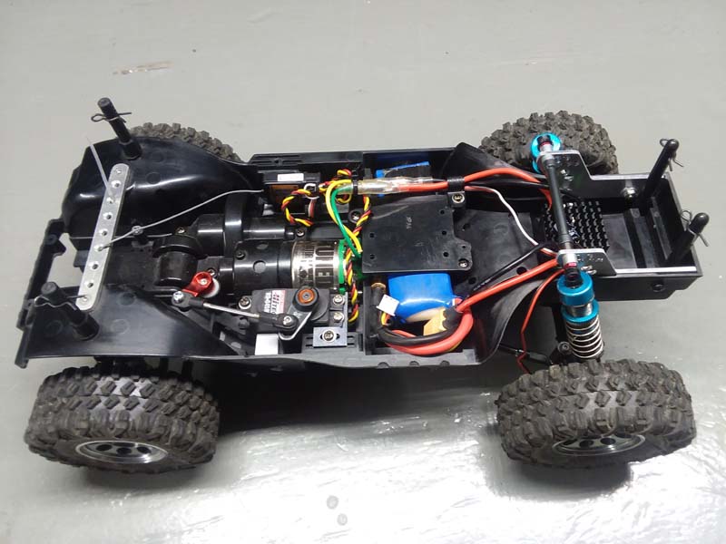

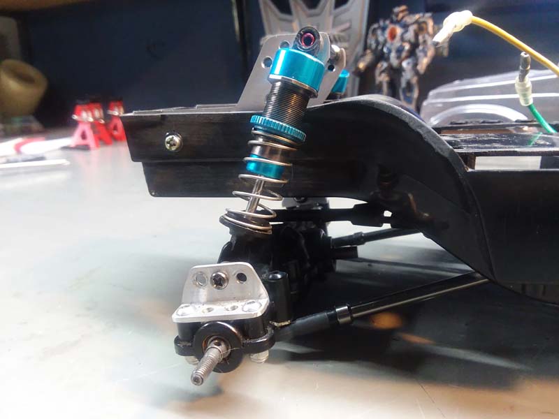

Needed a rear shock setup. Fabbed some new mounts from aluminum angle and plate and used some old buggy front shocks (either old TRF or 3Racing, I don't remember...) Still super smooth! Filled with 20wt oil and the lightest springs I had on hand.

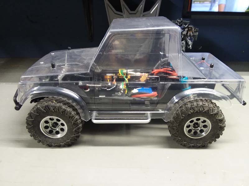

Back on 4 wheels and wired up!

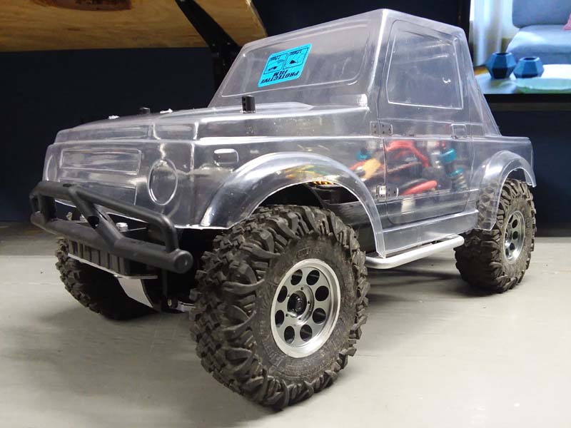

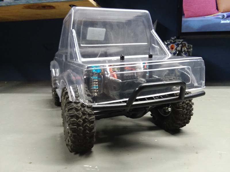

Found some body mounts in my pile and fudged on the Sumo body. It was already drilled for my CFX chassis, but didn't quite like the way it looked so I never used it. So it's got some extra holes. Oh well. The trails and tribulations of spare parts builds...  Experimenting with various 1.55 wheels and tires as I go.
Thought about brazing some bumpers up, but what's a spare parts build without using actual spare parts?

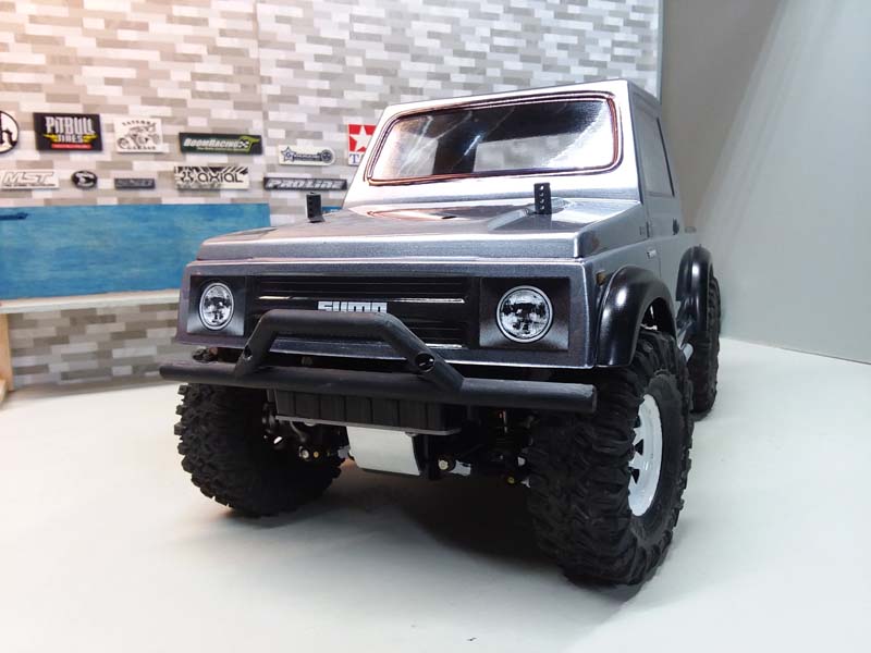

For the front, found out an old HPI Savage bumper lines up perfectly with the holes for the front body mount, and fits the Sumo body pretty well once I cut off the molded in bumper on the body. I made a front skid to protect the brick cut-off, dug out some long screws and bolted the skid and bumper right to the existing holes. Not overly happy with it, but it was quick and easy.  I'll do some fine tuning later.
Had some Junfac sliders laying around in my CC01 parts, so they were a no brainer. They sit a little far forward compared to the body...some new brackets could easily move them back, though I didn't have any aluminum stock handy. I'll pick some up later and move them back a bit. Or not, I don't know.

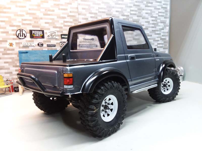

Out back I trimmed up the stock CC01 front bumper of which I have about 10 laying around (again, spare parts!) and drilled some holes and bolted it on to the back of the chassis again cutting off the molded rear bumper of the body. I was debating cutting off the "stinger" but it makes for a nice little anti-flip bumper. I'll leave it for now...

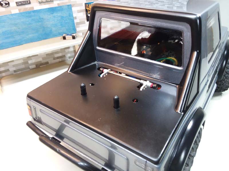

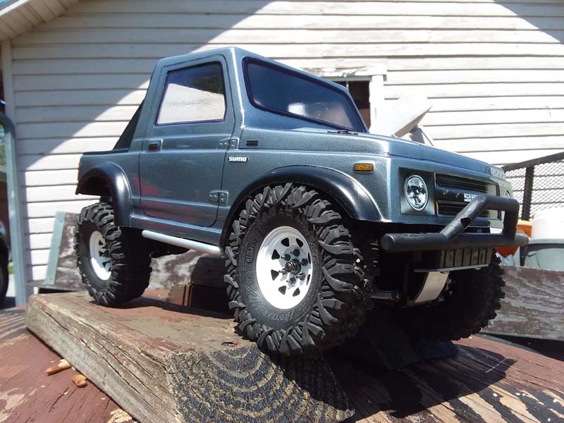

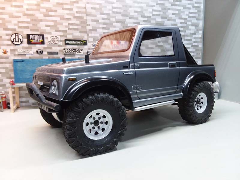

I trimmed the body a bit to sit lower, and sprayed with Parma pearl silver. Swapped the Hustlers over to some RC4WD wagon wheels and it looks just like I remember! I did screw up the front window surround...last time I try to hand paint it. Trimmed the front bumper a bit too.
When I lowered the body I had to cut out for the rear shock mounts. It was either that or re-do the mounts...hacking the body was a much faster solution. :)

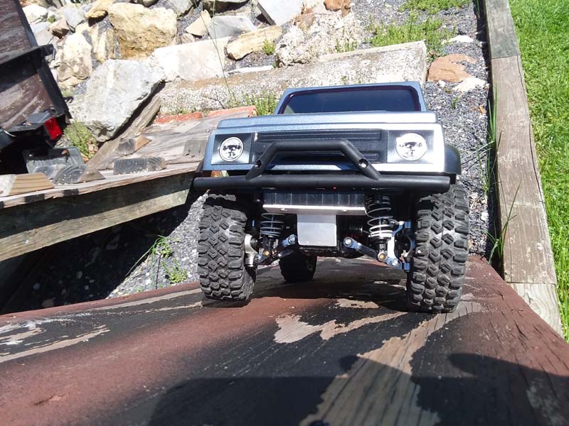

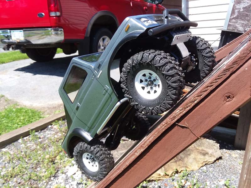

Typical CC01 - it's a very capable little truck as long as you keep it within it's limitations. Wheel placement is key as with any tiny tire truck. Amazed it zipped right up my 60d ramp. My CMX with the same tires couldn't do it, and even my TRX4 sport struggles here.

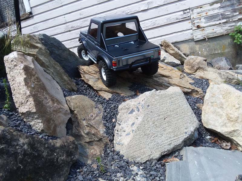

Out on the rocks, the Hustlers do a good job, and it's planted and predictable. I did change around the shocks a bit before playing - went a little softer on the front and a bit stiffer out back. Had the typical IFS tendency to let the rear do all the work. It's pretty balanced now, though a rear swaybar would help even more.

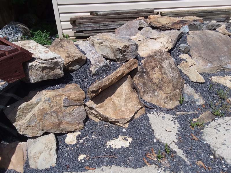

Found I have a new inhabitant in my rock course....about 2 feet long, and scared the heck out of me at first.  Little ****** was fast, just got a pic of him slithering into his hiding spot.
Wasn't happy about this tiny truck invading his living area...sharp eyes can see him poking his head out.... :)

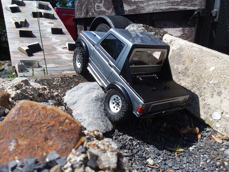

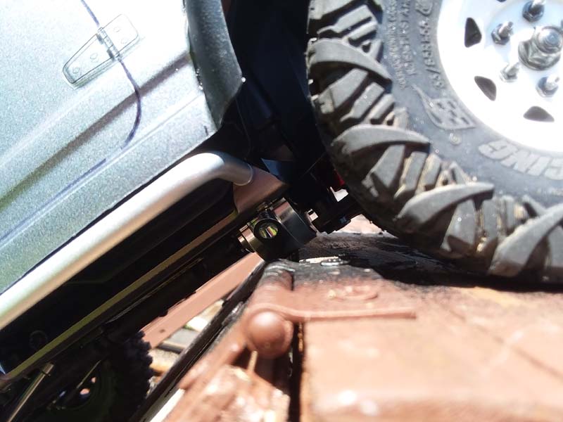

Anyway, back to wheeling. Took a little wheelspeed, but did get up and over "the &%#$" which is my somewhat tricky (1/2 finished) 45d test ramp with obstacles. The Hustlers are pretty good tires and make a cool screeching sound as they search for grip on the wood.
Didn't have this issue with the previous Pajero body, but it does torque twist just a bit on steep climbs. Can see the right wheel lifting off the ground just a bit. Not enough to worry me though, it still climbed just fine.

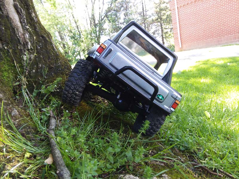

The lighter body does help in all situations though. I test sidehills on my giant maple tree out back, and with the lighter body it goes around far better than it used to. The stock foams are letting it down a bit, but all in all it's a much more stable machine.
