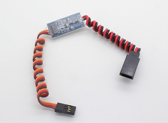

As for a electronic light switch so you can switch the lights on or off from your transmitter. The most reliable one I use for years now is the one from DR Mad, the Dr. Mad Thrust. Simple, easy. I waterproof is also with the conformal coating. Hobbyking also sold them, but the seem to be out of them. But you can find them all over AliExpress.
