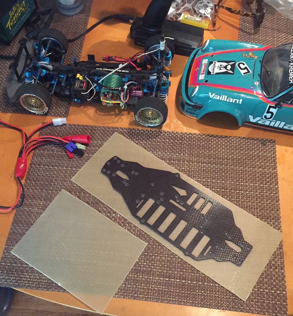

So I bought a new chassis for it if I restore it down the line. But for now I’ll use a chassis protector I made from thin G10 fiberglass.
E4B08DF0-4184-4B32-94B0-8B7E1A2FC946_zps
I doubled up the fiberglass in the rear
1B2AA5D8-F233-4D81-8B9E-CD7407A9FE9D_zps
BF339072-2284-4C14-90B9-EB8E321A4B8F_zps

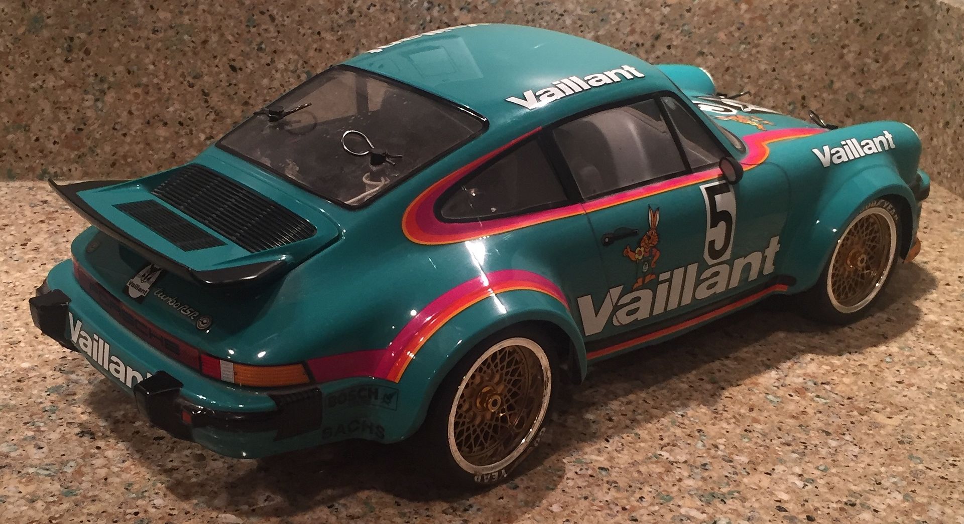

The body is well done and has led lights installed. I’ll try to run this gently until I can paint another body from the 40th release that I won’t mind will inevitably get messed up.

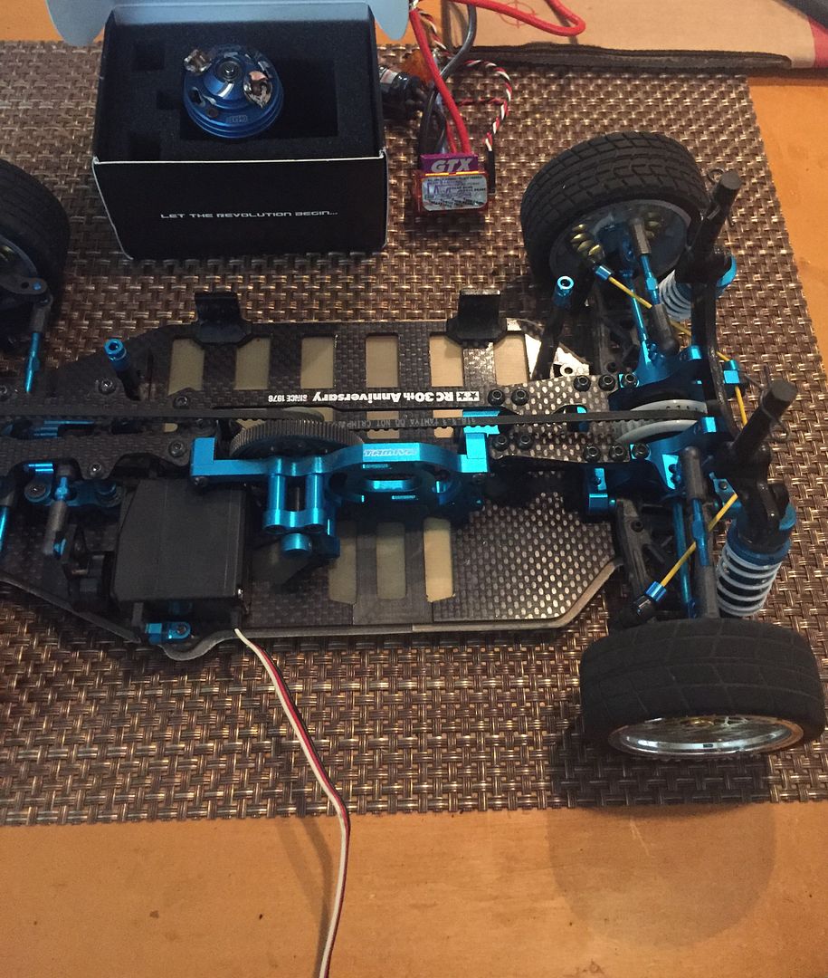

This morning I set out to replace the ESC And Motor for something faster. As I suspected it was a tame 35 turn motor.  I dug through my boxes of goodies and came up with an 11x3 team Orion revolution motor and a Novak GTX to power it.
C839DD27-99CA-4EEE-B8C4-C2AE7373464A_zps

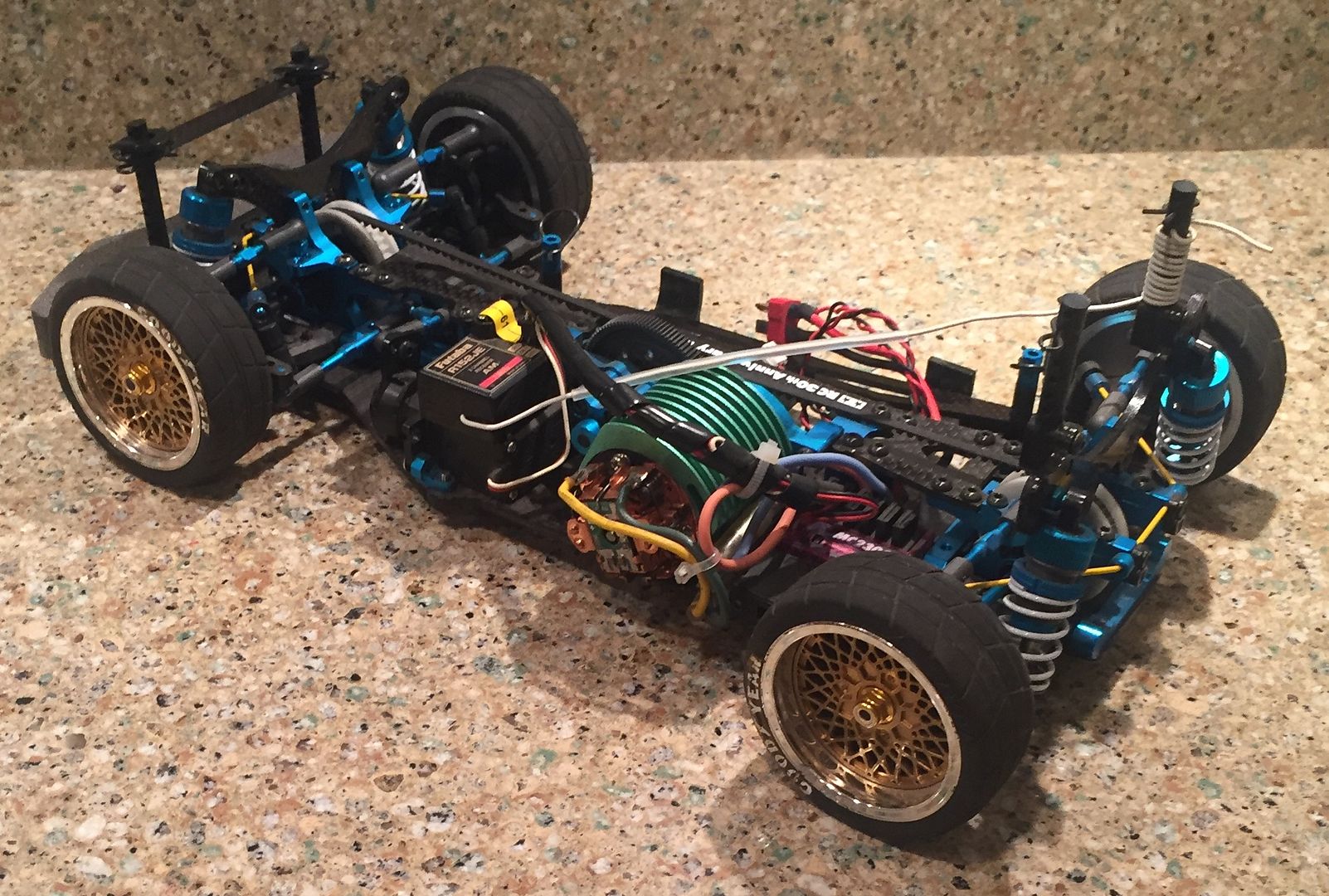

Got everything installed and plugs and motor soldered up.  Took it out for a run and discovered a new set of issues.
5B30C3ED-E0BB-4A39-8EEB-204A2E00130D_zps
 Diffs are way too loose and I’m not loving how it brakes with the front one way.  I may change it back to the stock pulley. I’m getting radio interference so I’m not sure if it’s the way I have the antenna mounted or having no motor capacitors.

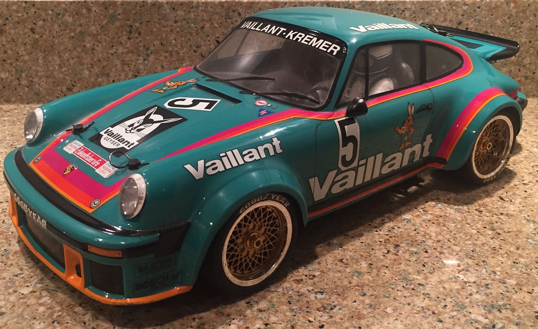

Not super big fan of the Valiant livery. I love this body I painted. I think it’s going to become my runner body

I don’t see a way to mount the motor capacitors or if their needed. They might be internally installed in the motor. I’m at the point where I’m going to go brushless and 2.4
