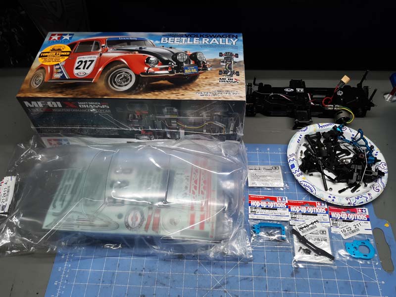

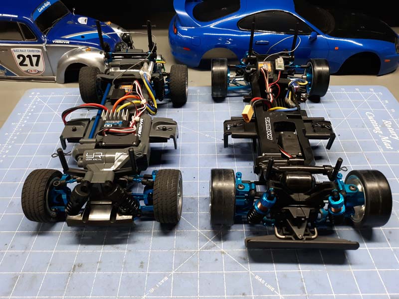

To that end, I had bought an MF01 a while ago for this exact purpose, but quite honestly once I built it up stock-ish and took it for a test drive, I loved it.. So I used the parts I bought, picked up a few more and built up both a MF01 and TL01LA (of sorts) - they came out great!

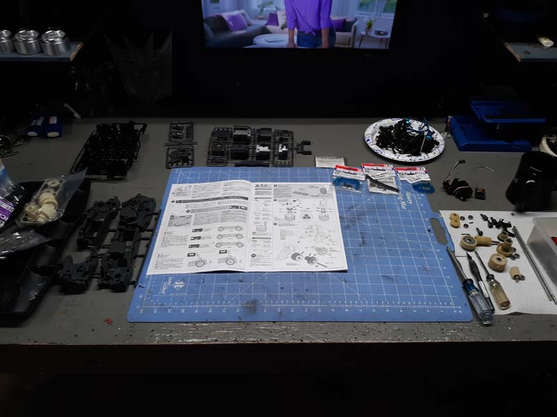

I didn't have the heart to tear them down, and this project has been in my head forever so I sold off an M06 I had and bought another MF01 kit. I picked up another Beetle Rally version and a few hop ups. I had the Porsche body laying around from my previous attempt.

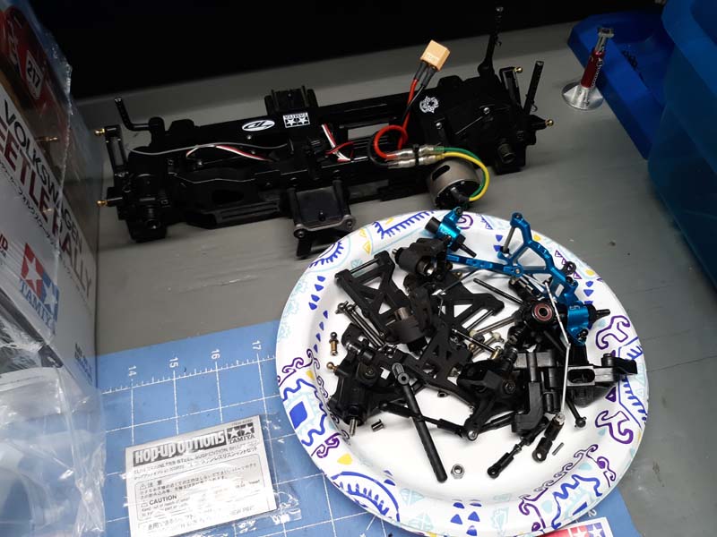

My shelf queen TL01LA was torn down to donate parts for this project. I'm not sure if all the suspension bits will work or not due to the quirks of the MF chassis, but we'll give it a go anyway.

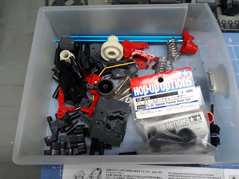

Plus a box of goodies from my previous MF project. Can never have enough parts when mixing and matching kits.
Love it when the workbench is filled with parts trees, manuals, and tools.  Going to be a good day!

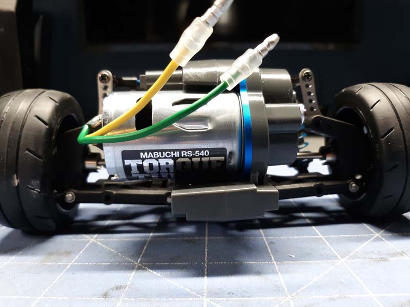

Rear gearbox built with the upgraded motor mount. Anything to help dissipate heat... the motor on my Bug gets quite warm! Not a lot of airflow back there.
Rear suspension options.. .the LA parts, some Yeah Racing bits left over from my Konghead, and regular TL01 bits.
Not sure how well the LA bits are going to work - the upper link mounts are far more inboard than the others...Can't bolt the extenders to them, so not sure what I want to do here yet.
Plus, I had to flip the hubs due to the rear toe, and the upper link mounts are way offset compared to the MF versions. Definitely need to think of something, or just revert to the stock TL bits - they work fine.

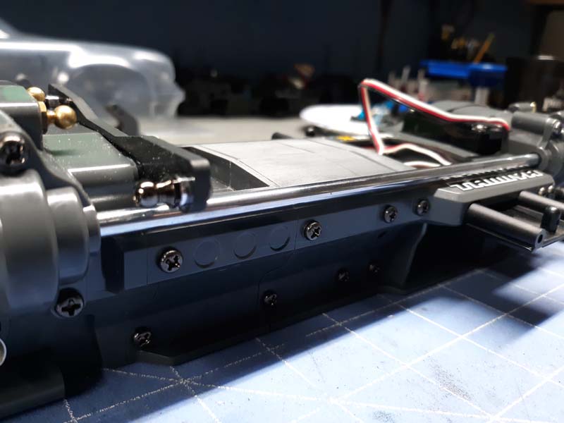

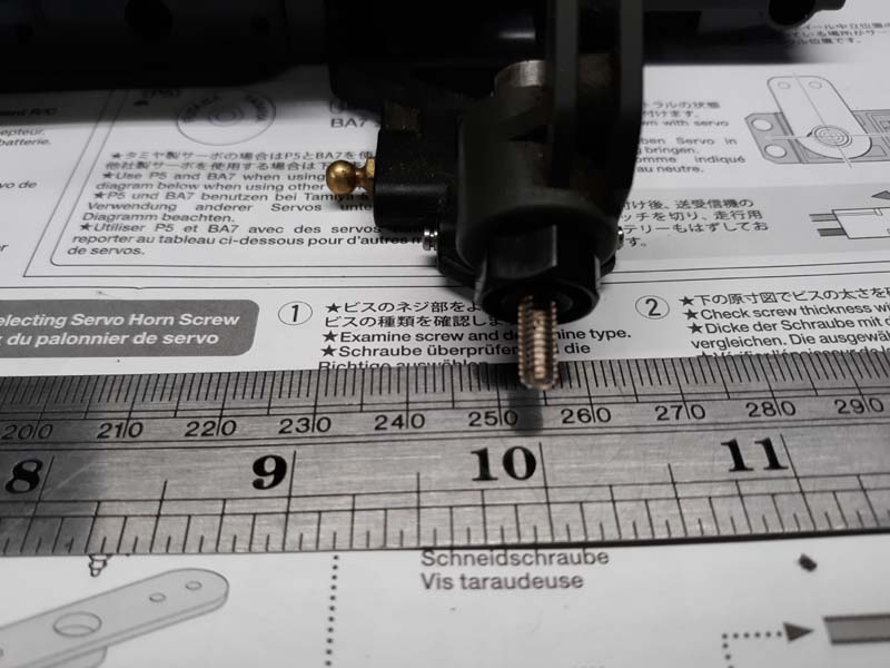

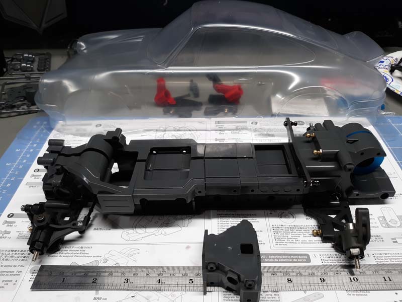

Setting up the chassis...as Juls1 found, using all the spacers in the kit brings it right in the 251mm ballpark. It's just mocked up below, but it's for sure very close.  Interestingly using the leftover small spacer from my previous MF takes it right to 257mm by my math. Interesting info for a future build. :)

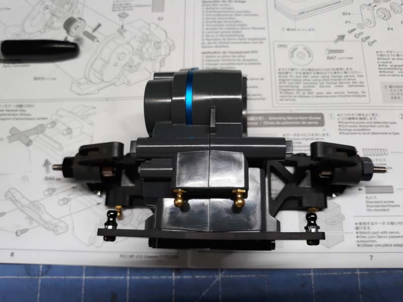

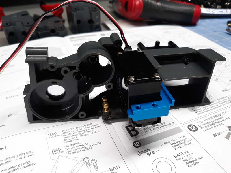

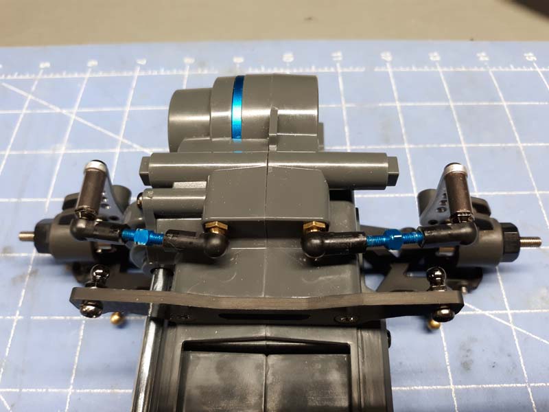

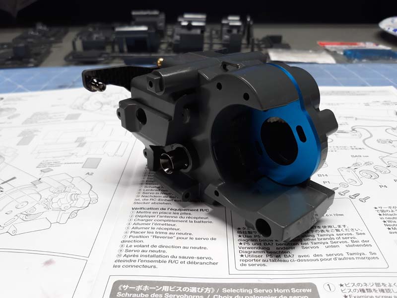

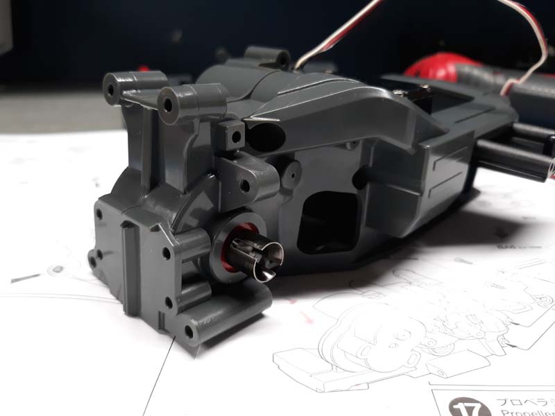

Front gearbox being built up. Upgraded servo mount installed as well. Nothing wrong with the stock unit, but I cannot resist Tamiya blue!

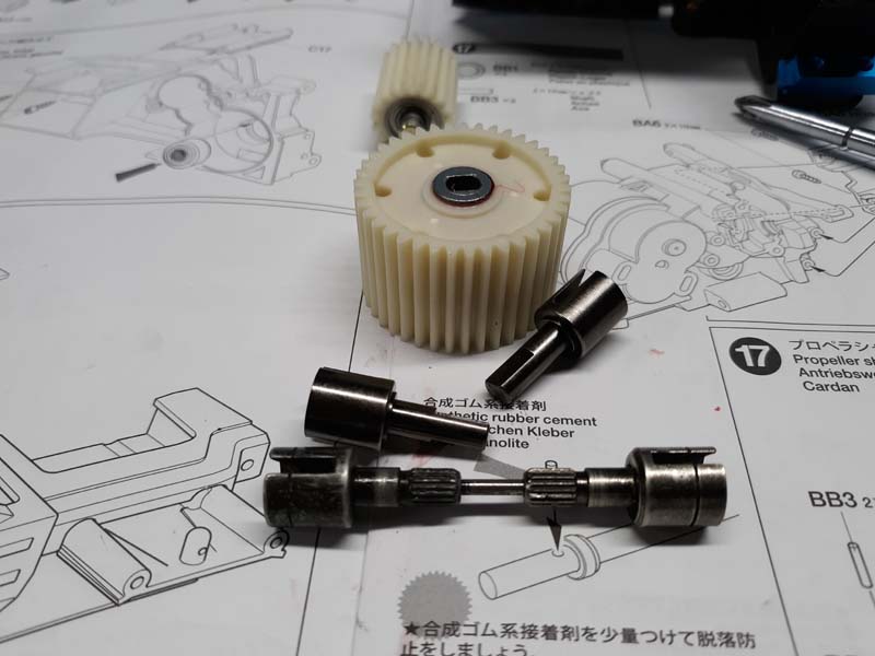

One thing I don't like with newer Tamiya kits are the diff outdrives are no longer aligned with a pin. In the splined outdrive days, they were kept aligned and seems to be a more solid setup.

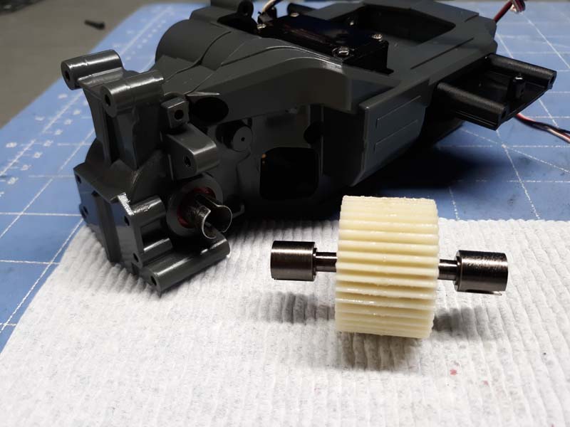

Finished up, the front diff was very grouchy. Tight and notchy on the diff action, though the trans gears themselves spin fine. I'll have to tear it down and investigate. The red inserts are suspect...might be some flashing I missed or something.

No matter what I did, I could not get the stock front diff to turn smoothly. Tore the diff down, looks fine, and spins perfect out of the chassis. Took out the red inserts, sanded and re-installed - nada. Finally I swapped in a ball diff and it's perfect. I'm still not sure why the stock front diff is not playing nice. The rear diff was slightly notchy too, so before going further I swapped in a ball diff back there too.

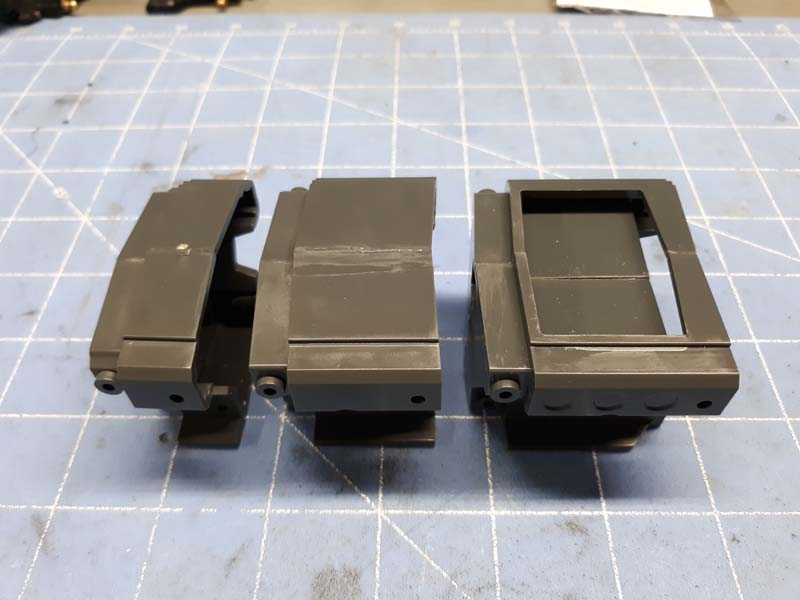

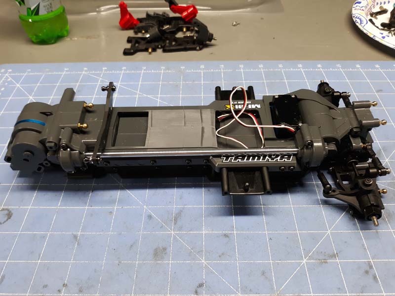

Now that the drivetrain is happy and free, started on the chassis and suspension. I glued the chassis extensions together. Not sure of it helps rigidity or not, but I figure it can't hurt.
I am out of Bondene, so I used CA. Worked very well, though it left some blobs on top of the chassis that I had to sand down. Ended up sanding quite a bit. Looks terrible.. :( Though I added a few decals to detract from it. "MF01X Concept" - that kind of works!

I was dreading this part... fitting the center shaft. I came to the same conclusion that Juls1 did and modded the gears ilo the shaft. I sort of trimmed a bit too much of the ends of the TL shaft, so hopefully it stays centered for and aft. I think I have another somewhere if I need to have another go at it.  So far it seems to fit and spin fine.... I did chuck it in the drill and polish it up before installing.. it is probably 20 years old and looked it. Now it looks good as new!

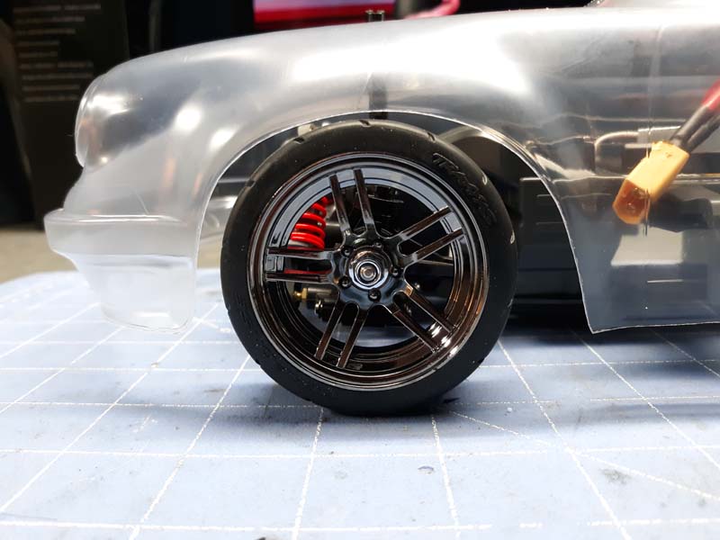

Tamiya 2 piece wheels were in short supply... after scouring around, there were none of the Porsche wheels stateside that I could find. Not really a fan of the BBS type which were everywhere. While the Tamiya tires look the part, they are not super grippy. Doing some digging, I found that Traxxas wheels from the GT have a wide offset out back and a more narrow offset in front. Hmm.... Took a chance and picked up a set of new takeoffs for $25 and they seem like they'll work very well. Good fitment and grippy to boot! I could help mocking everything up... :)

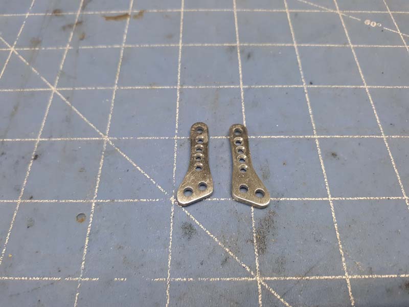

Been a long time since I fabbed up some aluminum bits. Used to love doing it, but I burned out a bit I guess. In any case, needed 3 parts for the Porsche and I think they came out ok.

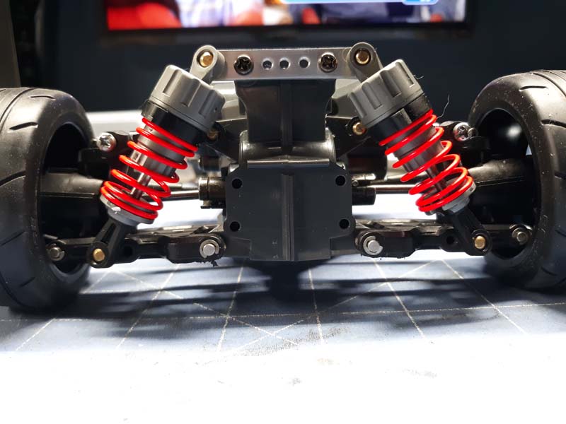

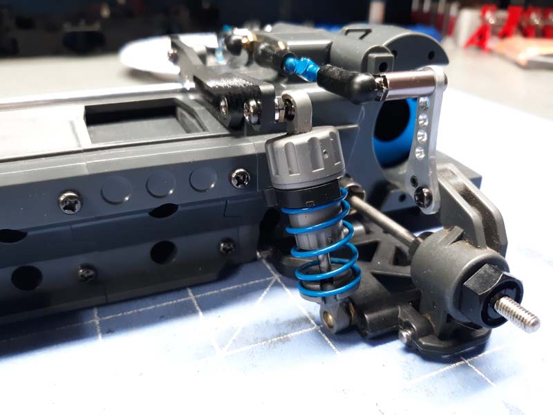

First piece is a simple shock mount... even with the longer rod ends, the mini CVA's were too short. Plus, I think they shocks would have been laid down too much using the stock holes. So I made a small tower that pushes out the upper mounts a bit. Worked out perfect!

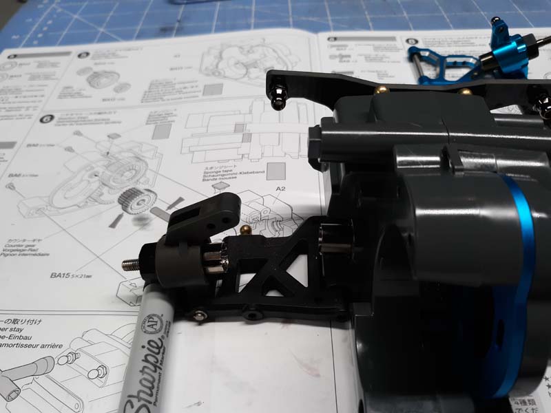

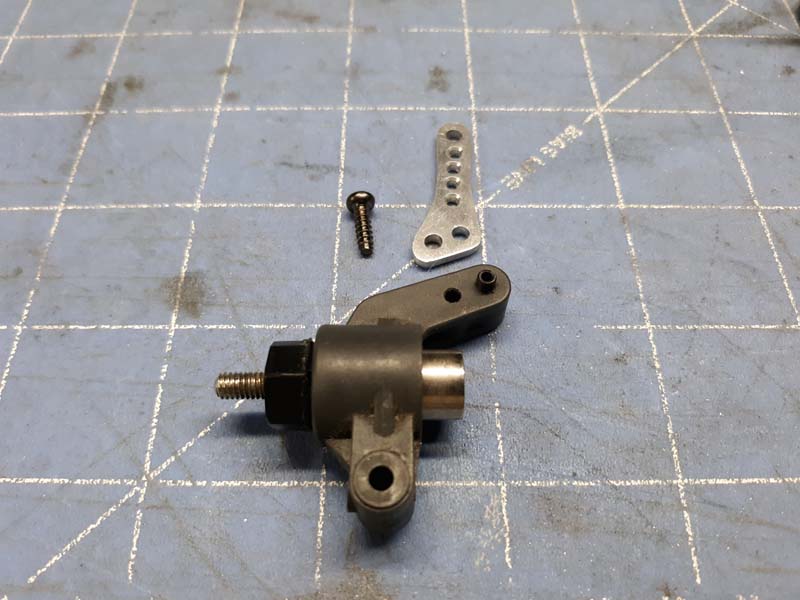

Second idea was to do something about those rear upper links so I could bolt on the LA suspension. I came up with make some rear extensions out of 2mm aluminum.
Then bolting them to the rear hubs...there's not enough room for 2 screw heads, so I got inventive.  I used a standard Tamiya tapping screw (to match the rest) to tighten the assembly and a small 3mm headless screw to keep the mount from rotating. Works perfectly!
Since the hubs had to be flipped a certain way for proper rear toe, I needed a long spacer up top... bolted together, it all looks a little wonky, but it works!

And just enough room for the shocks to mount. Nothing fancy needed here, they bolt right on. I used gray mini CVA's since they matched the gray chassis. Total guess on the springs and oil....

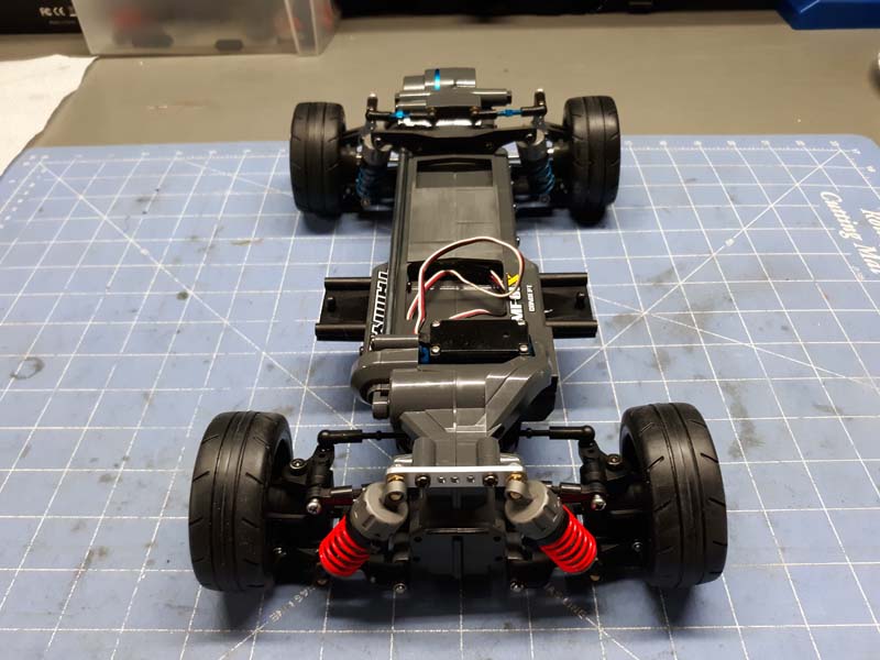

Most of the chassis is done - still need to do some shimming, they should be in the mail today!

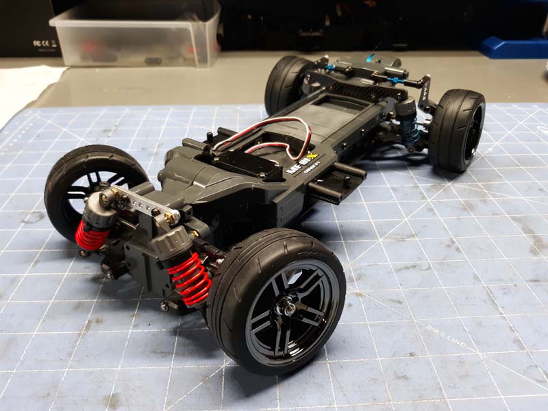

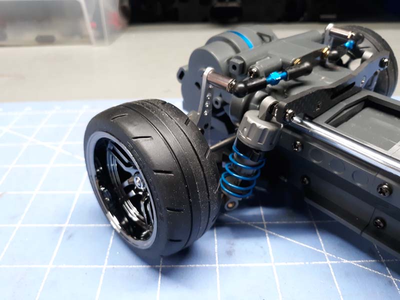

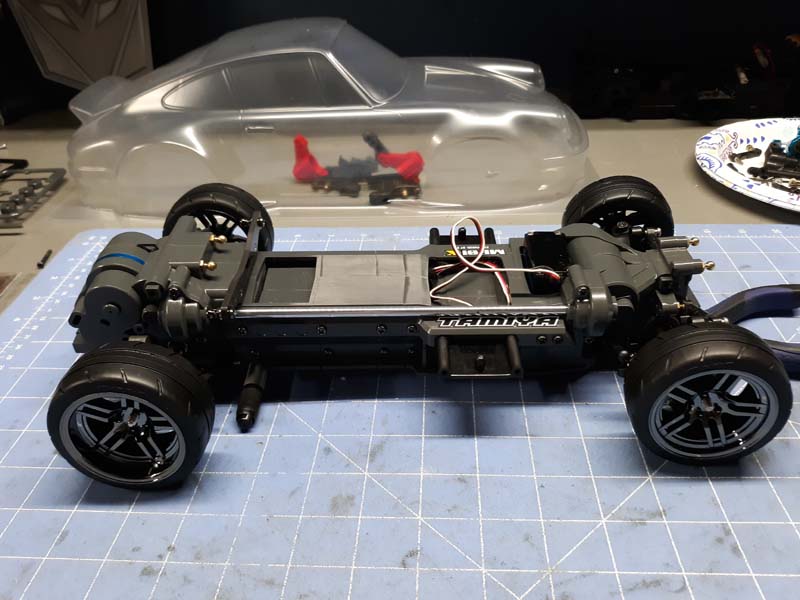

Had to put the wheels on. Love it! Ride height is pretty much spot on for our usual parking lot adventures

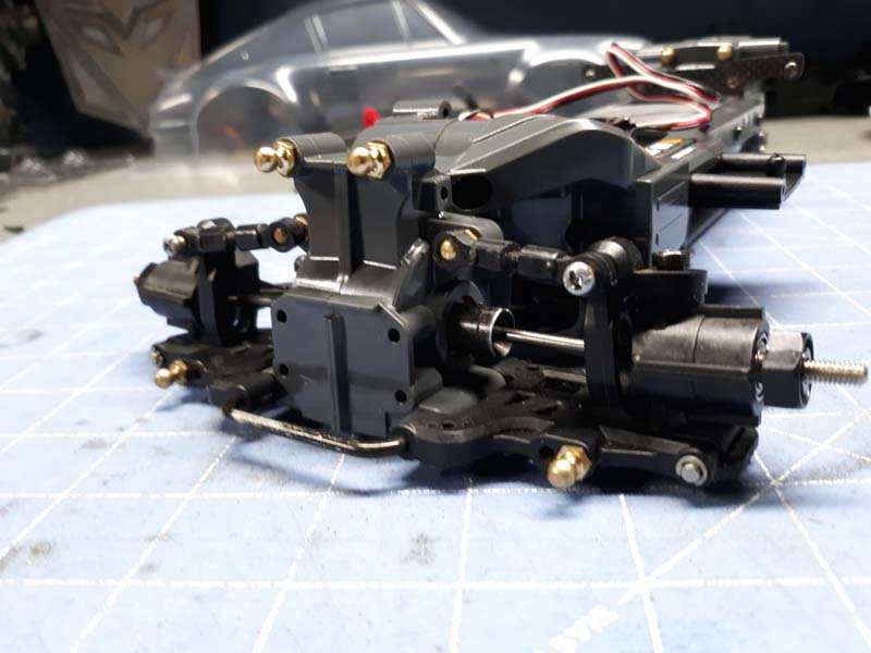

Oddest rear suspension I've ever seen, but it feels fine on the bench. We'll see how it does on the road...

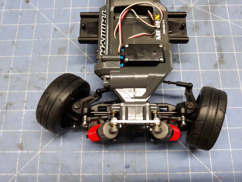

Steering might be an issue. That's full throw, and though I haven't fine tuned anything yet, I don't think there's much more there. The geometry of the LA kit was never designed for the single pivot servo steering of the TL01, or the MF01. Definitely have some tweaking to do here.

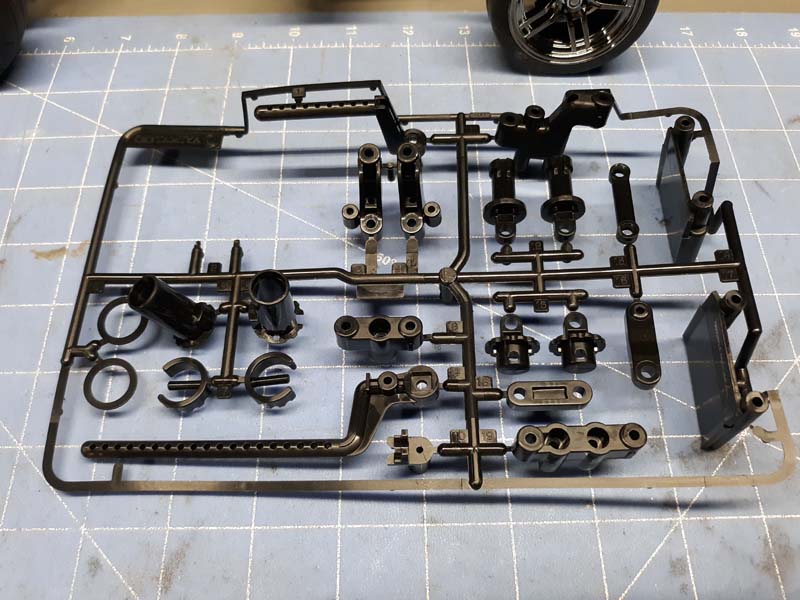

And a quick beef....Tamiya, can you please do the body mounts separate? To get both front mounts if ever needed, I'd have to buy 2 parts trees, with a ton of parts I'll never use. It's a total waste!
Hear Hear!!!!!!

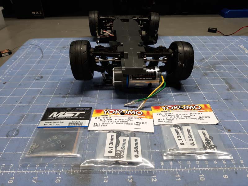

Tamiya shims were out of stock everywhere, so some Yokomo and MST shims did the job. I went though everything, even the C-hubs and steering knuckles. Takes forever, but now there is no slop anywhere on this thing. Well worth the time and effort.  Also set all the suspension and toe to 2 degrees to start.

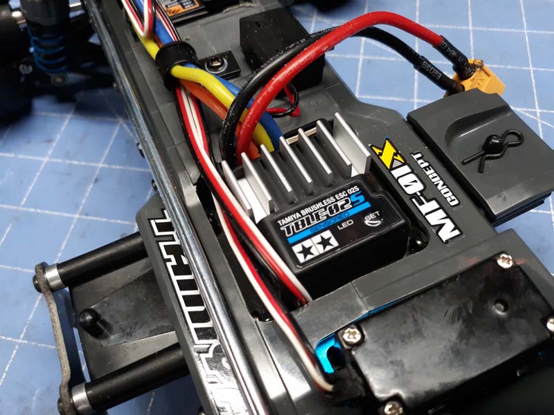

I dremeled out the recess towards the front of the chassis. There's a slight lip front and rear, and I've found if you grind off that lip, the Tamiya ESC fits perfectly. It does fit if you orient it side to side, but I much prefer it pointing in the right direction. Also fitted a carbon TL01 battery retainer and the kit front bumper while I was at it.
Got all the wires in...I don't trim them down as I move things from vehicle to vehicle as needed. I did shorten the on/off switch for the ESC, but otherwise just zip-tied everything and called it good. I did add a small wire clamp in the middle of the chassis to keep the wires away from the prop shaft.  Eventually I'll have a BL motor in here, but the TT will certainly do for now.

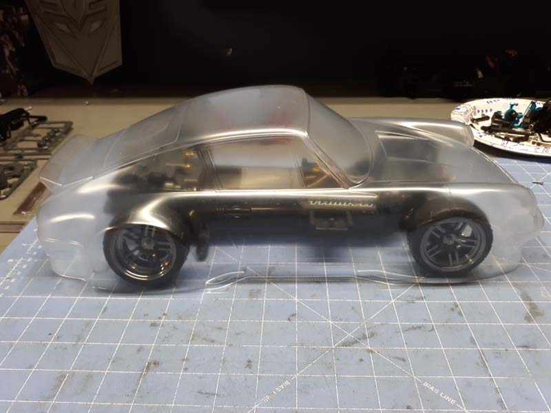

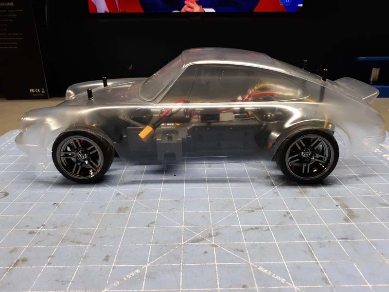

And onto the body... I used some TL01 body posts out back as I thought they fit the body profile a bit better. Always makes me nervous drilling the body post holes - been doing this for nearly 30 years and can still easily screw this up - especially when there's no dimples! Took my time and got it about as good as it's going to get.

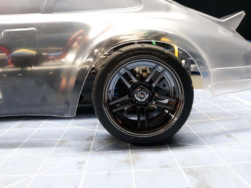

Got the wheels about as centered as I can. The front is off slightly due to the different in WB, though I can certainly live with it.
The tires almost fill the wheelwells. I think it's a bit narrow - especially out back.  Pretty common with Tamiya, I think some fine tuning with some wider hexes should solve the problem.
