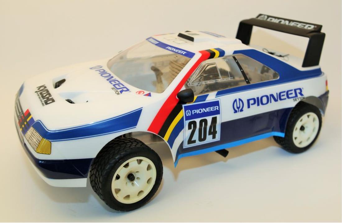

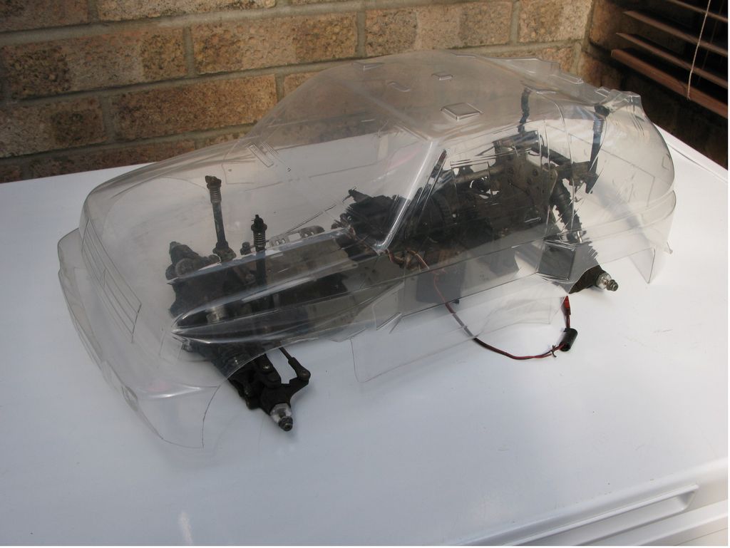

So as ever I usually have around 8 or 9 projects on the go. As the David Jun TNX and the Kyosho Turbo Burns near completion I have been wondering which kits to do next. I picked this up from Japan recently and thought it would be good to do next.
The Pajero along with the Citroen ZX is one of the rarer nitro cars from this family. Most people would of heard about the RS200 and the Peugeot 405. I have an RS200 to restore and I have already done the 405. The Citroen ZX body I have just needs a chassis.
So the Pajero has a badly cracked body, to bad for me to want to use it so I have used some body tape to hold it together and it will get sold off. The Pajero does look good though

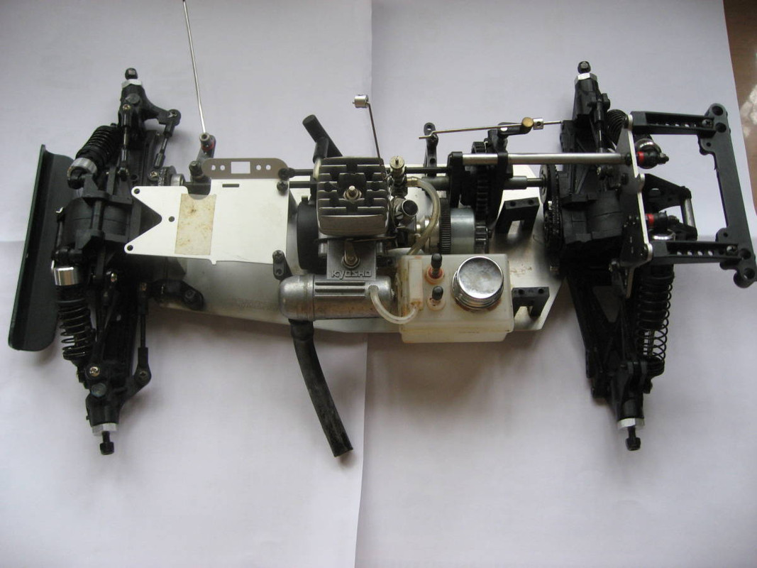

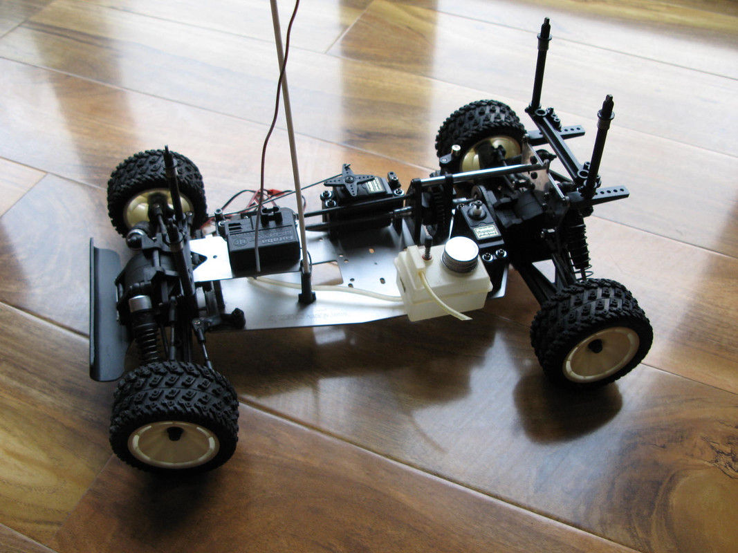

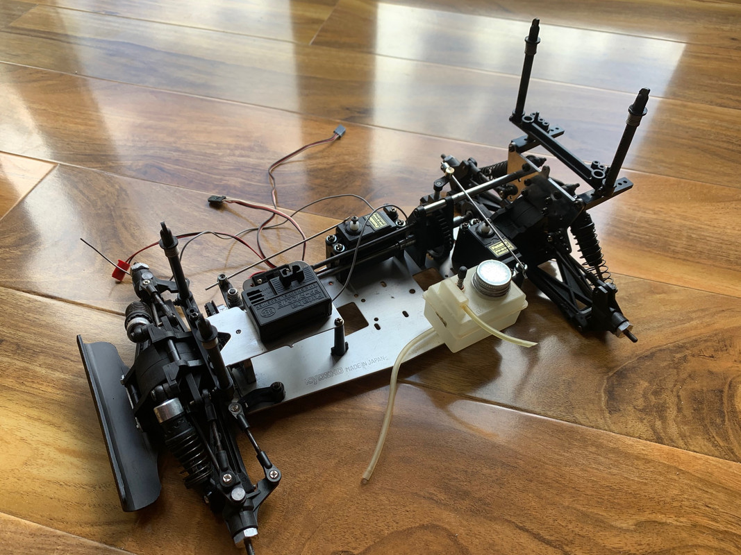

The chassis is pretty much complete but needs some love
Having looked it over there are a few plastic parts missing and I have already ordered them, mainly some mounts, the aerial holder etc. The parts aren't too rusty and I am hoping I can recover the tyres and wheels with some care. A few plastic parts are bent (body mounts) but they should straighten up. Most parts from these chassis are still available in the Kyosho FD- range.
I already have a new body so that will be painted for this restoration by @jonboy1

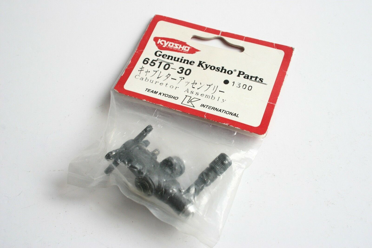

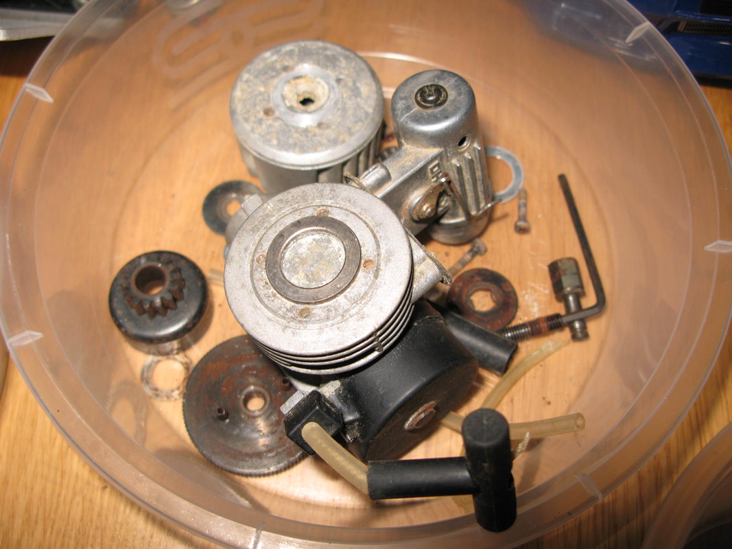

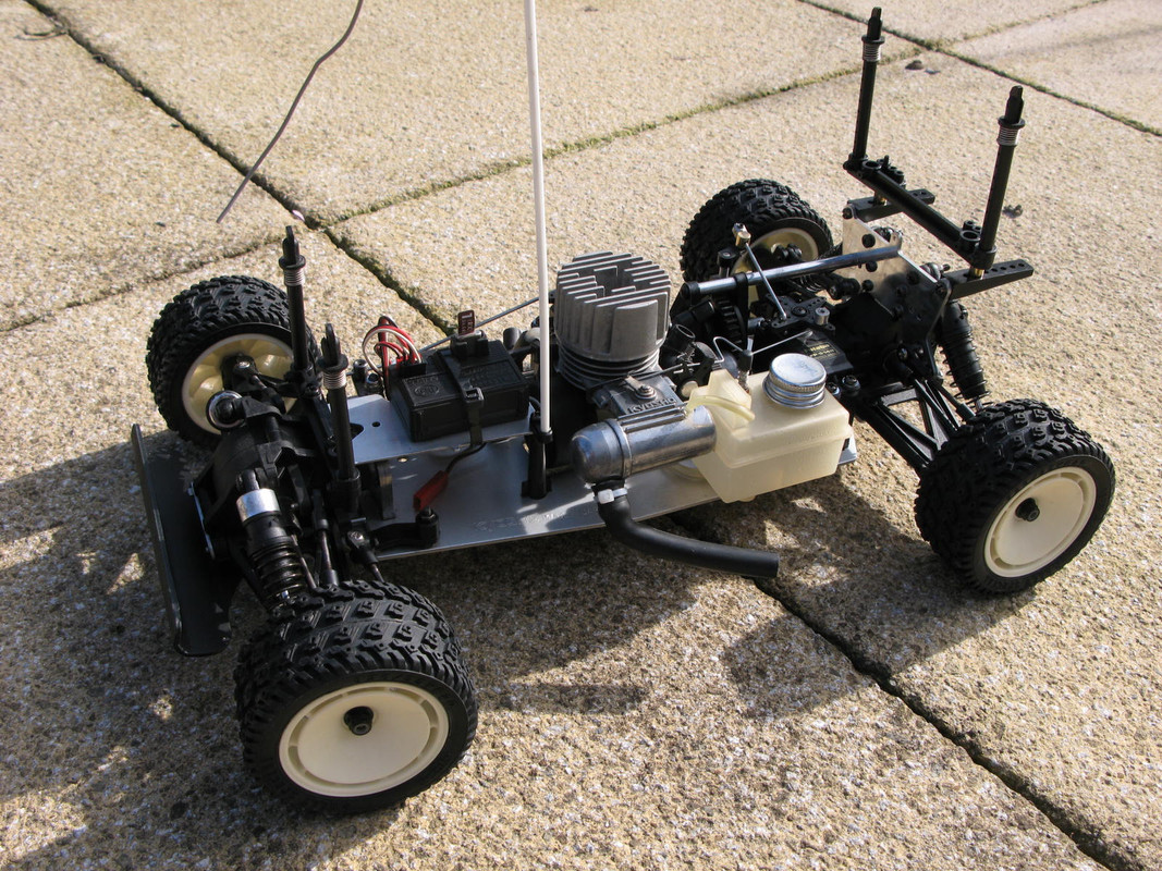

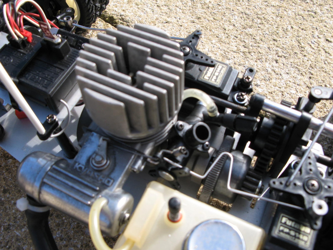

The engine on this is the Kyosho GS-11R and it is seized solid. Its also missing the carb but that was easy enough to find.
The rest of the engine restoration will be documented. Next steps will be to strip the car down, time to get dirty again!

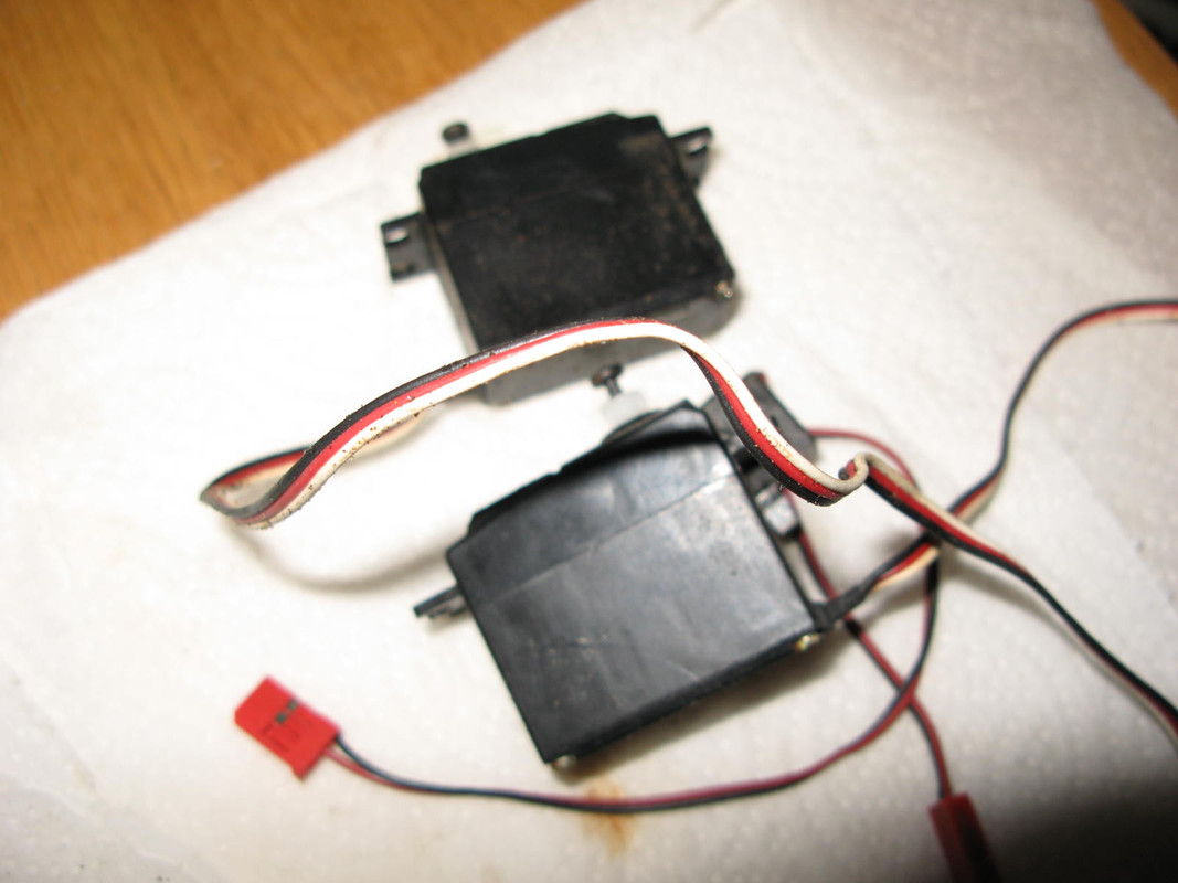

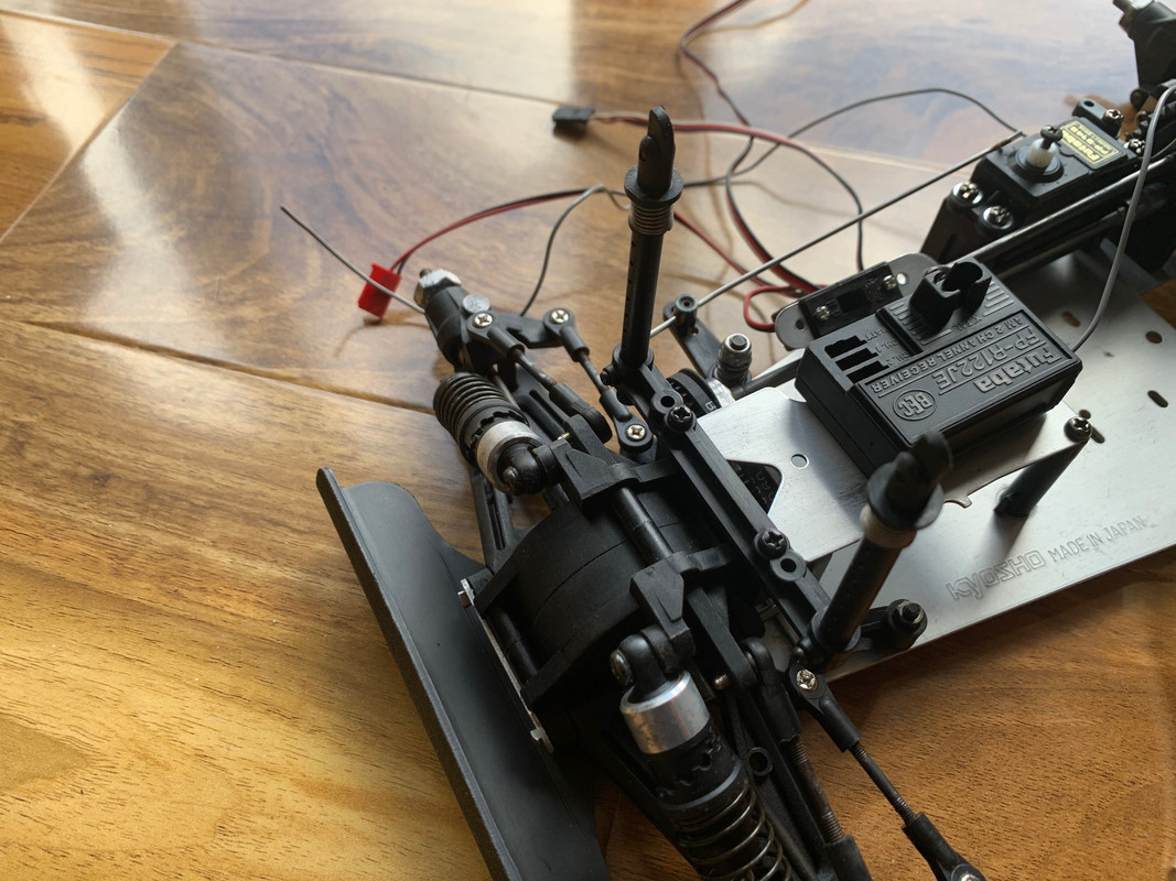

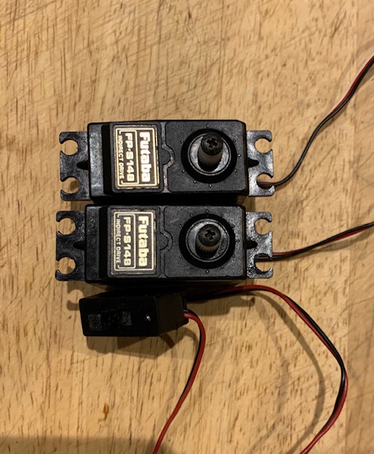

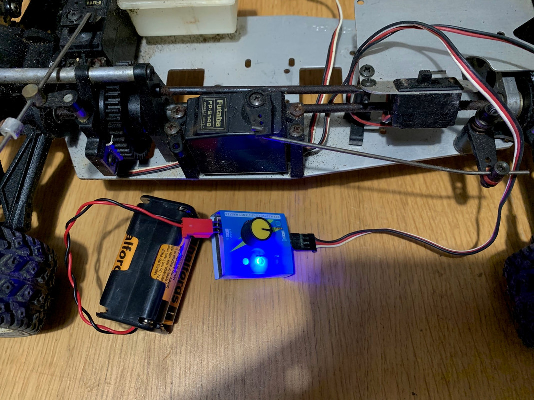

Remarkably the servos have tested ok! Full range of movement and no nasty sounds.

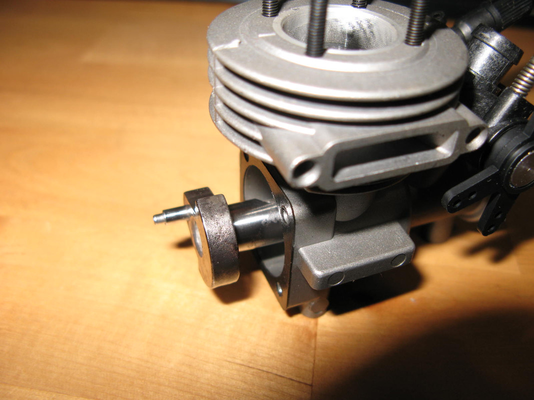

Took the head off the engine to have a look. seized solid and a load of dust inside.....this one will be tough to get moving again!

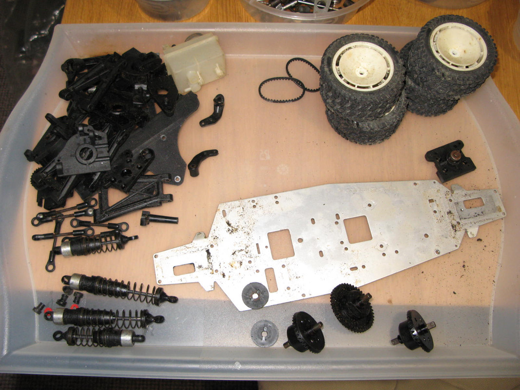

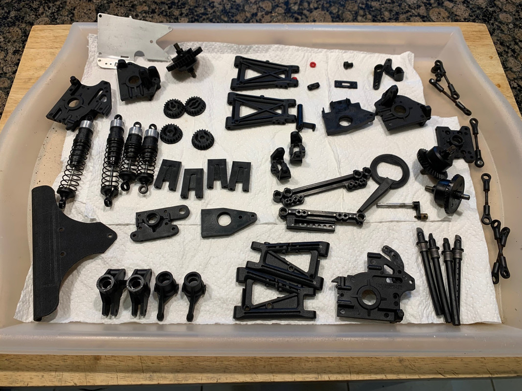

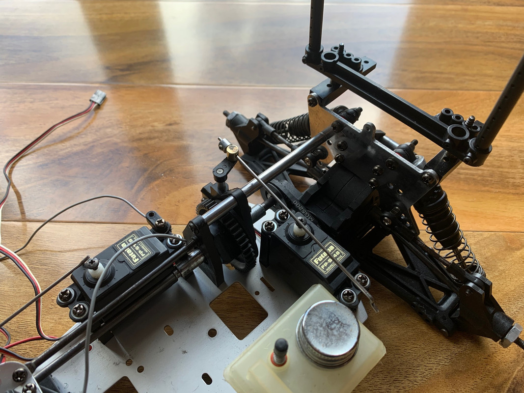

So made some progress and got the chassis stripped and sorted
Plastic parts to be cleaned along with the shocks, chassis plate, wheels and tyres

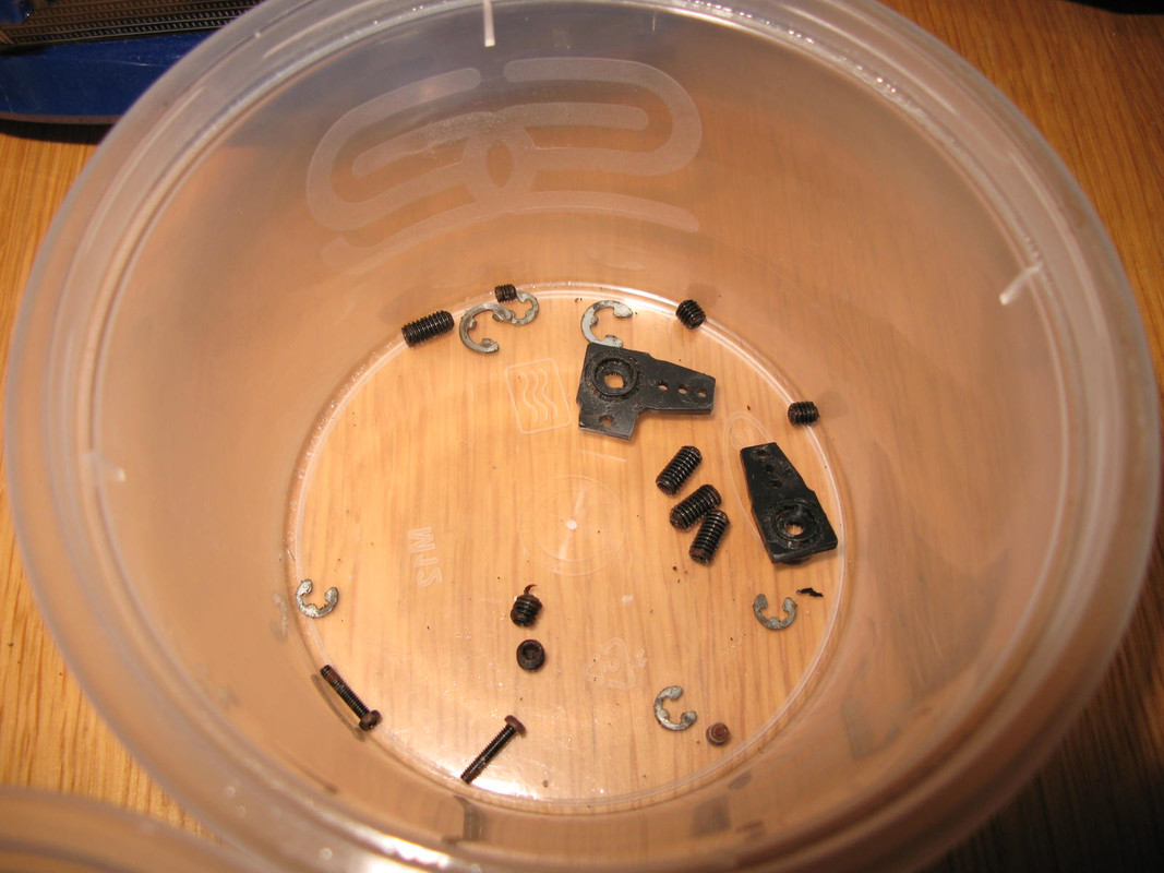

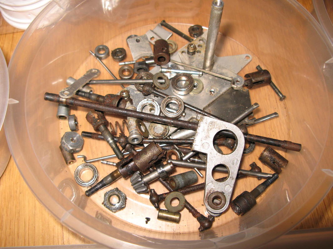

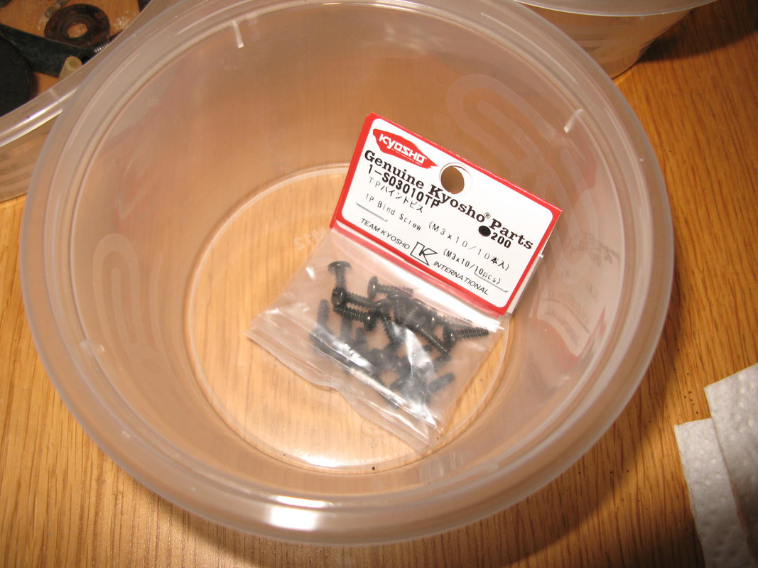

Screws to be ultrasonic cleaned and refurbished

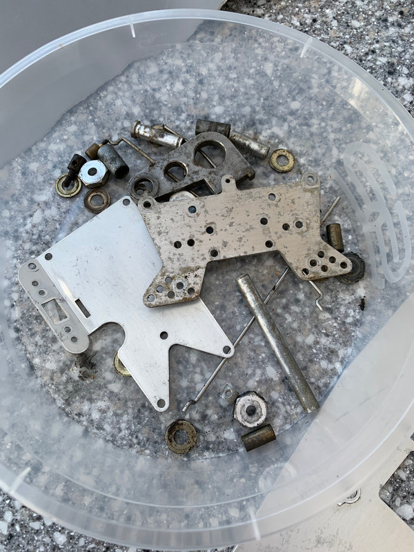

Metal parts to be restored, the biggest job in this restoration
Initial parts to throw away, more to follow I'm sure
The engine parts
The servos
some new parts already arrived, these are to replace the missing screws

Observations are that some parts are rusty but might be recoverable, we shall see. As expected all the ball ends are brittle. Not sure what it is about Kyosho plastic on these but they just dont last like old Tamiya parts.

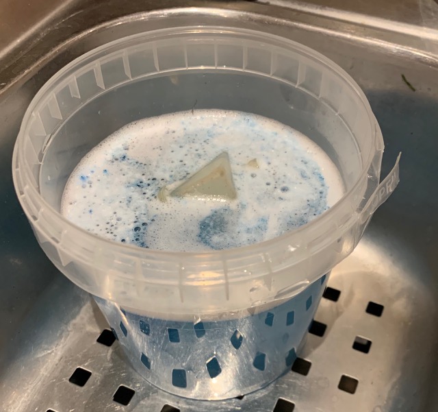

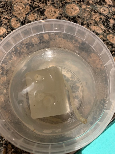

The tank went in some denture cleaner along with the fuel tubing
and 24 hours later is looking much better. I have found a nice shiny looking cap in my Kyosho spares as well. Just needs a rinse wash and drying out.

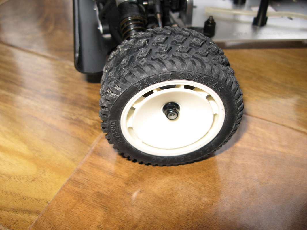

Carb arrived today so that's ready to go back on the engine once its refurbished. Next step will be washing the plastic parts. Tyres are in the dishwasher. Sorry dear!
Wheels and tyres came out great. I'm very tempted to get a nitro car to relive my youth - I have fond memories of a Nitro Evader truggy thing - but wouldn't know where to begin. What's a good (well supported) Tamiya nitro car I could keep an eye out for? Didn't they build one based on the TT01? Sorry to hijack your thread with questions!

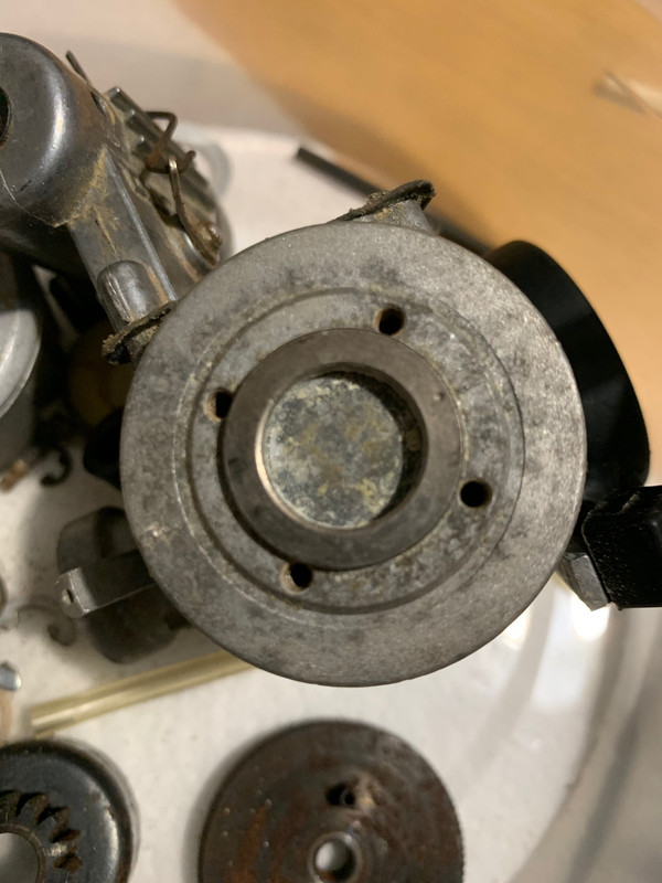

A few bits to work on like the shocks and diffs but basically clean. Also started looking at the seized engine and it is well and truly stuck. Tried every trick I know to release the crankshaft but its had it. So stripped off what I can save to recover and will get what I need elsewhere. Found this on Ebay in France (a GS-11r crankcase) and purchased it. Not 100% sure what parts I am getting but its brand new and was cheap. Engine recovery on its way!

So I had a very productive day Saturday. The engine arrived and I found out I had basically bought a crankcase and backplate. I added some new head screws, fitted the carb and set about recovering what I could from the old engine. I think I will need to purchase the crankshaft, piston, liner and conrod. I think everything else will be ok (maybe the one way bearing). Everything was then cleaned and polished that would be re-used. The heatsink head was blasted and then the lower lip polished. Looks great. The muffler polished up well also.

Did a little bit more research today on the engine. It would appear that the engine originally fitted to the kit was a Kyosho GS11-CR. This is extensively the same as what I have but it had a red plastic backplate, different heatsink head and a different starter, starter shaft and one way bearing. Sometime in the past this has been changed to a later setup from the GS11R. This uses a later and very different set of parts. They both work but originality is always good.
Now the question is where do I go? Keep the setup as it is or try and find the older parts? Decisions decisions!

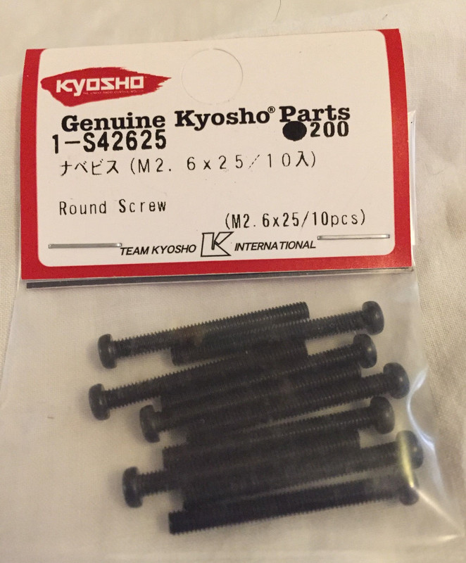

New muffler bolts. The Kyosho cars of this period use M2.6 not M3 and as I have a few cars to restore still I picked up a pack of ten.
Managed to get the Con rod. Thats one more bit ticked off for the engine restoration. I am contemplating cutting open the old engine casing to get the old parts out as I love a challenge!

Its truly stuck. I am actually planning on cutting it open!

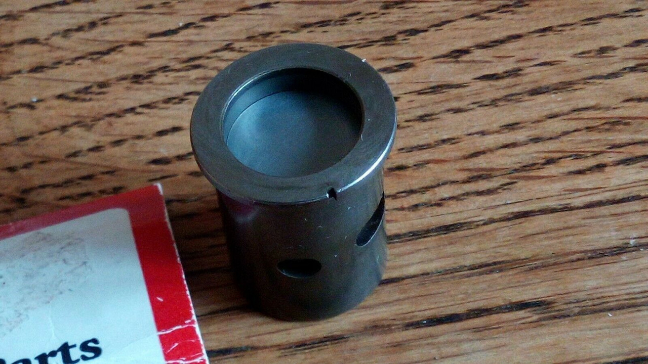

Spent an hour or so on Saturday cutting the old engine casing open with my Dremel. I managed to recover the crankshaft and polished it up. That will save me approx £30. The piston and liner have had it.
Won a piston and liner in France for approx £3, I already have the con rod and ordered a new gudgeon pin. I think that's all I need now to get the engine finished.
With all the COVID-19 issues at work and making sure my team of 30 are ok its not left much time for RC this week. The engine parts came for the GS11 motor and so I built it up and fitted it into the car. The chassis now looks like this
I have two parts to do and its finished. It still needs an Acoms battery box and the iconic red Kyosho air filter. The engine came up nicely in the end
