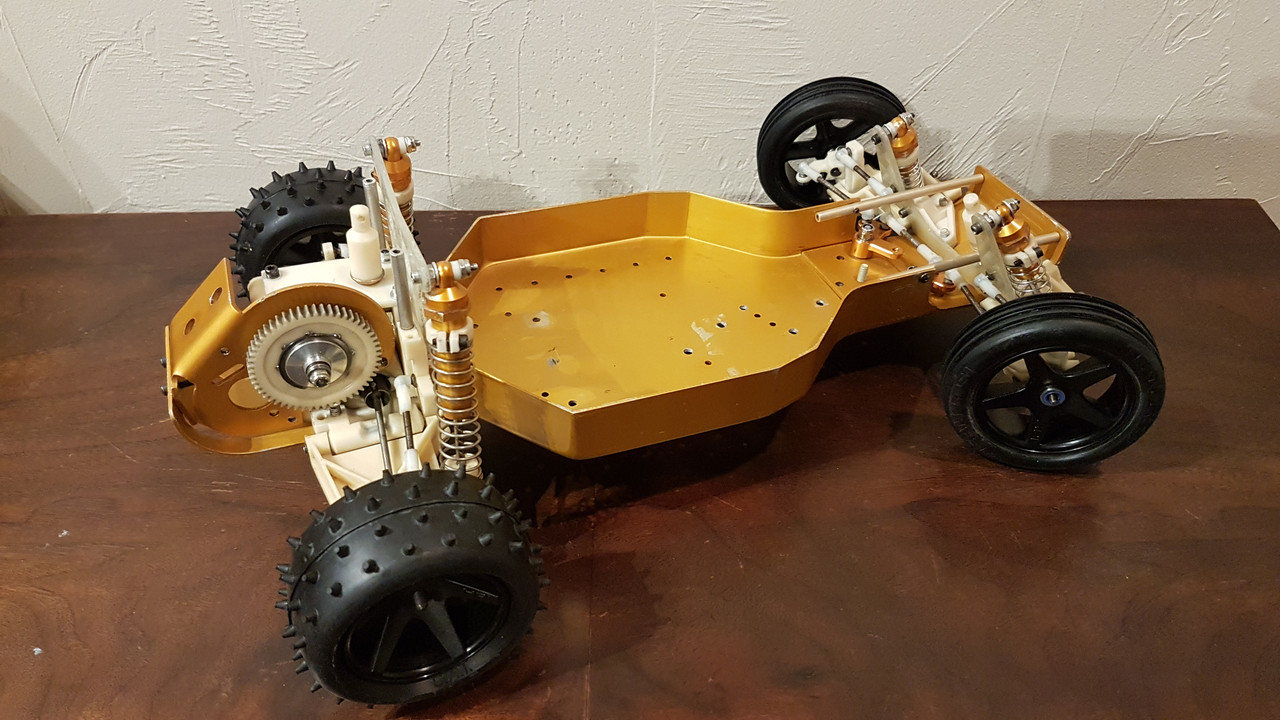

I've had this nice old Team Associated RC10 Gold Pan Edinger lying around for a while.
Not sure if to dive into a restoration or not, being somehow half-aware of the rabbit hole I'd be jumping into, or to just sell it off to finance other rc projects, I've lingered and waited. In the meantime, the appeal of the car/manual/box really got to me, so I've finally decided: I'm going to strip it down to the last screw, and restore it to a good runner. That quirky, silver wrapped body shell will also get a good facelift, I'm planning on a John Player Special livery which should look good with the goldish tub and shocks. No overly fancy aluminum wheels for now, or else I'll end up just  putting it on the shelf instead of running it!
I wanted to start this thread to share my restoration/facelift journey as much as to ask for some advice/info along the way.
 This thing may be old but it looks quite sturdy if not close to bulletproof... and I can't wait to run a real, properly set-up RC10.
I've briefly tried it already, just chucked a modern receiver in and went for a run to check its averall conditions. It drove a treat, even with the empty shocks, worn rear tires and hard/binding diff (who knows what I'll find in there) so I'm sure it will be a great driving feel once properly restored.
Another aspect that kept me from starting was how expensive it was going to be, but at a closer look it doesn't seem to need that much: for now I know I'm going to need alloy steering cranks (not an issue), jps decal sheet (no issue there either), rear tires for those vintage HPI silver star wheels (this seems to be a problem alright, couldn't find anything so far) and most likely a new dust cover, although before ordering a new one I'll try to fix up the one I have, which looks quite munched up but still, I'll give it a shot.
Well, time to start stripping it down now, probably by following the instruction manual backwards :)

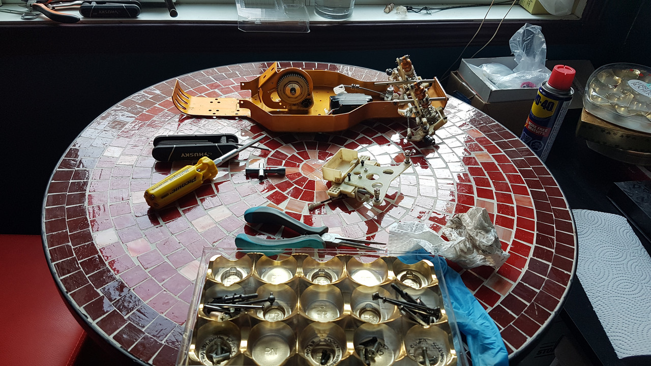

I've taken down the wheels, rear arms, motor, transmission box and bulkhead.
Found out that the gold pan is an "A" stamp: yay! -not that I cared that much, but still.
It seems that the Varilok diff works just fine.
That means the binding is happening inside the transmission... next step I'll open it and hopefully find out.

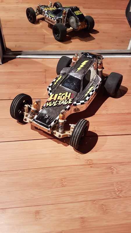

Good call to keep it. I just got one too. It's obvious Tamiya took a page out of the RC 10 playbook with the Astute and latter competition 2wd cars. It's nice to see where it all came from!
Never owned an Astute so far, I hope someday I'll be able to make the comparison!

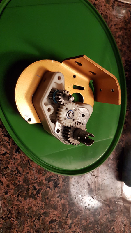

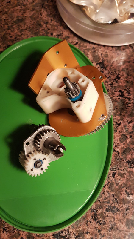

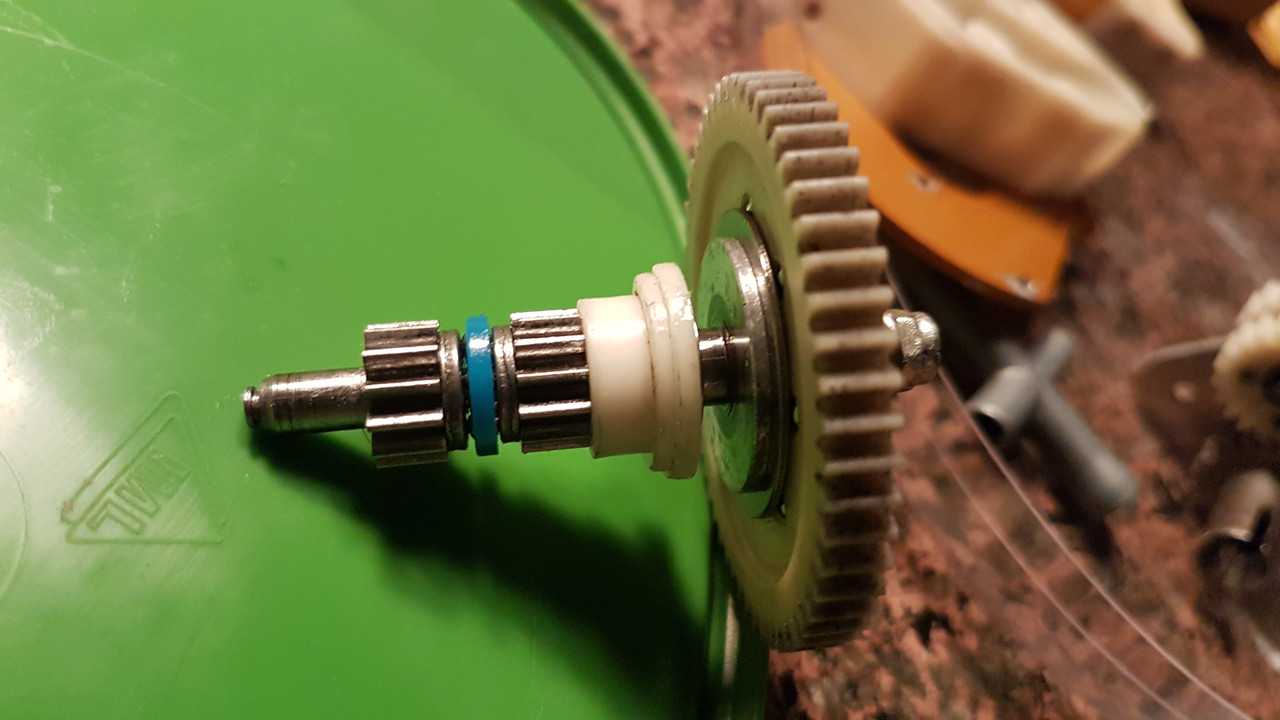

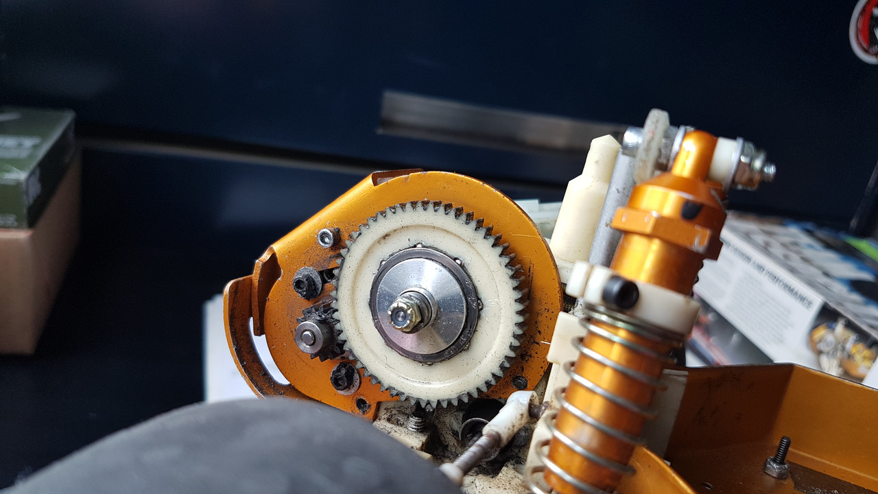

I've opened the gearbox, very pleased to find out thatceverything seems to be in great condition. The binding must have been just all the dirt packed in the diff.
What surprised me were the bushings: for some reason I thought the RC10 kits came factory equipped with ball bearings. Anyways, a new set is on its way from California.
Next thing I'll disassemble and clean the ball diff.

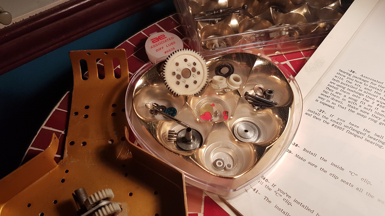

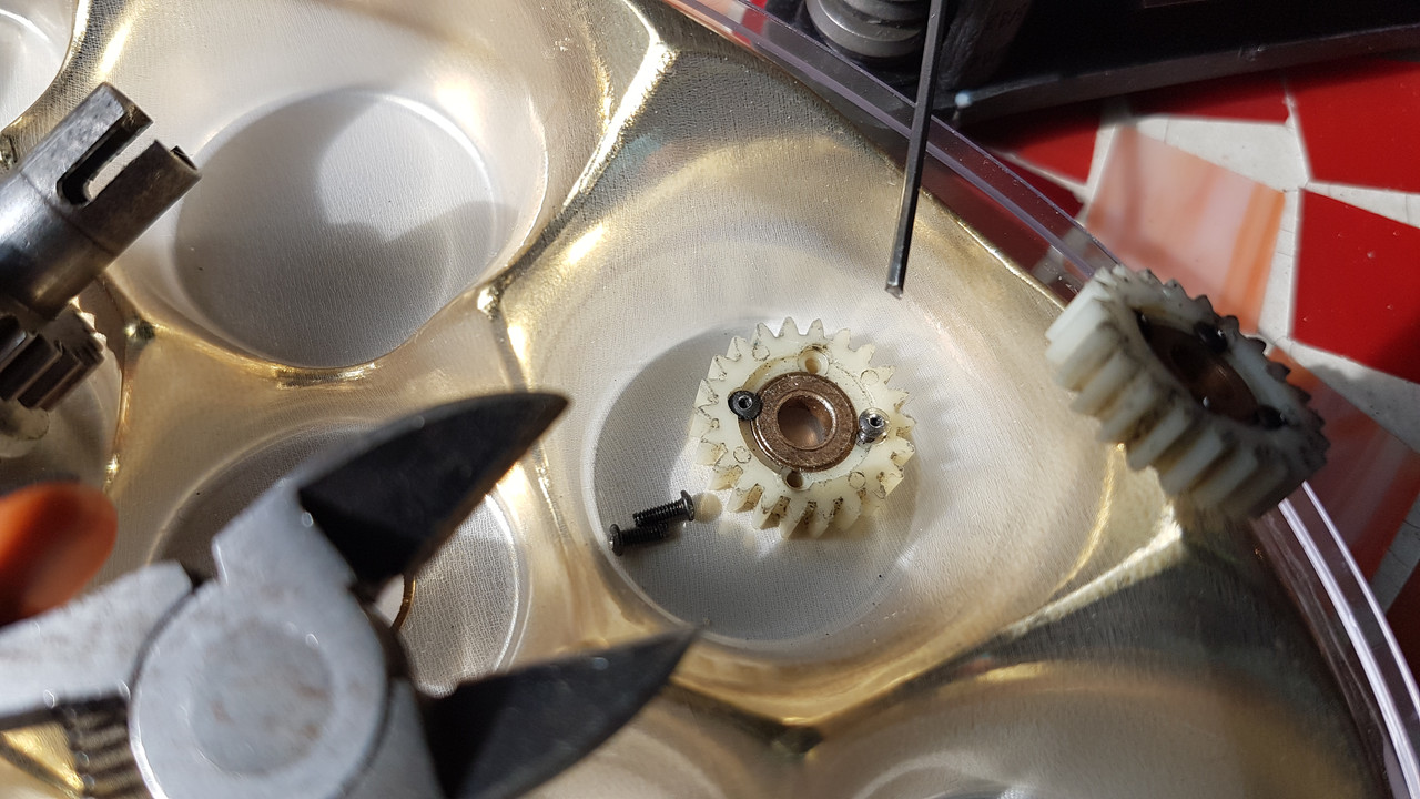

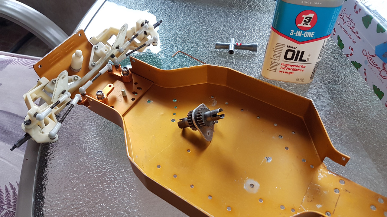

In the meantime I took apart the ball diff, which was quite packed with dirt. I found some suitable boxes where to store all the tiny parts and bits for now.

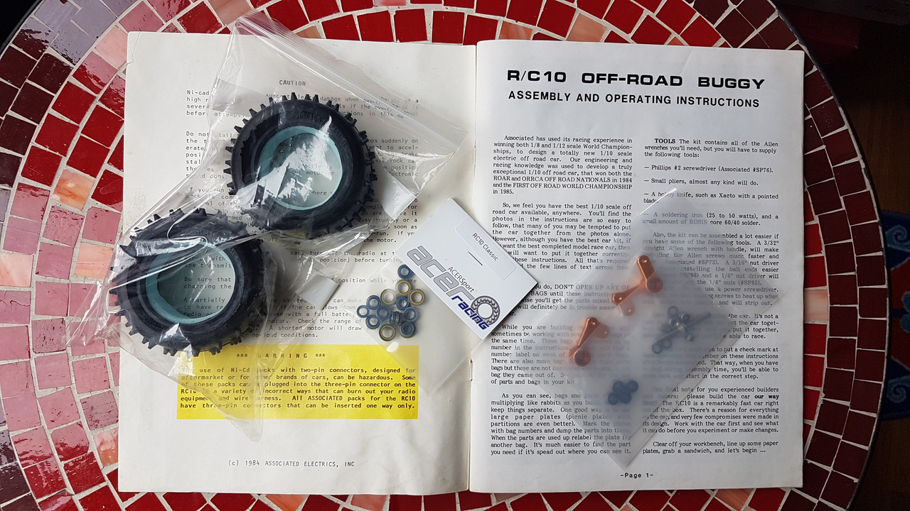

Also, the alloy teering cranks arrived today.
I didn't have much time to keep going with the restoration lately with what's going on in the world at the moment, but still I have a few small updates.

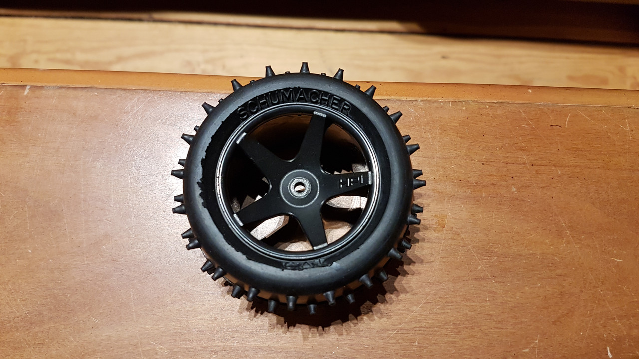

Most important, the tires have been sorted out,  and at a burgain price on top of it! Thanks @mtbkym01 for the indirect information :)
Brand new Schumacher Cat 2"" rears with foam insert, here they are with the other goodies that arrived in the meantime: gold alloy steering cranks and sealed ball bearings.

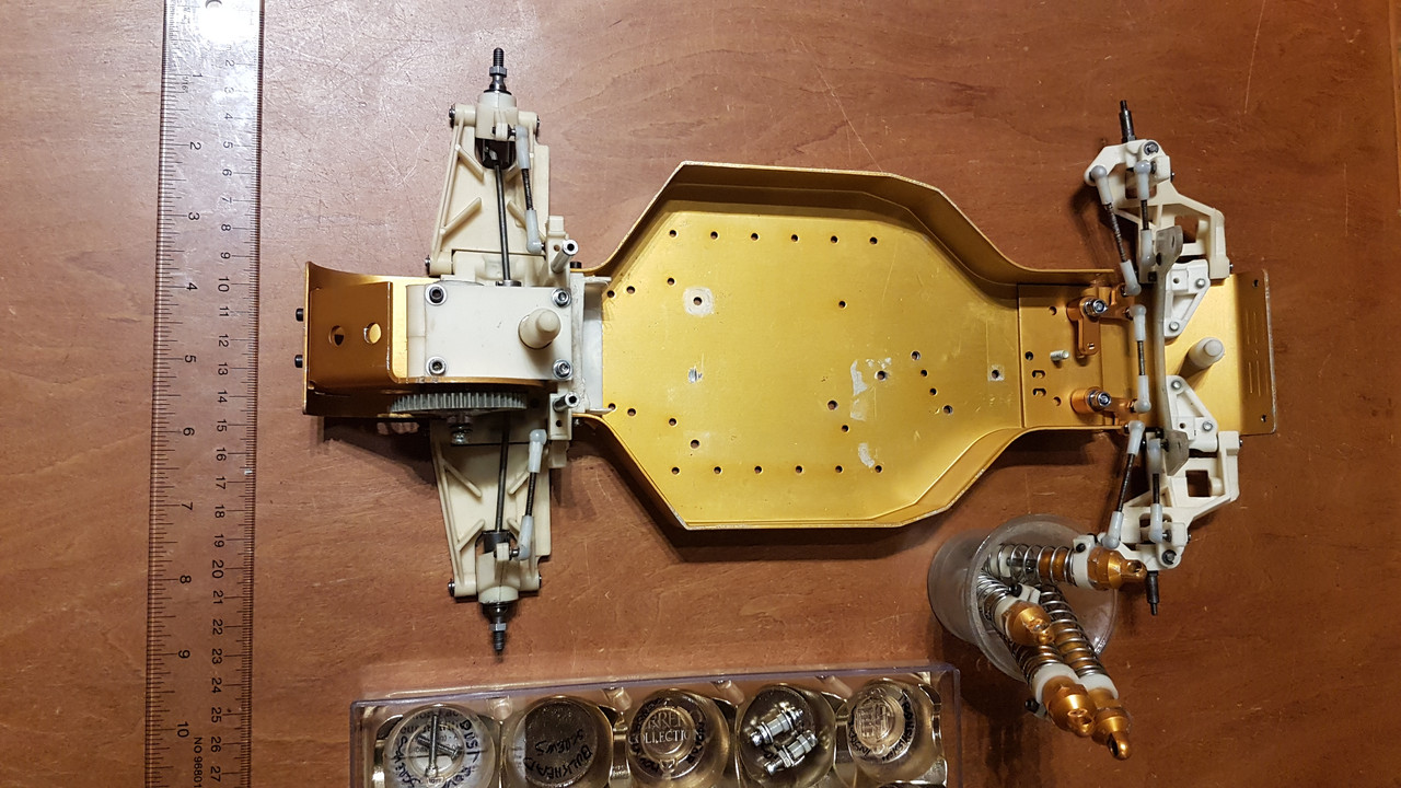

I have almost finished the stripdown, only the front arms and the shocks are left. I found every component in surprisingly good shape so far, regardless of the obvious extended use of the car, which I guess testifies in favour of the toughness of this vehicle.
 The only question mark left is about the state of the "O" rings in the shocks, but I'll find out today what the situation is. I cross my fingers that they are somehow still good to gi as from now on, with more and more businesses and provinces in lockdown, I wouldn't count on a timely delivery.

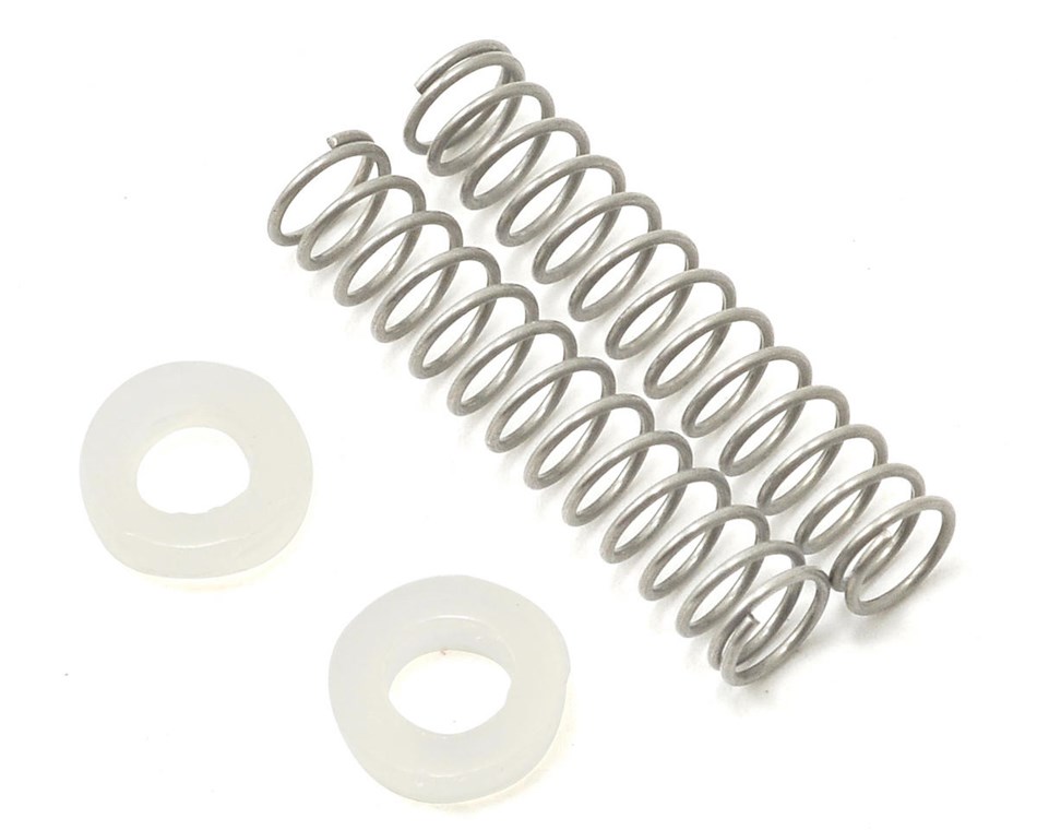

Venturing out to hardware stores for such reason in this crazy times just didn't seem the right thing to do either.
After some thinking and rummaging, "Ghetto Solutions Inc." came once again to the rescue: I grabbed the smallest key I could find, which was just a hair too big to fit, and cut its tip on a 45° angle somehow hoping that the tip, sharpened by the angled cut, would fit in enough to grab into the screw. Well, it worked! Definitely not the kindest way to drive such tiny screws, almost sure they they sprained a little (the hole, not the thread!) but I figured might as well, as after fitting the ball bearings I'll screw them back on and there they'll stay for 35 more years.

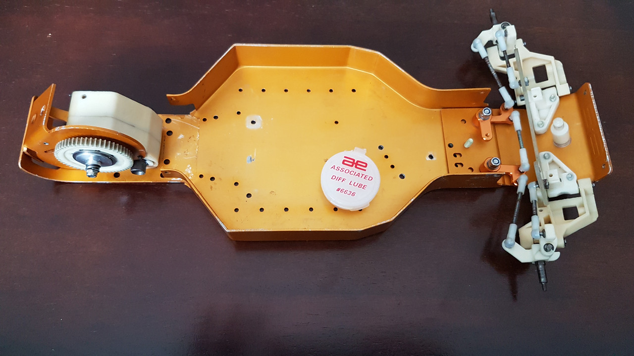

I got started on the actual re-build yesterday, here's some documentation of the progress.

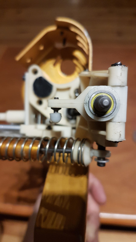

Got the front suspension arms and strut installed, along with the new alloy steering link. That is indeed a good piece to add if you ask me: simple, tidy, well designed, ball raced (two bearings per link!) and properly anodized in copper.
Here's the VariLok diff: stripped down, thoroughly cleaned, greased and reassembled.
I expected it to be smoother than it feels when I turn the gears, though based on what I've learned so far, it seems that realistically speaking you want it to be quite tight on this car. So I'll try it out like this for now, I can always do some tuning later on.
Here it is with the rest of the 6-gear transmission, installed in the gearbox. Everything is now ball raced, it felt like the right thing to do.

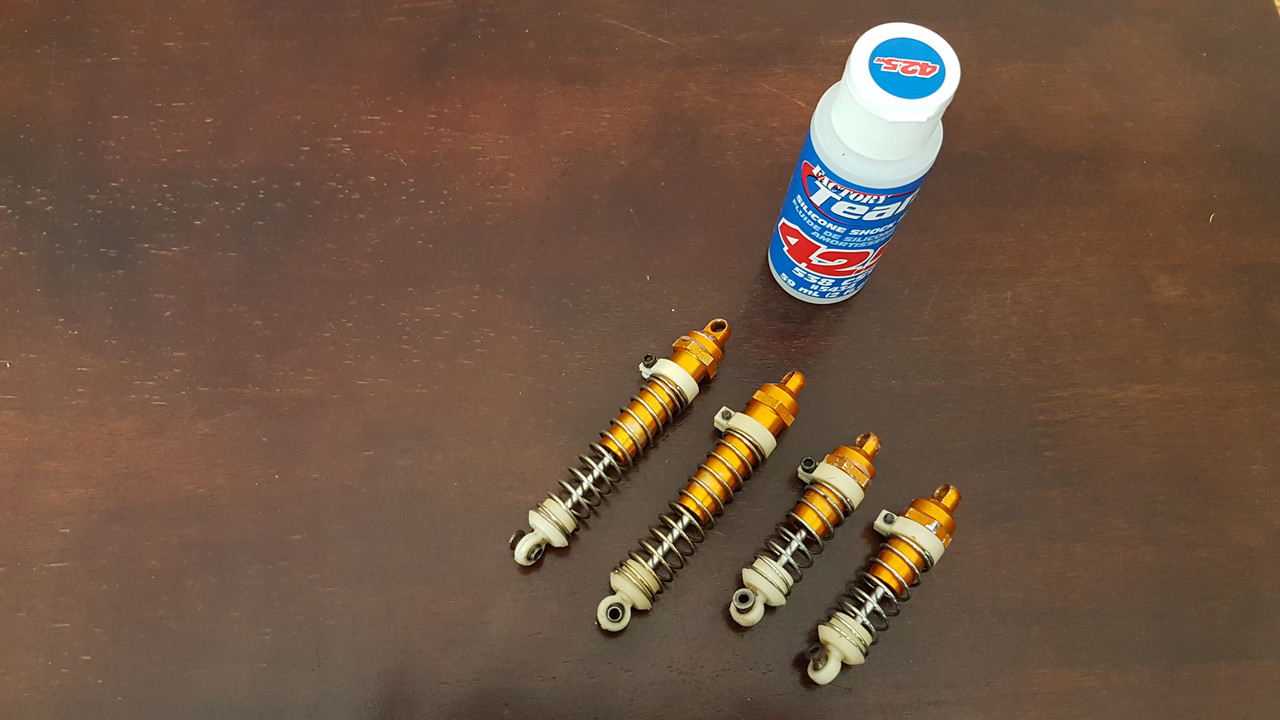

I also refurbished the shocks: took them apart, cleaned, flushed and refilled them with Associated Factory Team silicone fluid (538 cSt). Incredibly, all the O rings were fine, no leakage so far. Actually, the shocks were still half filled with who knows how old oil... I was tempted to keep it as vintage used shock oil ;)
So far, so good. Can't wait to keep going.

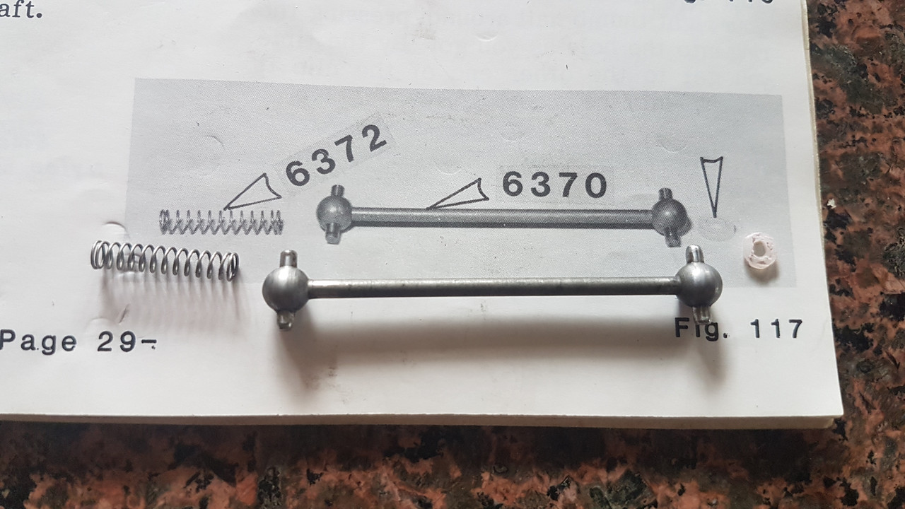

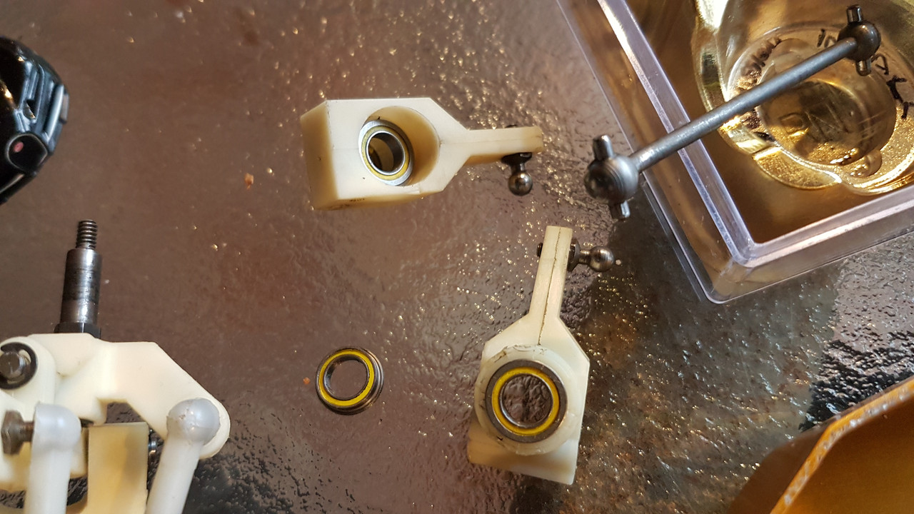

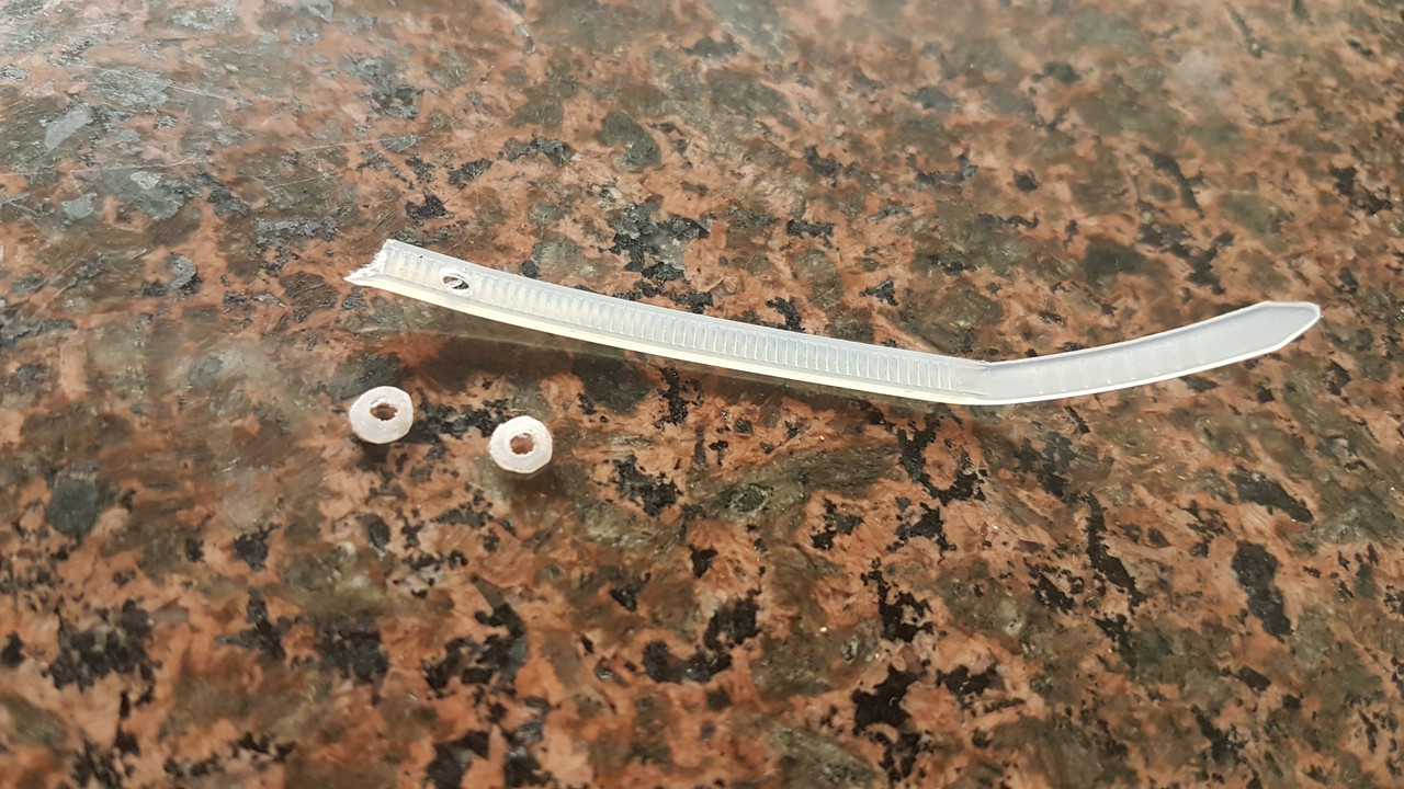

In the process I noticed something that escaped my attention before: when installed in the gears, the dogbones are supposed to be "cushioned" by the usual spring on the side of the stub axle and by a little 1/16" plastic spacer on the gearbox side. My car lacked the latter, I'm 100% sure there were no spacers when I took it apart.
So after some thinking I decided to recreate the spacers myself by butchering a nylon zip-tie. Right material, right thickness, I only needed to shape it right.
Here's the result, not exactly perfect but will totally do the job:
Besides, even the ones for sale on line seem to be quite far from perfect and almost look hand shaped:
 I'm happy with how these spacers came out. The dogbones seem to sit very well. I could have probably stayed without (who knows for how long the car was driven without those spacers anyway) but I am doing a restoration here, so I thought might as well go the extra mile.
Ball bearings for the rear axles:

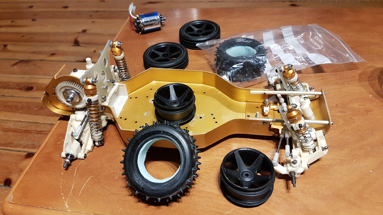

Here's how it looks now

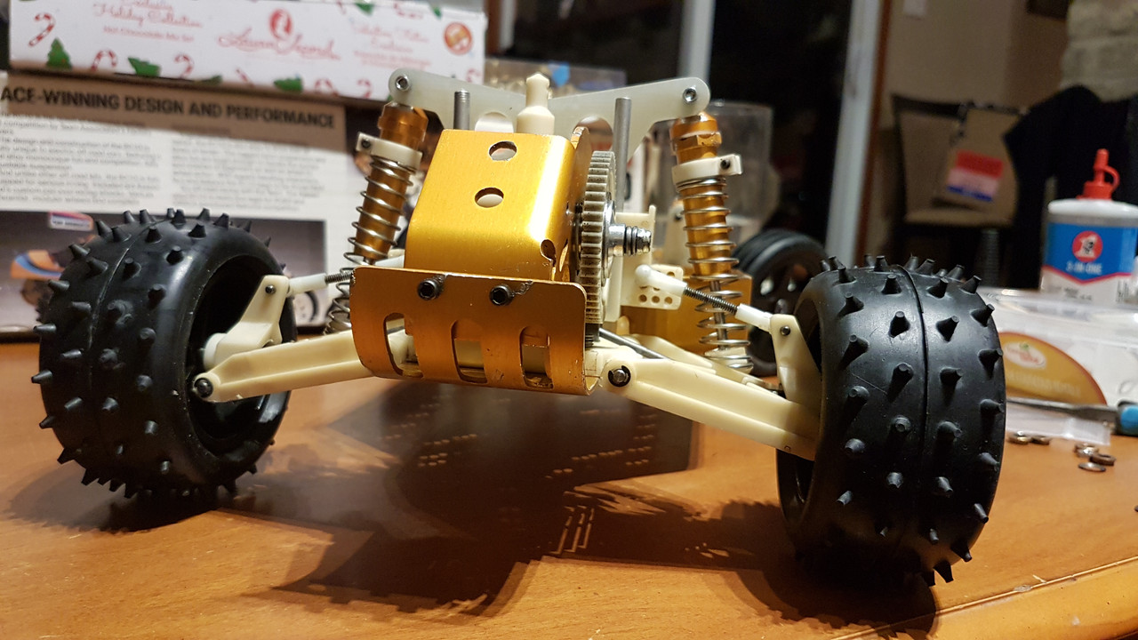

Update. Rear shocks installed, but that was a bit tricky: the two ball bearings the rear axles now sit on (one on each side for each axle) have pushed them closer to the suspension arm to the point it almost touched it when the shock was fully relaxed. Some fine tuning and double checking the lenght of the tie rods solved the issue and I was able to position the shocks on the second hole from out, but the distance between the axle stub and rear arm is no more than a hair. Well that's all I needed!
Next I got around to doing the wheels and tires. Cleaned and soaked in soap&water overnight, it was a relief to find out that these rear CAT tires are indeed a perfect fit for my HPI wheels. Measurents were matching but you know how it is when it comes to tires, glad that problem is solved for good.
Here they are installed, I find they look quite gritty
Rims and tires will get some more attention later on in the build: I am planning some lettering on both, though I know it'll vanish in the first 5 minutes of action. But I want them to look as good as possible for the spot on pics when the build is finished.
Also I couldn't wait so I just had to slip the wheels on for a moment, just to see the stance of the car. I think it's starting to look yummy even if I'm still in an earlier stage of the build.
I really like the view from behind...

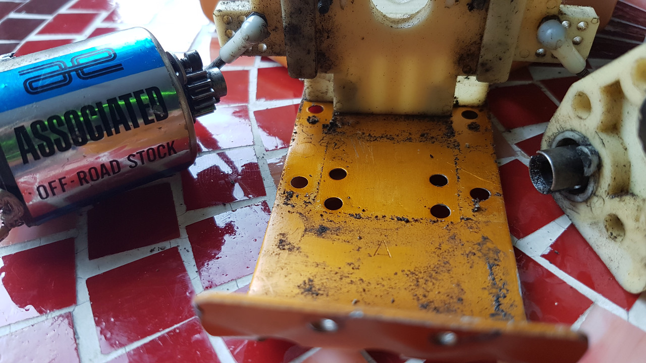

The car will be equipped with its original Associated Off-Road Stock motor for now, though that might change in the future depending on driving feel and performance.
The motor seems to be in a good shape but will need some cleaning and re-soldering.

The tyres look fantastic. These look fantastic on all vintage/retro builds without doubt. They are an iconic tyre from back in the 80’s and atleast here in Australia, they were very much the go to tyre for racing in our conditions 👍🏻
