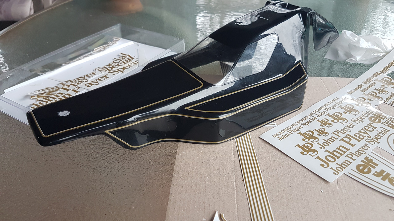

I've worked on the body shell. When stripping it, I found it had no cracks and barely any scuffs (it was hard to tell before, with that odd body wrap on). It also showed the poor trim job, but that was sort of good news as I got the chance to re-trim it.  Now it sits perfectly on the chassis.
I really liked how it looked once "unwrapped".
Usually I am all for bold colors but this time the bright decals had to go, given the livery I'm going for.
The stickers have been carefully peeled and religiously stored, I'm totally going to recycle them on a future project! The 'Dahms' ones are the only that didn't survive the peeling.
Here's the painted shell. I'm happy with how it came out, definitely better now than with that silver wrap
....and now the decals. It will be challenging to figure out these! Can't wait to start.
The body shell is finally ready. It took a lot of patiece and pondering but it was well worth it, it came out exactly as I wanted it to so I'm very happy! :)
It might get a wing, still debating that (but I'm working on something...) and it's screaming for a driver, but the body itself is done.
The pics aren't great and I haven't wiped off all the fingerprints yet but I'll take much better ones when the car is finished.
