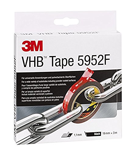

I use this stuff for everything around the house: ceiling lights in the conservatory, pictures on painted walls, doorbell and door number on upvc front door... oh, and rc car electrics. :lol:

Both 3M VHB tape and Tesa double sided are great tapes. I use vhb grey and clear Tesa depending on what’s closest.
Wiping both surfaces well with Isopropyl/rubbing alcohol and warm the adhesive before applying it is how I do the phone screens at work and it seems to work a treat. It’s kept many an esc in place too. The cleaning is the most important part in my eyes.
Agree cleaning is more important than most tape or pads
