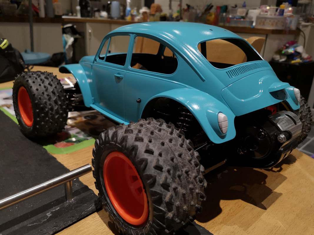

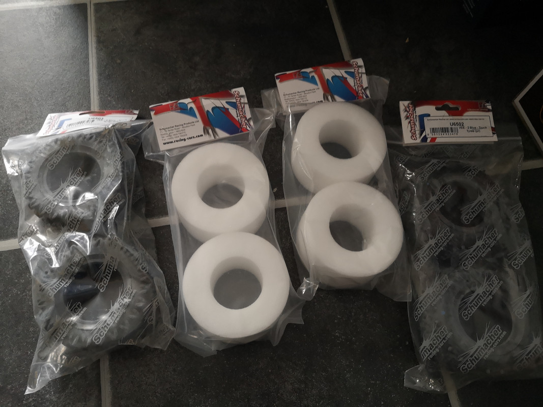

Had a few test runs and  came to the conclusion I might need to do something with the tyres to improve grip. Ordered some Schumacher Vee truck tyres after reading various reviews.
Fitted them up with the Vee 2 up front and the Vee 4 at the rear. Seems like I've got that wrong after a bit of discussion on the Blitzer Facebook group so I may need to revisit that. The tyre descriptions read (to me at least) that the Vee2 is a front specific tyre however it's been suggested that they're actually better out back. If you're on here guys, I'm going to get round to swapping them round once I've finished the body.
So on to that...

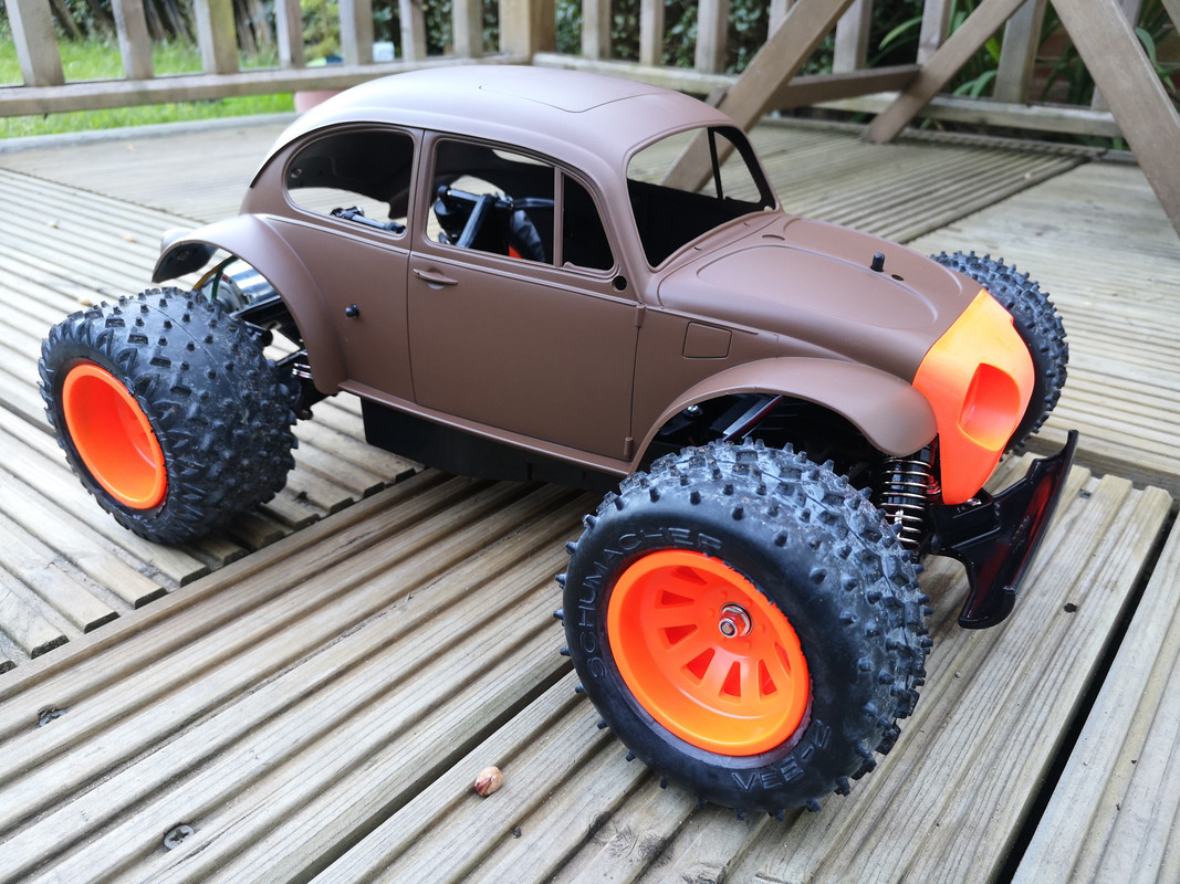

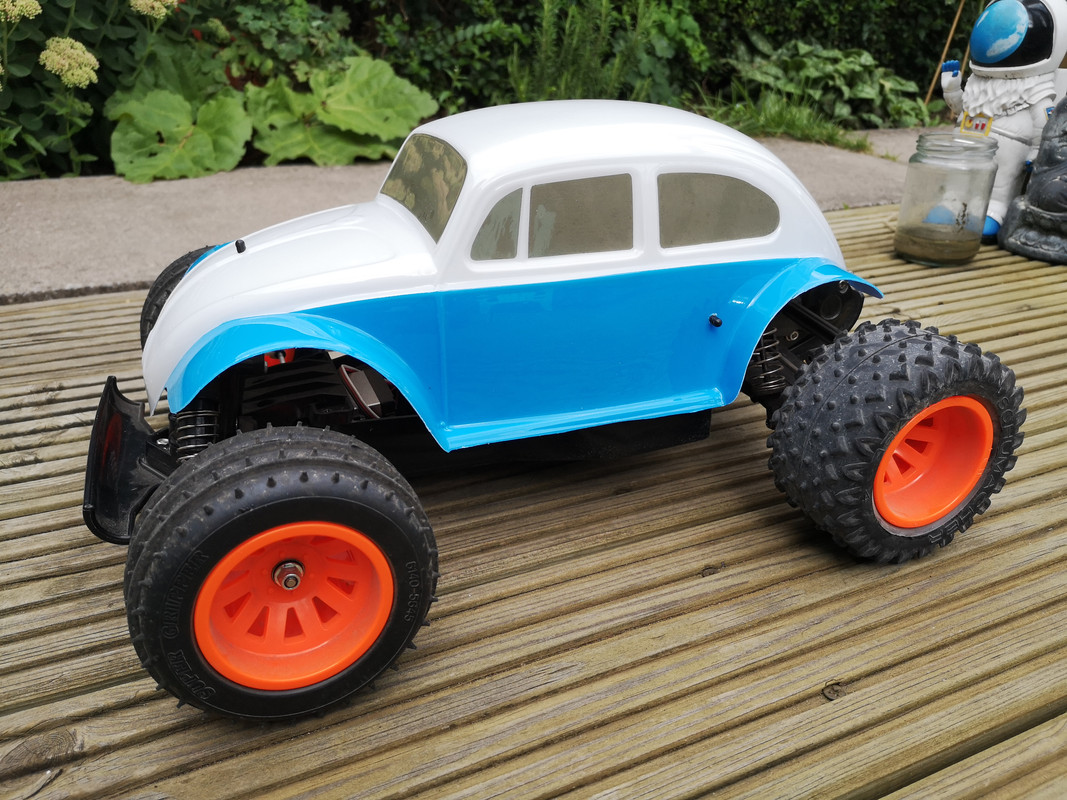

I've mentioned before that I'm interested in a kind of patina'd paint finish. First thing to do was to lay down a coating of brown. I'll look up the code if anyone is interested
After this I laid down some white primer. The nose cone didn't get the brown base as I'm working to the assumption that a full size car would most likely have a glass fibre nose so therefore wouldn't rust through. Maybe a bit of a pointless detail but never mind lol.
After the primer, I dropped on the 'coral blue' top coat. Loving the colour!
That's as far as I've got. Next stage is to start sanding to get some of that brown and primer to come through. It might work, if it looks crap then I'll just repaint.

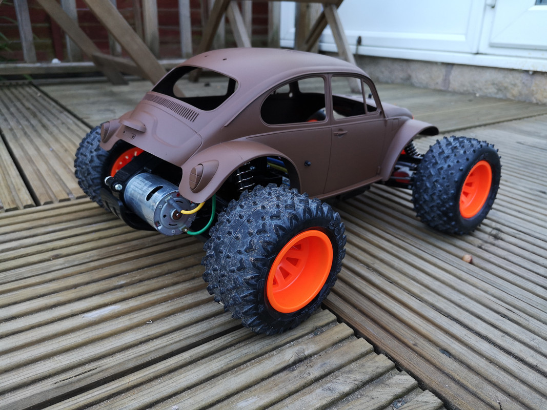

More updates...

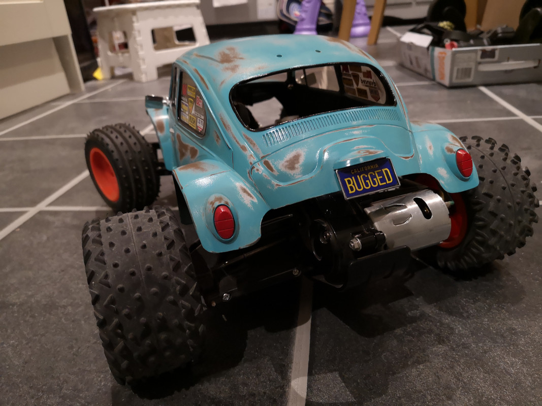

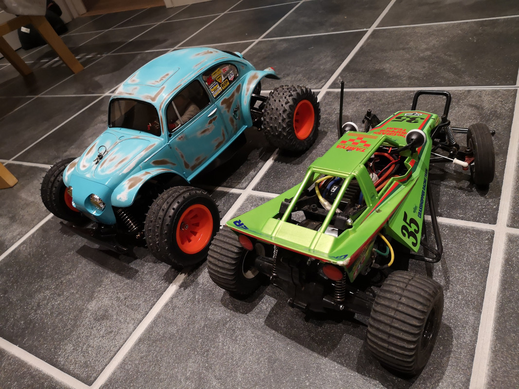

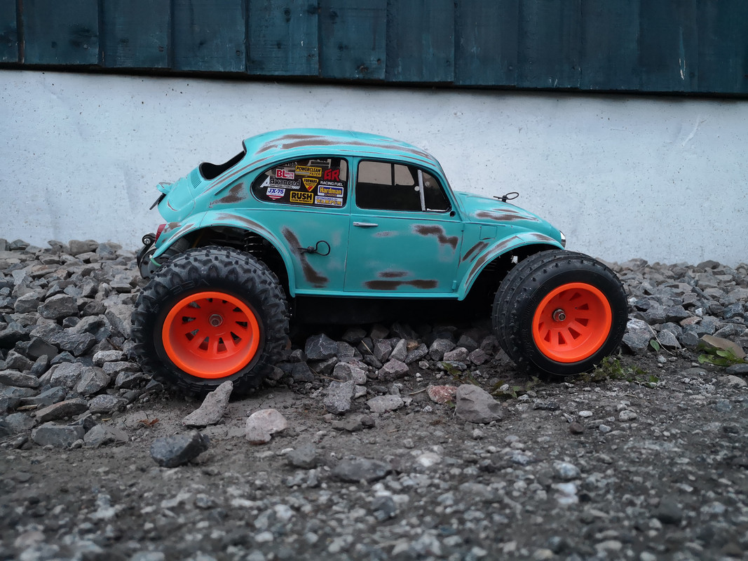

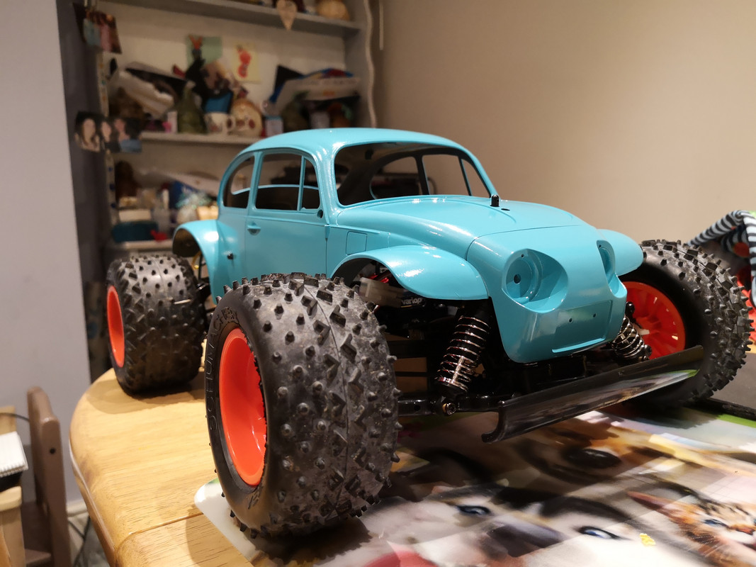

So I started on trying to create the patina look on the shell.

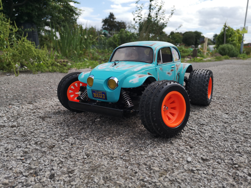

Gave it a rub with some 400 grit wet and dry and got the rusty spots coming through. Quite pleased with how it turned out.
After going over the whole body I gave the details a going over picking out the handles and window frames in black and aluminium then the tail lights in red. Also added the lights, number plates and a few of the decals...oh yeah and Barry the driver. Had to get a couple of snaps with the Hopper.
Think they look good together 😊

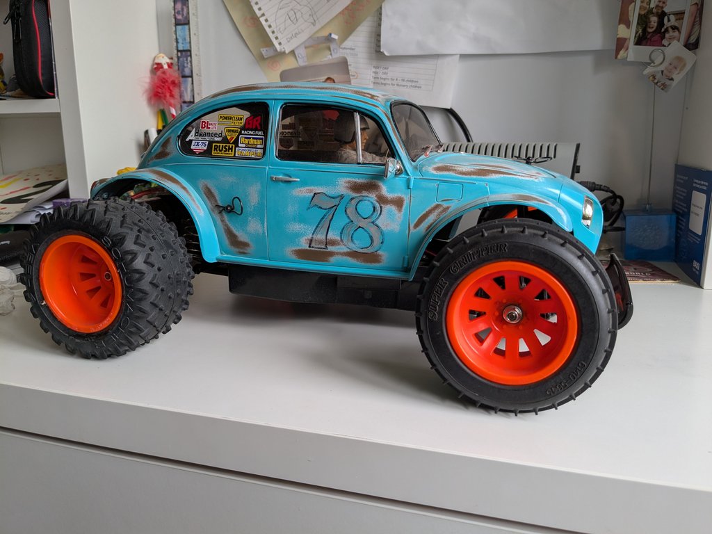

Finally, had a bit of a run with it this afternoon. Switched the front tyres back to the kit ones, mostly because they look better as the Schumacher tyres are a little wide for the Blitzer wheels.
Still need to add some of the small chrome bits such as the VW badge and mirrors and then a little more paint detail. Needs a faster motor so think I'll swap motors with the Grasshopper as that has a Torque Tuned.
Loving it how it's come together.

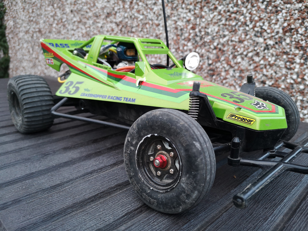

Had a session this evening round the lane behind my house. It makes for a fun little area to blast up and down. Took the Blitzer out first. Good fun kicking up some dust and gravel but took it easy.
Got the Grasshopper out next as it always makes me smile as it bounces up and down over the bumps. Anyway got a bit carried away
Poor thing suffered a bit of damage after a spectacular roll over ☹️ I'll try gluing it back together for now...gives it more character I guess 😜

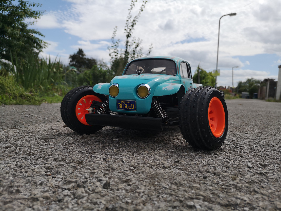

Little update on the Hopper. Basically been running it quite a bit which lets face it is what they're there for right? Lots more scratches and battle scars.

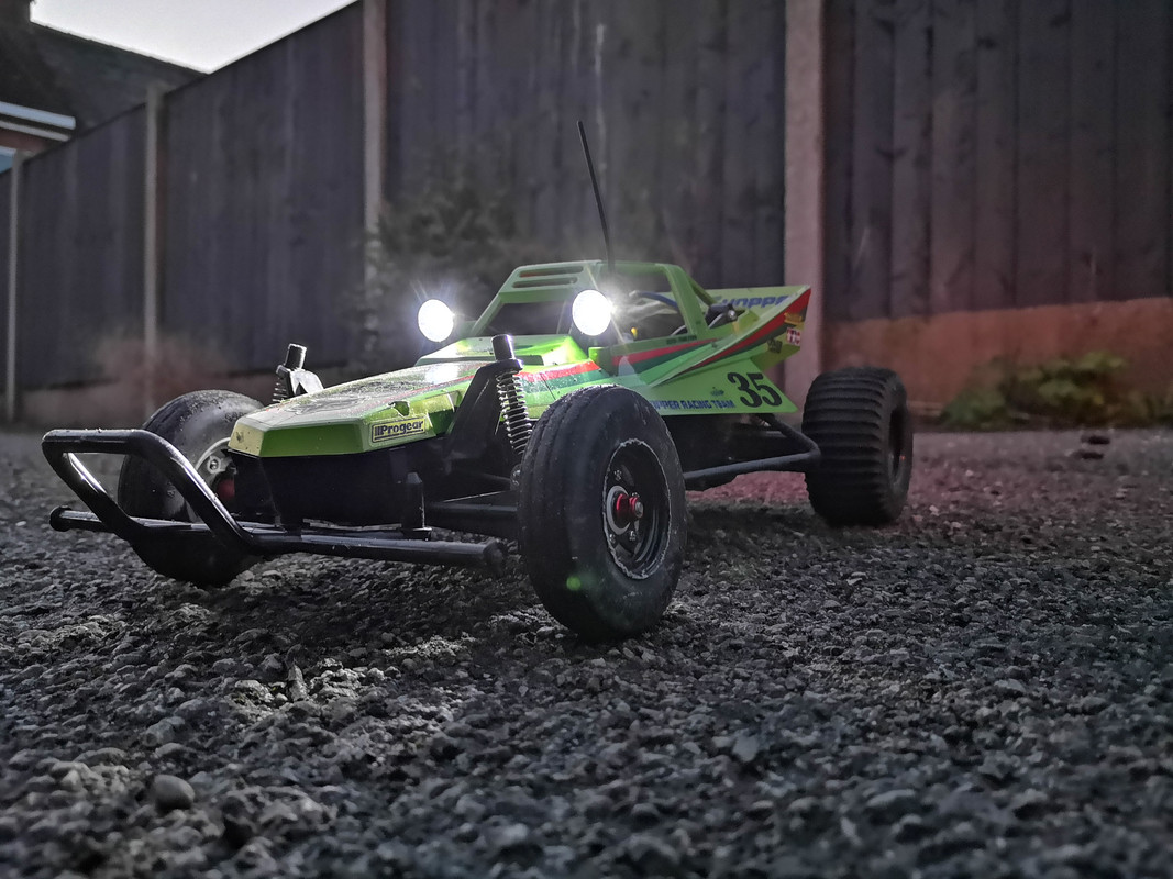

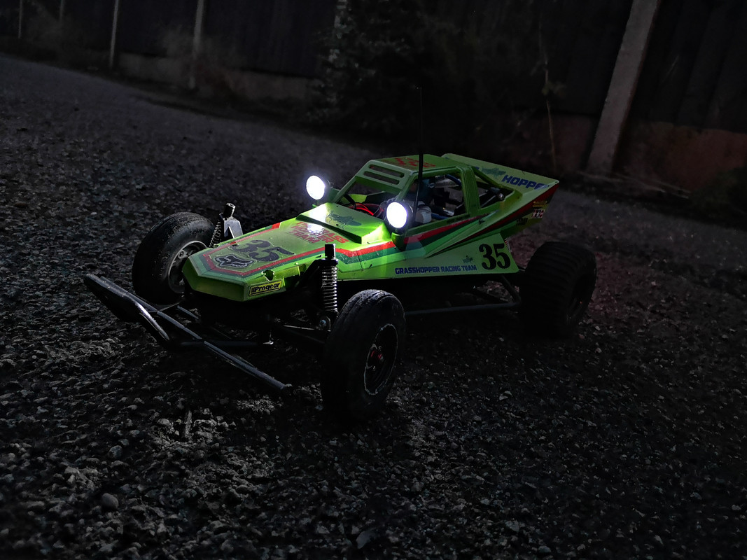

Anyway, a short while back I ordered a light kit which finally turned up today.
I went with a 4 lamp kit thinking more lights has got to be better right? I knew I was going to replace the standard kit lamps, they're kind of a defining feature of a Grasshopper. The 2nd set I was torn. Initially I was going to mount them in the front bumper. Then I thought about the Hornet position but they wouldn't sit straight and I'd have to drill the body.
In the end I found some transparent red plastic to make them shine red and mounted them to the back end. Pleased with the results. Just need to tidy up the wiring as it's bit messy!
Here's some pics of the end result.
Been for a blast this evening. Great fun 😁
Not going to do much else to this car, just enjoying it's quirks. Once there's some new stock I'll look to building something else...

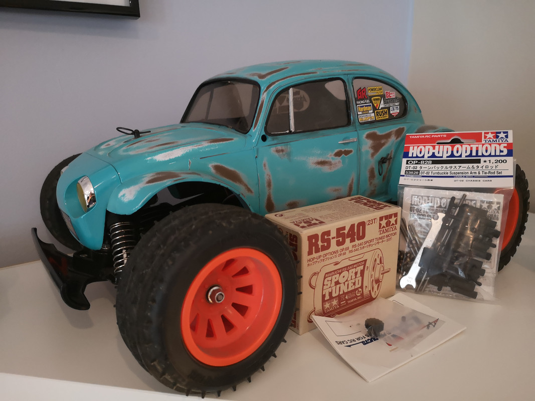

Got a few updates.
Fitted a DT-02 turnbuckle kit to the Blitzer. Had a play about getting all set up and think I've got it somewhere I'm happy with. Got a little negative camber front and rear and got her tracking nice and straight. Pleased with how it goes now. I'll post some more detailed pics later.
For now you'll just have to make do with this one (pre-turnbuckles on the Blitzer)

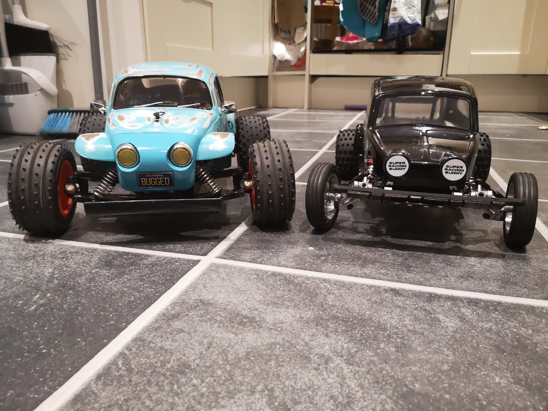

New project is in the house lol. Picked up this sweet little black beauty. Body needs a paint job, got a brand new body and decals already. Other than that it just needs a motor and electrics.
She's a thing of beauty 🥰

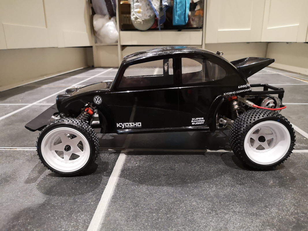

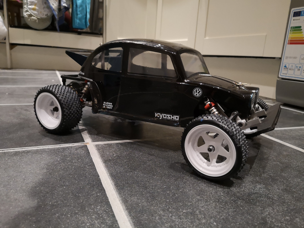

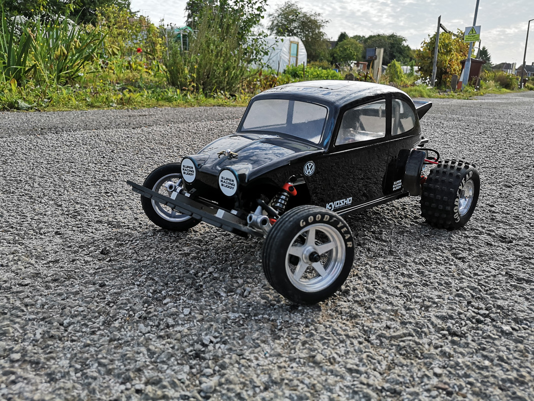

Got the Kyosho Beetle running thanks to a Hobbywing 1060 and a HPI Firebolt 15T brushed motor. End result is quite satisfying. It's great fun to drive. Unfortunately the Blitzer had to give up it's receiver and tranny but never mind.
Here she is on my 'test track' after her maiden run. As I've said, great car to drive!

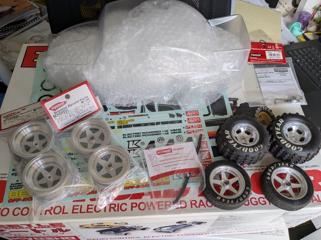

Got some new bits ordered including 2 sets of wheels and a new body & factory decals.
Both sets of wheels are the 2.2" Turbo Scorpion wheels, one in white and one in satin chrome. Threw some Schumacher tyres on the white set which will be the main runners.
I love how these things look. Maybe less 'scale' looking but I don't care 😜

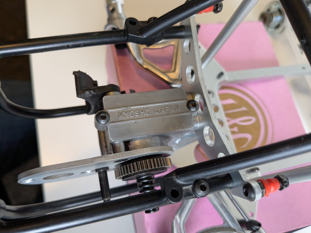

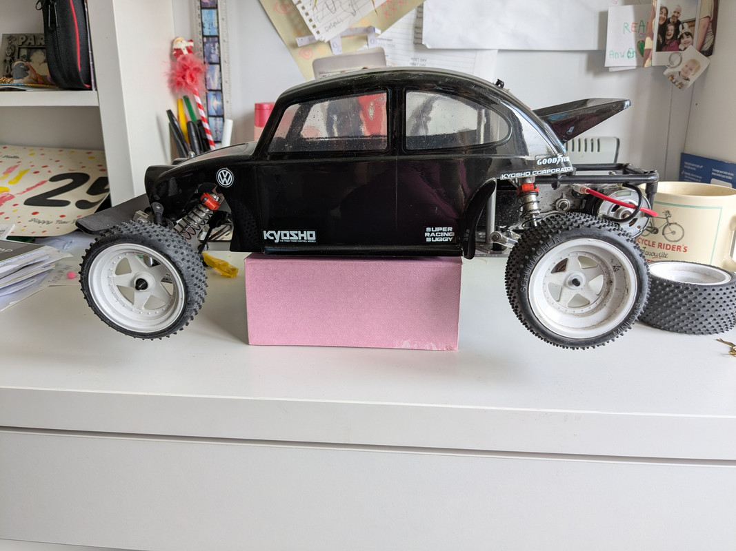

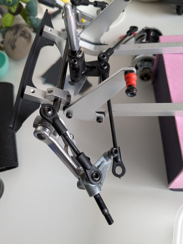

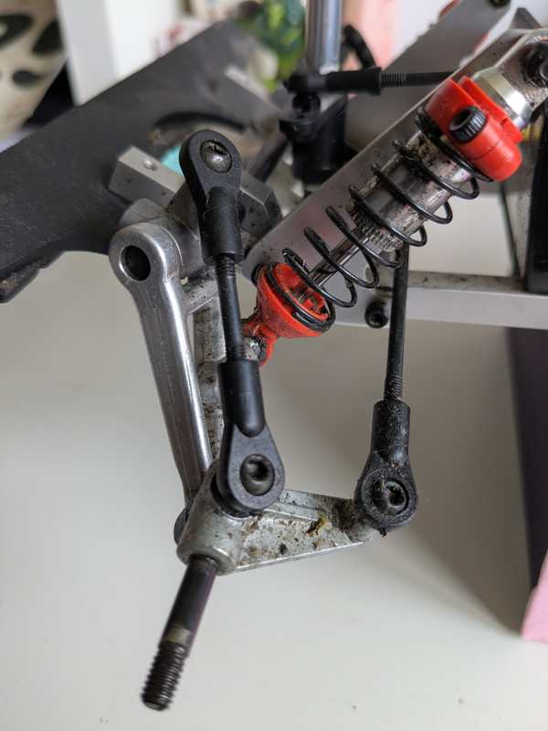

I actually started stripping and cleaning the Kyosho Beetle. The front end was a bit bent so I have a replacement crossbeam to fit but other than that she's just dirty so it'll be just a case of cleaning a few bits up.
I'll get some paint ordered and finally paint the new shell too. Pics to follow...
So this is where I'm starting. She's a little bit grubby but should clean up fine. The body is a bit battered though and the shocks need some fresh oil.

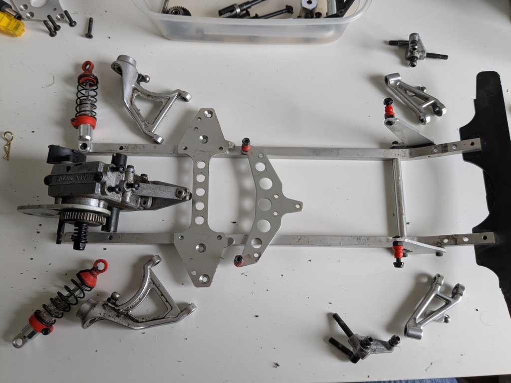

So it's raining, my body is still broken and the wife and kids are out. That means a good opportunity to get stuck into the Beetle.

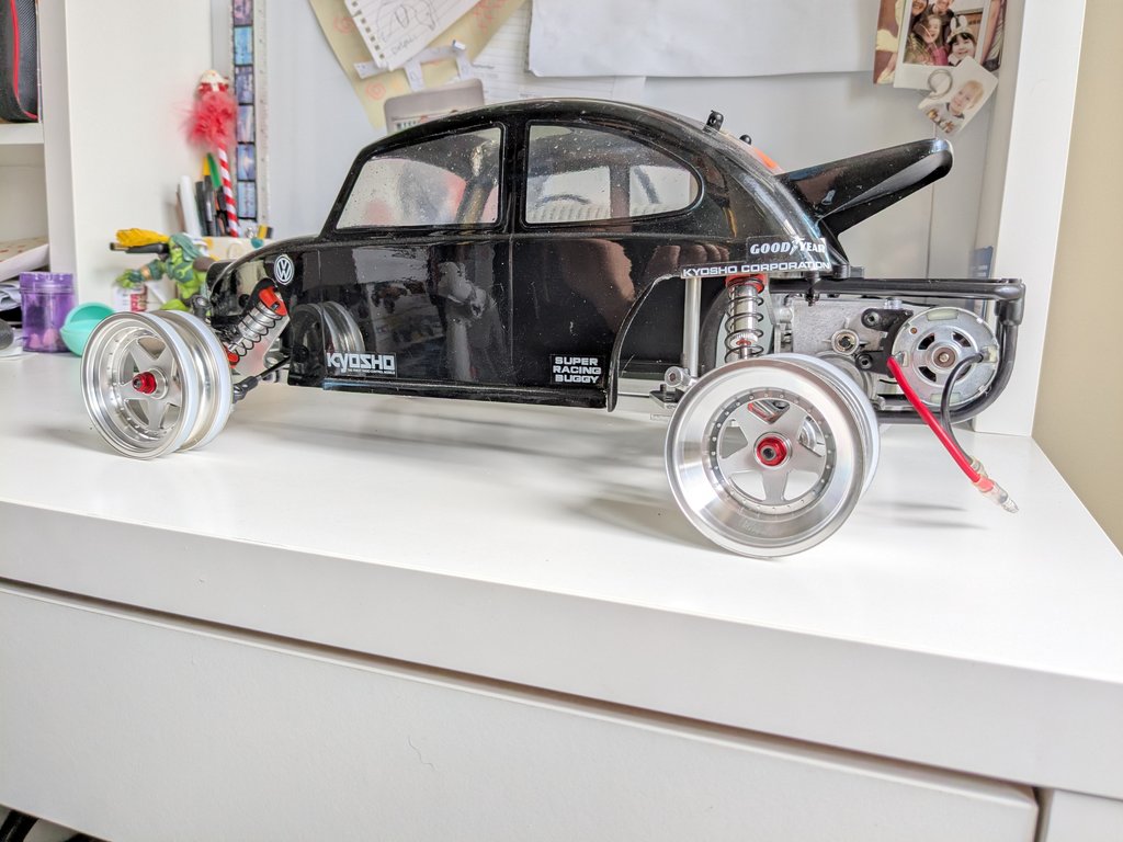

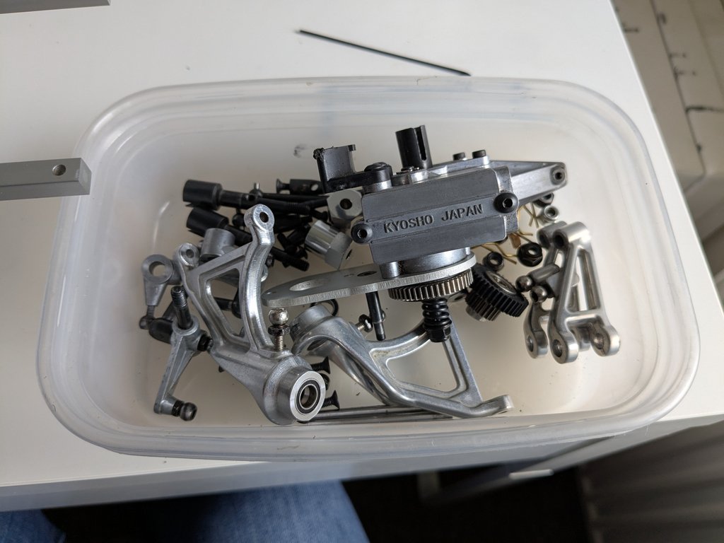

Fully stripped down (didn't take the drivetrain apart, it feels alright still)
Which left me with a pile of bits to clean.
Spent a bit of time with some degreaser etc. and ended up with a pile of less dirty parts
Started reassembly of the nice clean bits, thought it best so I didn't lose anything! Thankfully the manual is available on the Kyosho website.
This is where we are now

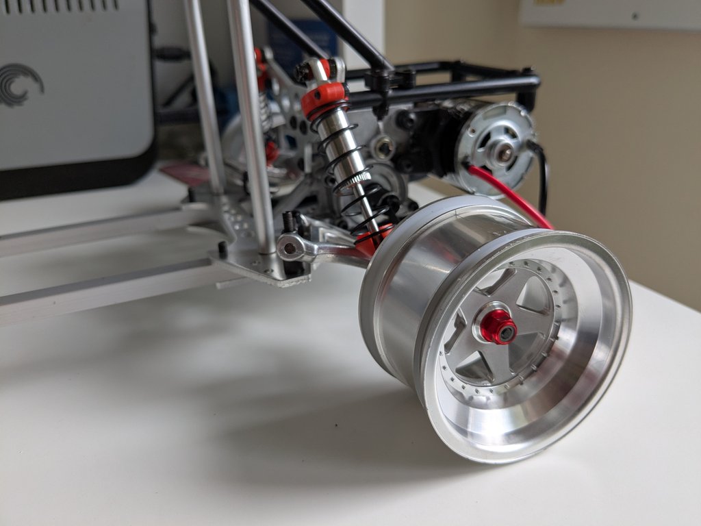

Absolutely love working on this chassis. All the metal bits are just so nice to work with. I was fancying a rally car but might have to get another Kyosho buggy...

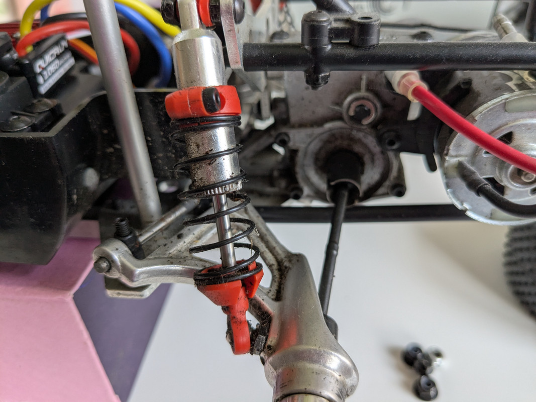

Spent a bit more time on the bug today. First job was to strip and rebuild the dampers.
Before on the right, after on the left (as if you can't see the difference!). Not much oil left in any of them. Much better now.

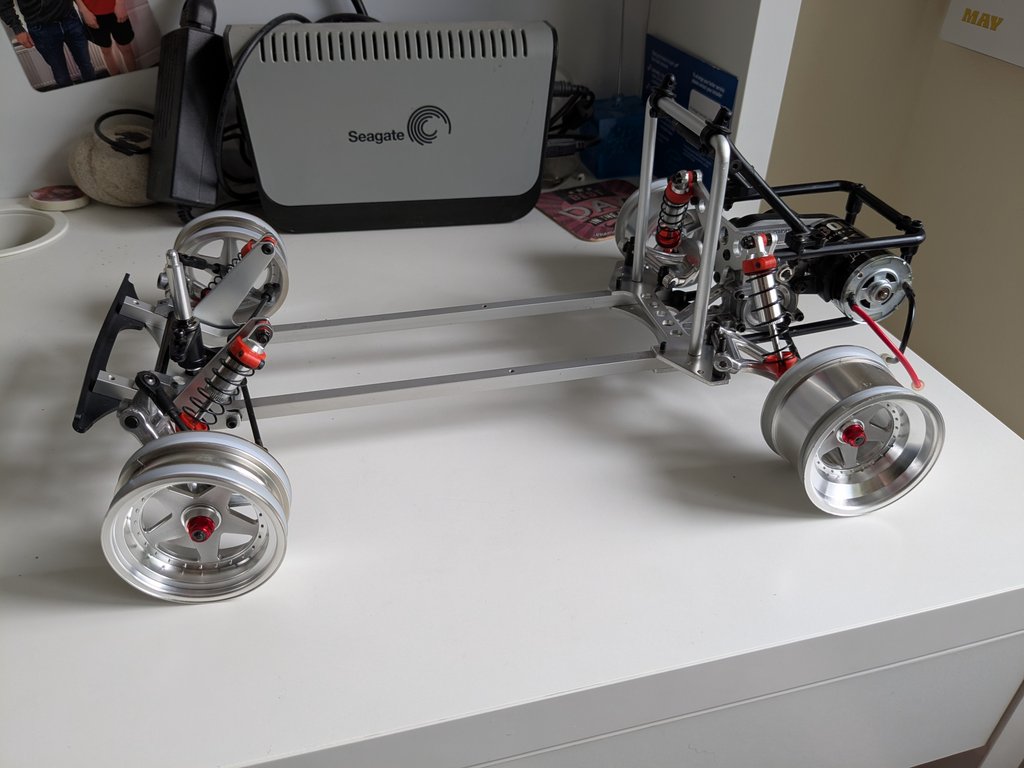

I then moved on to putting the chassis back together.
Couldn't resist fitting the satin chrome Turbo wheels and stole the red nuts off my Grasshopper. Love it!
I've also fitted the small front bumper. If I run it I'll swap it out for the big one.
Also chucked the runner body on for now. Radio box has been cleaned and refitted too.

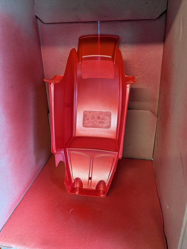

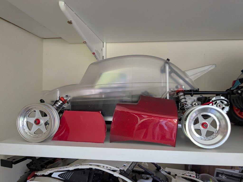

I'm now cutting out the new body ready for paint. If I don't mess it up it should look good 😬 I also need tyres and bearings for these wheels.
And finally, pulled the Blitzer down off the shelf. Got a pack on charge ready for a run out.

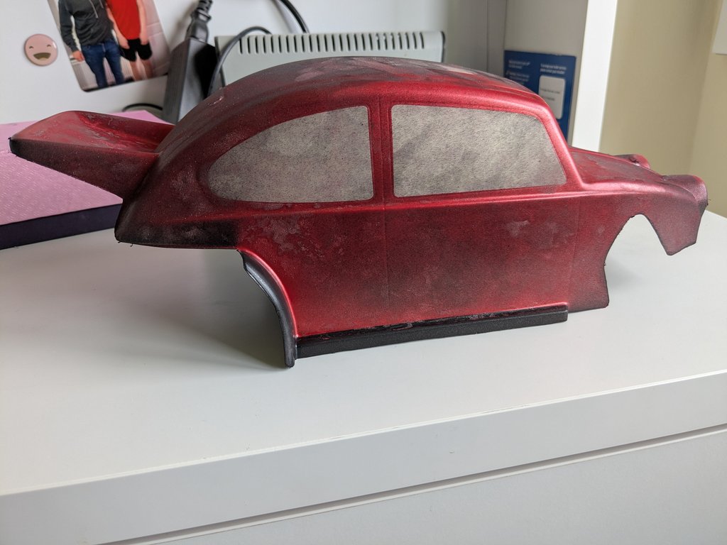

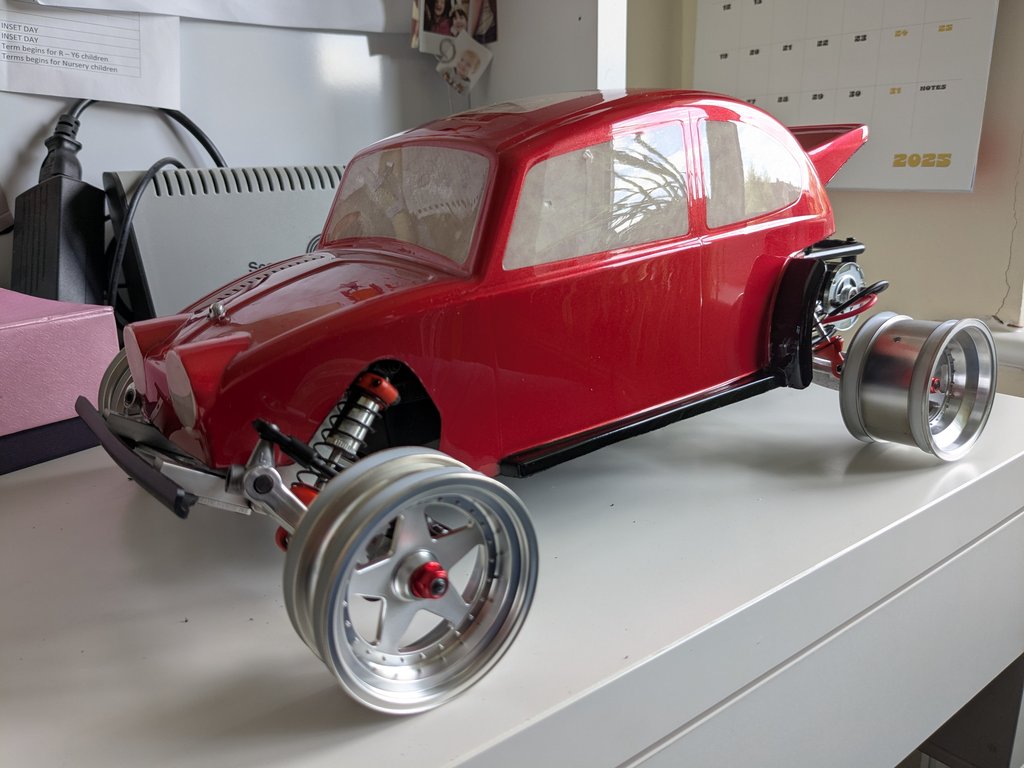

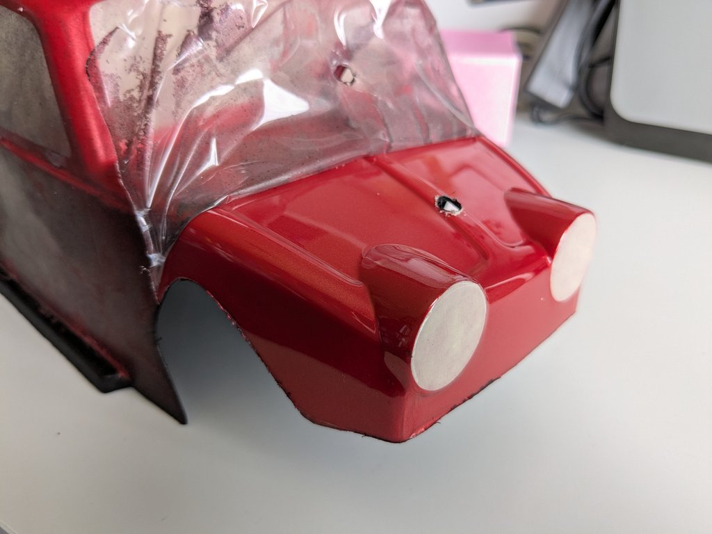

One more. Body cut out and played around with the final colour. Question is, light or dark? Using PS-15 backed with silver then either white or black. Can't decide...

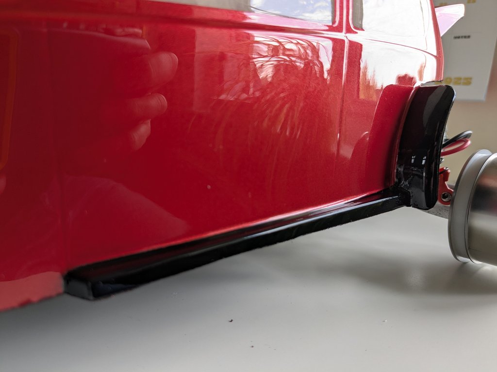

It's painted 😄 properly pleased with how it came out. Trust the process and go easy with it.
PS-15 metallic red, silver then PS-5 black. Masked off the rear wheel arch spats and sills for a bit of detail.
Is there anything more satisfying than pulling the film off?
I'll get those window masks removed and some decals applied to finish her off. Going to need a other project soon!

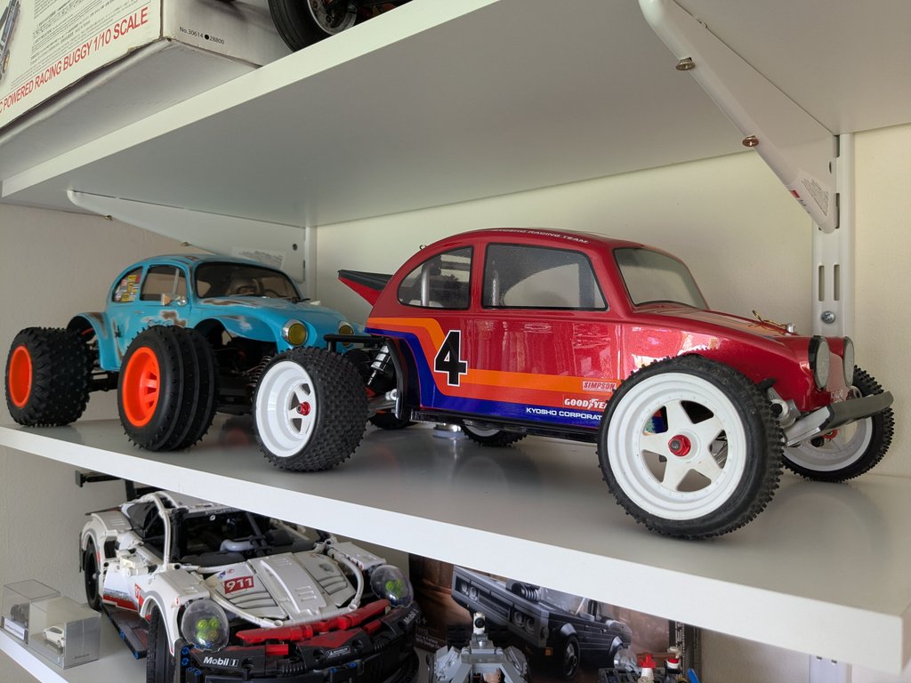

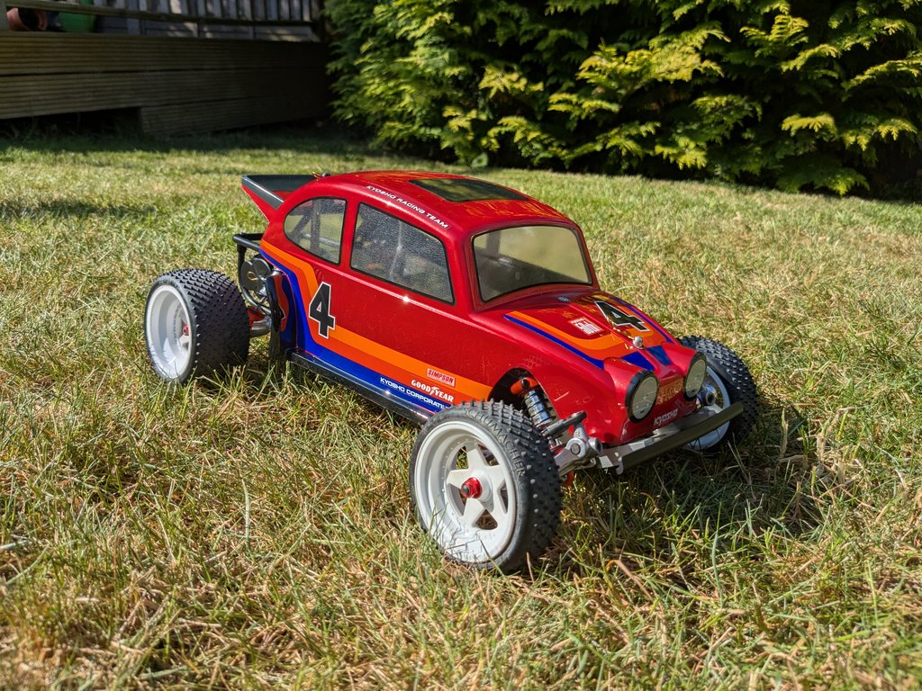

Calling this one done other than tyres for the shiny wheels and getting the radio gear refitted.
I may add more decals but I like the more minimal look. I'm really happy with how it came out.
