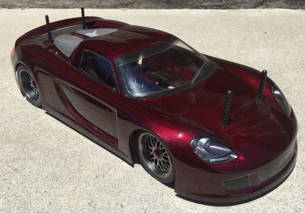

I just use lame bodies to try out my color combos.  Never really liked the tail section on this Carrera GT so it was my tester to try the clear red with a gun metal backing combo
00143F45-2747-4812-91D5-27C01EF15446_zps
I tried clear red and light gun metal and got this.
985F42E5-0442-4EA6-9F50-56B8BD65D5D3_zps

This is a useful intro with a good example.
As above, no hard and fast rules on the amount of primary colour you put down - but the amount will influence the tone of it. So test first. The more you put down, the less the backing colours can come through.
Backing a metallic with a light coat of silver then white makes it poppier, backing it with black gives more depth and subtlety and a darker tone. If you are backing with a dark shade - black or gunmetal be aware that the primary colour will be darkened quite heavily like the Porche above. AND if you have other colours that are light and not backed, the darker shade will back them too, so you may need to mask sections off depending on the design.
